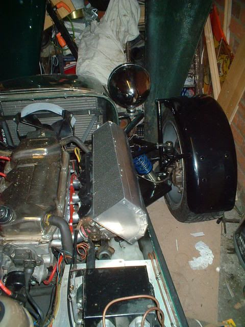

it depends on what CVH you are fitting them to, if its a older carb ok early mechanical injection model with basic vacume advance distributer should be a straight fit, if a electronic injection model may be able to fit the older kit or Mk 5 escort ignition management with crank sensor and vacume.
got motorbike carbs fitted to one of my CVH's with mechanical distributer
