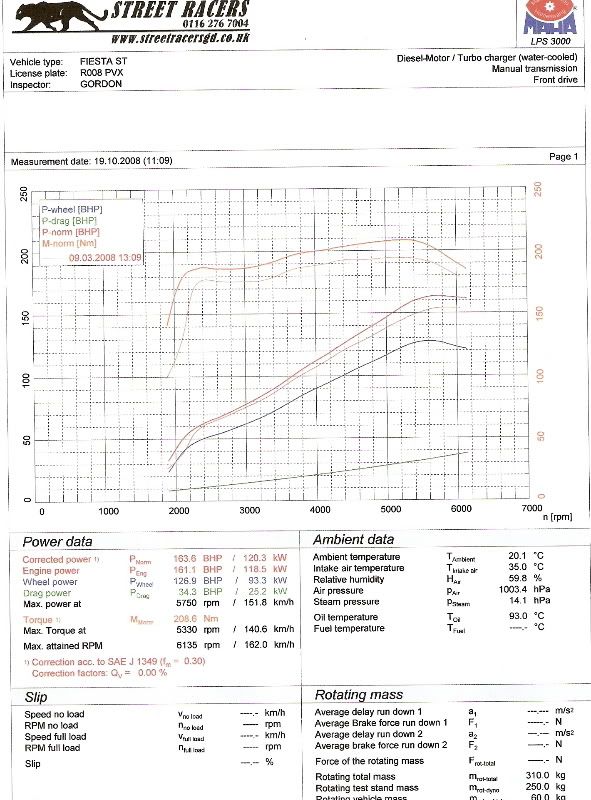

Ford Fiesta ST - 163.6bhp - 154 lb/ft
Standard - 147bhp - 140 lb/ft
Mod's
K&N 57i induction kit
Magnex Stainless Steel cat back exhaust
For what its got im more than impressed, a very good engine in this one, and goes to prove how these mods actually produce figures they say they do and how badly the standard air system restricts the engines capabilities!
Happy man! :thumbsup:

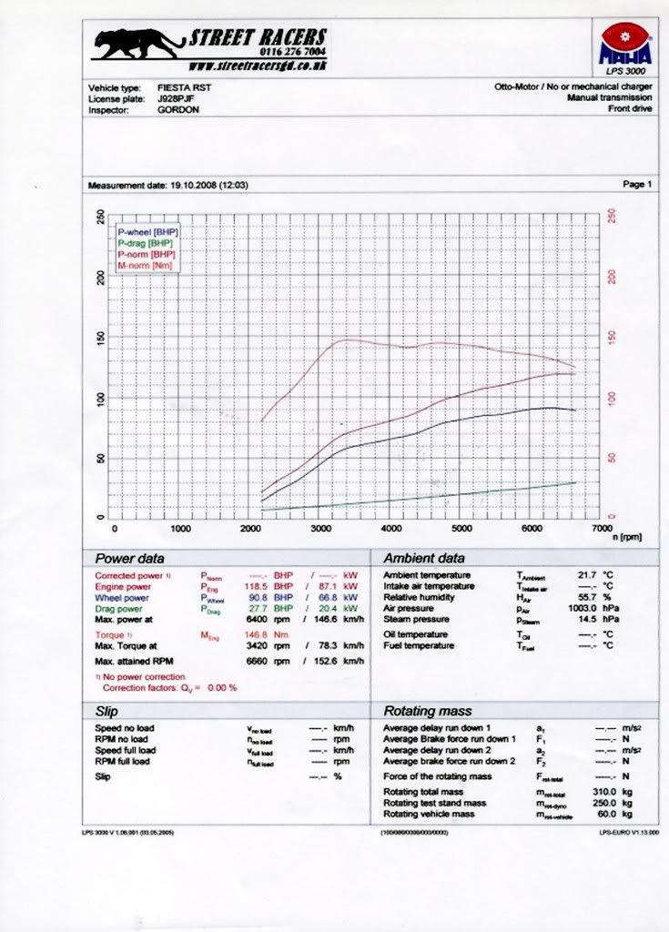

heres mine! hopefully with a decent T3 and new engine mounts and the boost turned up too 10 psi she should make 150bhp! :D

I see a few cars struggled to hold boost
Run from pre-boost revs I see :shock:
Knows his stuff does he??? :0 :0 :0 :0

Nothing like an accurate Flywheel figure :rolleyes:
Should have got him to run it in other gear.
I guarantee it'd have made a different amount :thumbsup:
...but guess what, if it was accurate, it shouldn't :doh:

I still can't get over the fact that he ran cars from off boost :banghead:
