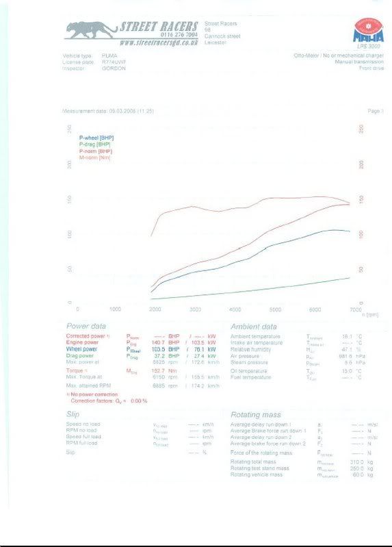

Yes that blurry line at the top is the torque curve......its shakeing like a barsted from 2k+ (has to be flooding......strain under heavy load.... Eeekkk)
Cheack out the power curve though. Tails to a flatspot, dips by about 1bhp, than heads up again by a single bhp...... Then he stopped with about 1.5k rpm remaining :( :(
I was very happy with transmission loss mind, as the LSD certainly does its job :P..........that is if anything can be salvaged from the day :(
But as they say "ON THE NIGHT......." and on the night it didn't really perform. At least I know what needs doing :rolleyes:
