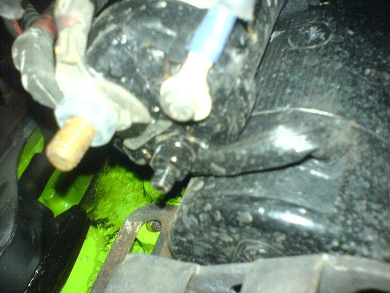

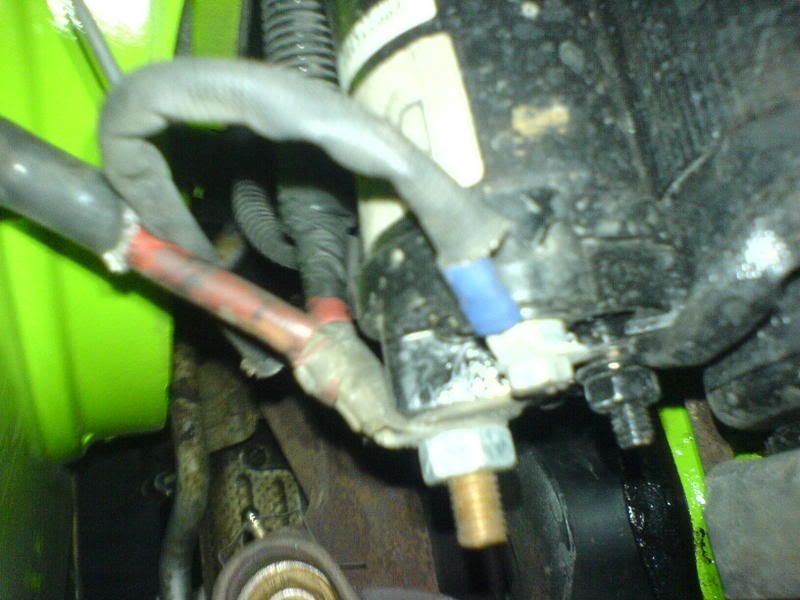

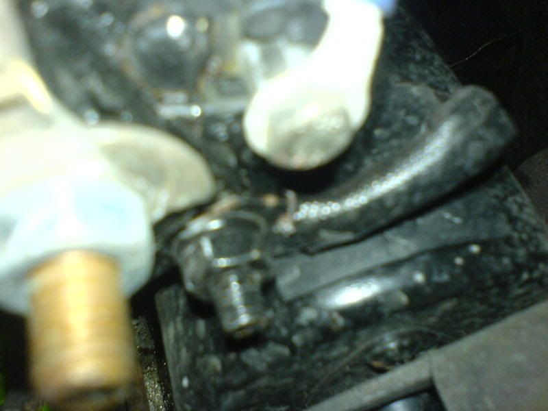

The starter/solenoid is wrongly connected, so havent been able to run it yet, but I think it should work :D

hope pictures help with the wiring mate !! frm onslack !!!
