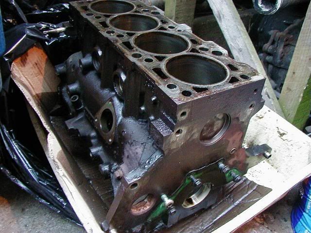

The block has been striped down now so will try and get some photos up at some point.

Here it is:-
Ok dosnt look much now but just wait.... :devil:

good work! looks how it should have been when i sold it :lol: (sorry)
