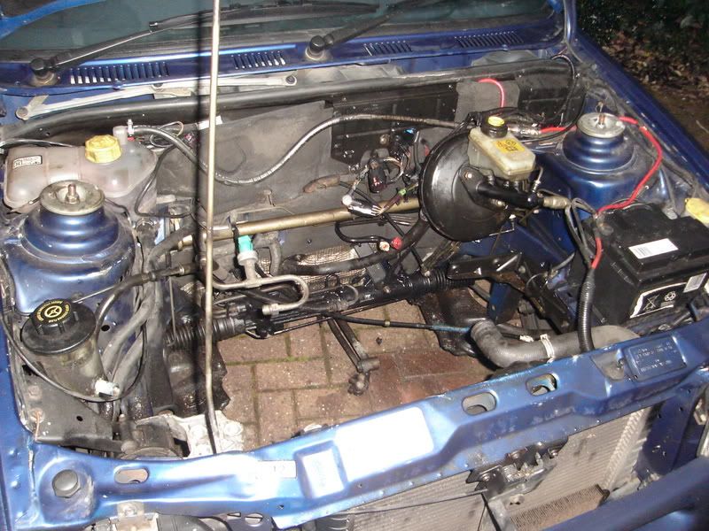

I got the Fiesta back home to Watford this Saturday by towing it the 130 miles with the Sierra, and i then started work. This is at the very begining, note the oil EVERYWHERE
Then at the end of the day :D

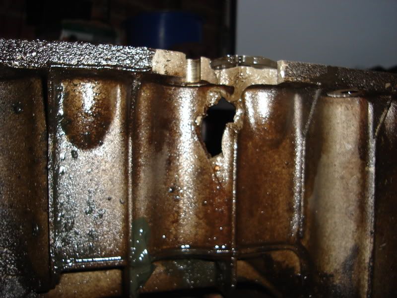

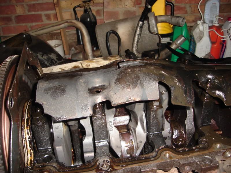

After getting the engine out i started stripping it just to see what had happened and found some interesting things. Most obvious being this nice hole in the sump-

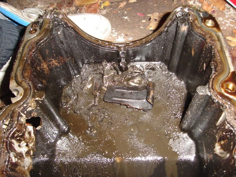

And all this shit inside
It looks like what ever put the hole in the sump gave the gaurd/pan thing a good whack-

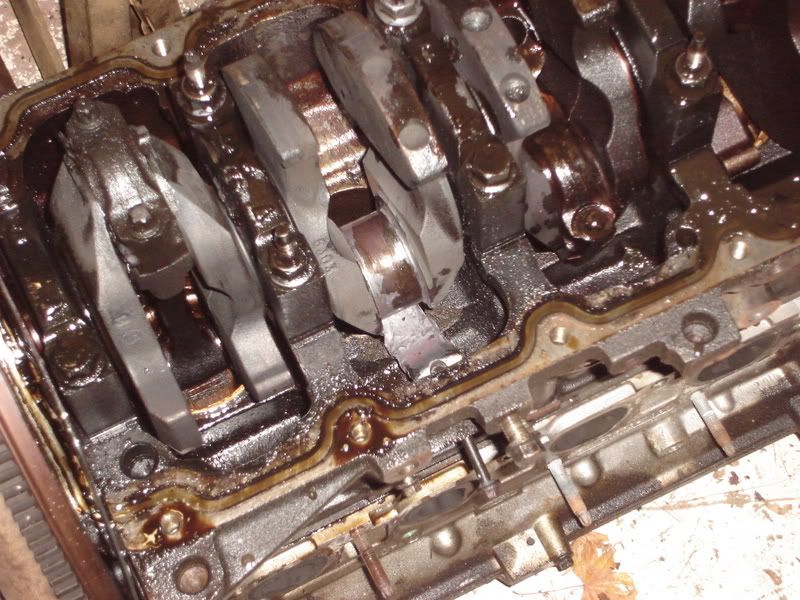

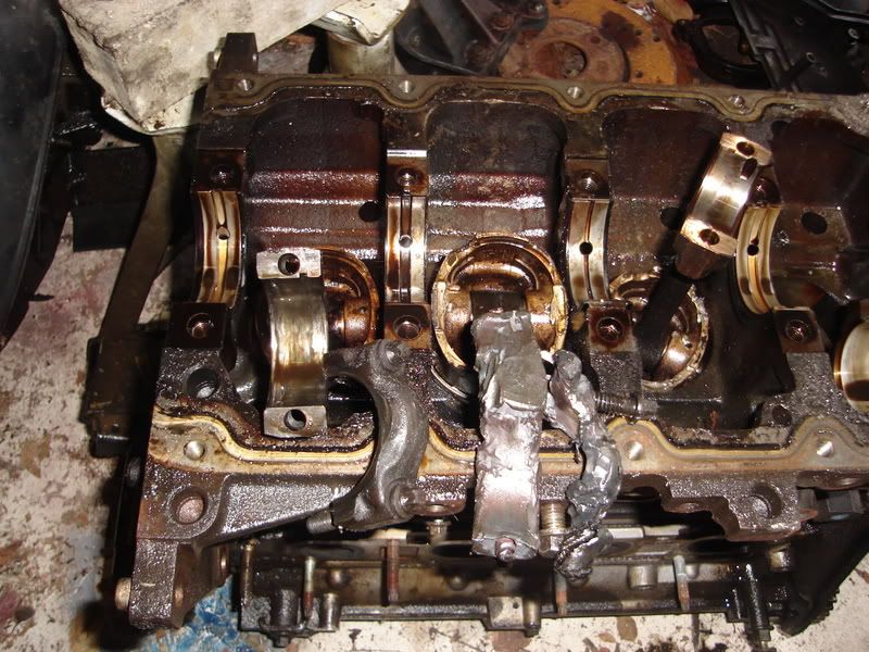

After taking the cover off i could see more crap and the big end cap of no3 was missing, and the part of the con rod i could see looked pretty mangled-
And after a bit of rooting around i found the offending item- :o
That beleive it or not is the big end. Obviously this doesnt help get the project any further, but was just interseting to find out what had happened

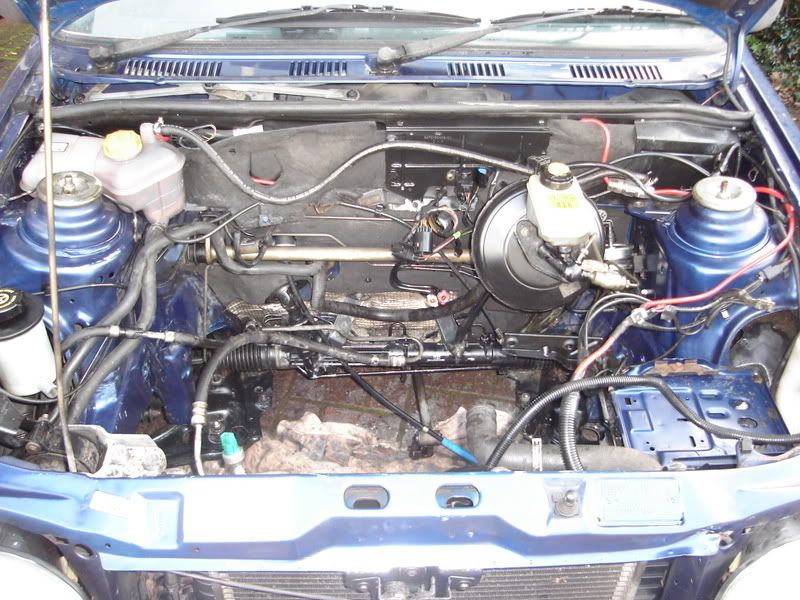

Anyway, small update. I got the steam cleaner and degreaser out today. The bay was covered in gunk and oil from the blow up, but now its looking much better, and should make it a bit nicer to work on.

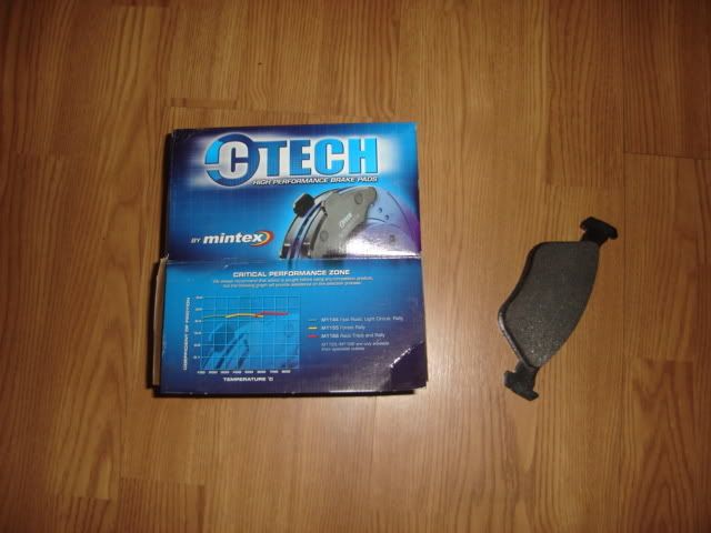

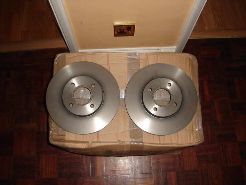

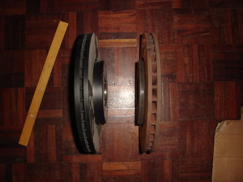

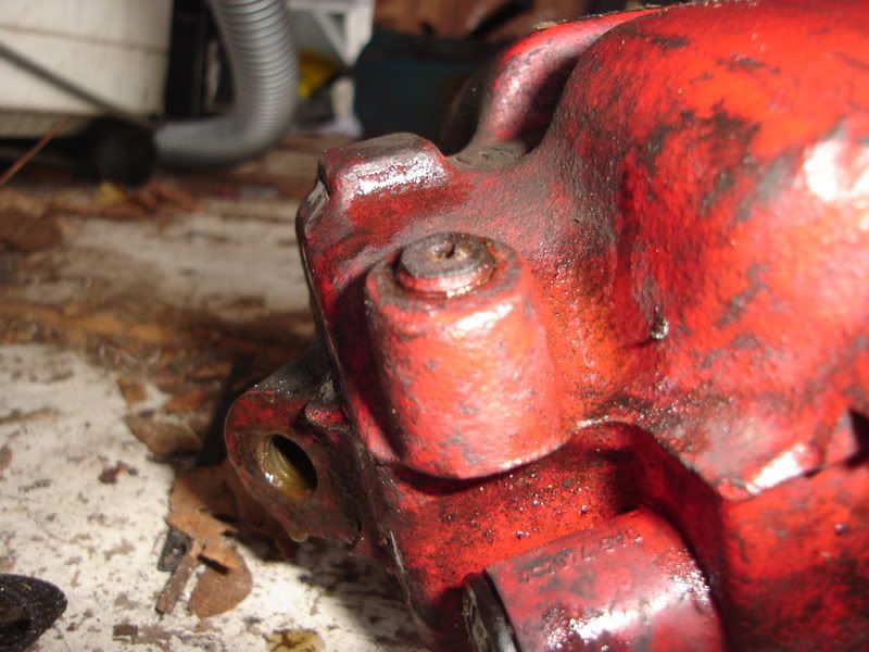

Next up were the brakes. When i changed wheels a couple of months ago, i found that the mk6 RS2000 alloys dived in a lot more so would catch the cossie calipers, meaning they needed spacing out 10mm which i didnt want. So i changed the discs from cossie ones to(brand new Ford) ST150 ones which have a better offset, which you can see in the photo below. Also bought myself some mintex 1144 pads aswell.
Unfortunatley when i did this i snapped the bleed nipple off :( . Ive spent a long time today at it with an easy out but didnt get very far so im on the lookout for one new caliper. Even went to the scrappers today and got a Scorpio cossie one but they are different :(

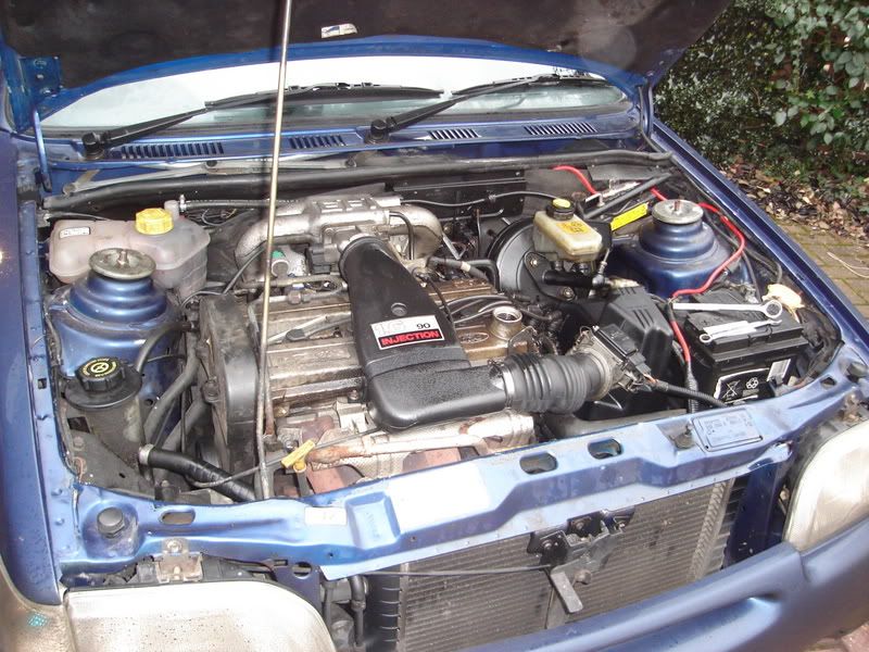

And as i didnt have much else to do i stripped the engine a bit more. Before on the left, after on the right :o
Need to get myself an engine now and start getting it in.

nice clean engine bay gona look real nice once the 2.0's in! :)
PostPosted: Fri Dec 29, 2006 10:36 am
engine bay looks tidy, maybe try tidying wires up etc whilst engines out.
