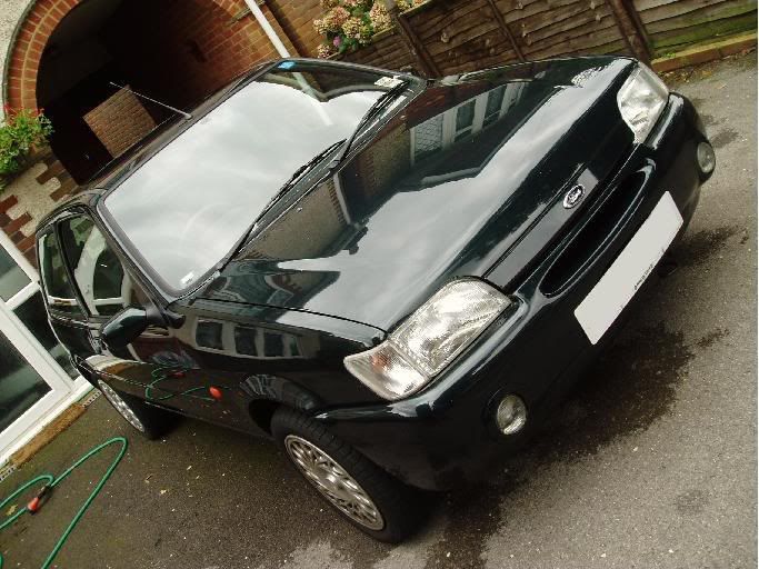

The plan is to strip down my Mk 3.5 1.6 16v Si and re-build it, improving everything really, from the shell (seam welding), handling and braking (coilovers, discs all round), performance (2.0) to general styling. The aim is cover every aspect of the car, no neccesarily making it the fastest or most mental fiesta ever, but to have a good all rounder.
It started life looking like this:
I'd colour coded the handles, made and fitted electric heated mirrors, waxoiled and soundproofed the car and done parts of the underside, among other things. Over the years I've collected most of the parts I need to carry out the 'main' work. Wheels, suspension, brakes, engine, seats etc I will post pictures of these when the time comes.
