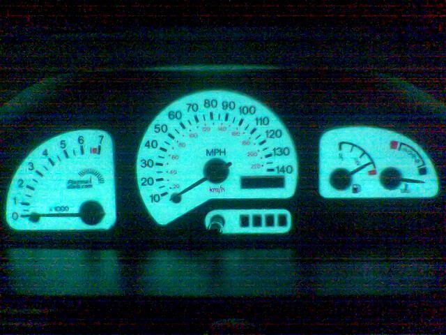

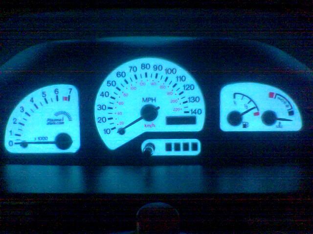

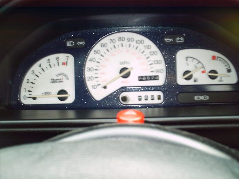

Plasma dials are in!! Only took about 35mins to do, but took about an hour to mask off the back and spray galaxy blue with a gliter Lacquer
Have Given here a good clean and a wax too

Not all, just quickly get the multi-meter out, turn the lights on to find out which one is the power going to the dials, chomp in to it, and the same for the earth!!!!(there is only two wires to connect) the dials individually have a single wire coming off of them..(power)..so i had to drill a little hole in the back casing of the dial housing to get them out, these have quick connectors on them which just connect to the plasma control box wiring loom, even a monkey could it! :wink:
