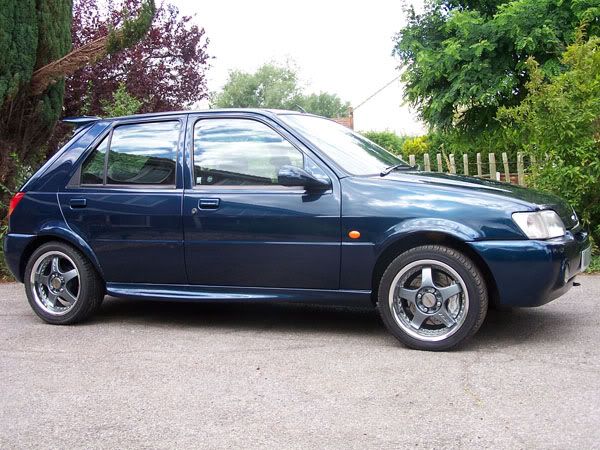

My 2.0l SI

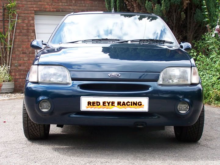

looks good mate, another 5 door to add to here also
maybe could go a touch lower
nice bonnet mod in one of those pics 8-)

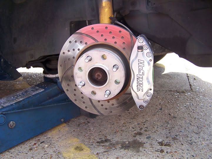

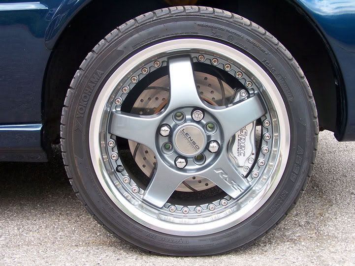

Brakes are from Hi Spec Motorsport 01322 286850 there based in Dartford Kent, uses 4x4 cosworth discs, with a 4 pot calipers, they work well, you need at least 15 inch wheels for the calipers to fit, however cause my wheels have a deep dish, ive had to use 20mm wheel spacers to get the clearence, the reason i havent lowered it, is i`am getting alot of rubbing on the arches as soon as i get one of my fat mates in the car, ive rolled the arches but need to take alot more off, then i should be able to lower it
http://www.hispecmotorsport.co.uk/

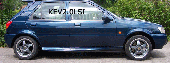

not being funny mate............it is a clean car but £3500 that is a bit steep and you will never make money on an engine transplant in a fiesta.
PostPosted: Wed Oct 18, 2006 9:01 pm
ive spent shedloads on my Fiesta but dont think i would even get anywhere near £3500 for my car
PostPosted: Wed Oct 18, 2006 9:09 pm
Wouldn't pay 1500 for it, nevermind 3500! :lol: :lol: :lol:

if thats what he feels it should sell it for then so be it. the price will come down when he realises it aint selling.
good luck though dude, you'll need it.
it does look tidy though, but the 5-door matter might put some off.
