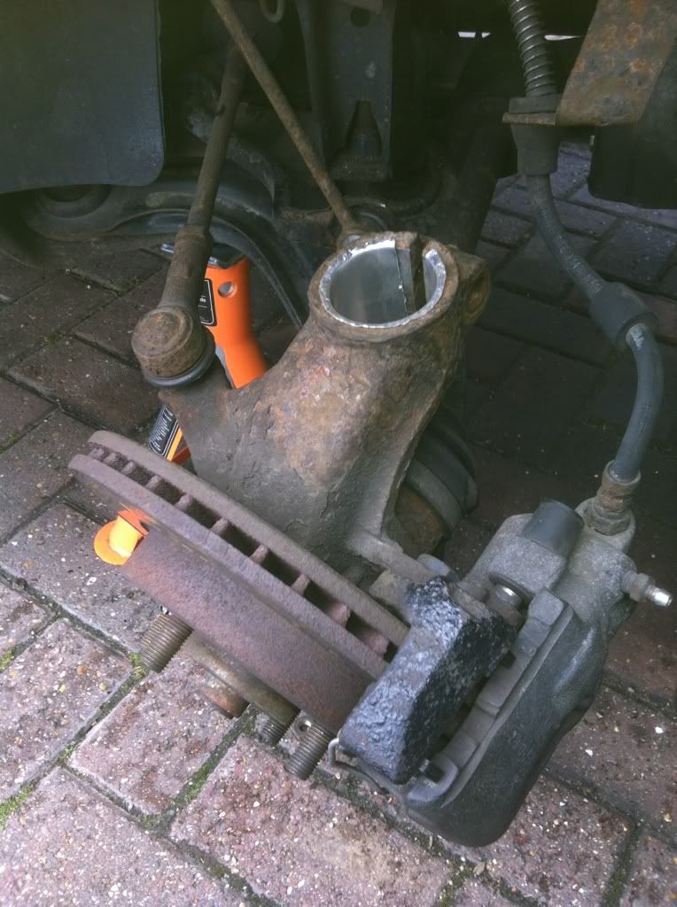

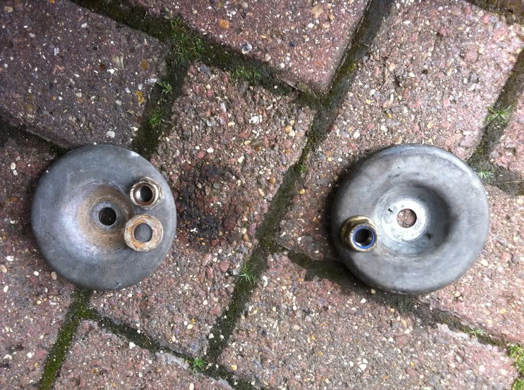

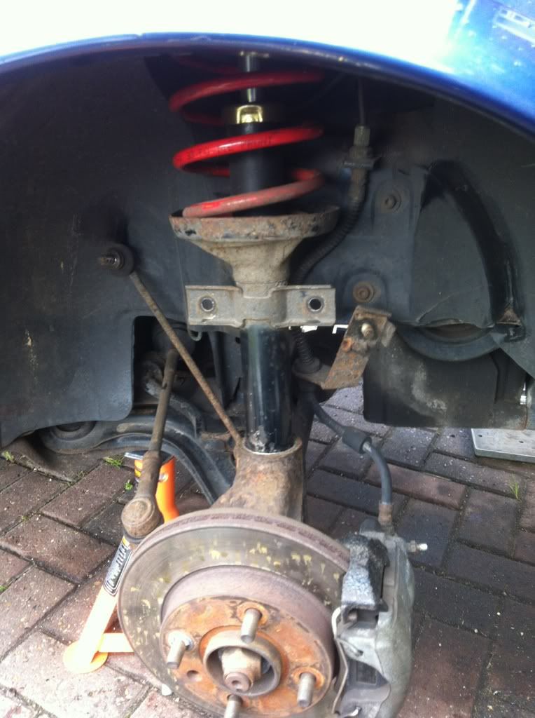

Today after pulling a sickie at work i fitted mk3 shocks to my mk3.5!

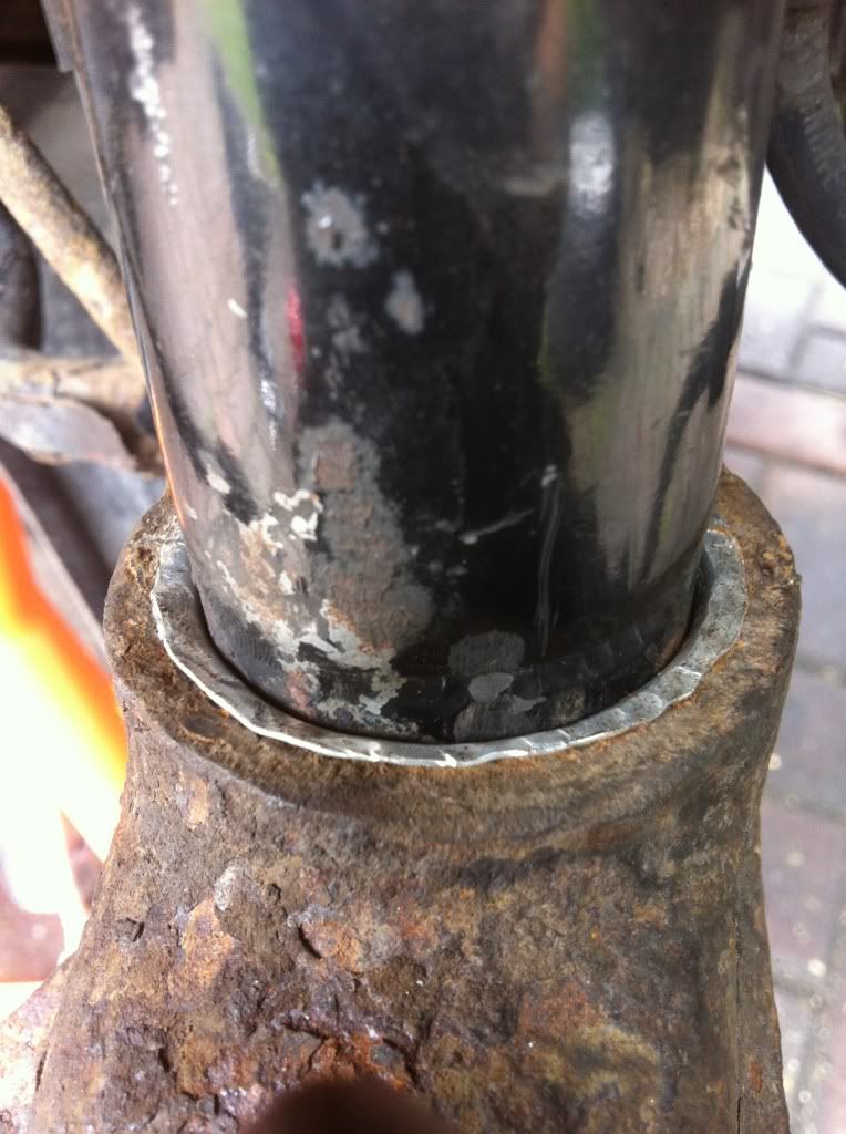

took some pics for everyone to have a nose, i made a 0.6mm shim and its in there seated nice and tight :)
by the way you need mk3 top suspension cap, and bolt and washer as its a slightly bigger thread than the mk3.5!
^perfection!
