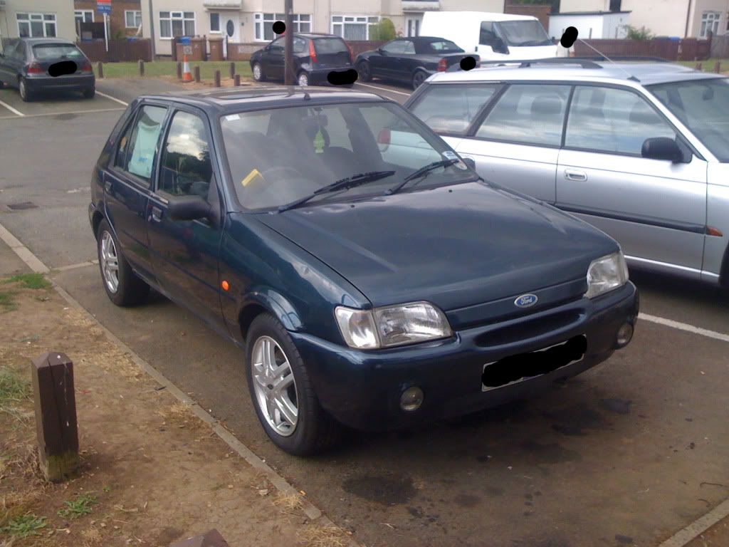

However, seeing as I love MK3 fiestas I got another one, an SI. When I bought him he had lex-arse lights, M3 mirrors (why have these when you need to wind down the window to adjust them!? And they shake like mad above 15mph so you can't see anything!) and had generally been mistreated by a couple of chav owners.
I used my old car as a donor because this one had no electric pack, the very basics. So that was the first thing done, including swapping over the PATS box. Next I set about swapping the suspension out for new parts, new front and rear shocks and springs, wishbones and a few other bits.
After 6 months of owning him it was MOT time. And boy did he fail. Emissions, brake lines, rust, brakes. There was a lot of work for me for two weeks before the retest was due. So new brake lines put in, everything cleaned up engine wise for the emissions, new brake discs and pads, rust cleaned up, new Cat. The MOT tester was a bastard and after making me wait like what felt forever outside he pretended it was a dangerous car.

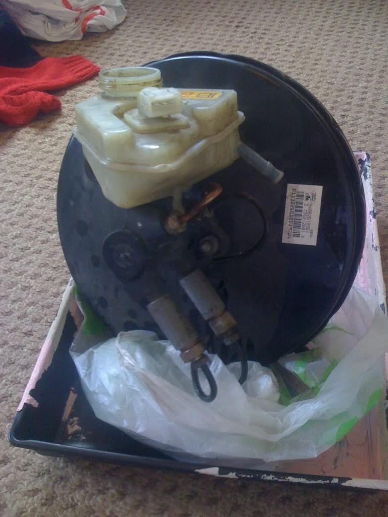

A MK1 Mondeo Servo and Master Cylinder. No ABS feed and a blocked off hydraulic clutch line.
Recognise them? Yup, ST24 discs and calipers. I didn't take pics of the spacers, but these fit straight on with 5 or 6mm spacers ground down to a 130mm diameter and the mounting holes on the spindle carrier drilled out to 12mm. You will need longer studs to do so, especially if you have to further space the wheel out from the disc. Problem was I had a broken Bleeding Nipple on the drivers side. Took me 4 days of work on this to sort out due to lack of tools and experience for this kind of job. I had a panic when I finally got the new one in and the whole thing fitted to the car. Got my pressure bleeding kit out (I get funny looks when I have a wheel on the engine) and did a test bleed with some old fluid I had, wasn't going to waste the genuine Ford stuff until it was ready ready. I got some signs of fluid coming out, then nothing. Tried it a bit more, still nothing. Thought sod it, do the other front wheel to check while I think of something. Air popped out of this one, then fluid came out, ran it a while, job's a good'un on this side!

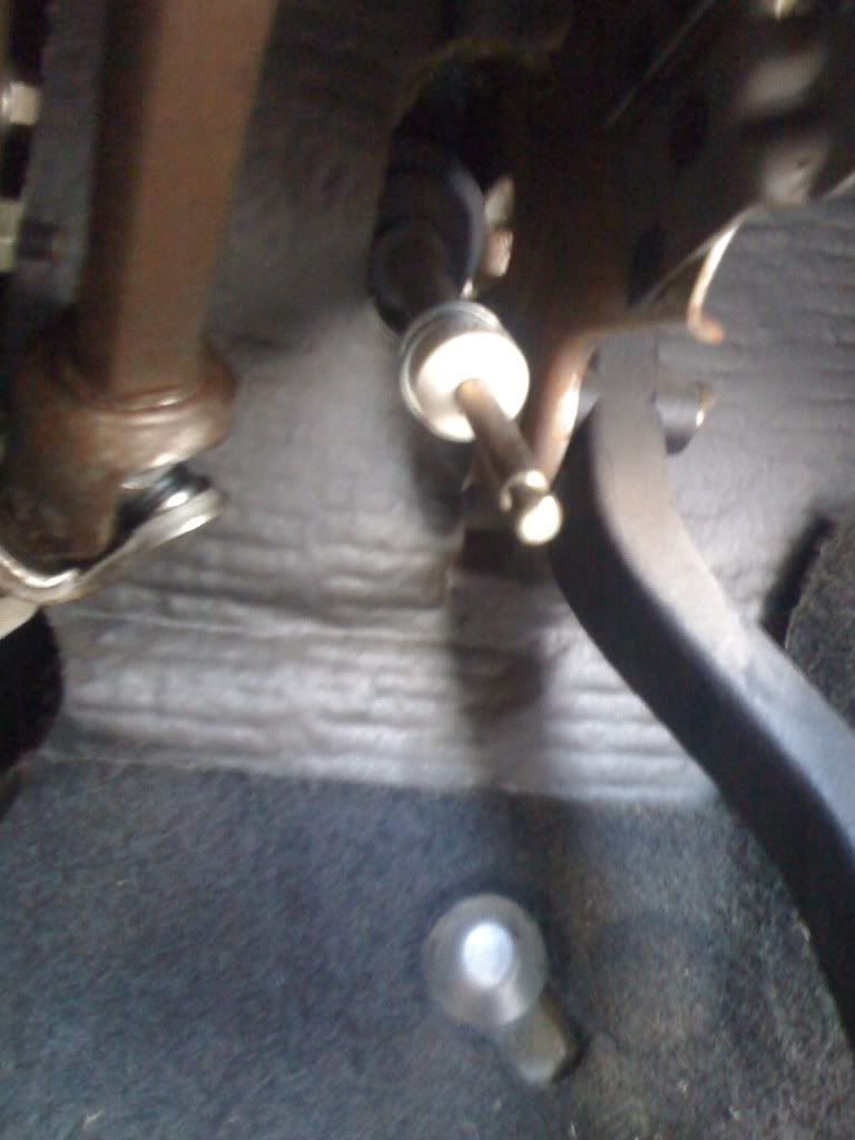

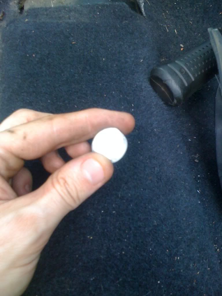

After doing the brakes I was seriously not happy with the brake pedal position and it's feel. It was at least an inch lower and there was another inch of weird travel after that. I suspect I need to bleed them again with some air but that really really doesn't explain a lot of the movement, especially as it was like that before and now with a new servo I should be feeling the pedal movement differently.
I got started on thinking about why the pedal was lower. Basically the servo pushrod is shorter than what it should be and this translates into a much lower pedal. It sat about 1 and a half inches lower than it should be and had a side effect of revving the engine too much as your right foot adjusts to which pedal is lowest! Not good and makes you look noobish...

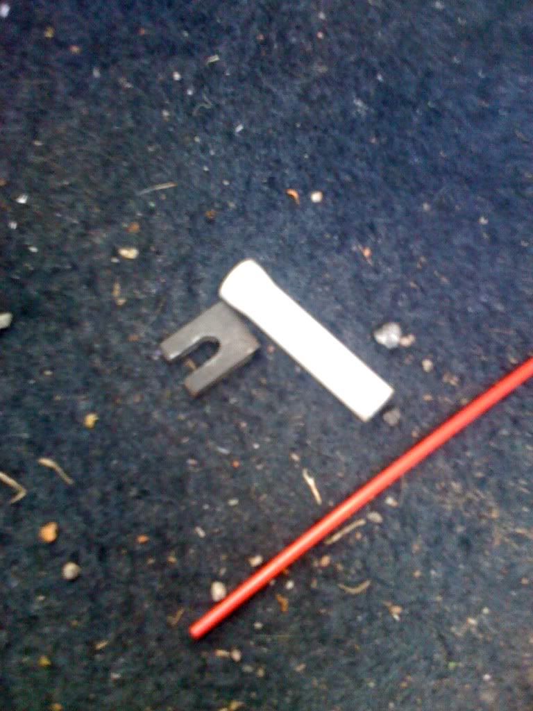

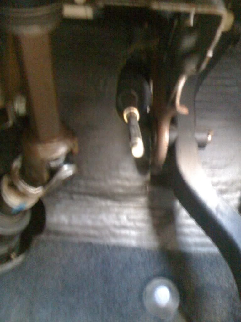

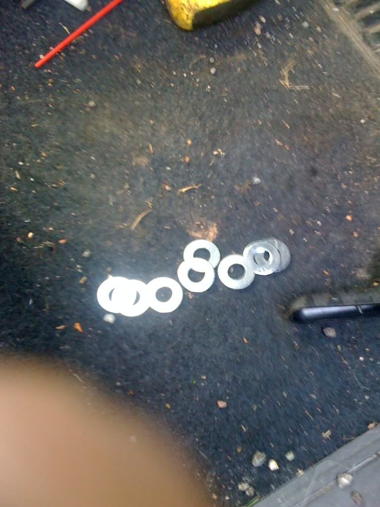

Now the brake pedal is actually quite simple in how it works. The pedal itself hinges on the main box bar. The pedal has a split near the top to let a rod come through it, and the pedal pushes on a bush that pushes on a wider part of the rod. I noticed not long after the servo mod that the pedal had free movement upwards upto where it hit the retaining clip.
So here's a little picture collection:
You need some washers, preferably slightly smaller holes than this but these will do. I'll measure the rod size and buy some proper fitting washers tomorrow.
Pull this black clip off and then the white spacer behind it.
Now remove the pedal by removing a very hard to see clip on the right hand side of it, then push the bar towards the passenger side just enough to get the pedal off. Remove the white grommet thing off the push rod behind the pedal.
This is what you should now see:
and this is the white grommet thing:
Put the washers on behind the white grommet thing:
And this is the finished pedal result:
All pretty much level with each other, I've raised it past the soft feel too so the hard point is much higher on the pedal. The first white spacer has to be cut back to the distance you've spaced it out, but other than that it's nothing hard to do.
Problem is I haven't refitted it all properly yet, I can't get the pedal box bar back in place!! ARGH!
