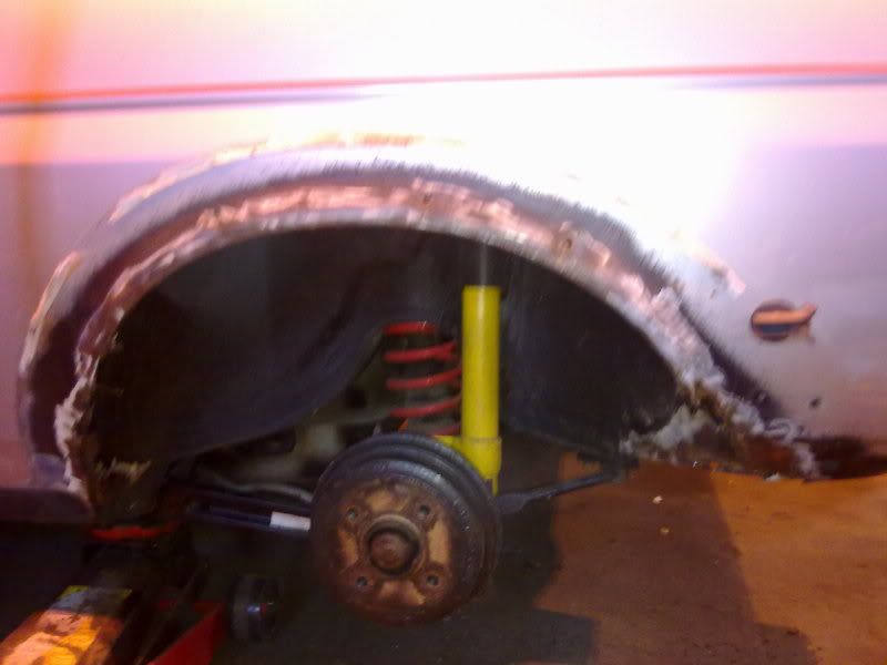

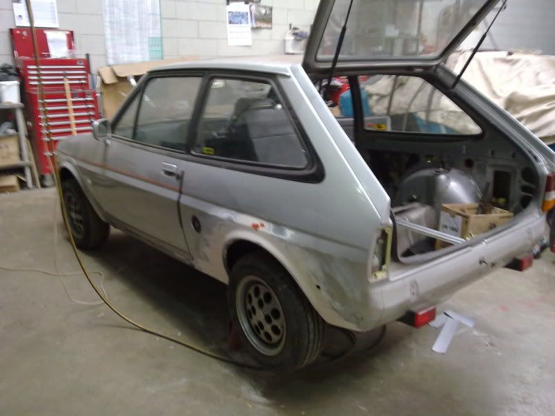

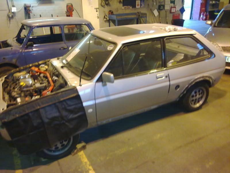

heres the current state of the car

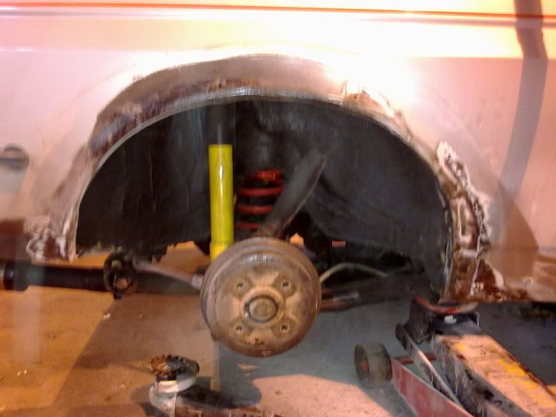

there is some rot on the rear arches that was hidden behind the body kit
the arches have been replaced in the past but not done very well as there is a ton of filler blending them in
so they will both be replaced
other than the rear arches the body work is in very good condition

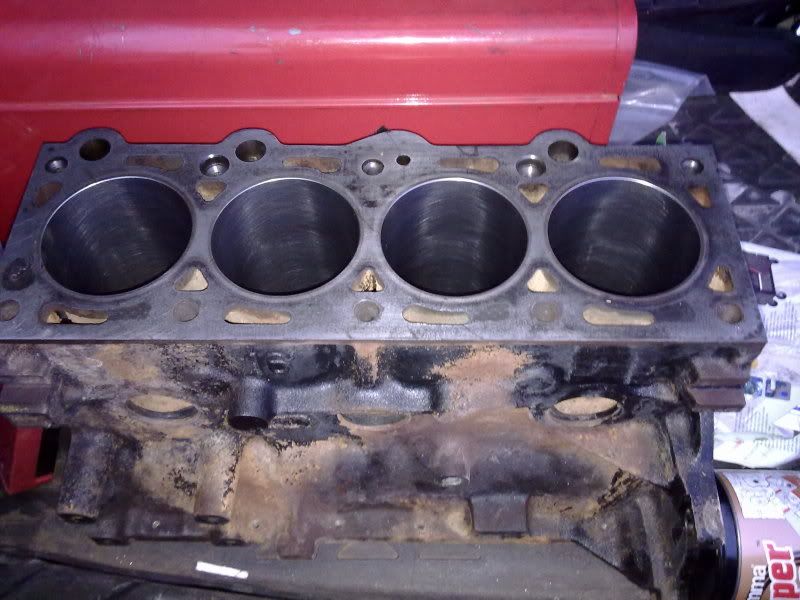

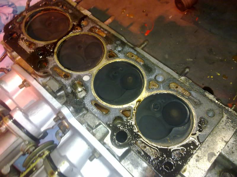

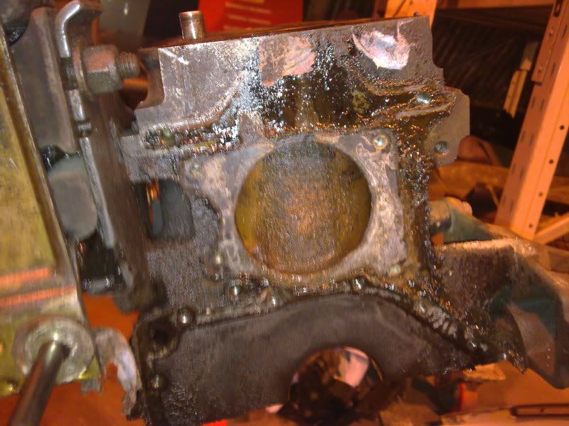

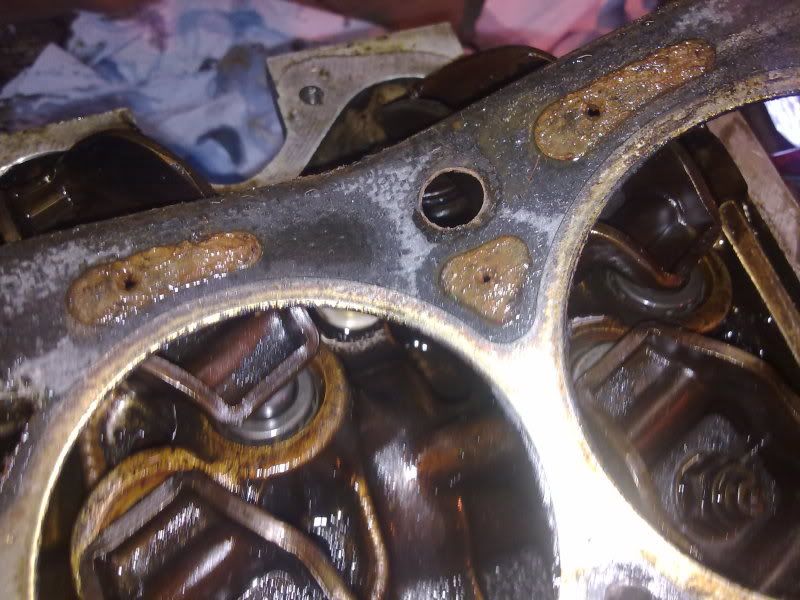

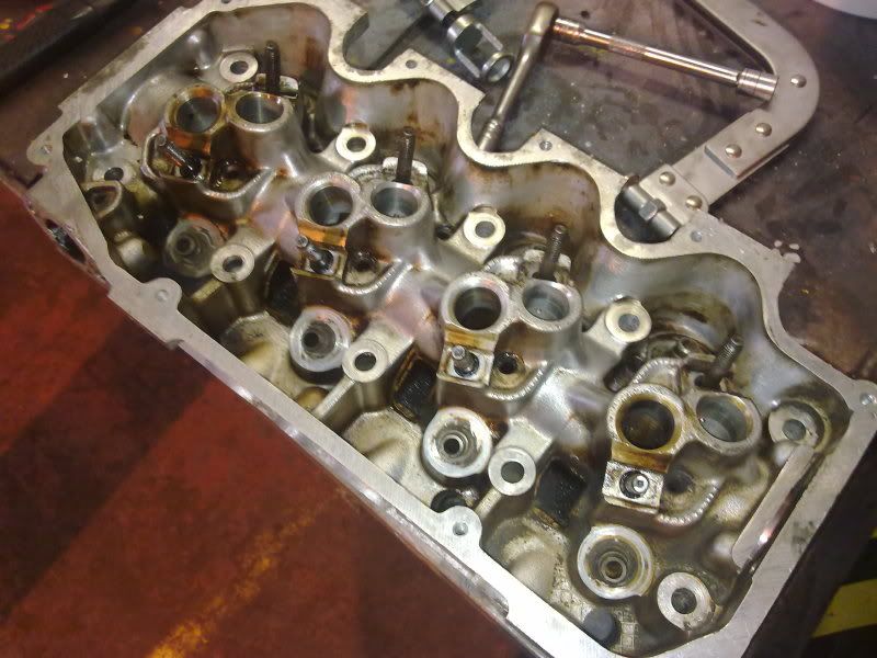

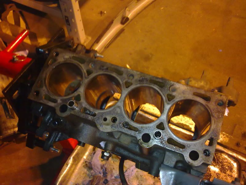

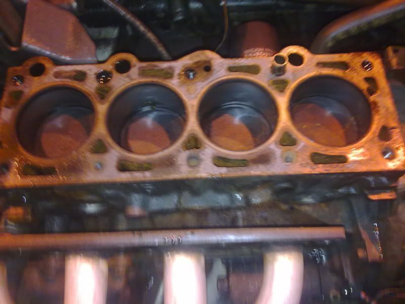

having checked the engine number it still has the original enge with 99k on the clock

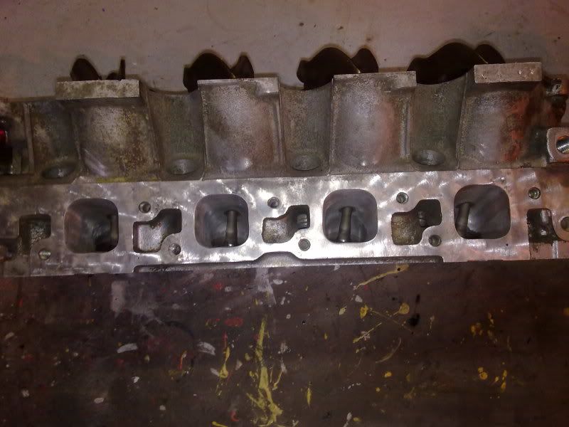

the valve stem oils seals are in need of replacing so i thought id tae the head off and have a nosey at the bores etc
it was a lucky thing i did
as you can see the water ways have become very gounked up with corrosion and crud with just the small holes in the head gasket letting any coolant to the head
how it didnt over heat i never know
but on the plus side all the bores seem to be good
but i will be doing a bottom end strip aswell as i want to give it a good clean and inspect
due to the crap coolant when i took the thermostat housing ou i found the stat was corroded into the housing so i had to chisel it out
hence why i now need a new stat housing ans its knackered

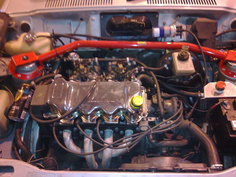

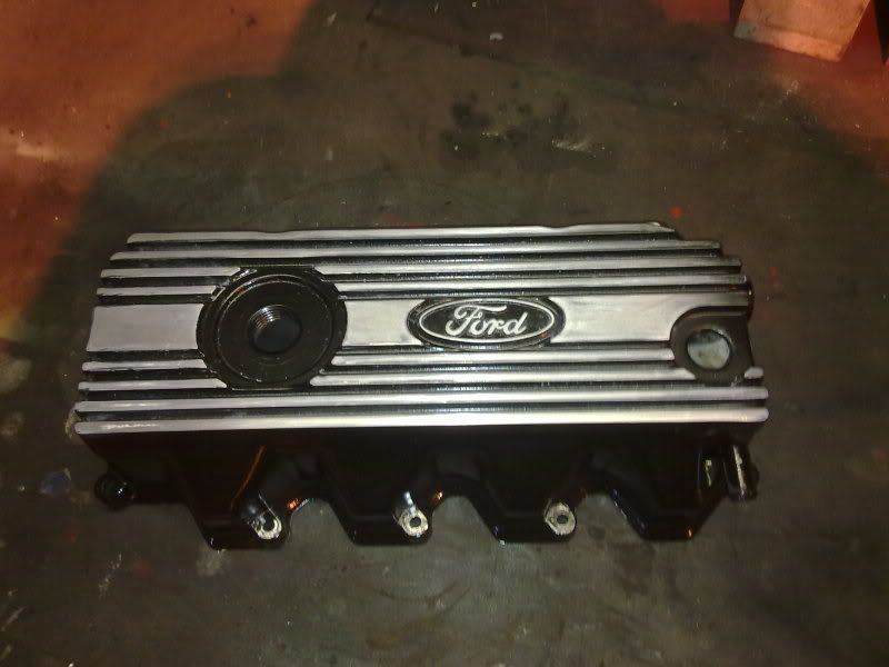

heres a sneeky of my rocker cover that will go on

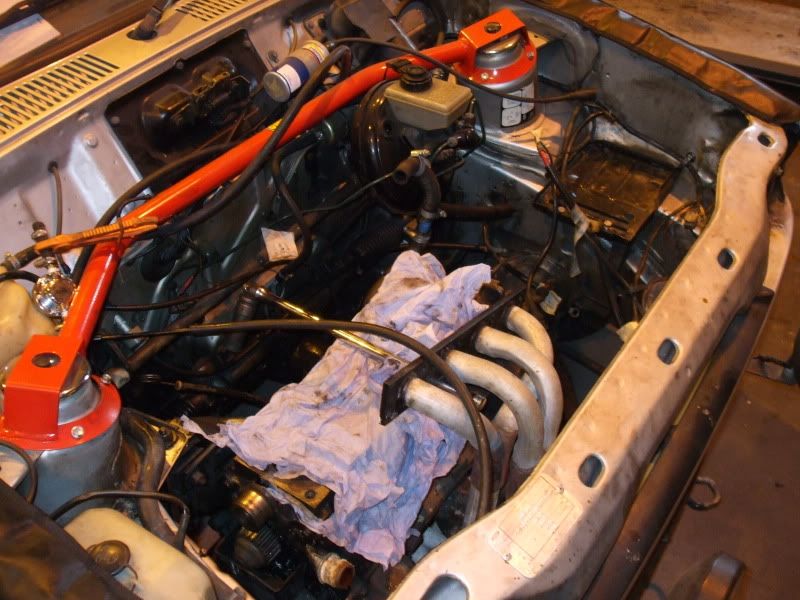

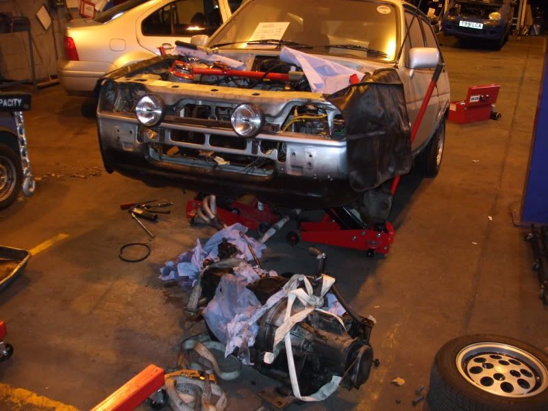

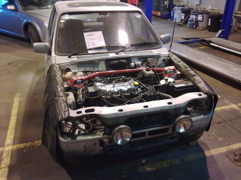

bit of an update today

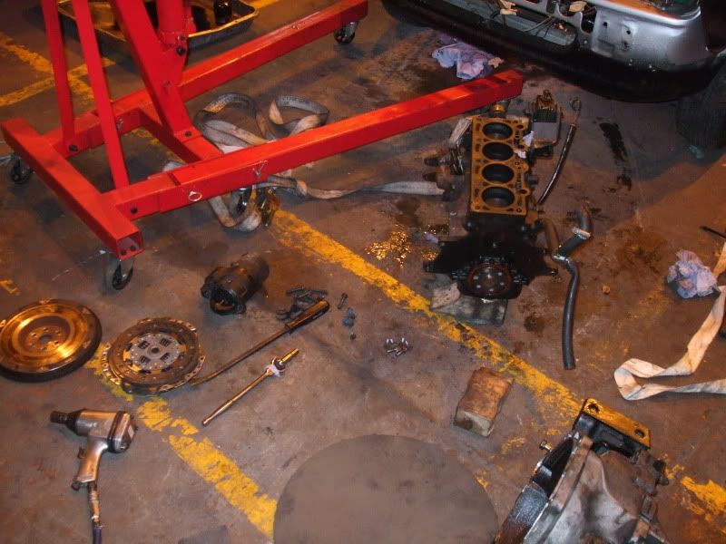

took the rest of the engine in prep for it to go to the body shop and the engine rebuild
plan for it now is hopfully it will be going to the bodyshop the next couple of weeks
the head, crank and fly wheel will be sent off to get worked on
the block will be stripped down this week
all came out very easily apart from one bolt holding on the alternator

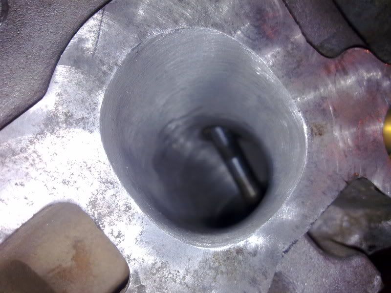

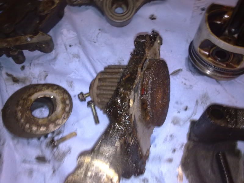

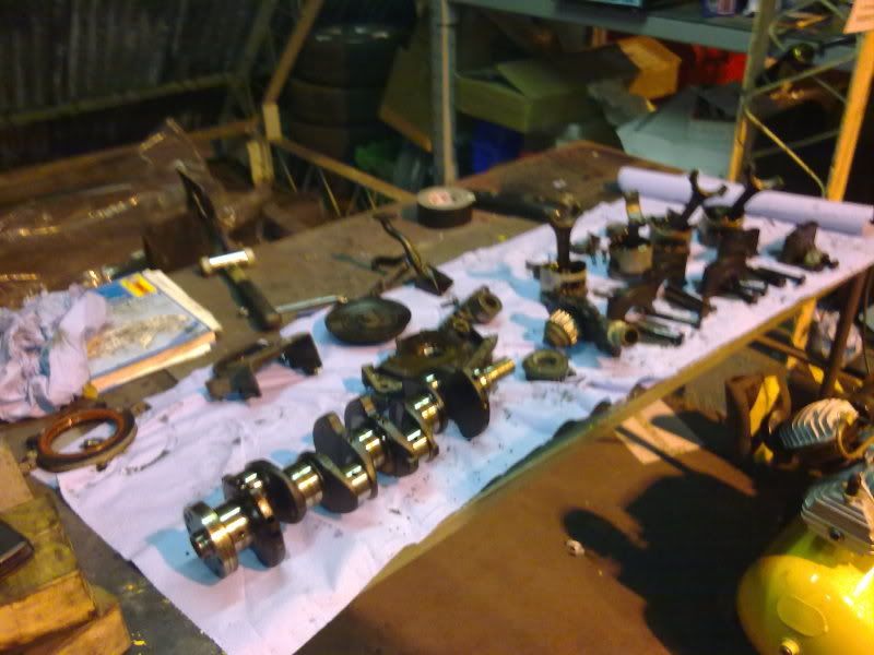

stripped the engine down
water pump has seen better days really gunked up and corroded

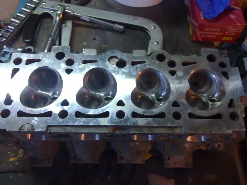

next step im sending the head off for ported and polishing
and the crank and flywheel for lightening and balancing

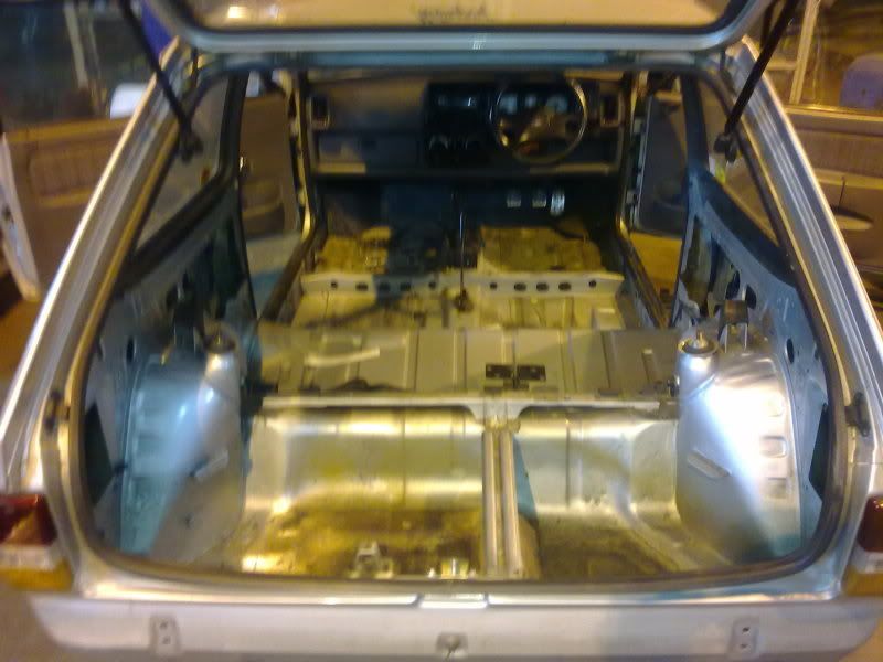

little update today

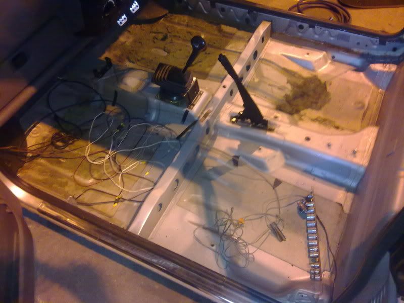

stripped the interior out today for its trip to the body shop today
no major nasty suprises floor pan is all solid and the first fiesta ive had where the floor is soaking wet froma water leak

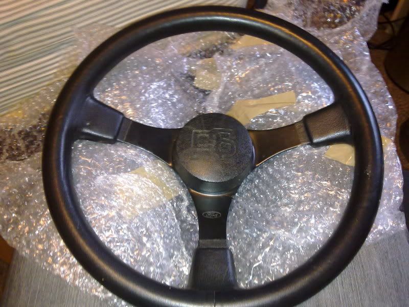

but i have got this through the post yesterday

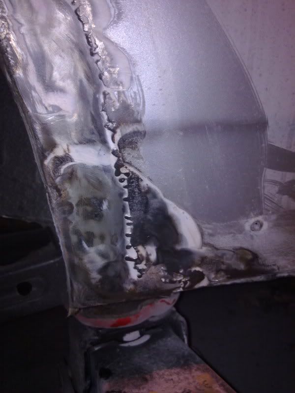

couple of little updates
the car is still in the body shop but its not far off paint now

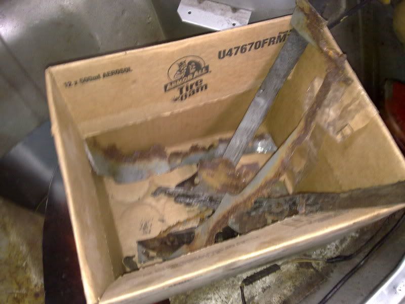

when they removered the o/s arch the body shop found that most of the inner sill had rotted away so that had to bereuilt which has taken the extra time
this is whats left of it
basically in ford infinite wisdom the drains for the sunroof just go straight into the sill with no where for it to go
hense why sills rot out so quick and its not just mk2 3/4/5's are the same as are other fords of the same eara
but luckely the body shop will be modding it so the drain acctually leavse the sill

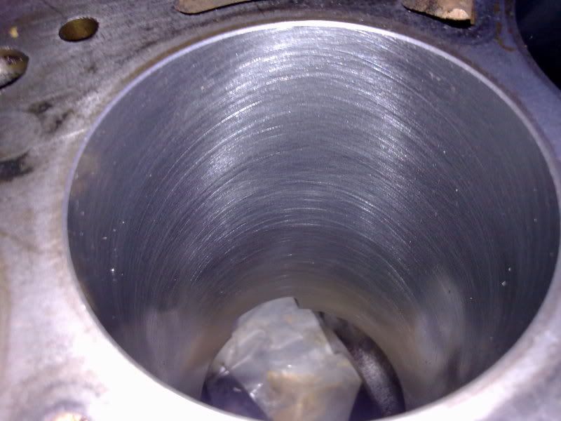

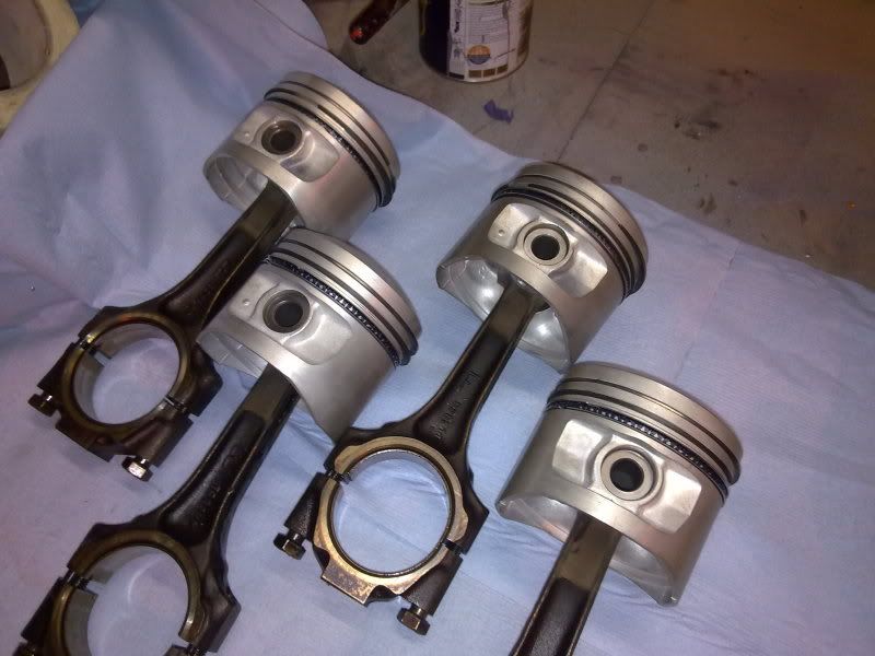

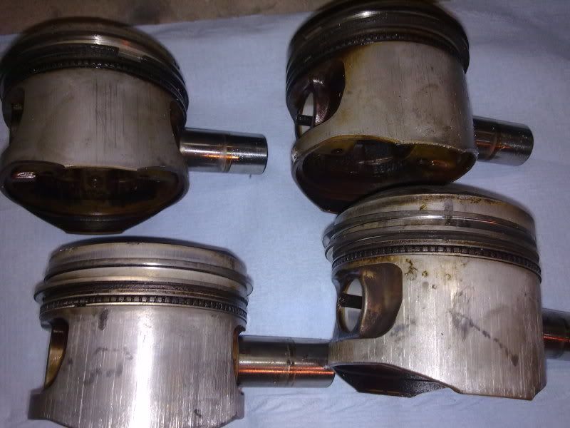

also got the engine back from the machine shop
its had a 0.5mm over bore and a new set of pistons rings and gudgon pins aswell
will get pics of that tomorrow
 Post subject: Re: my mk2 xr2 rebuild
PostPosted: Fri Apr 08, 2011 9:20 pm
Posts: 872
new shiney pistons
knackered old ones
you can see the vertical scoring on them
block bored next on the list
get it in the parts wash
new core plugs and painted

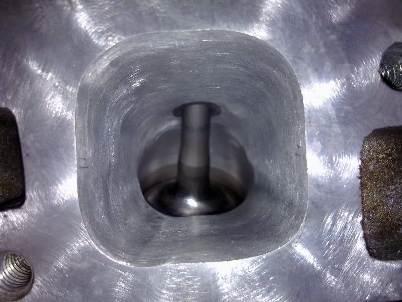

little bit of a update
been doing alot of cleaning and painting over the last week of little parts engine block etc

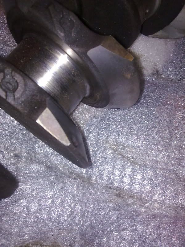

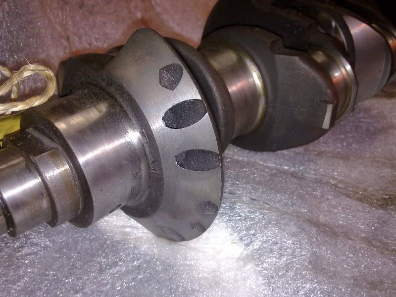

got back my crank and head today
and the head stripped back down for cleaning
PostPosted: Wed Apr 13, 2011 10:55 pm
Posts: 1442
Location: pimpworld
:thumbsup: lookin very good
has that crank been balanced then?

Posts: 872
yup lightend and balanced

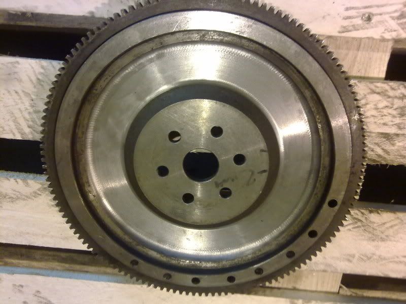

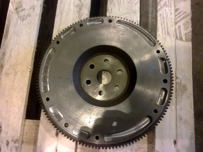

PostPosted: Mon Apr 18, 2011 8:36 pm
Posts: 872
not much happening atm
got my flywheel back today
leightned and balanced
