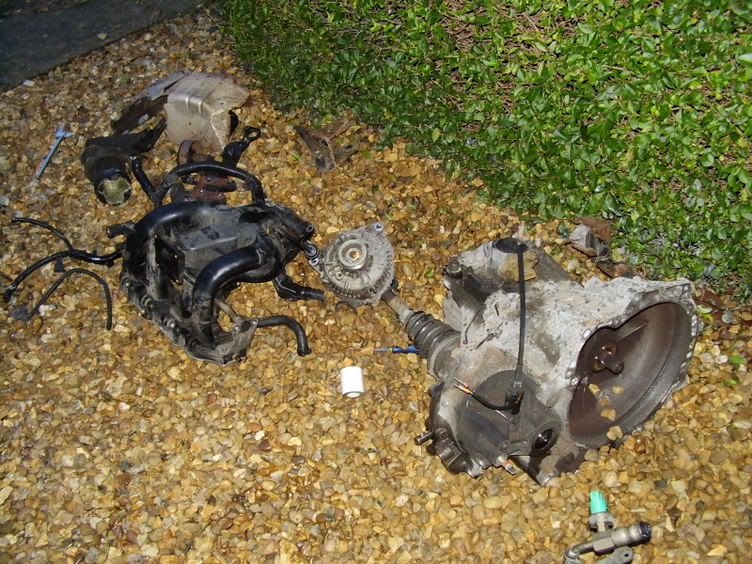

Here are some photos of the removed parts:
2.0 Gearbox
Random parts such as the remains of the mondeo engine loom, bits of driveshafts, inlet manifold, alternator and the gearbox again:

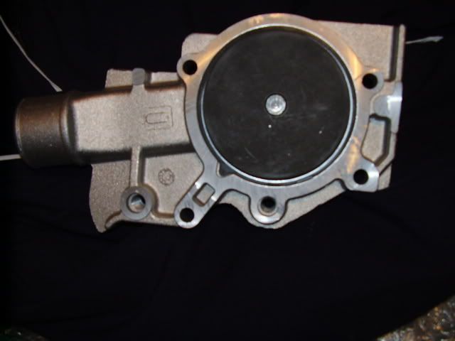

I then purchased a brand new waterpump from ebay for it, for 25.00 -

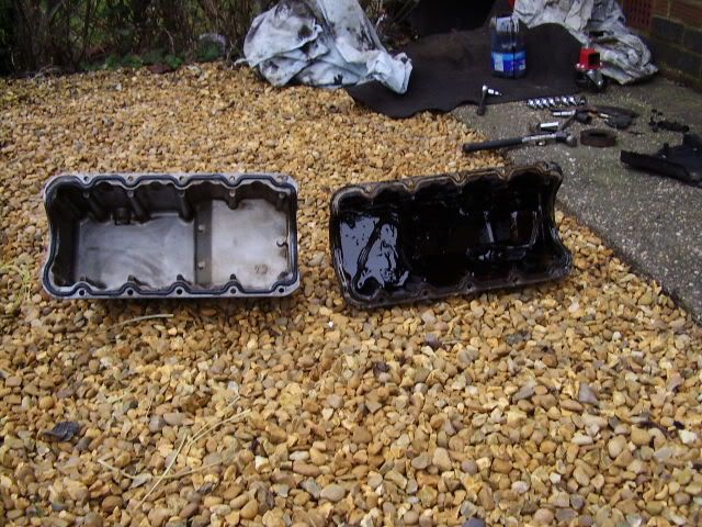

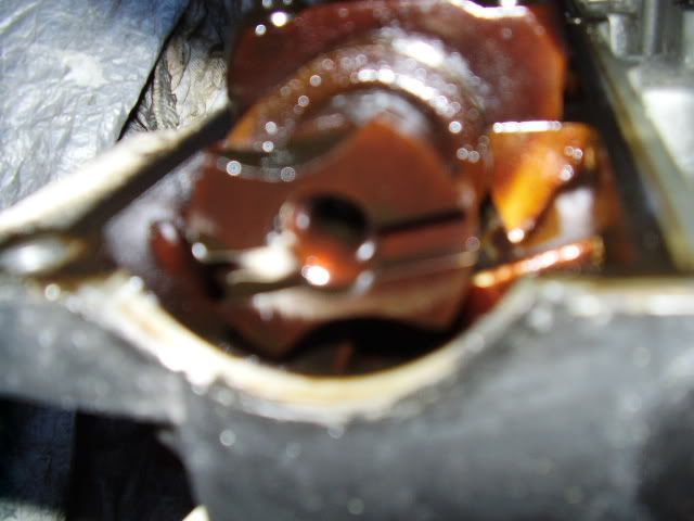

First off i drained the oil from the 2.0 engine, and removed the sump, if you havent taken the flywheel off yet like me, its a bit of a bugger to get off, i ended up finding two 8mm bolts and removed part of the lower metal gearbox gasket, the 2.0 sump then came free -
Pictures of the 2.0 Mondeo Sump next to the Fiesta XR2i 1800 16v Sump -

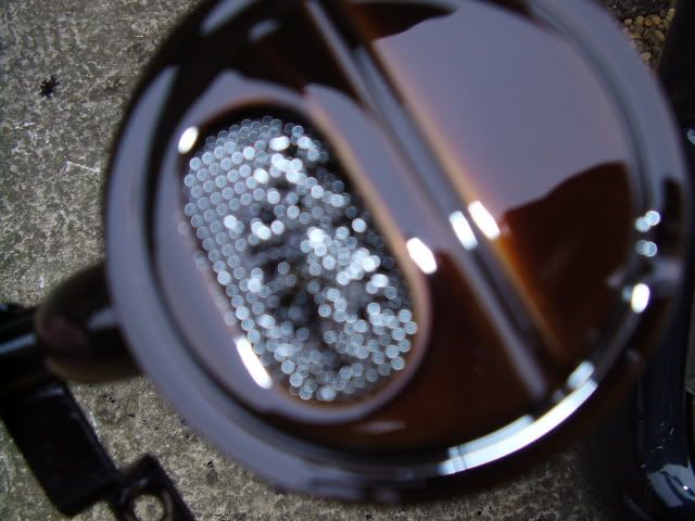

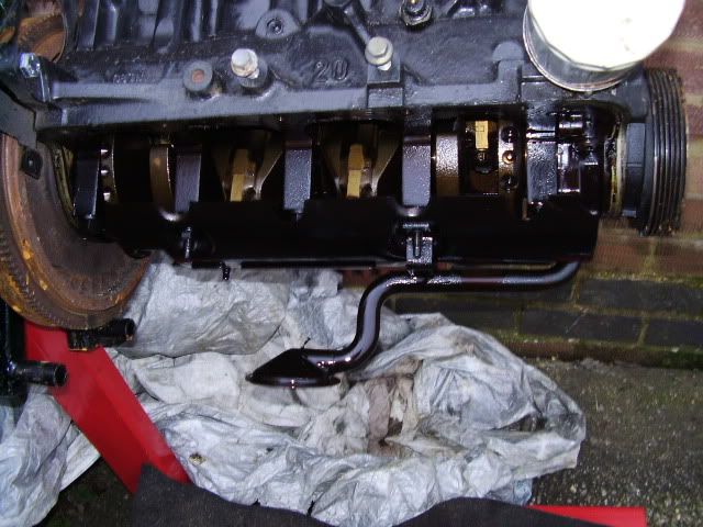

I then removed the Mondeo 2.0 Oil Pick up pipe, this was held on by 2 13mm nuts and 2 T30 Torx bolts -
Look at all the crud in the strainer !!

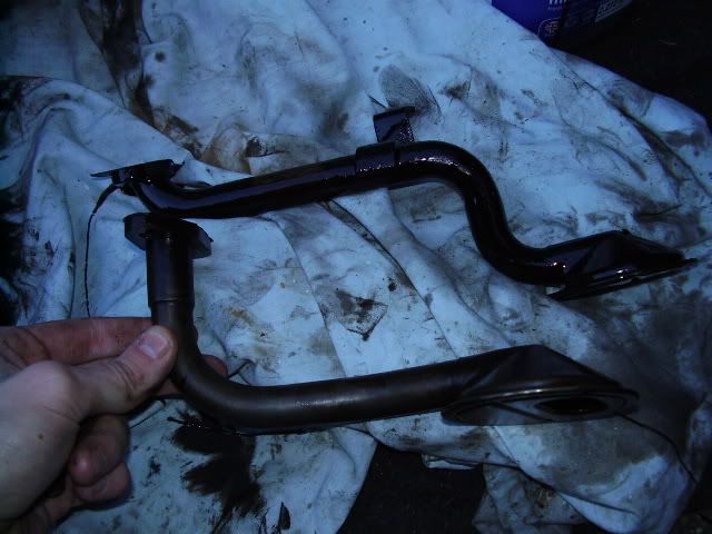

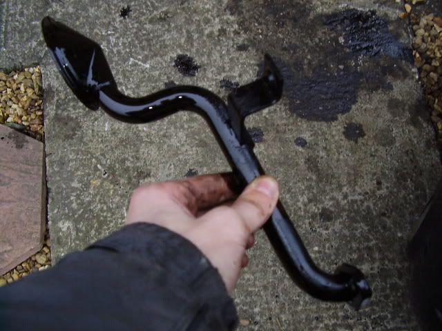

Today i reicieved my 1.6 Oil Pick up pipe in the post :
Here it is compared to the 2.0 one, ( the one im holding is the 1.6 one )
You may have noticed, the 2.0 one has a bracket in the middle, the 1.6 doesnt have this bracket as it is smaller.

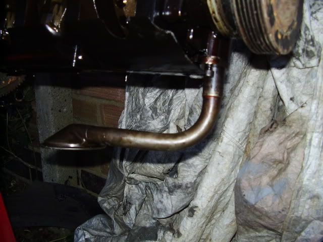

Remember those 13mm nuts i removed from where the 2.0 bracket attached? I refitted them back in place where they came from too :
The fiesta 1.6 oil pick up pipe in place :

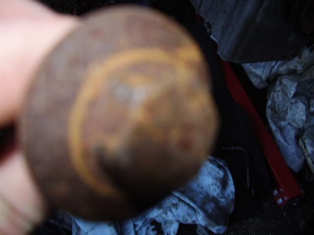

I also got the crank shaft pulley bolt off today, what a complete cunt, ended up bounced on a spade, i got the handle of the spade over the end of the ratchet handle and jumped on it 3 times, the engine nearly fell off the stand !! But its off :
The offending article removed:
