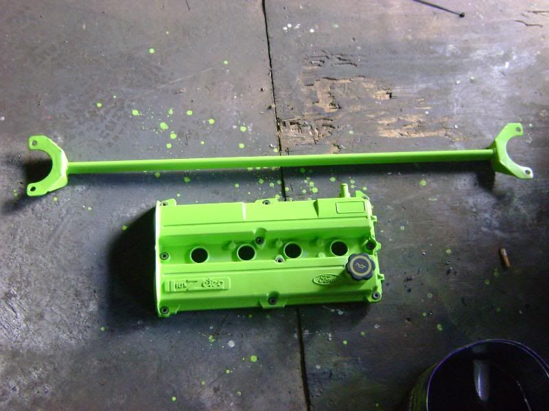

Front and rear strut braces, roll cage and rocker will be this colour, was looking at those hoses for sale recently but thought it would be bit green lol. Plus there not my top priority at them moment as i have a FRST thats getting treated to a 2.1zvh when this ones finished.

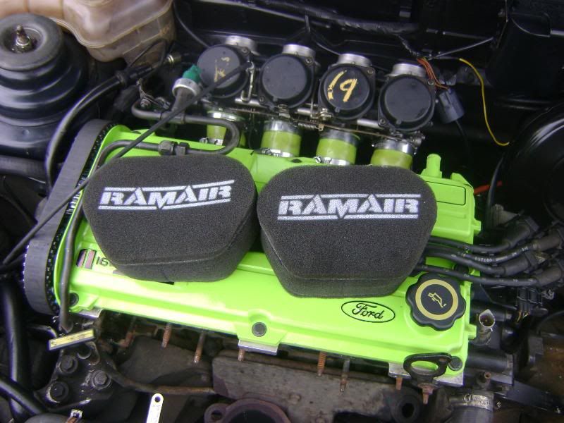

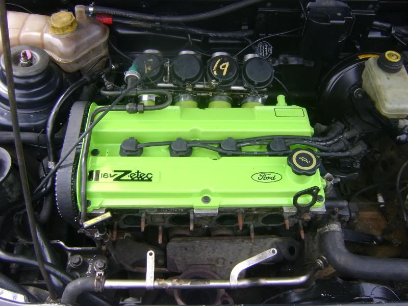

Cheers guys, spent quite a while looking into things and wanted to be slightly different than the normal 2l injection route. Ive some of these bits fitted to a differnt car in the past and it worked well as a 1.8 so should be good with the head/block mixture
Spent a few hours on the car today and got a few bits done. Dont have and pics really of what it looked like when i got it.

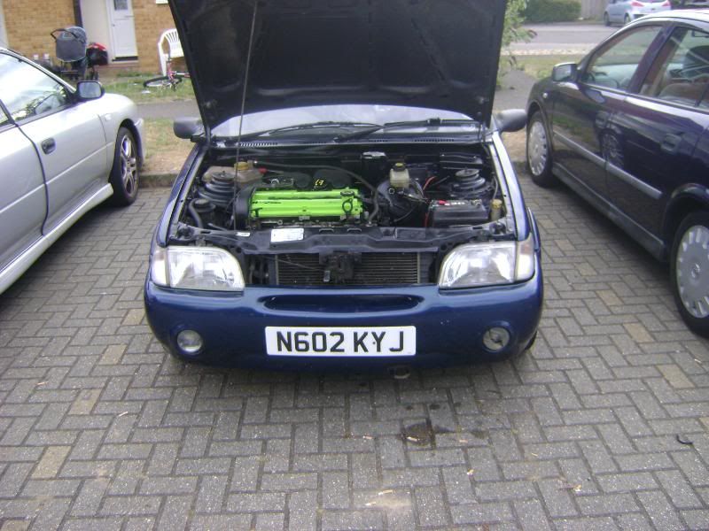

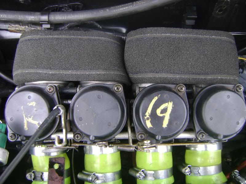

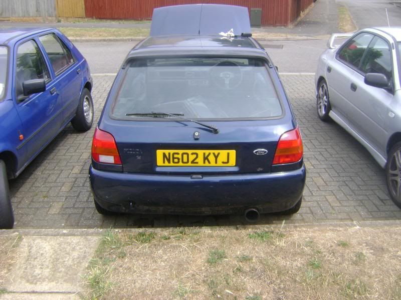

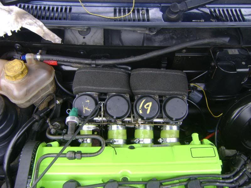

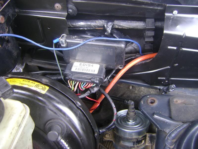

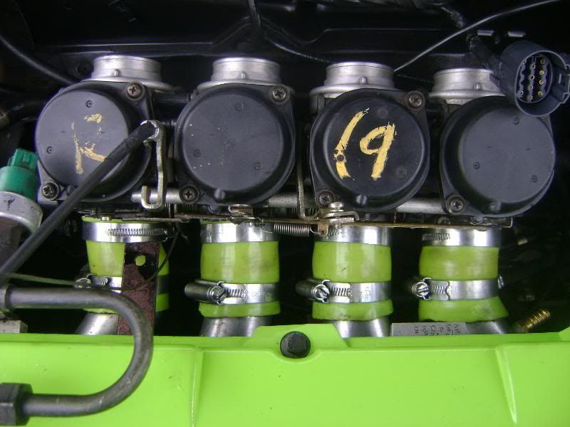

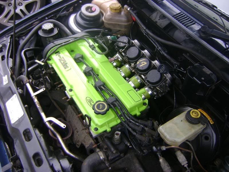

Some progress pics. didnt take any before i fitted the head and carbs.
Going to keep standard manifold and decat for time being as i cant be bothered to take out rad/fan, starter and alt to fit my 4 branch as it wont pass the engine with these bits in place.

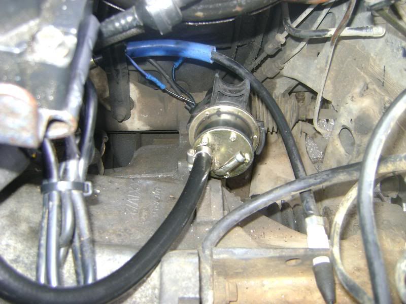

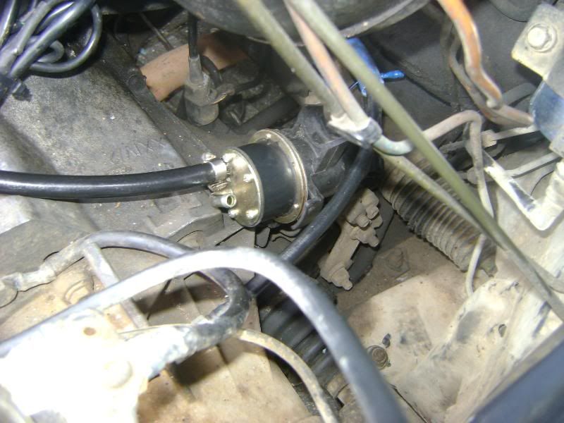

Fule pump mounted to gearbox/going to fab a bracket in metal when its up and running but for now using the std bike rubber one

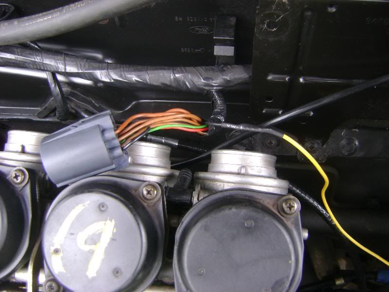

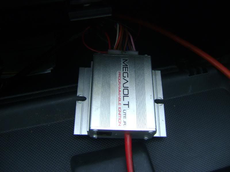

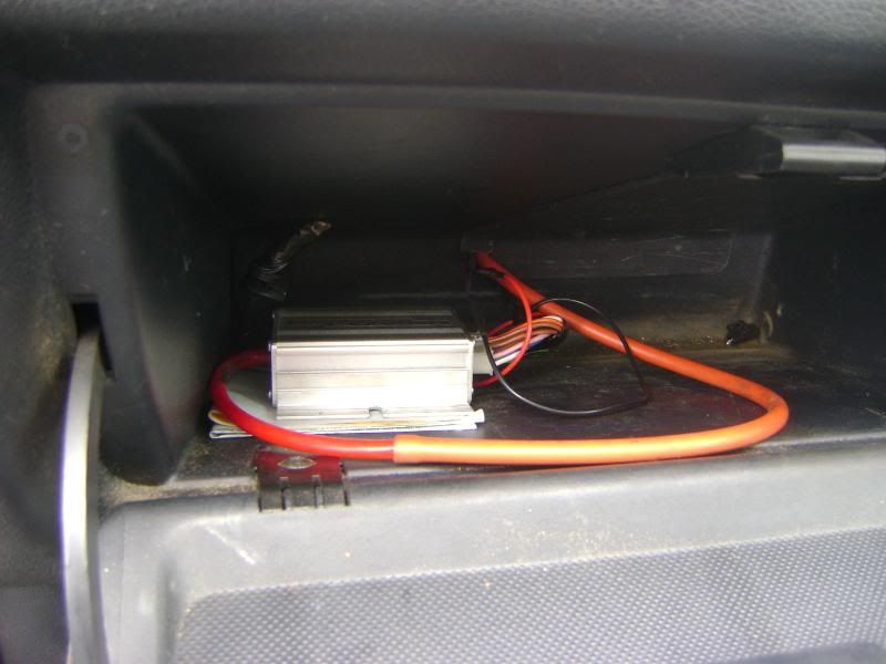

Wired in the ecu and edis etc. Ecu in glovebox for time being

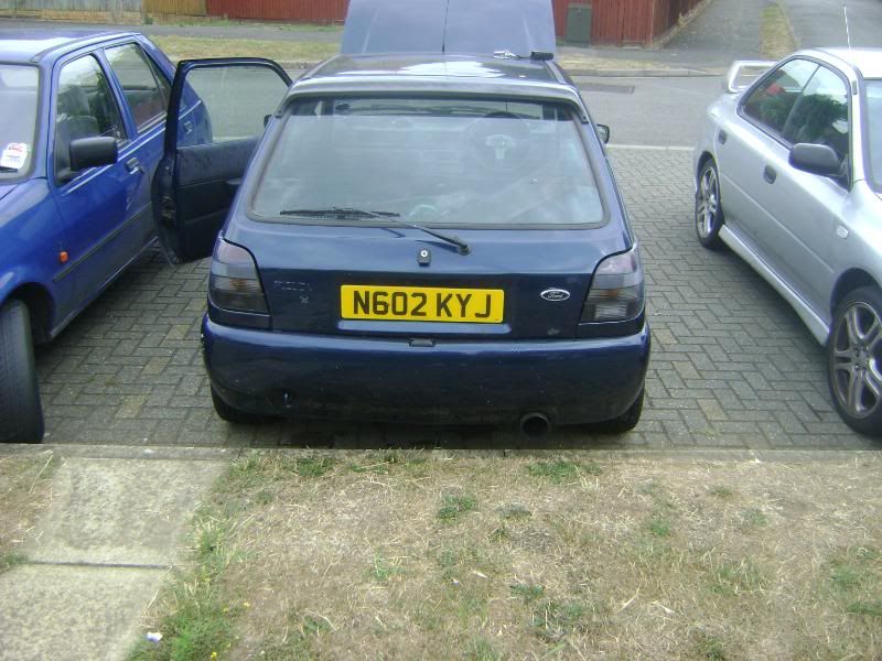

Swapped standard rear lights for smoked ones, opinions please.

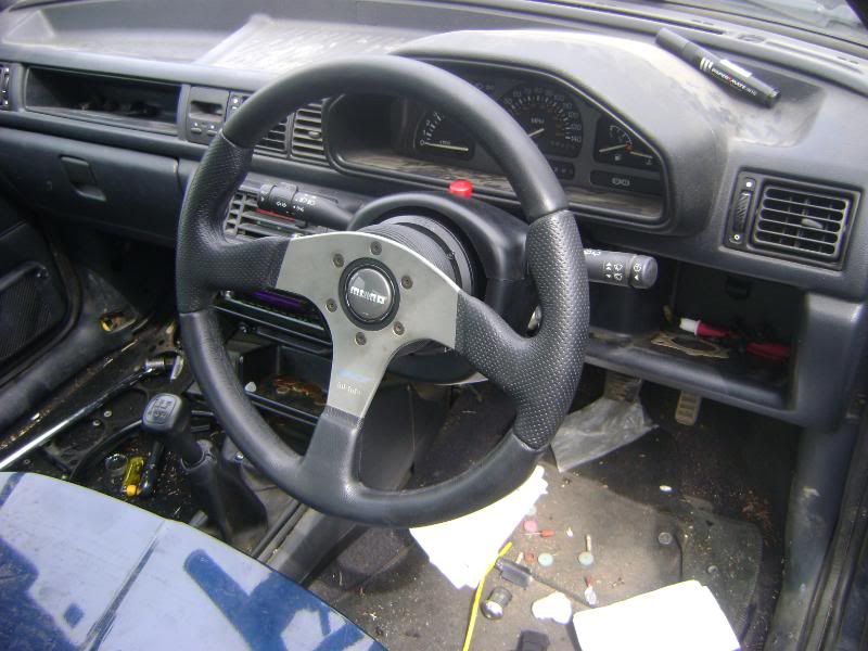

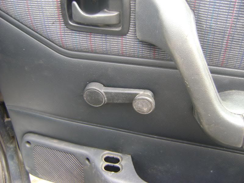

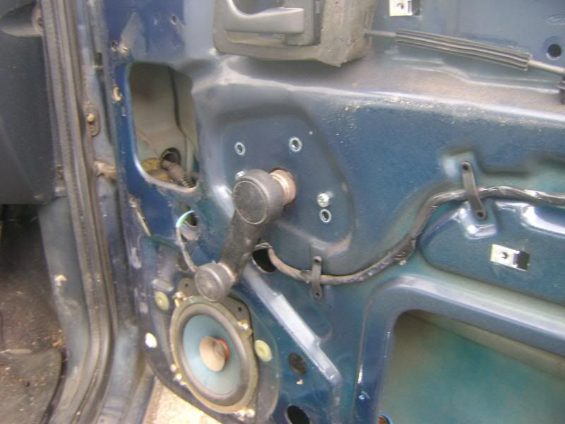

Electric windows gone for manual versions
Ditched airbag wheel for a Momo one i got recently
Some air filters, not sure if im going to use them yet but they were cheap on the bay so thought why not

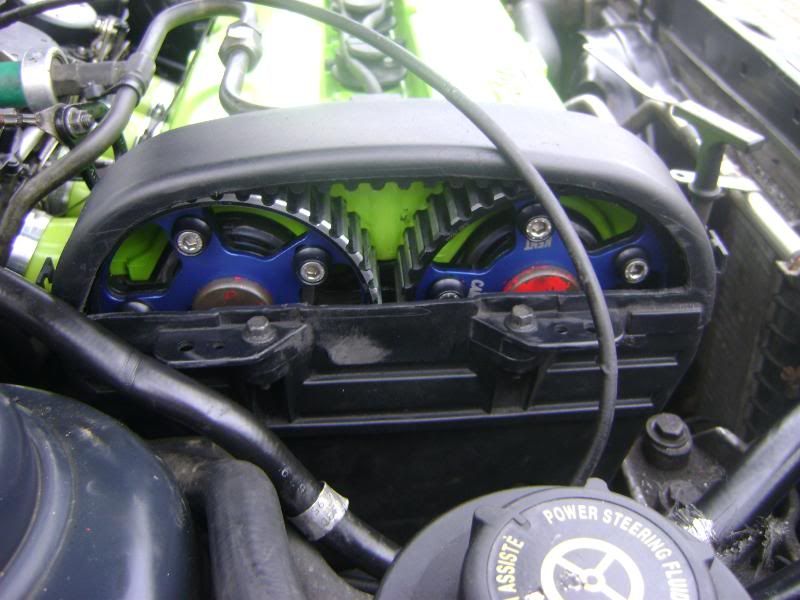

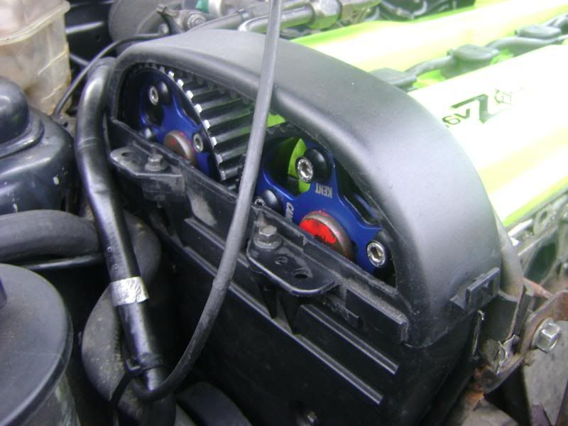

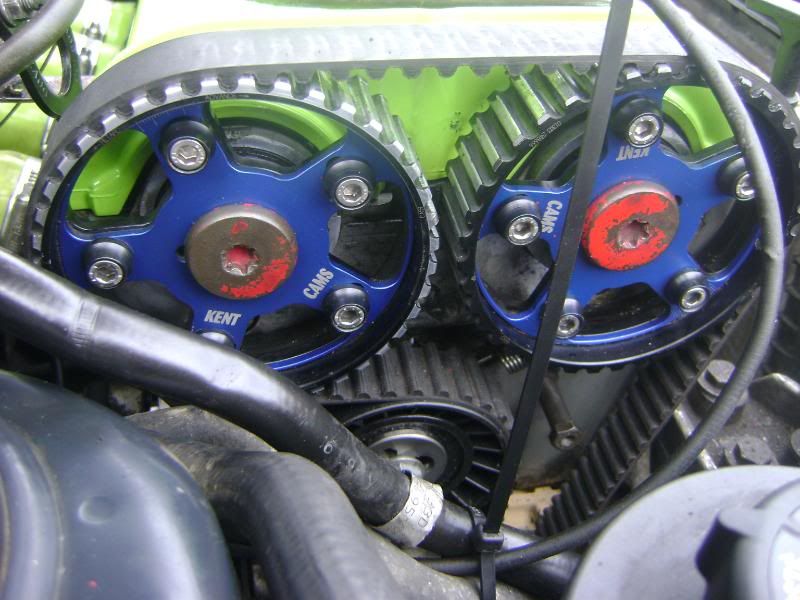

Thought it would be a shame to cover up the verniers so modded the top timing belt cover

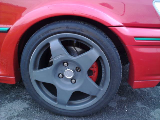

A few random shots with the new wheels fitted

What wheel bolts should i be using with the OZs as ive got the standard ford alloy ones on ther and they seem to fit ok or should i be using the bolts with built in collar that come with most aftermarket wheels?
Where to buy 10mm spacers for between the axle and stub axle or a wheel spacer kit with longer bolts?

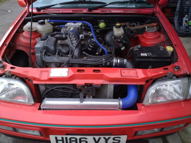

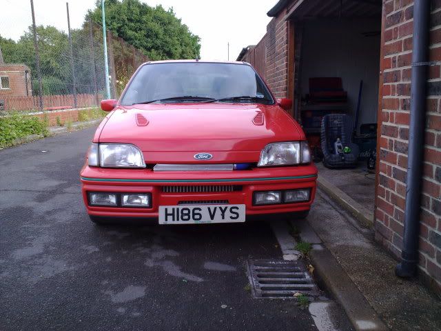

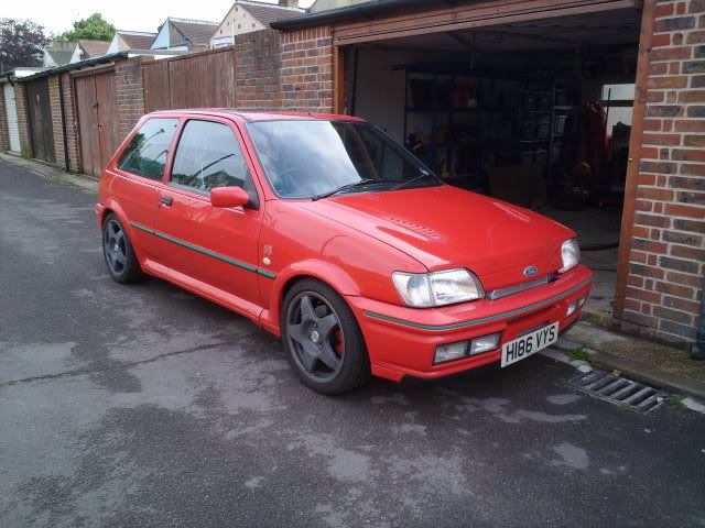

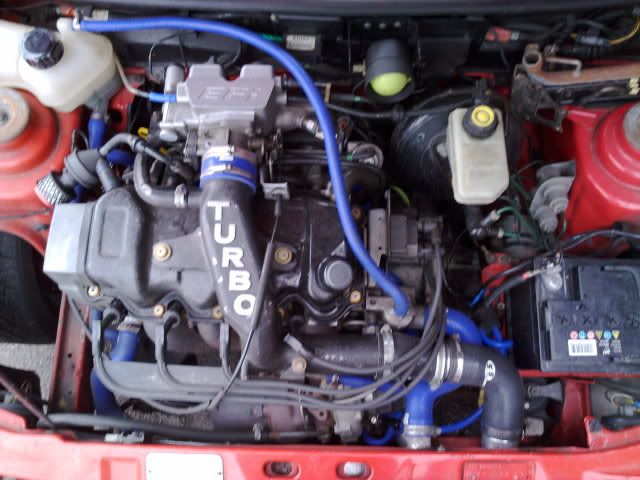

A few pics of my other fiesta which will be converted to 2.1 zvh with stage 3 head and kent cam, chip and beiges etc when this one is finished. Engine totaly standard at the monent and running std boost.

Good work mate,
With regards to the wiring on the clock plugs, look up in the guides section with one for mk5 clocks into mk3, I had the wiring diagrams on that ;)
Looks good mate, although I would remove the panel on the bulkhead to let some better airflow to the carbs :)
