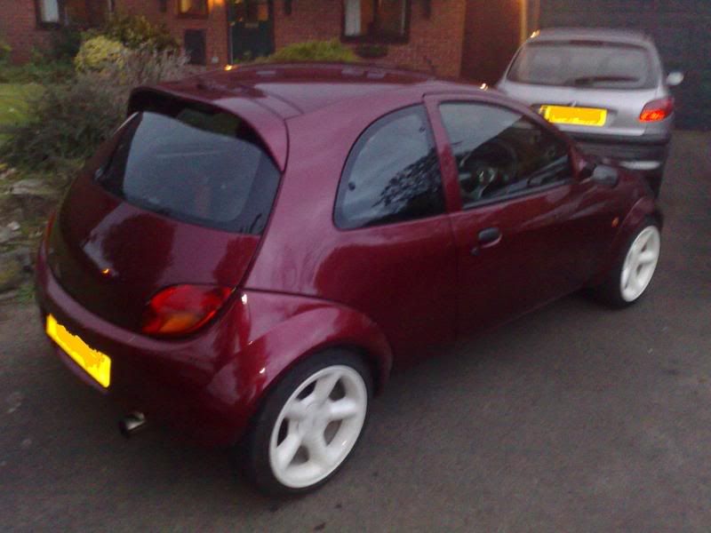

right registered along time ago now to find some rs1800 parts and created this thread
Was asked to create a members galley topic but at the time didnt really have much to show as regards the zetec ka

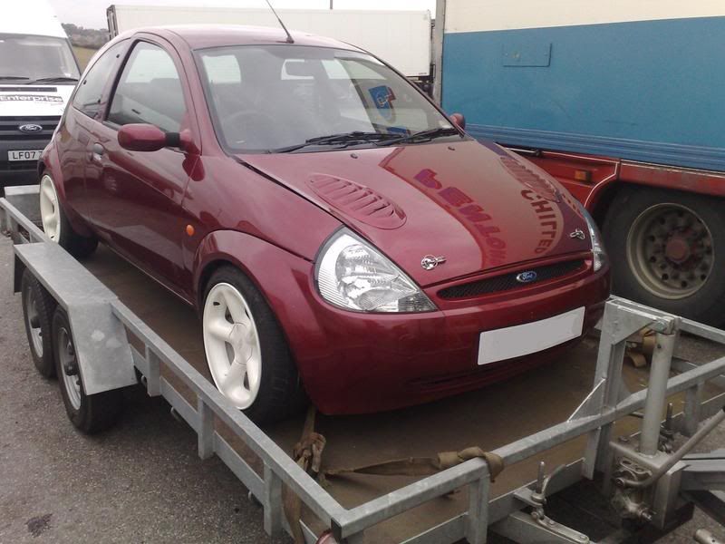

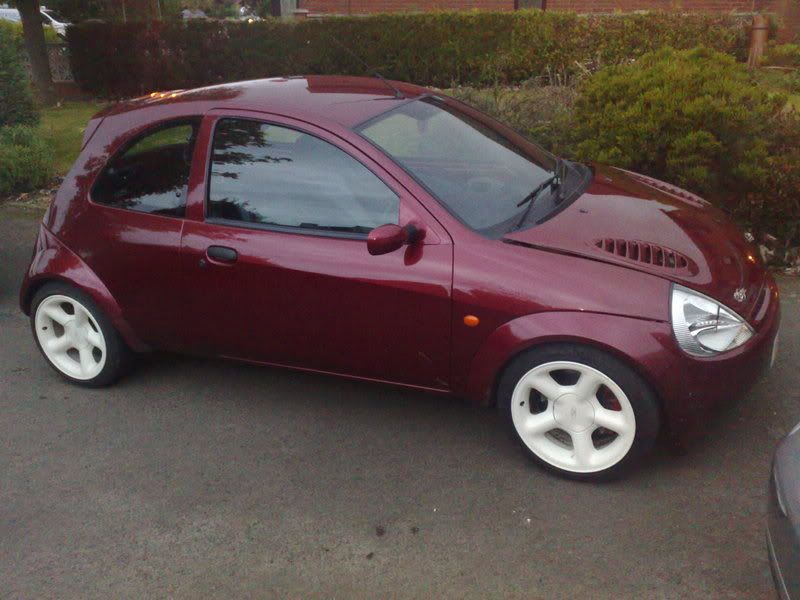

My first ka ended up looking like this....
nothing fancy just a little different, new wheels, bigger brakes, coil overs, nice interior, respray, new sills, wings petrol cap surround all due to rust!!!
the plan was always to drop a larger engine into it but then this came along and I couldnt say no it had all the bits I wanted so off me and my Dad went to fetch it October 08
plan is to do a complete restoration on it and follow the same theme as my current project ka lol :D
1.8 zetec converted ka 0-60 in 7.81 sec

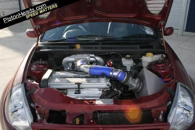

work started as soon as we got it home, has had omex management wired in and running a base map at the mo and will be live mapped when all the work is complete so should see 130 bhp as the engine is up to rs1800 spec :D
have got a new inlet pipe made up so the bonnet can be fitted without the need for bonnet rasiers too

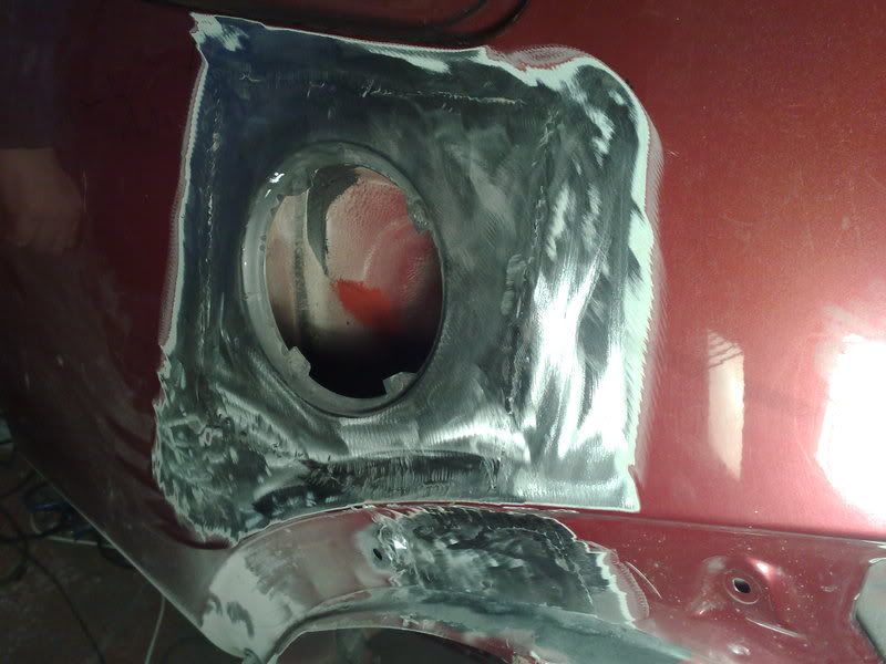

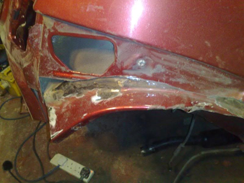

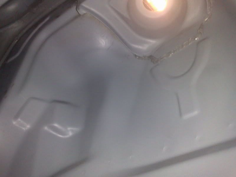

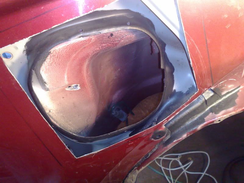

got the filler on the drivers side where the sill was attached and the work behind the bumper, looks much better but forgot to take any pics, shall take some tomorrow lol

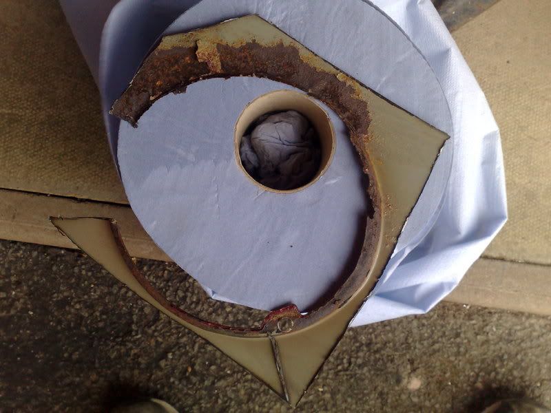

cut the petrol cap surround out and realised the inner panel was rotten too so got a new panel from ford and got it fitted today along with the repair panel for the surround
reverse of the surround when cut off
the surround and the inner panel cut out no more rust just a big hole haha
all the new panels had the primer removed and then coated in weld through primer to hopefully prevent rust around the spot welds later on
then the new panels welded on
and finally a coat of filler applied
onto the sill tomorrow its all cut off ready to shot blast the seams and cut the new sill to size etc
very happy with it tho

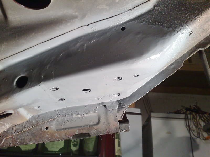

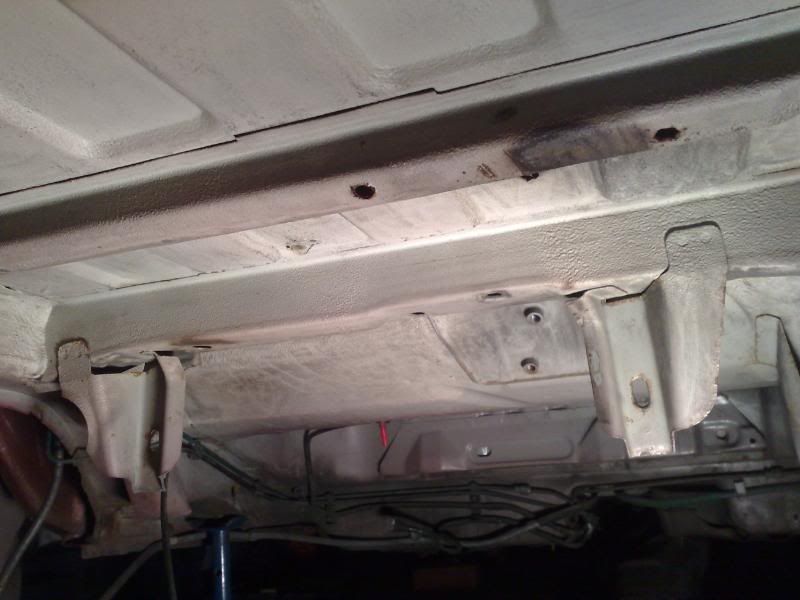

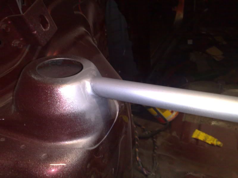

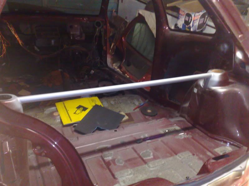

got the rear strut brace welded in today and finally got a picture of the passenger side sill, be it a very poor one lol
just a rough coating of a zinc primer to prevent rust for the time being
also got around to repairing the rear chassis rail, got it all cut out, well the outer two layers and now its all ready to be shot blasted and welded back up :D tomorrows job!!!

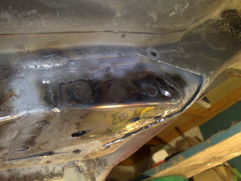

well tonight's update, got the rear chassis rail sorted :D

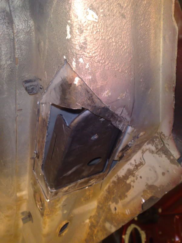

both outer layers were rotten around the rear beam mounting points all due to a drainage hole that has been blocked for many years by the looks :(
haven't got any pics of it in its worse state but it wasn't pretty
so with it all cut out and the inner layer in weld through primer after being shot blasted
then the first layer welded in just before it was coated in weld through primer
then the outer plate all cut out and ready for a coat of WTP
then all welded up
the rest of the underside will be done when the engine is out and the car is higher up in the air :D will be all shot blasted but bar two holes near the front of the car on the drivers side the rest is all surface rust :) :D :)

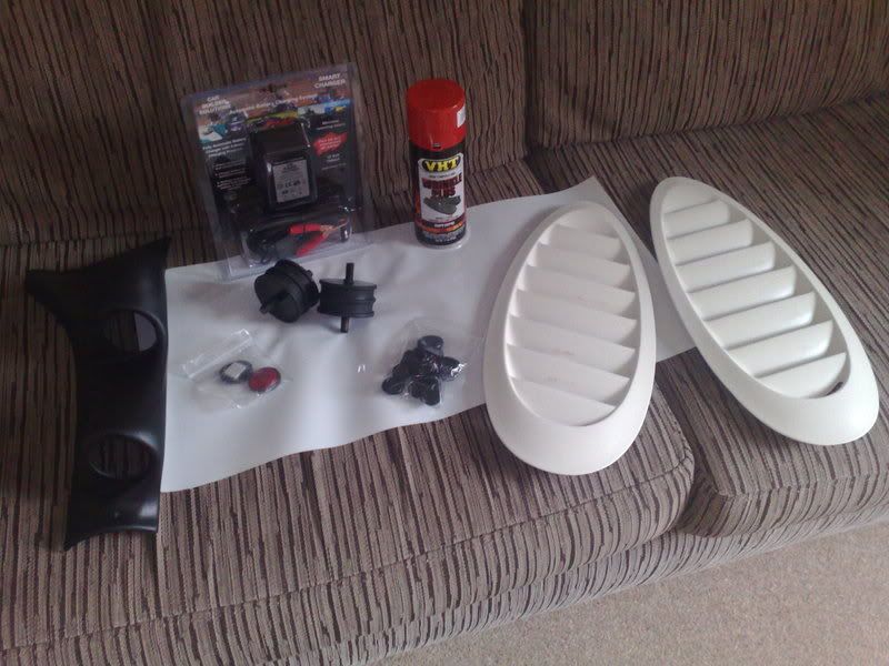

Finally had the time today to get some pics of my ka related Christmas presents :)
some cleaning stuff, black alloy window bolts, tools and 4 self build electronic circuits!!!! oh and a volt gauge :D
and today some packages arrived

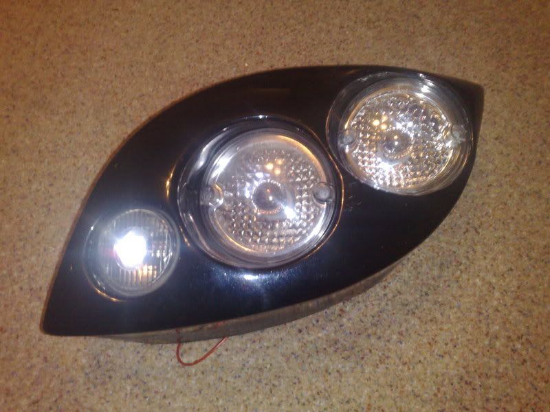

some cossie vents for my new bonnet as I sold the old one as it had horrible bonnet pins on it,
2 rubber engine mounts (1 spare) for funnily enough the engine lol we shall be making another mount for the front of the engine off the rs1800 alternator and PAS pump bracket like the rs1800 has fitted as imo the engine rocks too much and putting too much stress on the main engine mount at the back
some stone chip film for the arches etc
battery charger as the ka is a summer toy I shall need one of these to keep the battery in good condition
red wrinkle paint for the cam cover and air filter
red reflectors for the rear to be fitted flush in the bumper either side of the number plate to make the car legal as the afterburner rear lights have no red reflectors
twin gauge pod to hold a coolant temp and volt meter gauge, the volt gauge is a little pointless but I wanted two gauges lol
and finally some rubber bungs for when we have cavity waxed the car would like to bung the holes up neatly

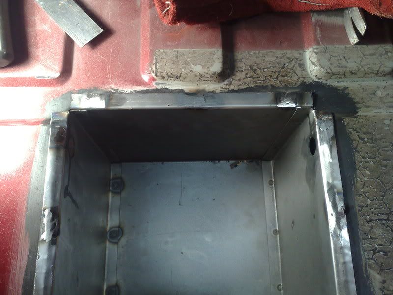

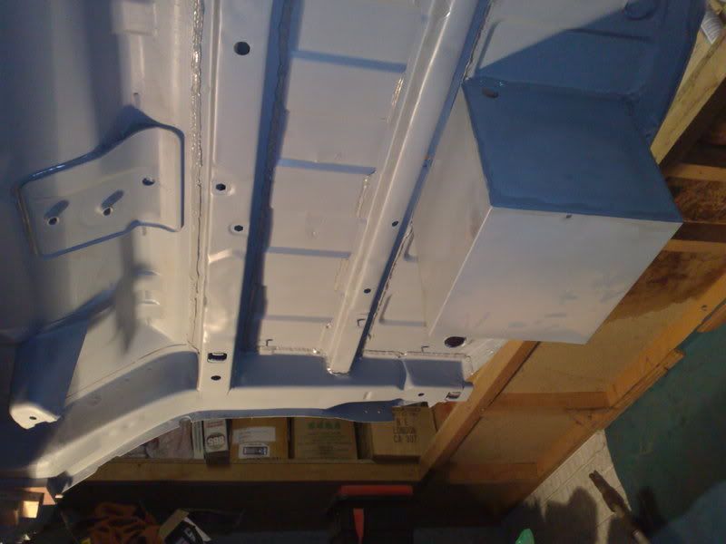

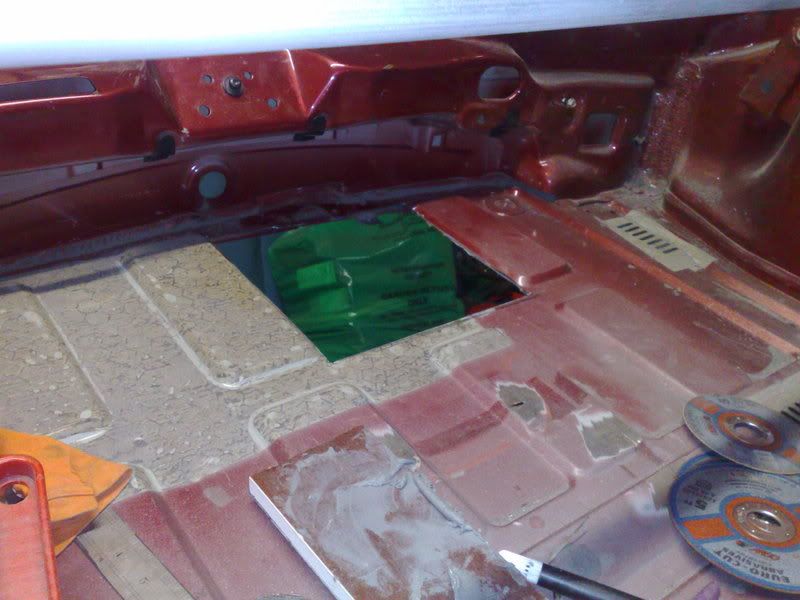

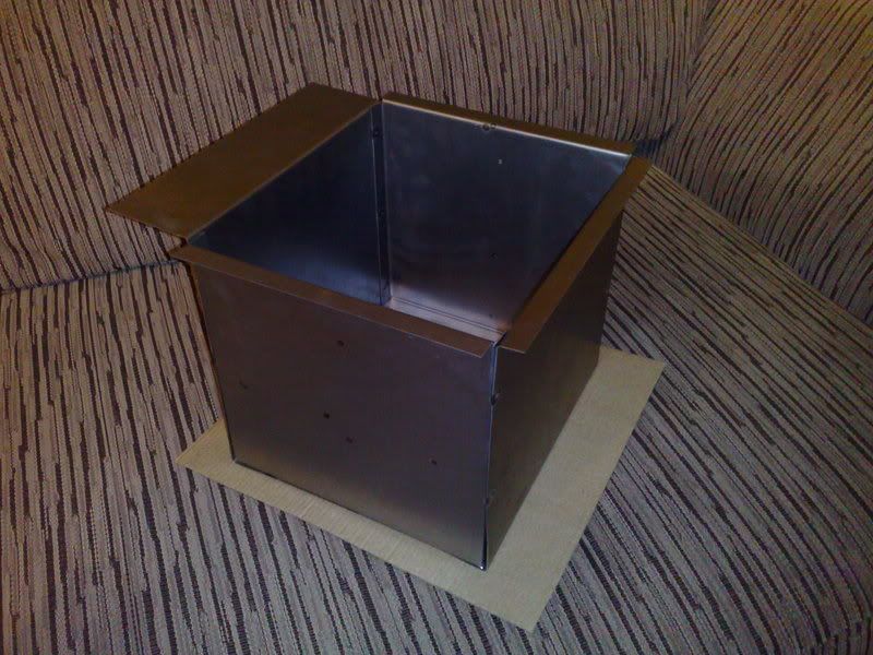

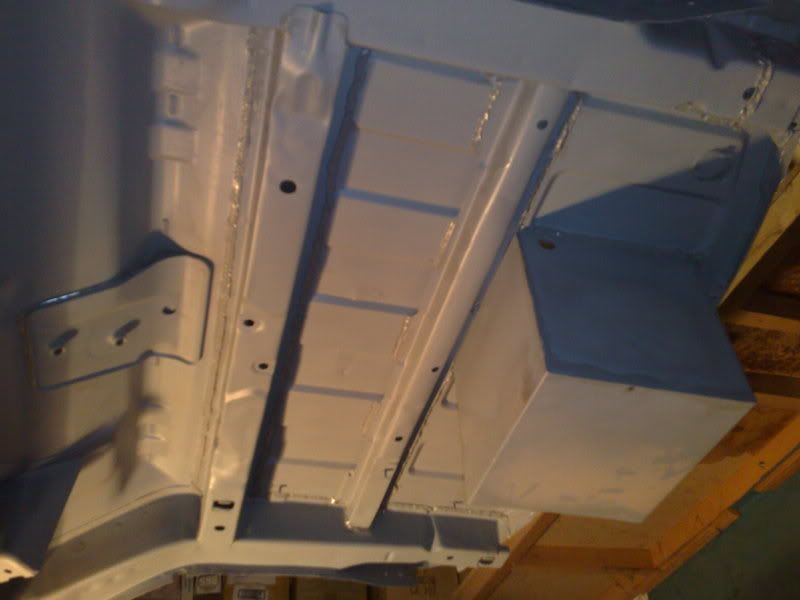

well finally the battery box was made :thumbsup:
so got that welded in roughly tonight
so pleased its in, just got to weld the corners etc up tomorrow then onto the front engine mount as all the metal for that is cut up so just got to tack it all in place and then out comes the engine!!!

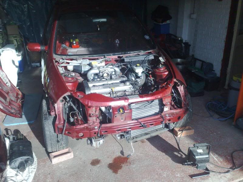

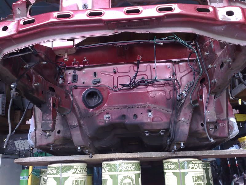

some pics of the engine out :thumbsup:
the brake lines have since been taken out as well :thumbsup:
the car is now ready to be shot blasted underneath, that will happen hopefully valentines weekend if lunch with the g/f doesn't turn out to be a day out lol
the list of bits left to get is getting shorter by the day need to raid a scrapped ka for some clips and little things, then its off to for for loads of new nuts and bolts :thumbsup:
also found out that the engine was missing one bolt on the rear engine mount, so the engine mount had been damaged so that has been dropped off to my Dads mate who runs his own specialist welding company to see if they can fix it (its cast ally)
the whole car was a death trap to be fair, no main fuse from the battery which is located in the boot, brake lines rubbing on the wheels, live 12v wires floating around the engine bay, the rotten rear chassis rail, main engine bolt missing, the list goes on........

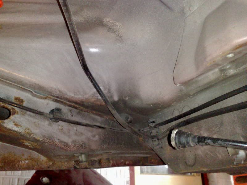

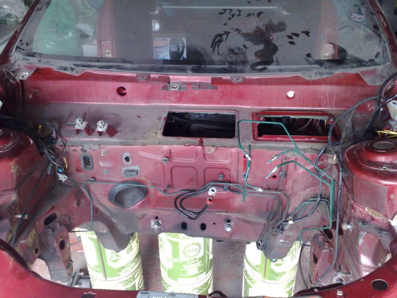

Managed to remove all the underseal from the main floor plan and shot blast all that and give it a coat of etch, also seam welded most the engine bay just in case I feel like adding more power later on! We only did inch long welds then an inch gap and then another inch but better than nothing!
Didnt mange to shot blast the entire underside as the compressor we hired out kept tripping out so we gave up with it in the end. We had to hire one because my dads hobby one isnt big enough for shot blasting but after the issue we had at the weekend we got a full refund off speedy the hire company and Dad went to machine mart and purchased a 12.2 CFM compressor lol Should do the job and make spraying the car much easier.

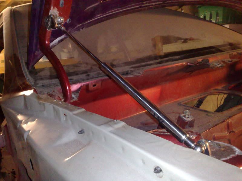

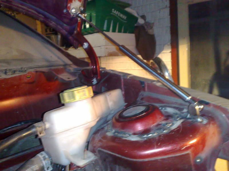

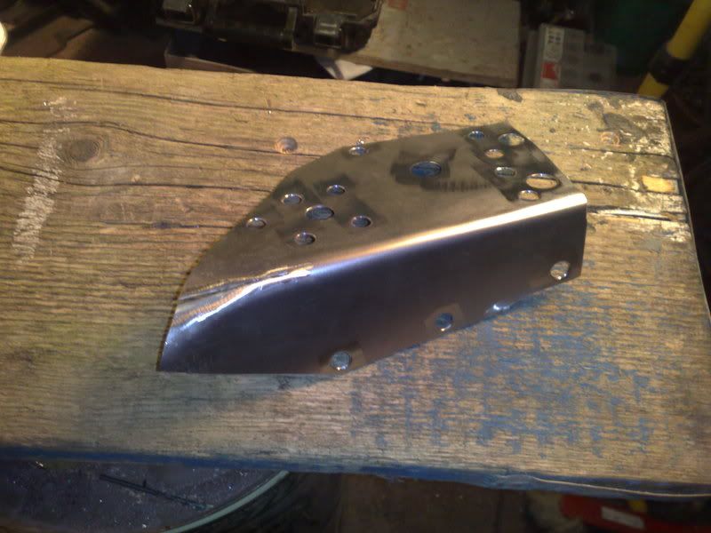

Manged to fix the gas bonnet struts on too, welded some brackets onto the top of the turret and the bonnet hinge, shall get some pics up soon.

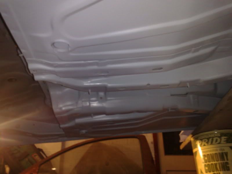

the underside before
the underside after it had been shot blasted and a coat of etch :thumbsup:
the nearside arch after some seam welding, shot blasting and a coat of etch
bonnet gas struts
bonnet struts showing the custom made brackets, going to neaten up the welds later :thumbsup:

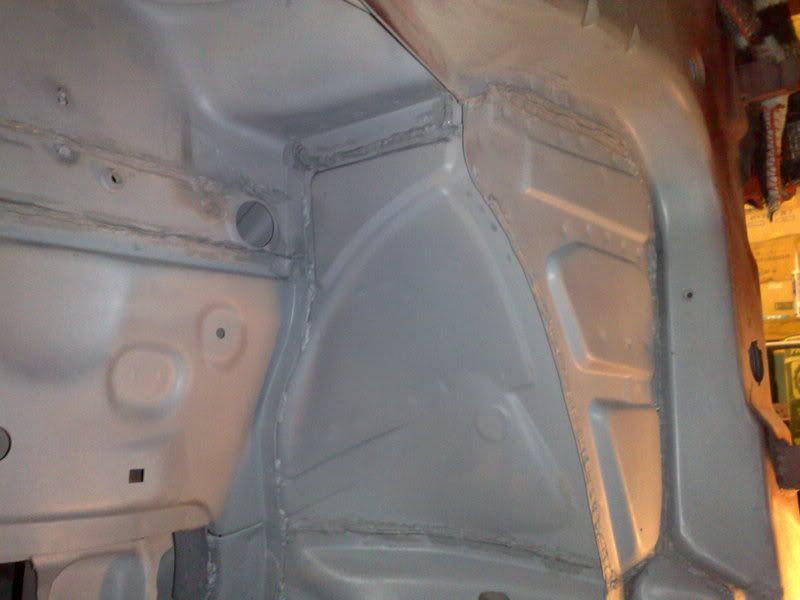

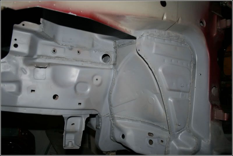

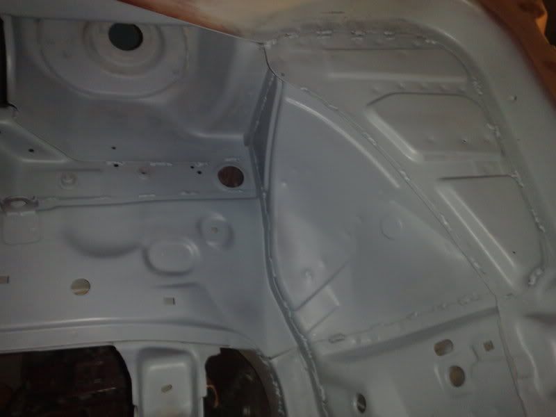

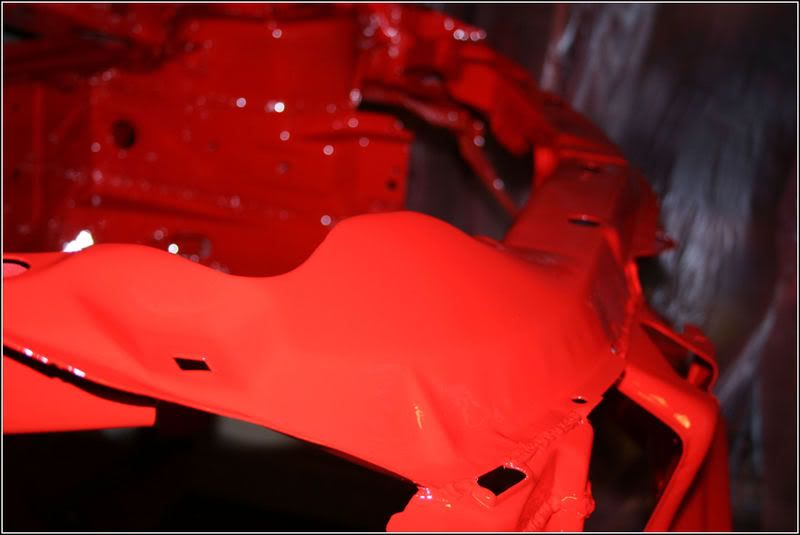

well finally most of the metal work is done :thumbsup:
whilst I have been busy with uni stuff my legend of a Father has been tidying up the welds and applying the seam sealer :thumbsup:
He has sent me some pics of the progress
all the underside has been shot blasted to bare metal and then had a coat of acid etch primer
front nearside arch
boot floor showing the battery box
next up is get all the seams sealed up then its on to applying the mastic 121 (expensive 2 part epoxy mastic) lol then add some radiant red on the underside and the engine bay :thumbsup:

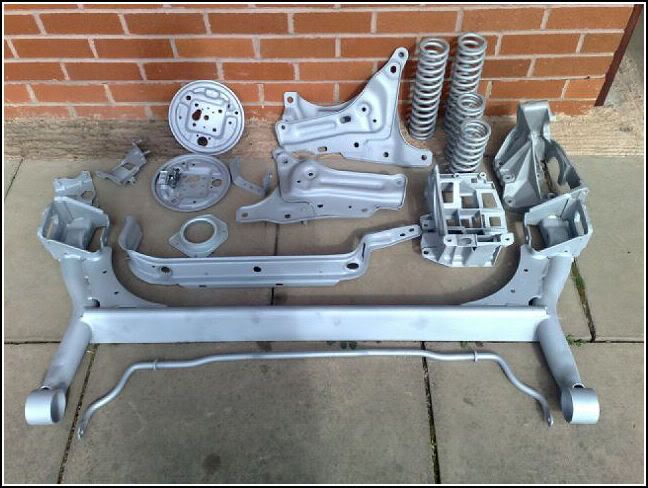

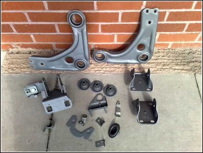

Oh also all the parts for the rear end have been sent off to the powder coaters- beam, brackets, rear of the brake drums so should be back on its rear wheels by Easter and onto the body work and engine painting over the Easter break.
Its really starting to come together and I cant wait to start putting it back together :thumbsup: :thumbsup: :thumbsup:

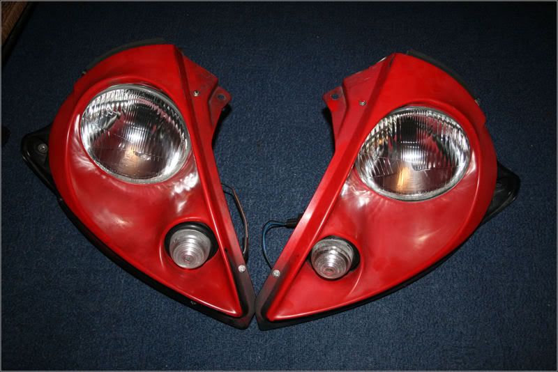

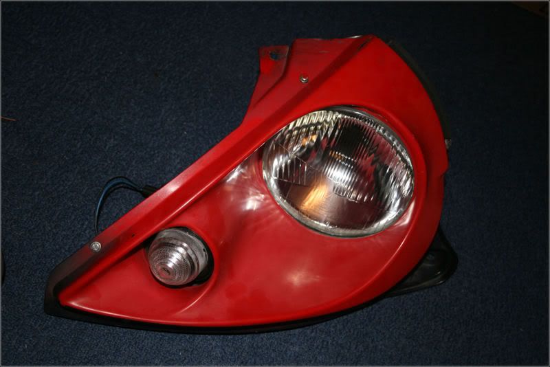

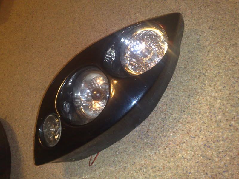

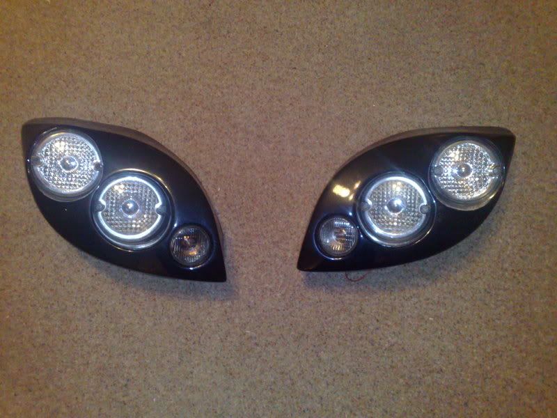

purchased these, they require a paint job but so does the whole car lol They have had new lamps both headlights and indicators and got them at an ok price.
I know they wont be to everyone's tastes but I like them and they are better in terms of light output than than the standard units :thumbsup: Plus I have a plan regarding them :thumbsup:

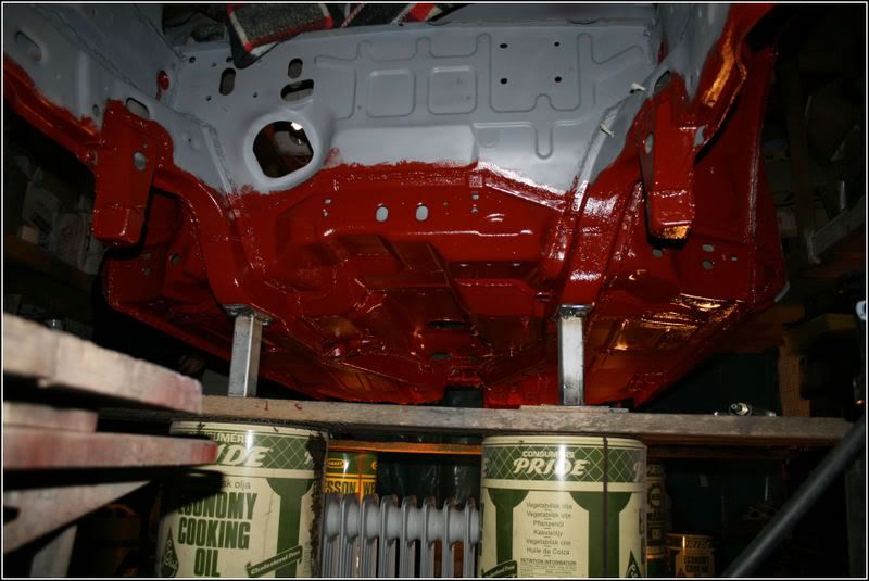

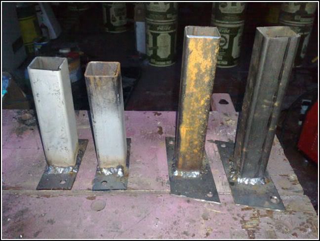

My Dad made some stands today, which will bolt onto the rear beam mounting points and the front wishbone points to help lift the car up and allow me to paint around 99% of the underside in one go and the areas that these stands take up will be hidden by the rear beam and wishbone brackets but they will still be painted :D They just need squaring up now :D

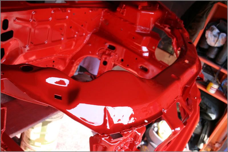

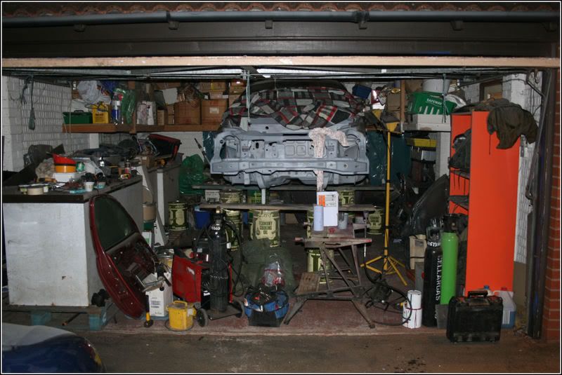

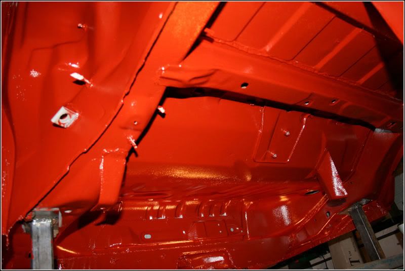

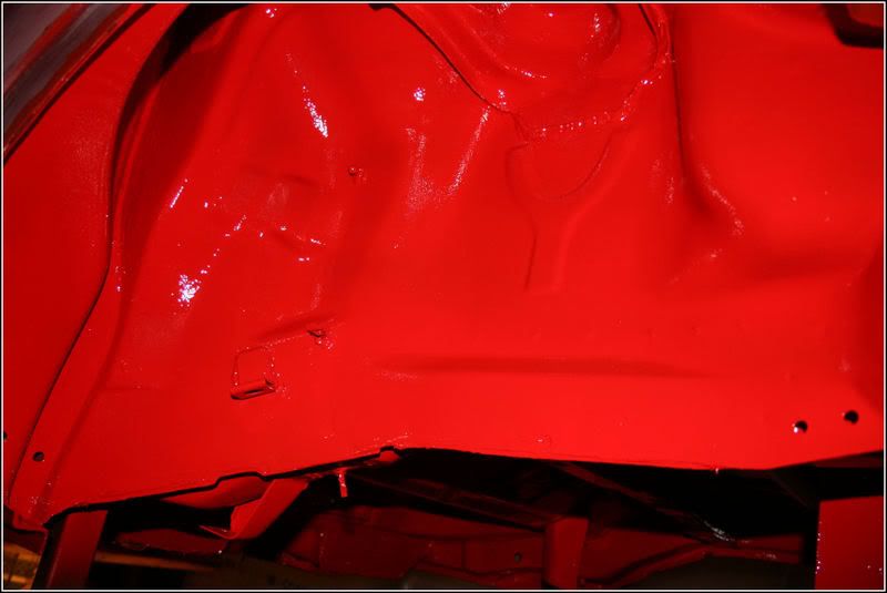

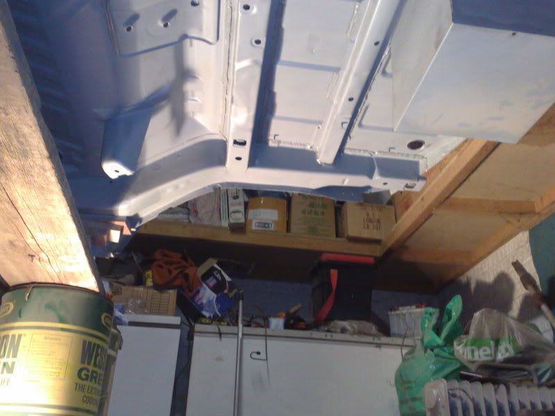

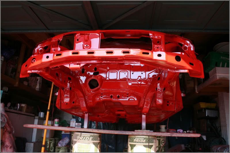

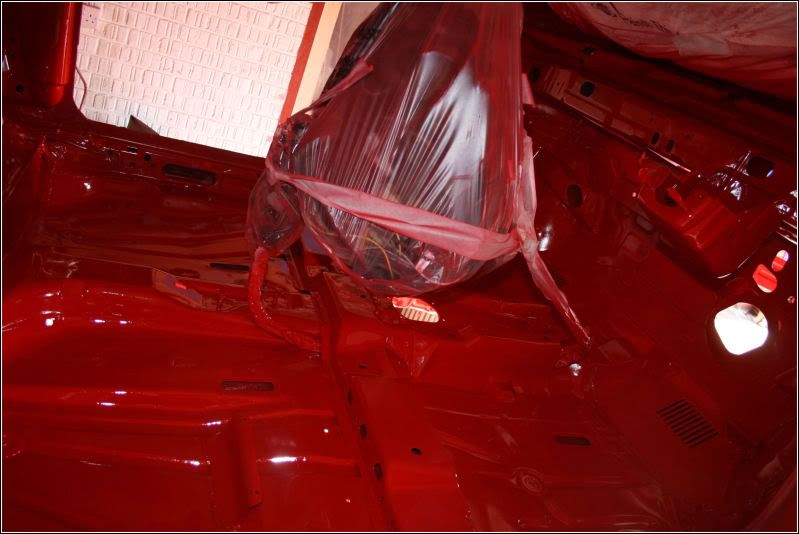

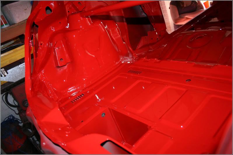

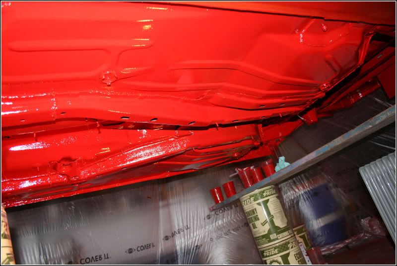

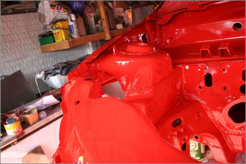

my Dad and I got all the little jobs like sorting out the bolt on wings and welding studs on to allow the battery cable to be secured to the floor pan and a few other nice little jobs!!!! Then it was onto some colour in the engine bay and underneath :thumbsup:
the front arch seamed sealed up
general shot of the garage after a hard days work! shows how high the car is!
epoxy mastic 121 applied on the underside, 2 coats in each arch and one on the underside
another shot of just the epoxy
top coat, 2 coats of adhesion promoter/red base coat primer and 2 coats of 2 pack radiant red (all with a flexible additive to allow it to flex with the 121 mastic!)
the front slam panel with modified cut out to clear the cam cover!
To say I am happy would be an understatement!!!!!!
Let me know what you think

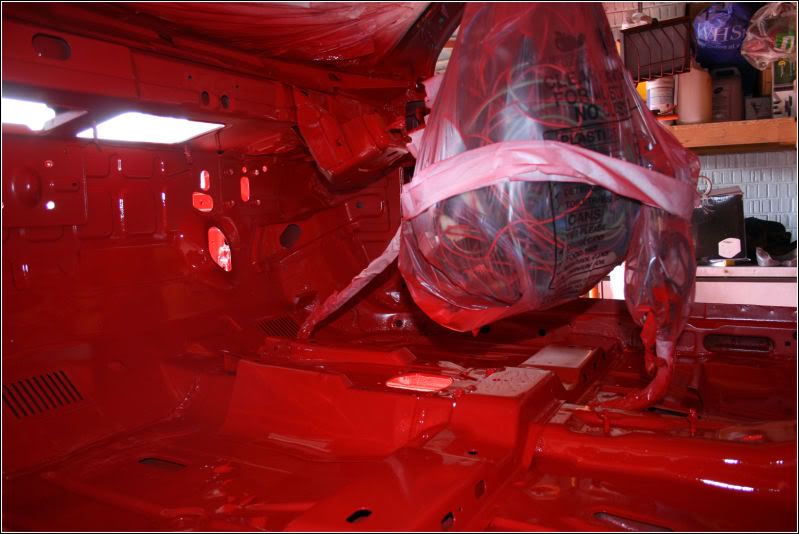

only a small update with no pics

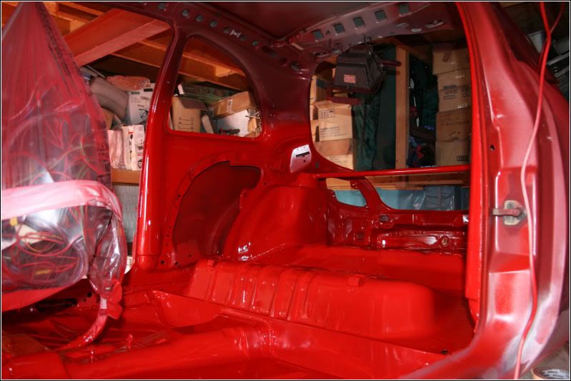

got the fuel tank sandblaster by my fiancée (cheers hun) :thumbsup: then painted in some special fuel tank paint to replicate the OEM finish
Also managed to get the inside painted up so that's all red

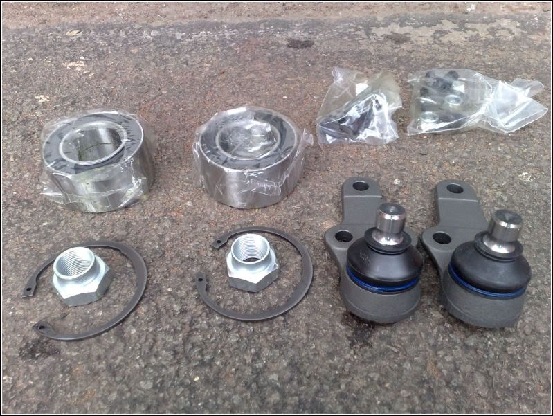

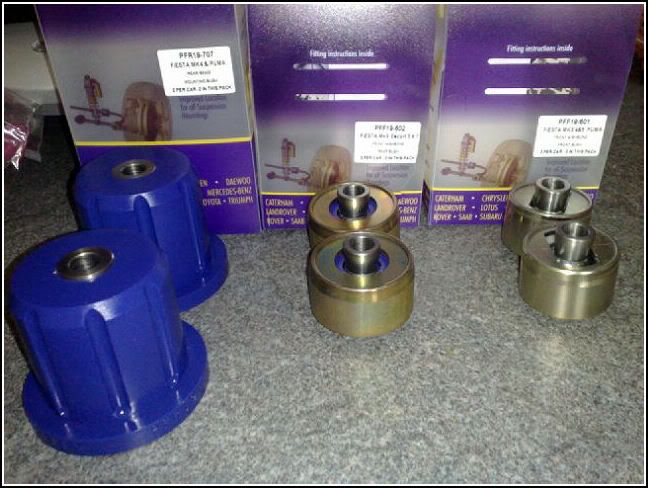

- Full poly bush set from Kev @ powartek should be nice when these are fitted to my freshly powder coated wishbones and beam
- I have been to Ford as well and got a nice long list of new bolts and clips oh and a ford starter button + bezel and axle spacers both the 10mm ad 20mm should make the rear wheels sit flush with the arches :D

so just got to wait for all of the above to arrive and my powder coated bits to come back and the rear end and the tank and lines should all be back together by the end of Easter :thumbsup:

just a quick update, beam and other bits have been collected from the shot blasters and are now at the powder coaters, a few bits are missing from these shots but hey ho lol

only just realised I hadnt put any pictures of the insde painted, I have also took some pics of it with the garage door open and the sun on it :D
boot floor showing the painted battery box
looking through the passenger door (ignore the top of c pillar and b pillar they are to be painted black like the outside
floor pan
more of the floor pan
front slam panel
front turret
overall view of the car

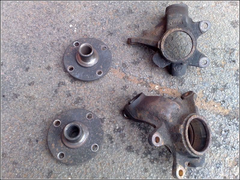

the front hubs have been split and the old bearings removed just need to be shot blasted, going to be painted so they can be touched up after the new bearings have been pressed in as it took 5 ton to press the old ones out :o
new ball joints and front wheel bearings and hub nuts
Just awaiting for £450 worth of stuff :o bushes, paint, cavity wax, sound deadening, coil over covers to arrive which the most should be here by later part of next week :D
the first job will be to cavity wax it all up with Dinitrol Cavity Wax, only the best :) (it is a ford after all don't take much to rust lol)

just a little update :D
have received the bushes :D
oh and have been collecting parts from ford the last few days, new heat shields for the exhaust, clips, all new bolts for the underside and a ford started button which happens to light up red :D got the surround too. Long way off from fitting it but it looks nice lol
Should be back home Friday so should actually be able to get it all cavity waxed up and start preparing and painting the brake/fuel lines and the shocks :D

check the rust though :shock:
a little bit of welding
