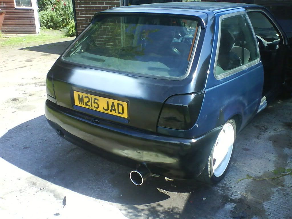

just thought i'd put a few pics up of my car as i am getting ready to re-spray it. the plan for the car is a 200bhp+ n/a zetec running GSX-R throttleboddies, 8 injector set-up, nitrous, uprated ST170 bottom end and a race spec head and cams (9500rpm rev limit :devil: ). im also savng for a 10 point rollcage, kevlar fixed back seats, fuel cell, carbon roof bonnet and bootlid, fibre glass bumpers wings and mirrors (making the moulds myself), coilovers, adjustable bottom arms, cossie brakes, twin rear anti rollbars, strut-braces, lexan windows, stack dials and custom flocked dash and some other bits i cant remember. so far its its pretty standard bar lowering kit, 2ltr throttlebody and MAF, enclosed induction kit with air intake through foglight hole, white late RS2k wheels, and a super chip. im currently sorting the body work so i can re-spray it gloss black, fitting my new exhaust and finding wheel spacers so i can sort the stupid offsets out. any comments welcome, what do you think? just some pics of how the

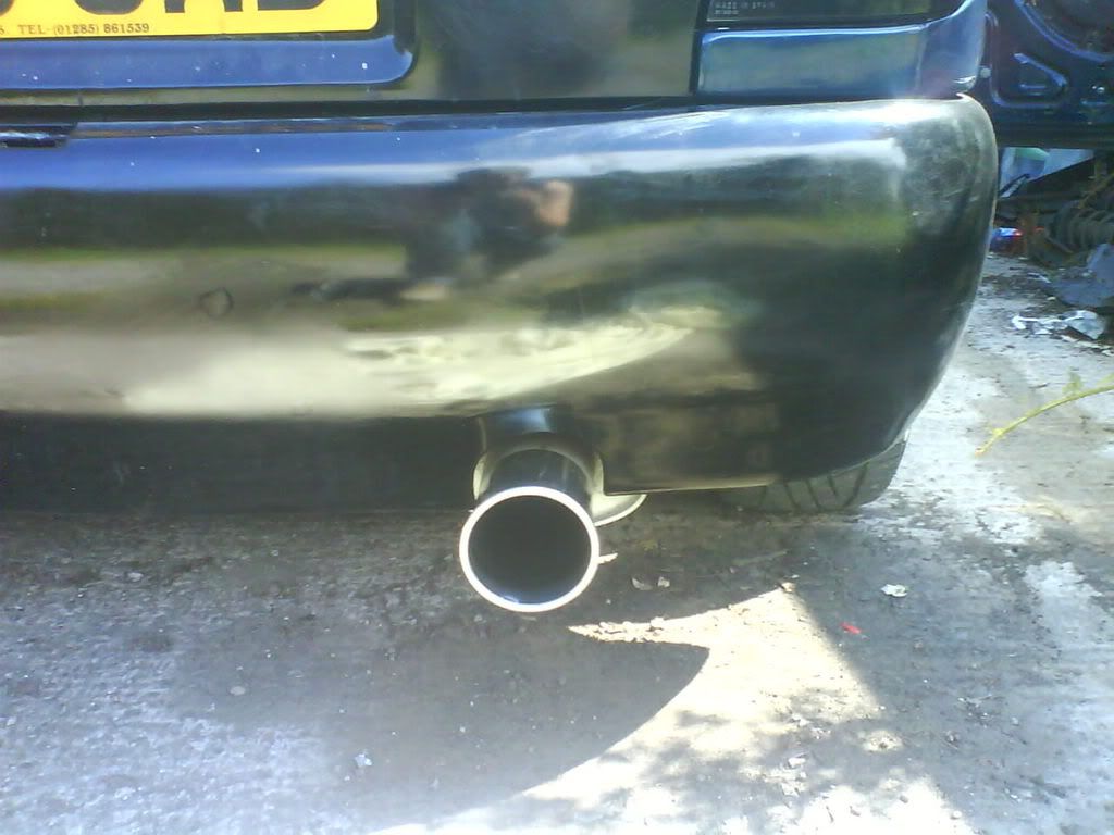

fitted my new exhaust today. tips a bit big and is sitting to low but it sounds amazing :D
PostPosted: Wed Jul 16, 2008 12:29 pm
looking good, wa zorst is it?
looking forward to seeing this if we have a bristol meet!! u gona have it sprayed by then?
PostPosted: Wed Jul 16, 2008 7:08 pm
Posts: 233
its a powerflow custom one, nice and raspy :devil: . might not be in black but i will definitly be in attendance. might be having the meet in cribs now, people dont like the weston idea. cirbs is closer to you tho so not that bad.
