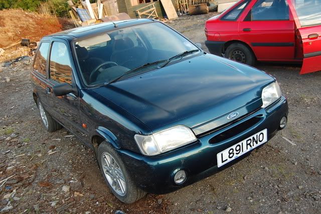

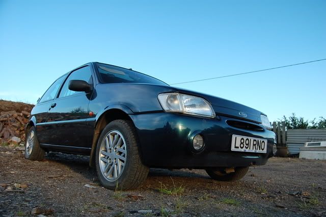

well been to pick my Si up tonight its a 1.6 but seems gutless compaired to my old mk1 fiesta 1.1 :rolleyes:
had a good look round it and looks in fair nick so when i can afford it ill just put it straight for an MOT

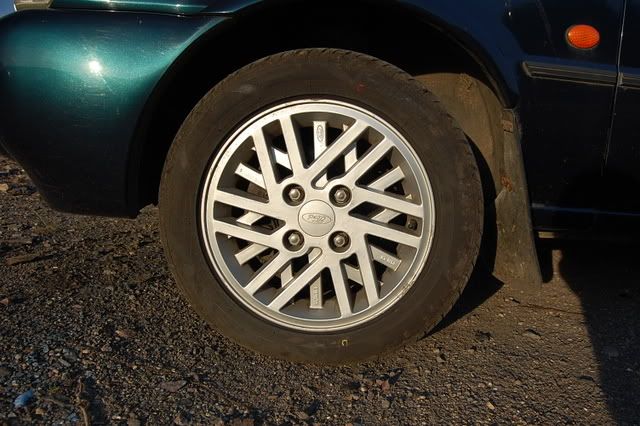

what are these wheels called?
i think it needs a crossflow :D

Looks tidy. Good base to start.

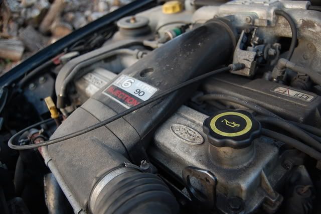

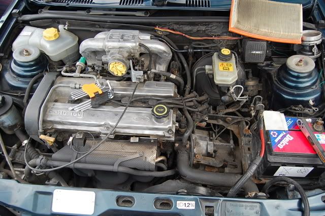

Try giving the engine a good service, most importantly a MAF clean (prob cheapest too), new plugs HT leads and some magnatec 5w30. The 1.6 aint gonna break any records but it shouldn't be sluggish.

what should i be cleaning the MAF with?

you have lattice style alloys there mate :)

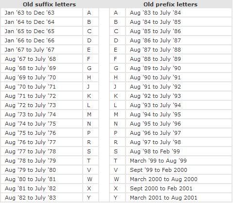

looks very nice mate :) but it can't be a 1993 si on a l reg prob a early 94 l reg, as back in them days reg plates changed from august 1st i think

though my mums old L reg micra was a 93 thats all, shall see when i get the log book back, K's 93 isnt it

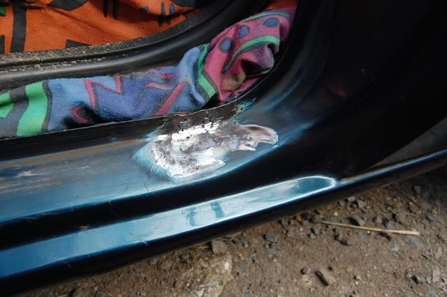

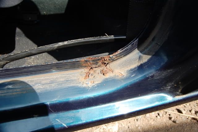

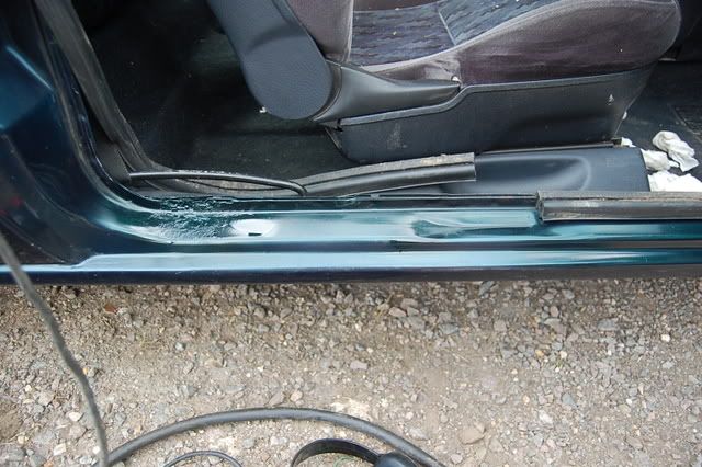

well today i gave it a damn good clean inside and out which gave me a chance to have a propper poke round
both sills on top under the rubber sealing trim have a very small hole which will be easily rectified

and started giving things a clean under here got some torx thingys to clean the MAF, did my escorts one and its like a missile now :D
whats the best induction kit filter? as the clips on the airbox are a right pig to get at so i cant be bothered stickin it back in :lol:

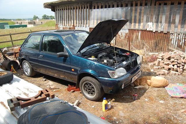

thought i would change the oil and bleed the brakes today
failed on the brakes none of the nipples would budge waht so ever :shock: :cry:
and failed on the oil too........how the hell do i get to the filter :x :x cant believe a car this size has got power steering and the pipes are right in the way, i take it i have to reach it from below?
also needs a CV rubber gaiter thing on the hub end on drivers side, can i do this by taking the leg/hub out the way leaving the shaft in the gearbox?
although i guess if i take the shaft out completly i could get at the oil filter easily

yeah your best bet is doing the filter from underneath
ad for the shaft Q i'm not sure about that one

sooo any tips for CV gaiter am i going to have to remove the shaft from the box or can i get away with just removing it from the hub end?
PostPosted: Wed Jul 09, 2008 12:35 pm
Yea, you can do the gaiter by just taking the shaft off the hub end. This will save you alot of work too! When u put the new gaitor on, dont forget to fill it with sum new grease before reconnecting it to keep it all well lubricated. When I did mine, the new gaitors came with grease from ford! 8-)
