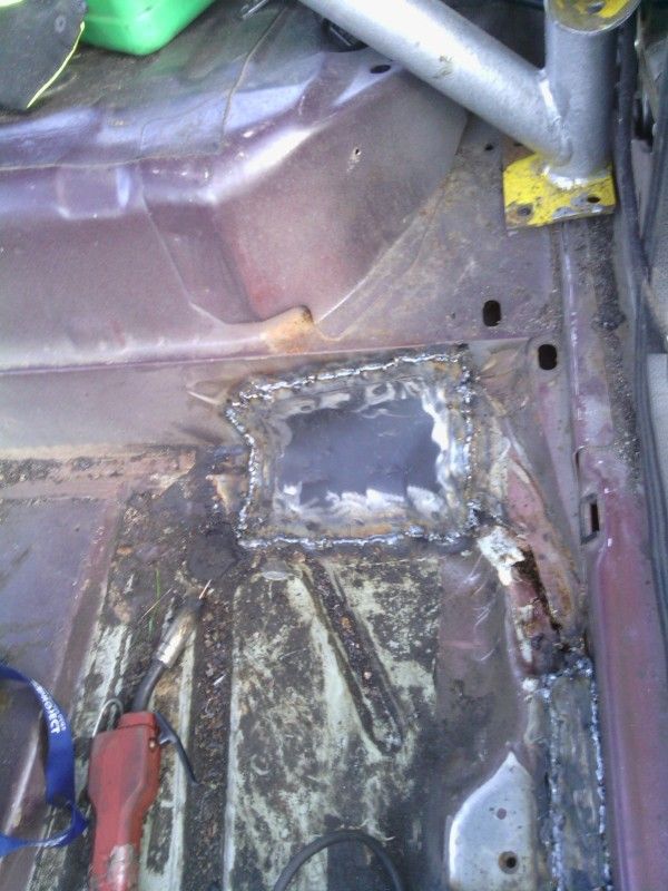

This evenings effort (2 1/2 hours work at a slow pace)

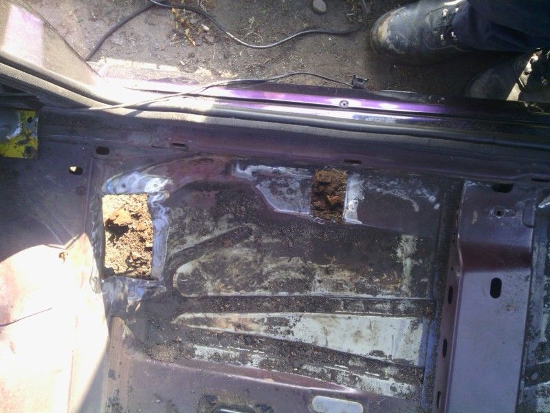

Just next to seat mount:

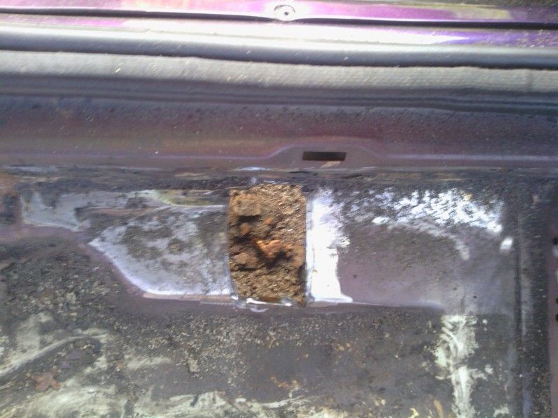

Rear of floor pan just as it goes up over the tank:
Both... thinking this isnt too bad tbh!

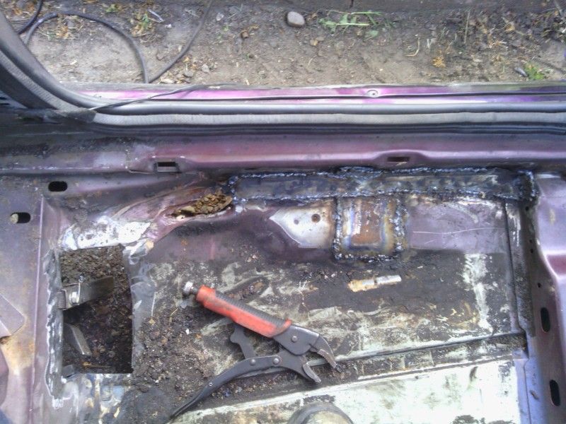

Welded seat mount bit and then went along the edge up against the inner sill... which then uncovered another weak spot!
Welded up the rear hole:
Welded up the other bit:
Found that under that corner where the rear of the inner sill is, is basically fucked, so need to get under the car and do that at some point :rolleyes:

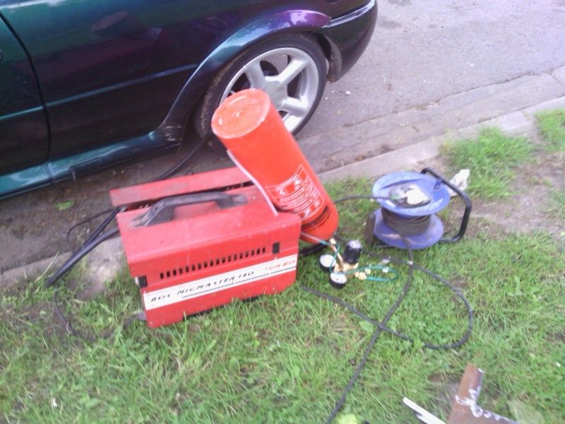

Can I just ask, what type of welder do you have?
And yeah, maaan that's a hell of a lot! I now understand why MOTers have always said that mine is in decent condition.
PostPosted: Tue May 29, 2012 9:59 pm
Erm I'll have a look tomorrow, its just a mini gas mig... using co2 fire extinguisher as gas :lol:

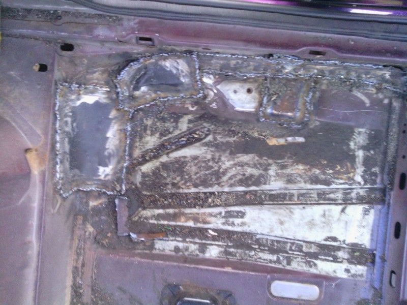

did some more tonight... didn't bother with photos as I was busy.
floor pan on the inside is now complete.

not paying anything... got plenty of wire with the mig... im using metal and gas I have acquired from work lol.
PostPosted: Wed May 30, 2012 9:24 pm
the fire extinguisher hahahaha! thats genius, didnt think that'd work!

yeah co2 extinguisher... uses pub gas sized regulator so works fine. just need to keep it upside down. lol
