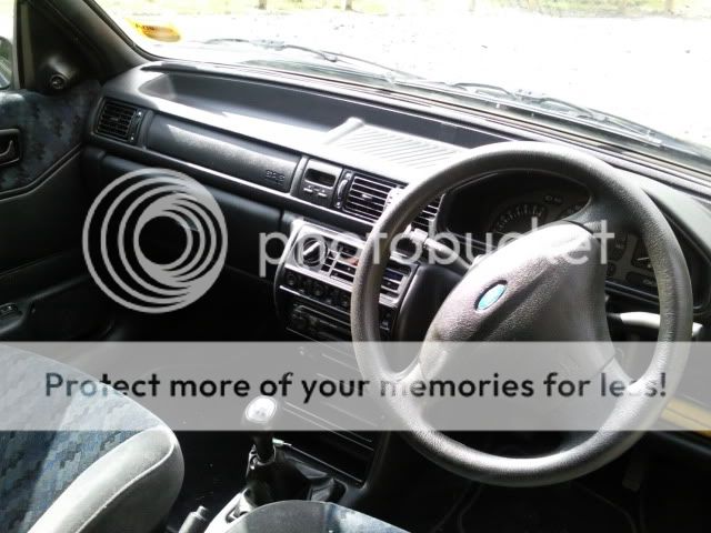

heres an early photoshoot of it, my fondest memory of it :hsugh:
pretty standard minus the 30mm drop and tinted rear lights
little photo shoot where i work :Q
not taken decent pics with the original wheels on since lowering so
seems to be only down 30mm, will be fine for now, ill drop it to 40mm in a while
