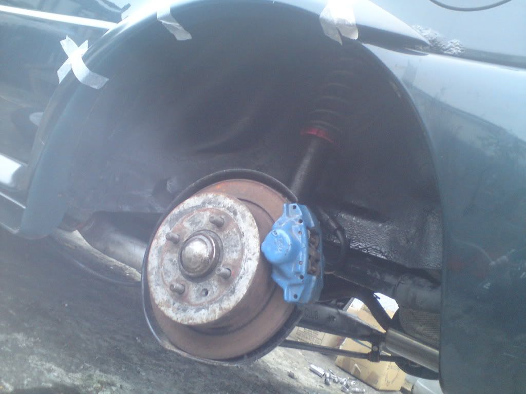

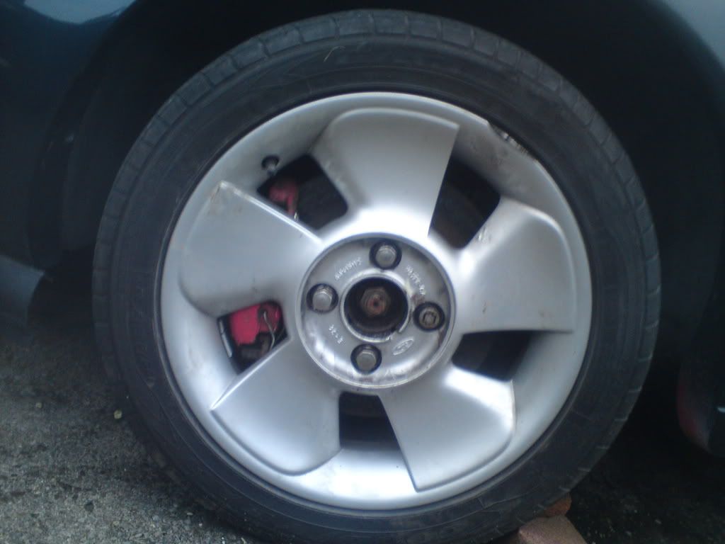

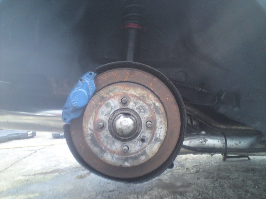

anyway, bled the rear brakes yesterday afternoon.
good news is they work!
bad news is they dont work to their full effect.
when you stamp on the pedal you can still turn the rear wheels a bit, so i dunno whether they need bleeding again or maybe theres something wrong. but will find out soon. im taking it down work this week hopefully.
also i still need to connect the handbrake cable up.

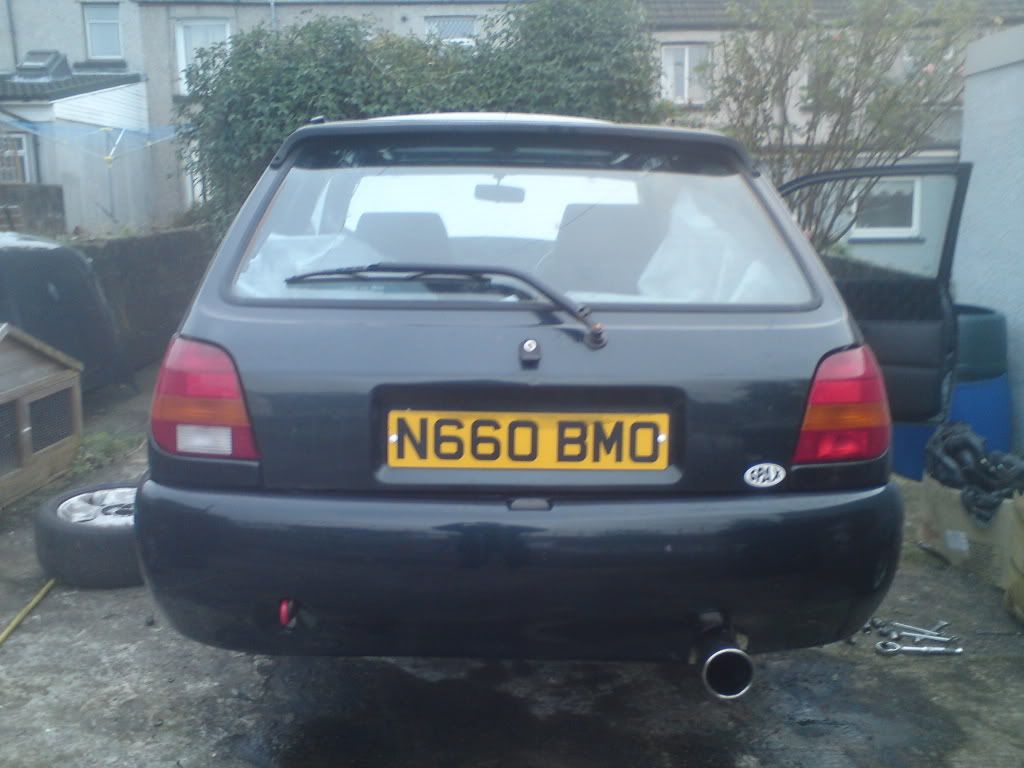

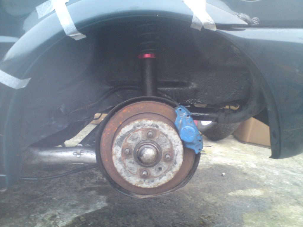

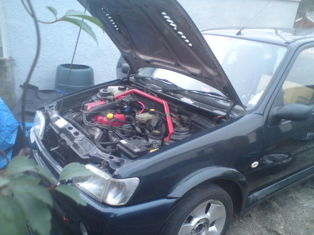

anyway heres some better daylight pics.
and a few random ones

as for your brakes not at 100%
they should lock and stop you hand turning the wheels, but the fiesta servo will be really overwhelmed by 280's and 260 rear discs, specially since they're 2 pots
get a escort mk5/mondeo servo on her then watch them :D
PostPosted: Mon Nov 21, 2011 11:33 pm
yeah i know that lol
yeah it needs a bigger servo, master cylinder now. i wana fit a mondeo one though, not an escort one.
and the rears a 270mm btw ;)
PostPosted: Mon Nov 21, 2011 11:49 pm
measure them theyre 260's as they fit under 14" wheels :D
well actually like 158mm but ya know :P
the focus ones are the 270s
escort ones are the same size :)
just needs the servo bar shortening which is peasy
PostPosted: Mon Nov 21, 2011 11:50 pm
Posts: 872
focus ones are 253mm std and st170/rs are 278mm on the rear
PostPosted: Mon Nov 21, 2011 11:53 pm
no offence mate but i disagree
if they were mate my 14" wheels wouldnt fit over them ;)
PostPosted: Tue Nov 22, 2011 12:09 am
http://www.rsownersclub.co.uk/car_info/esc5rs2.php
270mm it says here.
14s probably do fit over them because of the offset of the discs.
PostPosted: Tue Nov 22, 2011 12:13 am
270mm could just about clear 14s i guess
but no way would 280's
