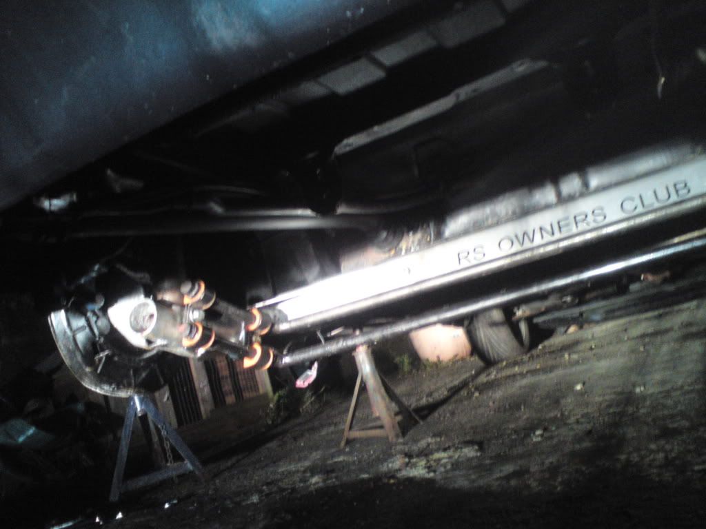

All the bushes are fitted to the axle/arbs now.
Axle bushes were soo easy!
after standing around looking at them for around quarter of an hour and the boys telling me they were gona be a nightmare to get out and theres no point in changing them for the poly ones coz the standard ones are already solid rubber ones, put a bit of heat on em from the oxy acceteline gas, gave em a good whack with a hammer they came flying out! cleaned up the hole,slapped plenty of copper grease on and simply pushed the poly ones in by hand! was done in 10-15mins!
been having a bit of trouble tonight though getting holes in the mounting brackets on the arb to line up, pain in the arse as their all bent out of shape.
but i will finish sorting that tommorow afternoon, might just widen the holes a bit to help the bolt fit through.
hopefully fitting the axle onto the car tommorow as well if all goes well.

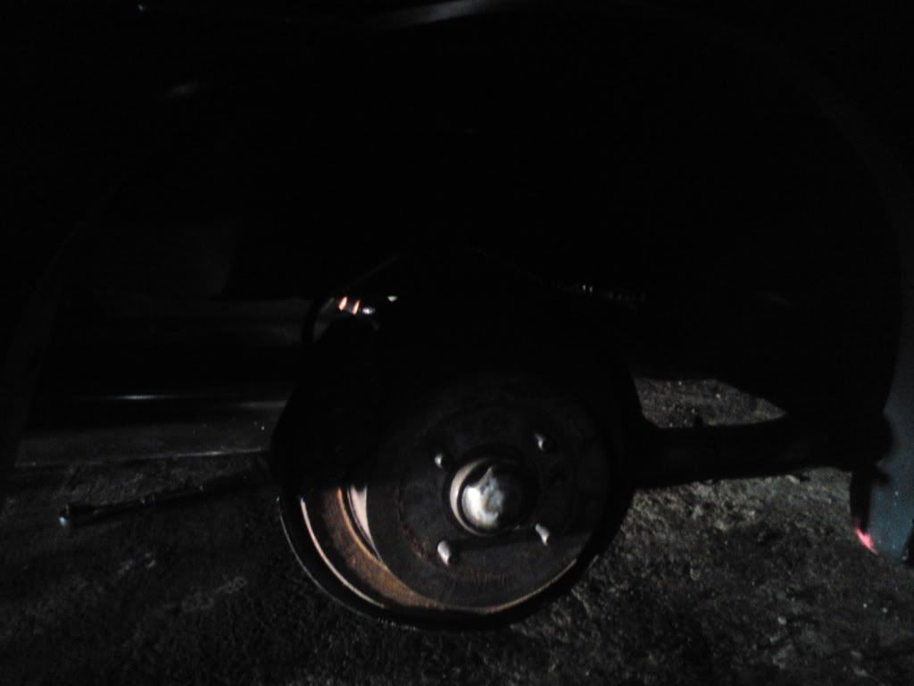

well the axles on the car!! finally! lol been sat in the garage for a year and a half!
was a right potch to fit it, on my drive, on my own in the dark lol. got the old one off including flexis and handbrake cable and then fitted the new beam on in about 2 to 2.5 hours, which isnt bad i dont think considering conditions. my backs aching now though haha.
finished fitting the arbs to it in work earlier this afternoon, had to drill the holes out a touch with the cone cutter to help them line up so i could get the bolts through. got some new longer bolts for it as well.
its on there now, just gota finish a few bits on it in the morning.
the brake lines are piped up but leaking at the moment as ive used 2 washers in between the flexi and the metal brake pipe so the union doesnt tighten up far enough. then need to bleed them.
and i just need to connect the handbrake cable to lever. the cables a bit short at the moment though, might need to adjust it in the drum to connect it up but i dunno yet.
will service the brakes when i get it down work anyway. think it could do with 2 wheel bearings as theres a bit of play in them as well.
well heres some crappy pics for now as it was dark, but i will get some better ones tommorow.
PostPosted: Sat Nov 19, 2011 10:37 pm
Thats one savage rear axle!
PostPosted: Sat Nov 19, 2011 10:41 pm
haha.
it weigh a bloody tonne! more than the standard one! im suposed to be losing weight not gaining it lol.
least it should corner better now though. and stop quicker!
