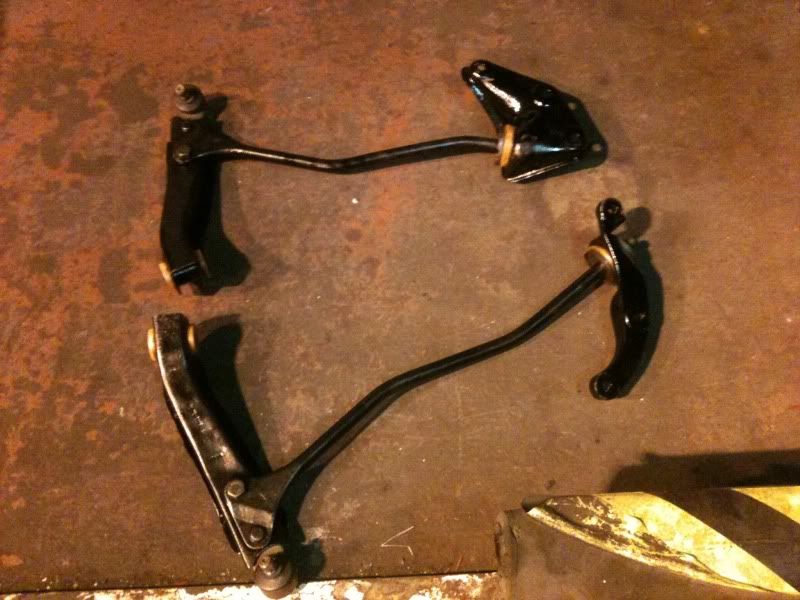

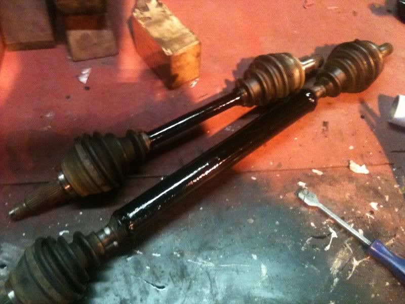

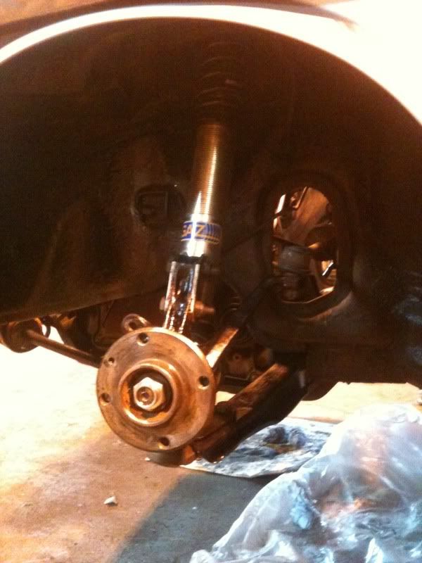

cleaned painted and started to refit the fron suspesion components with new poly bushes and ball joints
hubs have also been cleaned painted and new bearings fitted.

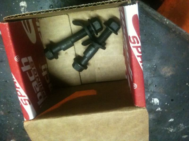

also recivied my eibach camber adjustable front suspension bolts

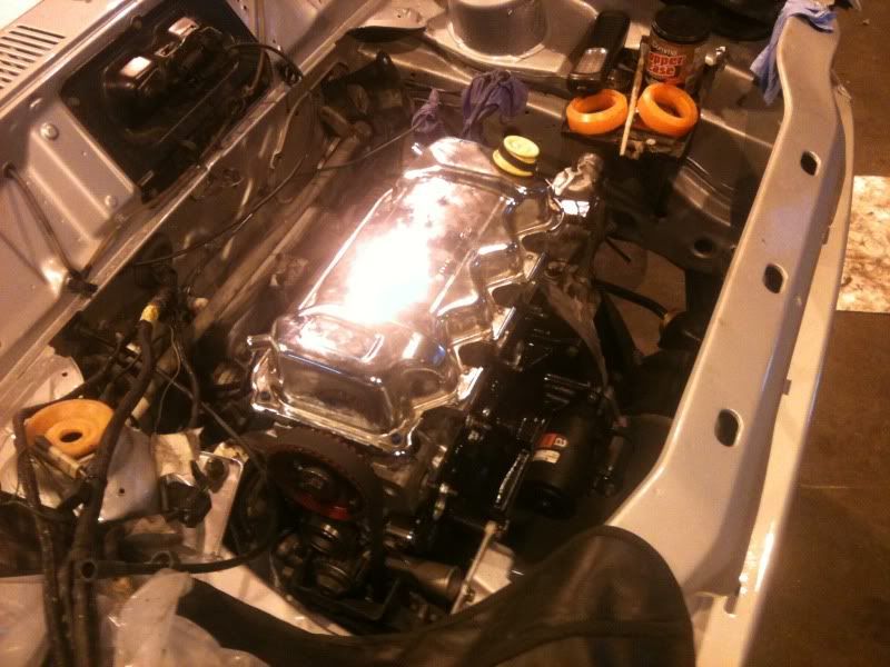

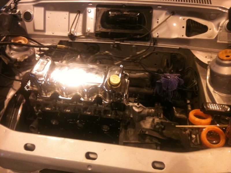

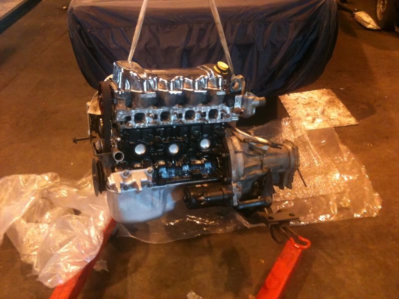

been feeling really crappy so have done sweet fa but i have fitted the engine this evening

trying to figure out them bolts :P
 Post subject: Re: my mk2 xr2 rebuild
PostPosted: Sun Nov 13, 2011 7:53 pm
Posts: 872
on the mk2 the shock bolts to the hub unlike the mk3 where it sits in the hub
the bolt goes in the top hole and is cam shaped so depending which way its turned will change the camber

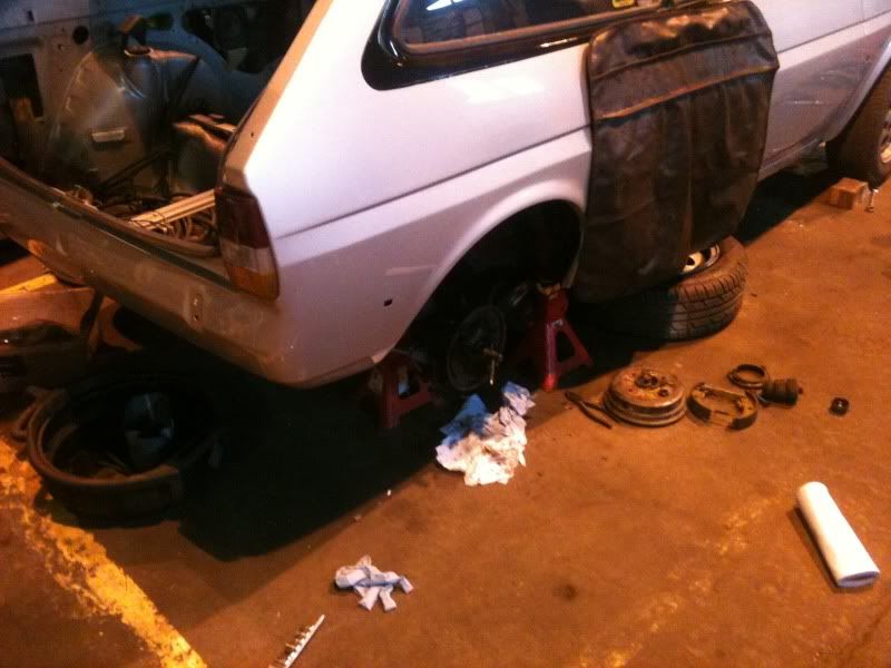

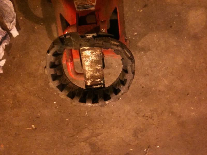

fitted the front suspension today and removed the rear suspension and striped down the rear beam ready for refurb
hofully gonna get that refurbed
knackered top spring mounts

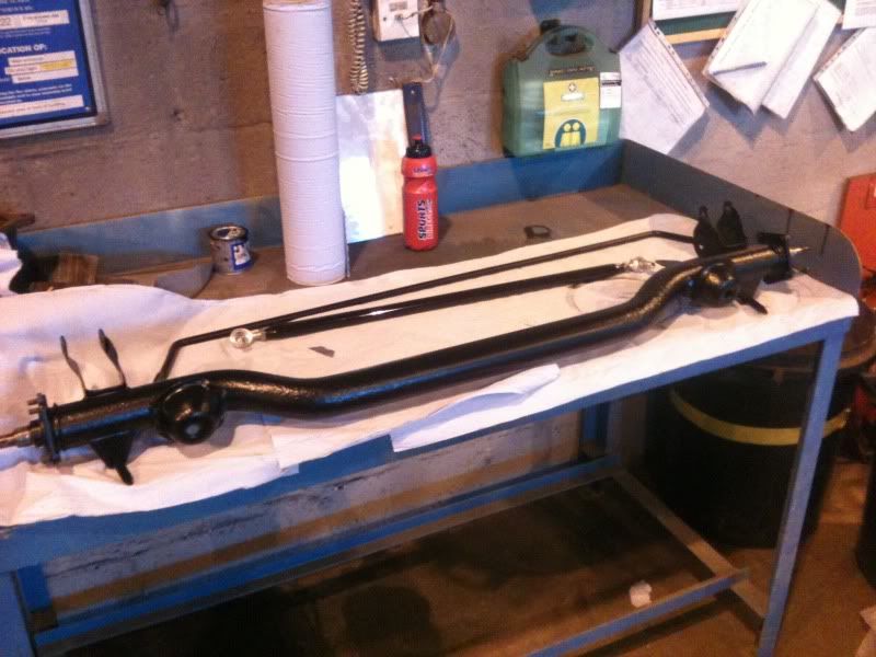

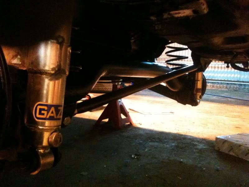

first off ive had the rear beam and arb powder coated black

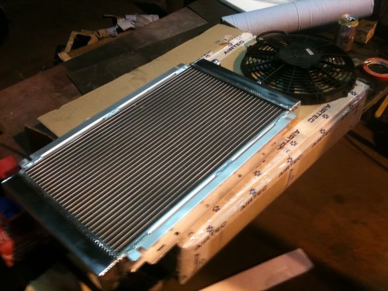

got myself an adjustable panhard rod and also a alloy rad and slim line fan
poly bushed the trailing arms
got all new rear shoes cylinder and fitting had a right nightmare fitting it all

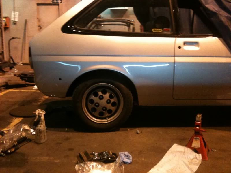

rear beam and panhard rod all fitted up.
didnt realise till this morning that i didnt fit the bump stops so had todo them today and also fit the rear braided brake lines after sorting out the holese to make them fit

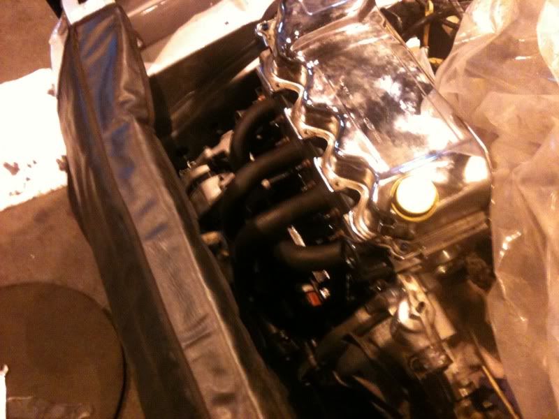

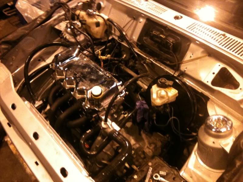

well today ive been cracking on with the engine bay

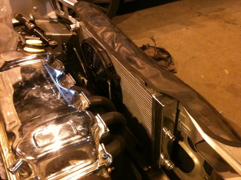

got a new altinator fitted, exhaust manifold sprayed up and back on, rad and fan fitted and also fitted the mondeo master cylinder and servo and dry fitted the silicone hoses
