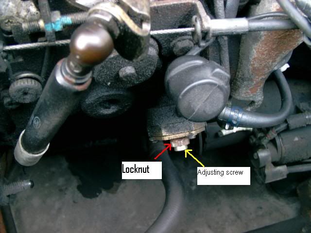

dunno how to turn up the preboost :(
PostPosted: Fri Apr 15, 2011 7:11 am
14mm spanner to un do the locknut
4mm allen key
wind it out a couple of turns, lock it off, and enjoy.
PostPosted: Fri Apr 15, 2011 5:31 pm
Fucking genius! And that's it lol more omph
Rad in or out?
PostPosted: Fri Apr 15, 2011 7:23 pm
Better to drop the rad down unless you can get your hands in there, bit awkward but do-able
Might be able to get it from under it without moving the rad, I didnt try.. but thats what I did when I had the same lump in a smaller fiesta bay.
Will give you alot more oooomph for the turbo to kick in.
PostPosted: Fri Apr 15, 2011 7:43 pm
cheers ill give it a go, if it smokes like fuck you've gone to far? :P
PostPosted: Fri Apr 15, 2011 7:52 pm
do it 2 turns. it wont smoke when it gets on boost so ignore it lol

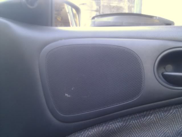

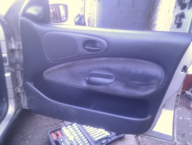

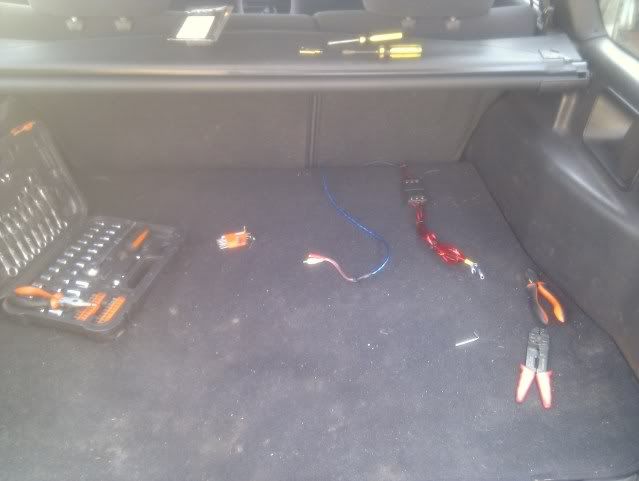

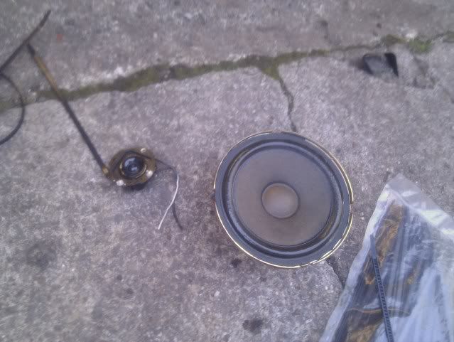

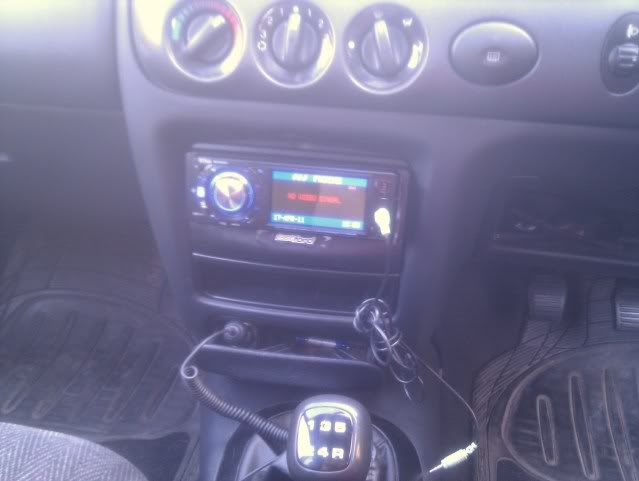

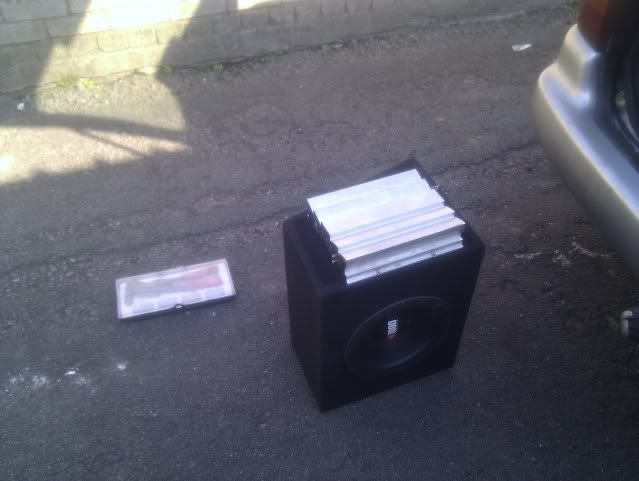

well i was playing around today in the lovely sun
swapped the speakers and sub over from the fiesta

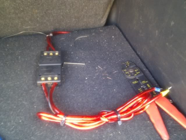

after running the power cable, remote which is attatched to the rca leads which were also run and hid under the trim
heres my new quick release coupling from Vibe i got from work, good kit this, quickly unplugs so you can remove the sub easily, handy in an estate ;)

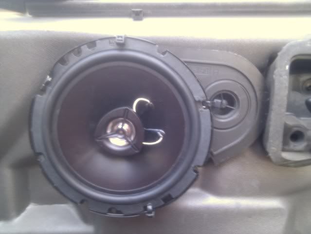

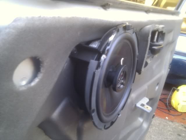

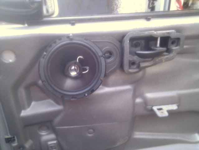

sub sites nice in the boot, and is bungie strapped down using the standard fixings in the boot, the standard escort sound system is very good when used with a sub, but just to be on the safe side, ive fitted my 16cm speakers too

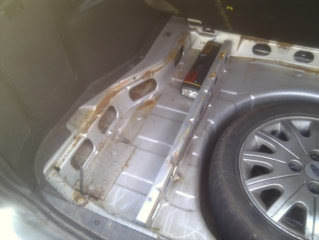

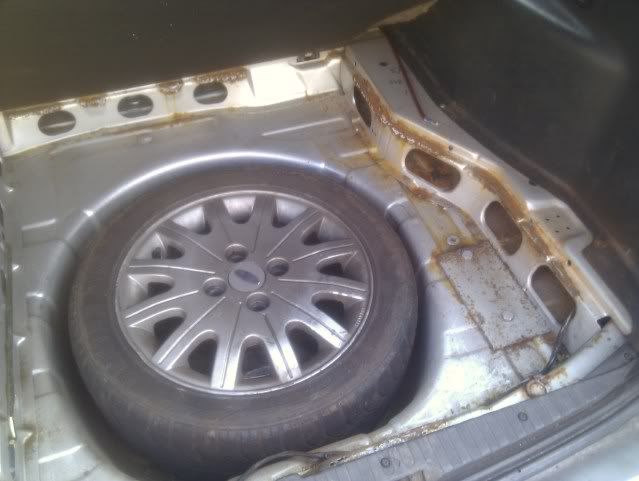

while fixing the ground cable tot he boot floor, noticed that theres alot of rust around the boot floor, so started to ground it back ready for painting
odd that my spare wheel is a focus Ghia alloy
PostPosted: Mon Apr 18, 2011 1:22 pm
Nice work, I'm just about to drill some holes in my boot floor to attach my sub down properly :lol:
