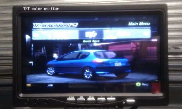

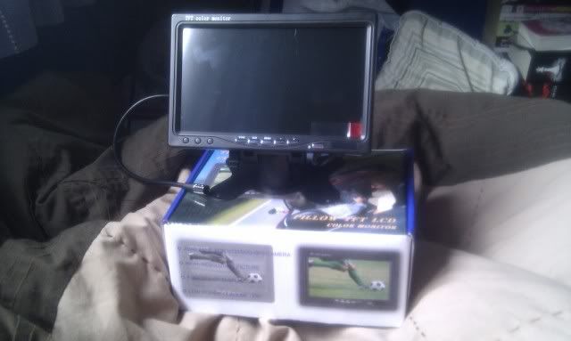

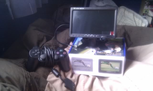

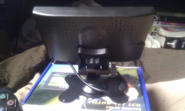

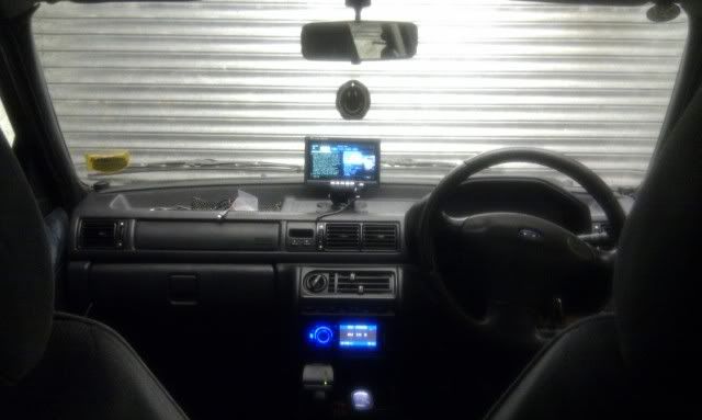

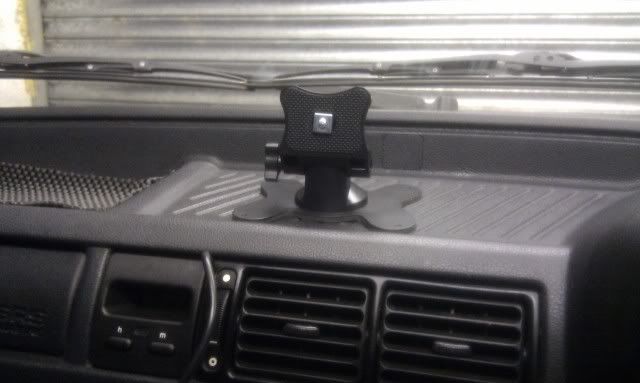

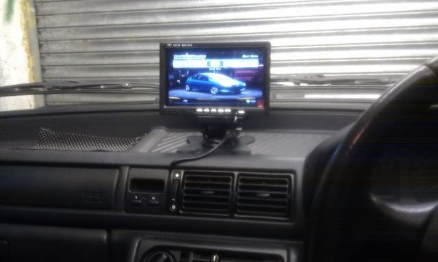

UPDATE!

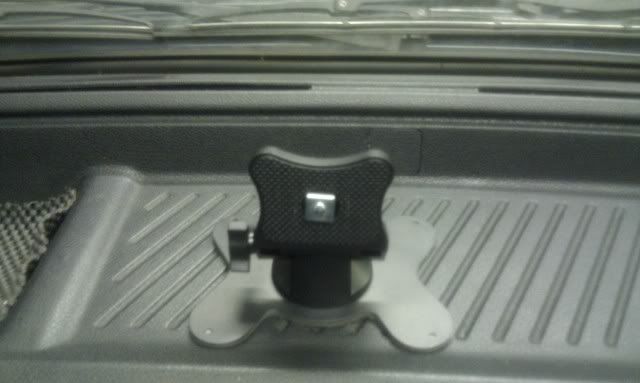

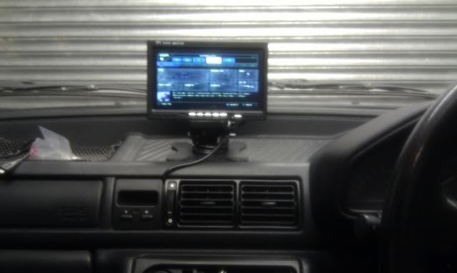

for size comparison
the new "ebay tablet"

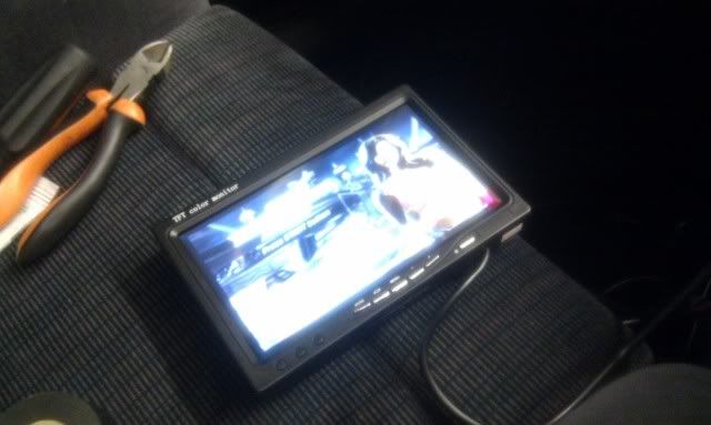

fitted and wired in (they spelt colour wrong)
back seat view
much better, can now enjoy films and games in the car. the good way

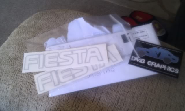

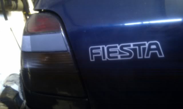

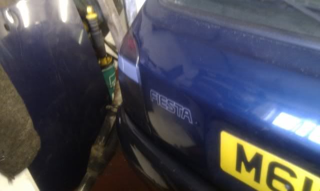

my new fiesta badge come today
a nice retro early mk3 decal :Q
suits the colour in silver imo

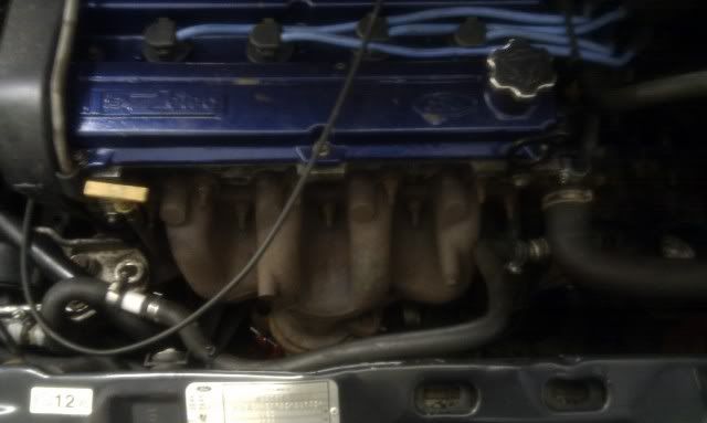

and the standard manifold and cat
finishing it off today now im home from work

lol mate, lovin' all this. guessing you will be taking the screen down when you park etc? or is your area the type where you can leave the door unlocked, keys in the ignition etc and nowt will happen? :p#
either way mate, loving the car

Dunno what to think of the screen lol, bit in in your face for me. But ive been through them days :lol:

The New Fiesta sticker looks at home :) Not to sure im a fan of the screen either tbh..... but not my car is it :)

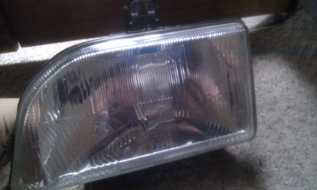

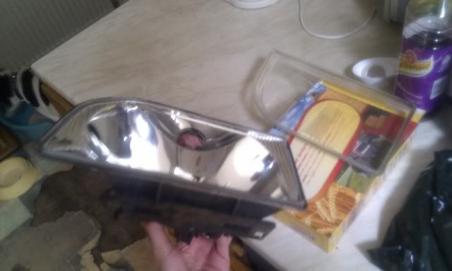

mot day today, so got to checking it over and prepping it

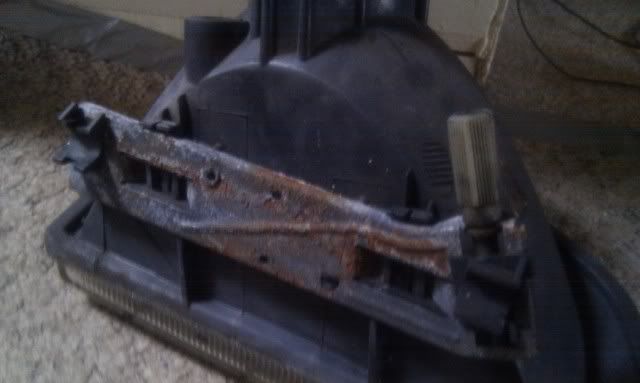

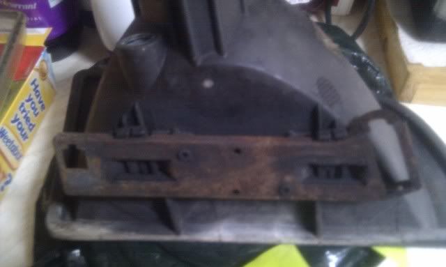

had condensation in my headlamp, took i t off and it fell apart, no wonder it had water in it :rolleyes:
so dug out my spare, it was in the crash at ford fair and lost its clips
so removed the clips on this knackered light
on new lamp
bulb back in and good to go

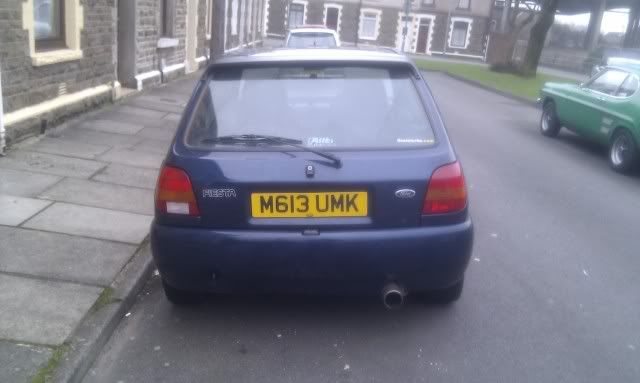

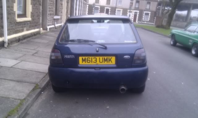

fog would appear white and they lack a reflector strip, so needed to come off for the test ( yup the new fiesta decal aint applied straight :rolleyes: )
not seen it like this in a good half a year or so

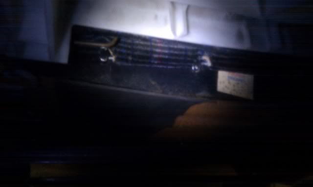

checked why my airbag light is on flashing when driving, took the cowling off the column, wiring plug was fine, took the bag off the wheel again fine unplugged and plugged both back in, took the speedo clocks out to remove the bulb, refitted it, tried the ignition and all was fine, bulb went out after a few seconds and didnt come back on after a few attempts

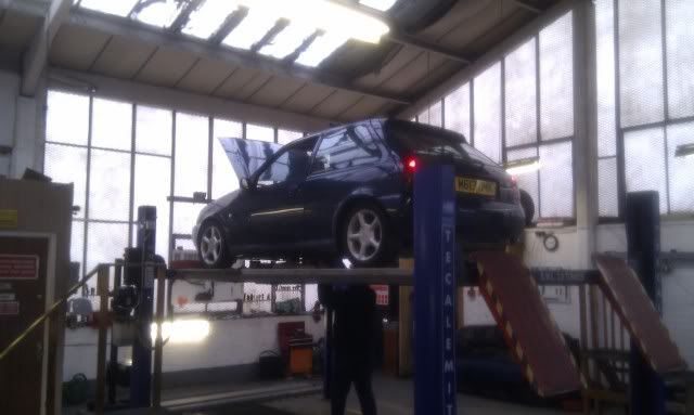

 Post subject: Re: Petrol Blue 1.8 Si
PostPosted: Fri Feb 18, 2011 7:58 pm

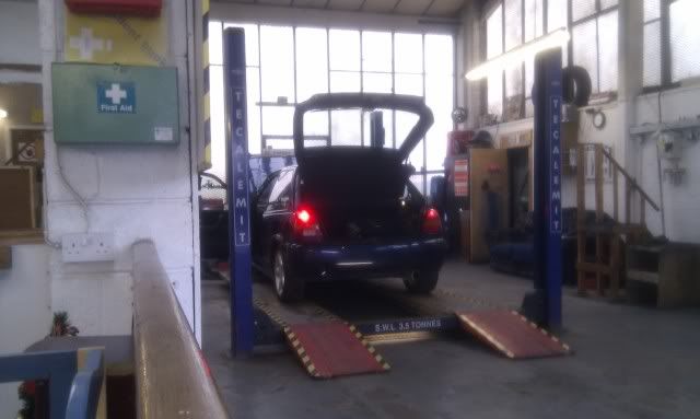

having its skirt lifted and a good rummage under neath :lol:
might leave the standard lights on for a lil while it looks nice like that, makes a change :)
i love how mot testers give it a good old ragging to see if its worth a pass
i mentioned the wishbones ball joins are looking a bit past it, he took into consideration the fact my invoice for the new ones was sitting on the passengers seat begging for him to have mercy, passengers side ball joint was goners, and the drivers not too far behind
he gave me benefit of the doubt and let me by knowing theyre going to be fitted with new ones soon ( this or next weekend )
it absolutely flied through the emissions test, knew it would :D
it had 4 advisories:
1: ball joins need replacing on wishbones/lower arms
2: passengers front damper is starting to leak oil
3: rear brake load sensor valve needs to be adjusted
4: rust hole forming on the rear passengers inner sill,
an actual hole but he knows ill sort it given the cars general condition and well looked after state,
the load valve thank god as i didnt know they could be adjusted, so atm its not letting my rear brakes do much as its fooling the valves as if its unloaded
the damper is a supprise but by this time next year i aim to either have coilovers or atleast uprated shocks such as Gmax
and the rust hole, im gutted lol, this car has not been welded yet and not its gonna need some :( ill cut it out and weld a new plate in, and then put underseal over it
but im happy its passed, very happy, paul at pauls MOT garage in sandfields port talbot, very very nice chap i was dreading the mot and he made me feel relaxed and i even enjoyed it, him and his assistant were fun to watch, and was done in 30mins, as a note he liked that i fitted polybushes all round, think he likes them

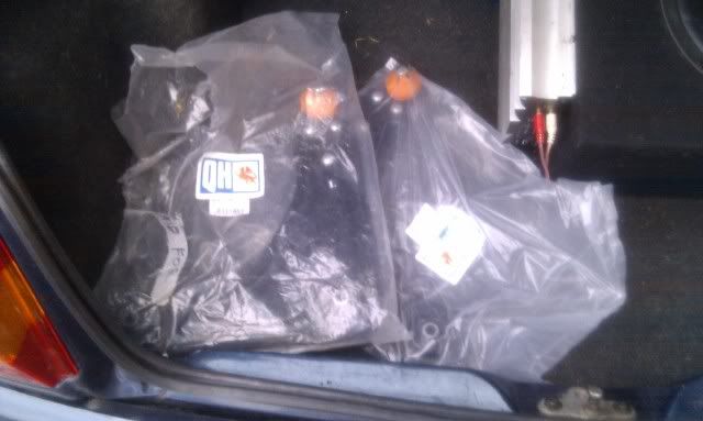

and my new lower arms i collected after the test, Jay should like this, QH :Q should be a great quality and both for £56, will fit them in a weekend or two

should get another 6 months out of those lower arms. lol

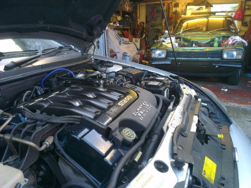

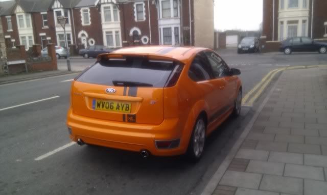

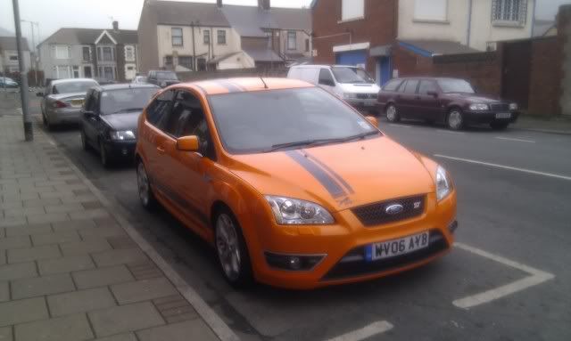

forgot to add, i know the man who runs the local motor factors in town, J.R motor spares, he drives this:
bought it recently, he had a fiesta ST before this, after than a 1.3 mk5 to be more economic, but this come up cheap, its a ST3 in WR300 spec, so good power and the graphics pack from Wolfrace, im in love with it

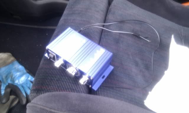

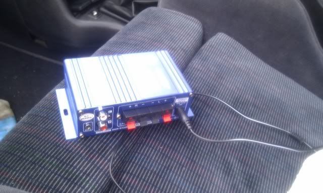

something arrived for me today
as my back speakers are much louder than the front with a sub in the boot and all, cant really hear the front, plus my drivers has stopped working again, wire keeps coming out of the plug on the back of the cd player :rolleyes:
so bought this china ebay special for £6 posted week and half ago, its a small 180w max amplifier i will fit undert he dash, its meant to be switched on and off, so ill wire it to the ignition live so i can just leave the switch on and it will come on with the ignition :), ill wire this for the front speakers :) should even out the balance
it can be used for anything you like, it uses 12v and even has a aux input

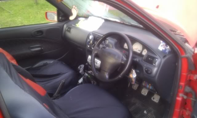

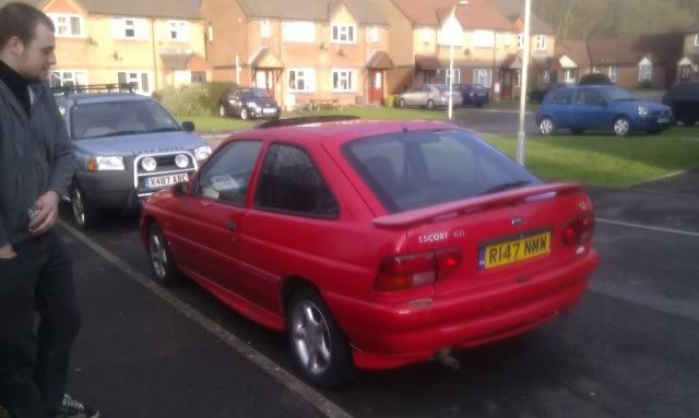

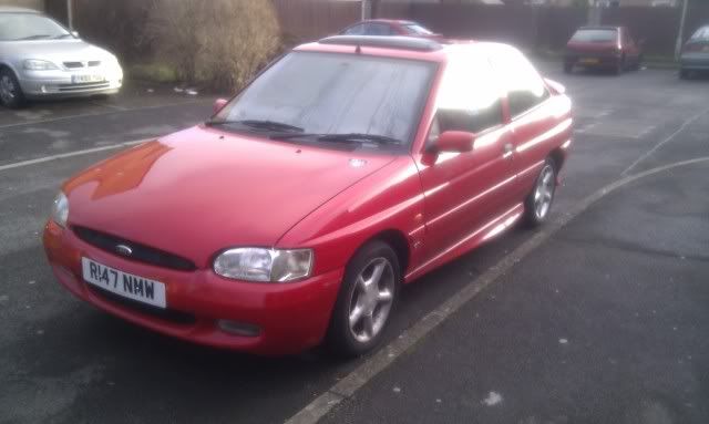

was helping matt strip bits off his puma today, after that (and 2 hours to get a wing off...) we went to have a last viewing of the GTi hes considering
its in good general condition, few issues to see it through a new mot, and will need taxing, needs a new tyre, some idiots at a tyre garage fitted a 185/60/15, when all the other tyres are 195/50/15 as normal, he will get that tyre off his puma
new brakes as theyre knackered, hes gonna fit his 280s he bought off me ages ago
and needs some of the battery cables rewired as theyve burnt theyre casings off
a new boot as its full of rust holes around the spoiler
rear bumper needs replacing, its cracked and the spat is hanging off
also its faded here and there, mainly the drivers rear quarter, we are going to buy a machine polisher between us as the Si needs a good polishing to rid it of scratches :rolleyes:
we used my battery to start the car as its one was dead and it wouldnt bump, after two little drives around the couldersack, the car stalled, and suddenly loads of smoke poured from under the bonnet, i shit my self jumped out of the car and yelled oen the fing bonnet, he struggled as the cables come away from the leaver, finally pulled it, blew the fire out, the earth cabled had shorted on something with live feed and caught fire :aaah:
bonnet has soot on it and a cable is bare now, wipped the battery off and left it, not detered he will buy it sometime in th week,a dn it will go in my garage at home to get fixed for the mot
pics
no test or tax, £400 with a spare blue bumper, should be around £700 car once tested and taxed and all sorted, maybe a bit more to get the bumper and boot sprayed, still below the average cost of a good condition Gti, usually around £800-£1000
and this is a rarer 3 door in radiant red
should be a good project for us :)

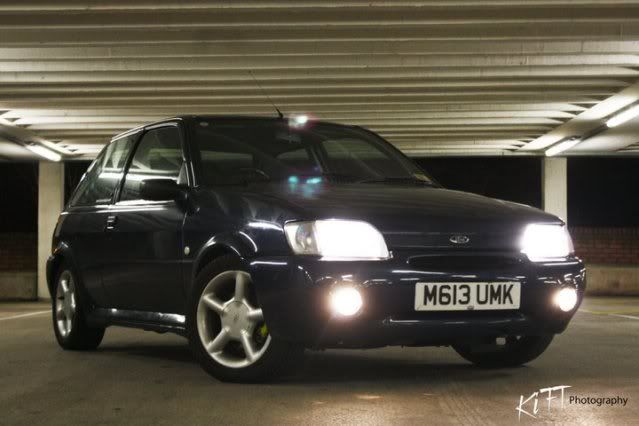

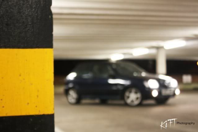

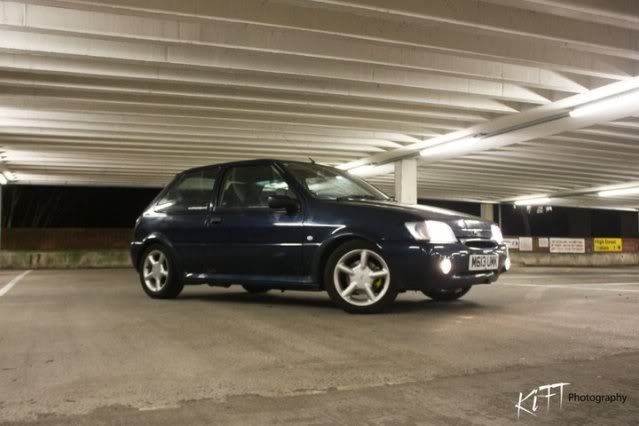

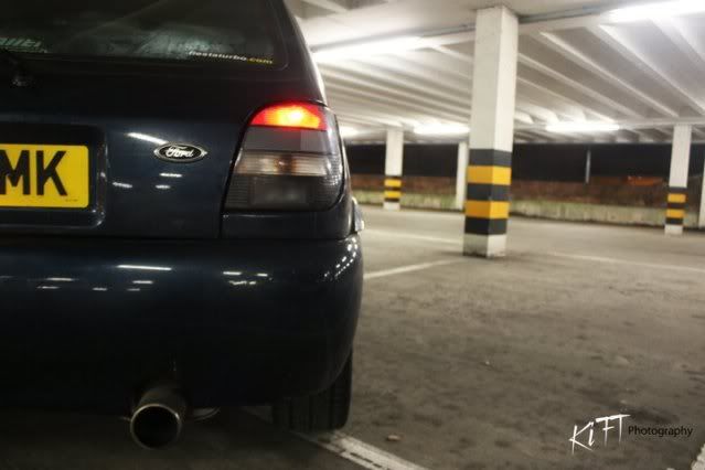

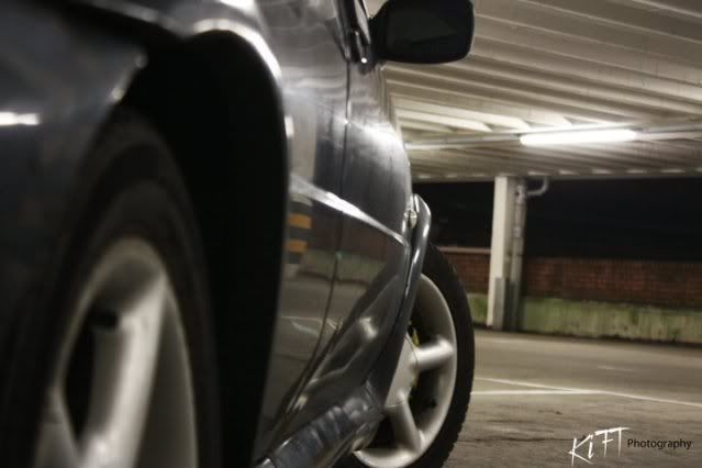

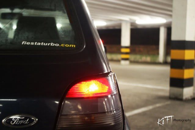

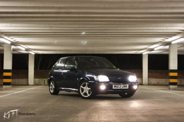

some of my photoshoot pics of come through
i think the pictures look amazing, some more to be uploaded, rest are on my facebook
pictures thanks to Stephen Kift, new upcoming photographer, the guys got some real talent and is more than happy to take some pics of peoples cars to add to his portfolio, will try and get matt do take the GTi once hes bought it and its road worthy :Q

tidy that mate
PostPosted: Thu Feb 24, 2011 7:19 pm
Could have at least cleaned it lol
PostPosted: Thu Feb 24, 2011 7:30 pm
the guys caught me off guard lol
plus it was pissing down outside, wouldnt have done much :P
say something nice danny! :P
PostPosted: Thu Feb 24, 2011 7:38 pm
Say something nice? Hmmmmmmmmmmmm :lol:
It looks nice! It does to be fair, not just saying that.
You need to space out the rear bumper so it meets the arches, chop chop.
And he needs to learn to focus his camera better in some of the pics... Thats my critisism towards the photographer lol.
