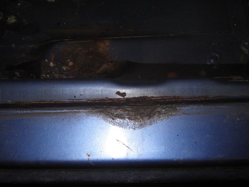

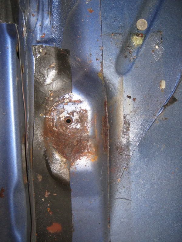

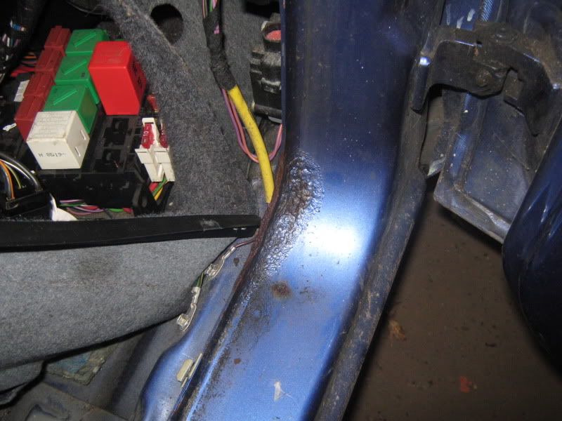

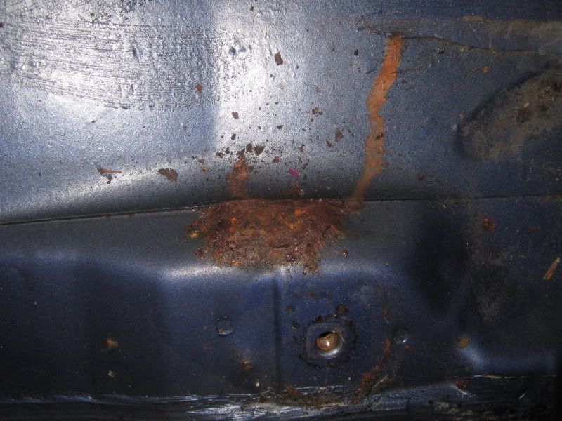

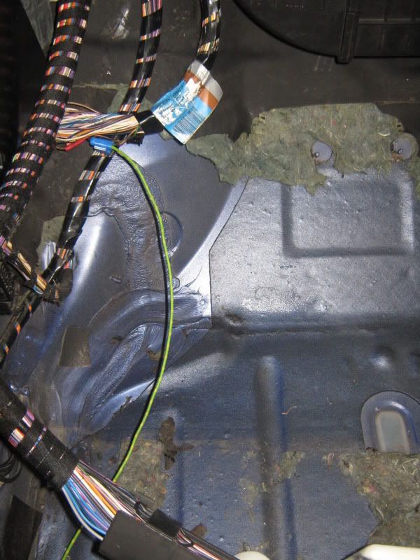

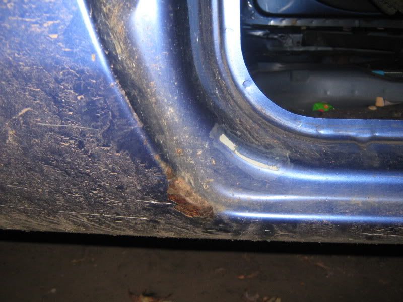

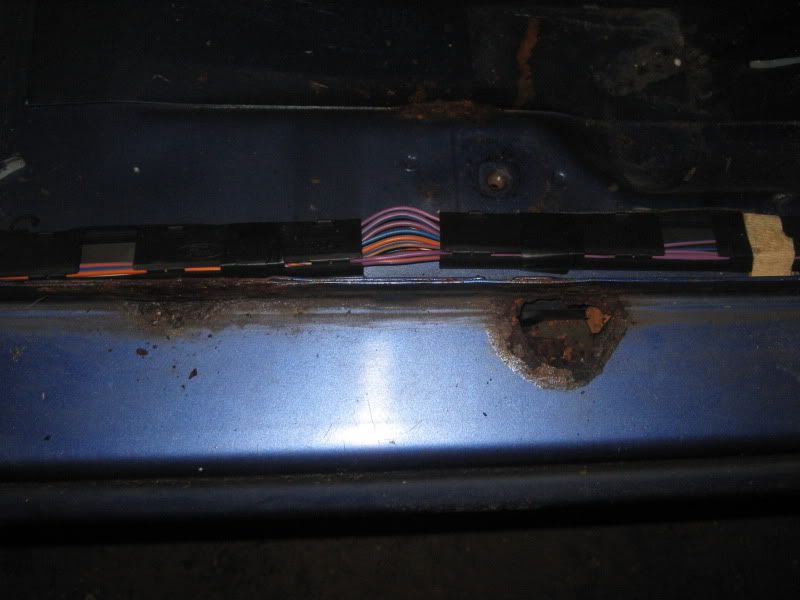

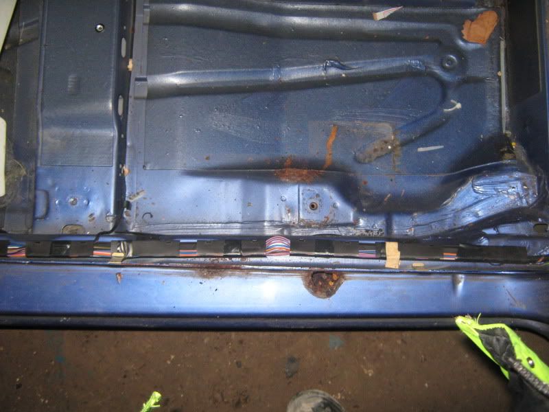

So as I never had a goooooooood look at it yesturday, I stole works camera (better than my phone) and got some shot of it!
Filler panel rust :blahblah:
Solid passenger side floor in the usual rot box area!! :D
Scabby passenger side
Scabby drivers side
So all I need is:
filler repair panel, and most likely the inner part too
both full sills
abit of floor work (nothing major TBH)
and the odd other bit
Floorpan under it isnt in bad condition, but I'll be getting it on the spit at some point to tidy the lot up!!

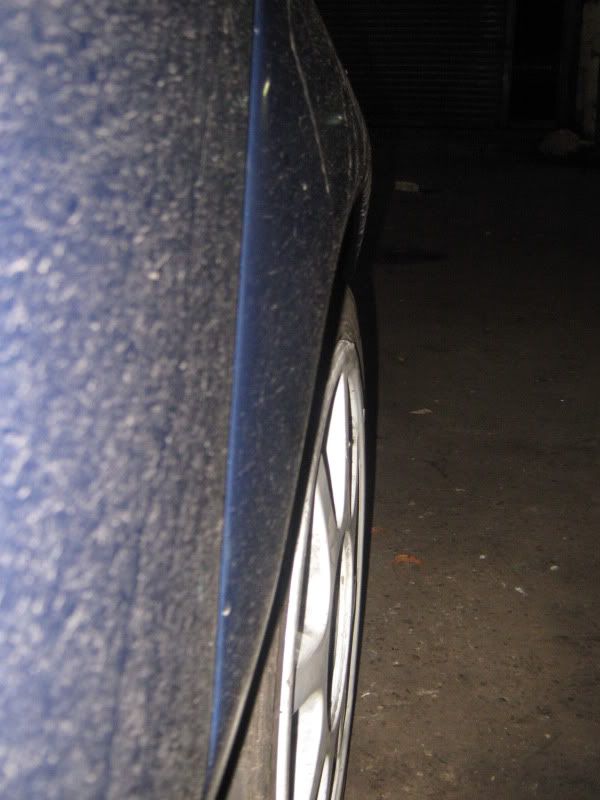

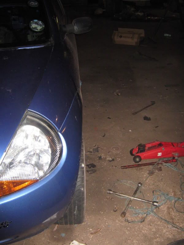

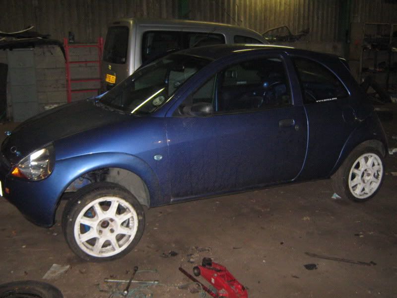

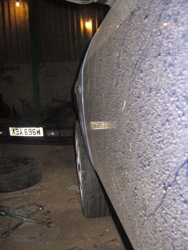

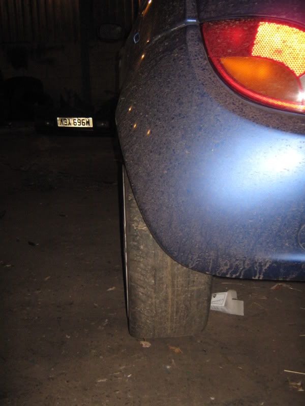

White wheel experiment!
As you can see the rears are fine, and even after lowering I have a few mm spare in the arches.
The fronts need spacing 3mm like they did on the fiesta as they are touching the suspension leg.
Due to lack of engine this is not giving me a true setup, so I need to do a test with the front lower down to see where the wheels sit.
I'm pretty sure I can *just about* get away with using the wheels, with a tiny bit of the ka inner arch trimmed
And not to go too mental with the lowering.. by that I mean no more than 50-60mm :lol:
But they worked on my fiesta, and it was a very very close call :teehheee:
If I can run the white wheels... I will !
If I can't, I'll drop down to some 15's and have it a little more sleeper style!
