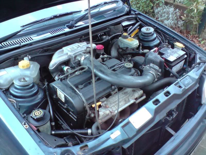

It's been a while since I posted about the car as I have been busy at uni and the car has just been taking day to day abuse rather than any work being put in :(
The 2.0 litre has been in for 3 months and 2000 miles and is doing me proud. There are a few minor problems that i'm going to sort out as i'm at home with time to work on it. :)
It has a water leak still as mentioned previously and i'm pretty sure that it's coming from the T piece section where I think it connects up to the heater matrix. There's 2 hose clips on but it's not holding the pressure.
Any one had this problem, what's the best solution? :? I think I can get away with not replacing the hoses but need to find a way of creating a strong connection.
Also, a problem from before, where I snapped the negative termninal off of the alternator but now I have realised that the crap soldering i did is loose and i'm not too sure how it's even making a connection :|
I need to find a way of attaching the wire, maybe using a chemical weld? But I have no knowledge whatsoever on doing it as I just heard about it on a forum topic somewhere.
When the fan kicks in the revs still are dropping to about 600 for a second before regaining idle, it's not too much of a problem but i'd still like to figure out what's causing it.
Finally, not to do with the conversion but my exhaust is hanging a bit on the rear and I think it may have lost a mount, or i'll have to make one to hold it up better for the speed bumps :lol:
Sorry about the life story, just wanted to see if any one else has experienced those problems.
Anyway, today I painted my cam cover in some black VHT paint:
It looks nice but really shows up the crappy exhaust heat shield :lol:
One more thing, I'm thinking of colour coding my alloys, I think it'll stand out (not that white doesn't :lol: ) but I'm still not sure if it'll just look gash. Have anyone got or seen Mallard green wheels to match the paintwork?
Thanks, James.
