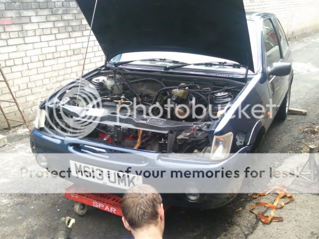

how it looked at the start
A dinner short break
and out! :) were very chuffed, no hoist and left the gearbox in, was tough wiggling it free but hey :) come out in the end
sits so much higher now with no weight in it lol, half the engine is in the boot lol so the back end is really low

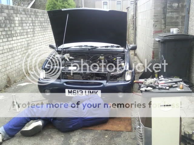

had more progress today, got the engine out of the Si, at long last, took almost 10 hours! ABS is a fucking PAIN! god, took hours to detatch it
im strongly considering removing it, anyone got any advice or shall i just take it all off, and by pass the pipes going tot he modulators to the juntion thing on the wing? should work
not that its gonna be too anoying to put back in but in the future again on removing engines or gearboxes etc it will deffo get in the way
bloody thing is useless anyway, sometimes it doesnt even prevent lock ups in the dry :rolleyes:
tomorrow im gonna try and find a hoist as i cant see me and matt lifting the engine and box in easy, anybody have any tricks or good ways ofgetting them in without a hoist???
matt wanted to prove that i do work as all the pic are of him (hence why it smy phone etc)

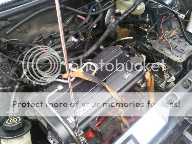

as i stand, much more tomorrow, should have the 1.8 back in, and running latest wednesday, b ack in work on thursday and leaving for silverstone Saturday :aaah: little time for a shakedown lol
pics of how it stands now
the 1.8 Image
the 1.6/gearbox
and the devilish ABS, i will retain it, ill put it back together eg drivebelts and covers prior to fitting the gearbox

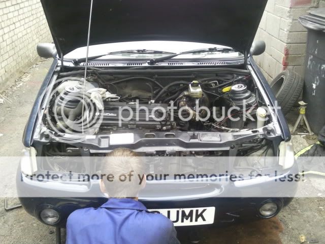

well time for the Si to have an engine back
sorry for the arty pics of the back of my head! but matt got camera happy and decided to rape my identity :rolleyes:
this was rather tence, never want to raise a car this high again, but sliding the entire lump and gearbox assebely in on the cart seemed the easiest method, matt was right with it
we started the day by cowering in the garage from the rain, removed the gearbox from the 1.6 and clutch with it, oh and since its such a good job and very unasuming, swapped the satin black cam cover too
pushed her around the lane to get cracking
my very own F.O.B camp bastion :oooh:
i was very wary of the slab of brick sliding off the roof onto my head underneath :aaah:
'Box fitted to the 1.8
up up away
the method, step by step, beam of wood to act as a crossmember, jack in centre, highten untill cant take it anymore with jack, hold with stands and add a brick tot he jack and start over a gain
the removed 1.6 with the polished cover
ready to slide into place
getting high now :oooh:
looks unsafe, but at a steady rate and using the stands as a failsafe and two pair of eyes watching it raise, it went up ok
under it goes, had to raise the cars front valance up to 34 inches :aaah:
its like it just swalled it whole :P
getting there 8)

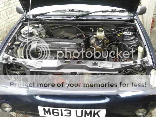

its almost ready for Ford Fair, need to loosen the timing belt tensioner a tad,belts too tight and is screaming for mercy, litrally!, and swap the water pump pully as its wobbling/wonky and hitting the cambelt cover a bit making a noise, the exhaust is banging around a tad so new mounts are needed and its ready to go :chill:
thanks for the kind words guys
the work is complete, in four days too, not bad, im very proud
to bypass the ABS
