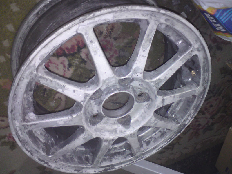

Refurbed the wheels this weekend! It's been a Nitromoors, sand paper, primer, paint and laquer job!
However halfway through I decided to measure them and realised that they are not 15" UKDM wheels, but 16" JDM '98 spec wheels! So that's £450+ gone on Pilot Exalto's in the next month or two :roll:
Anyway, pics:
Nitromoors effects:

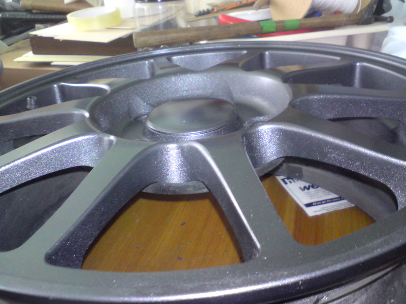

First coat - Gives a lovely dark grey effect, close to the standard ITR wheel colour:
But up close it sparkles and looks insane in the sun as shown here by the flash on my phone camera:

Percy it's easy enough to do yourself!
Just nitromoors the paint off, around a tenners worth will do it.
Lightly sand them if they need it with a mixture of 280git for heavy use and 1400 grit for lighter use. A few coats of primer (£12 = 2 large primer cans from halfrauds which is more than enough)
Then paint. I've used just under 1 can per wheel which is £6 a can. This is BMW Sparkling Graphite Grey.
Then Laquer. 1 or 2 cans at around £5 a can!
Then you're sorted!
