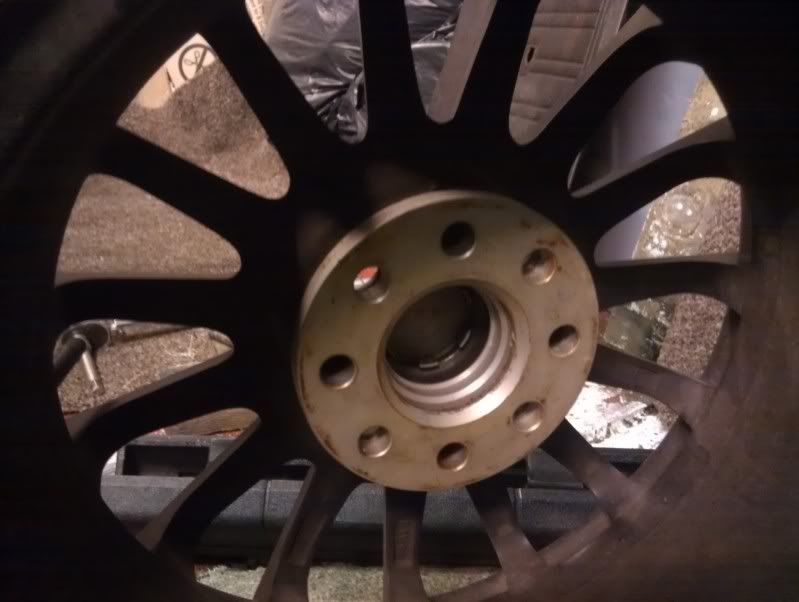

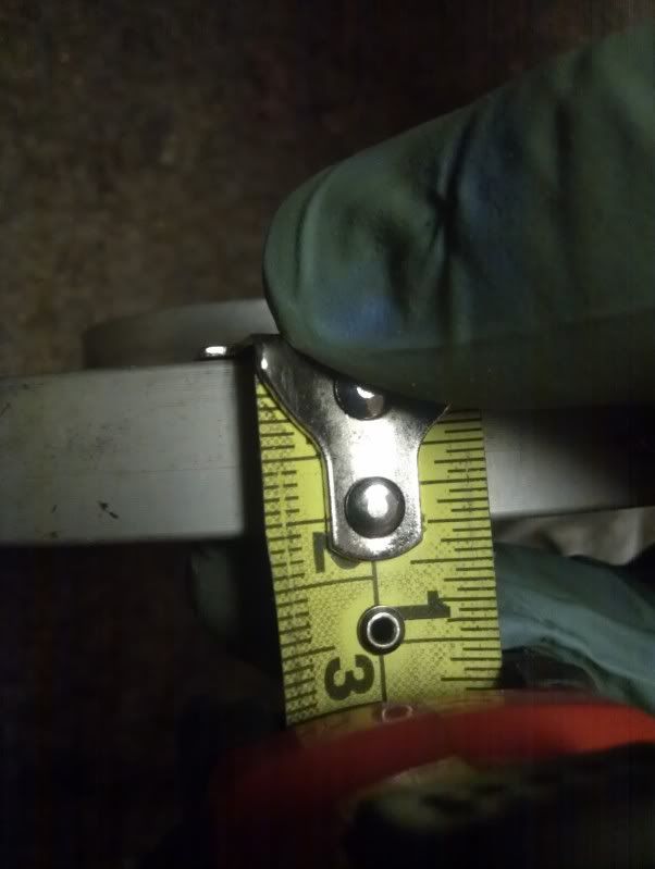

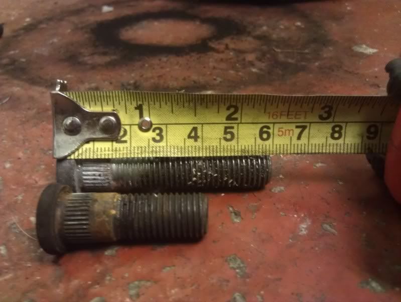

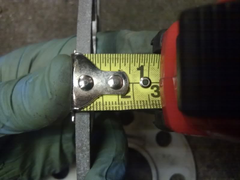

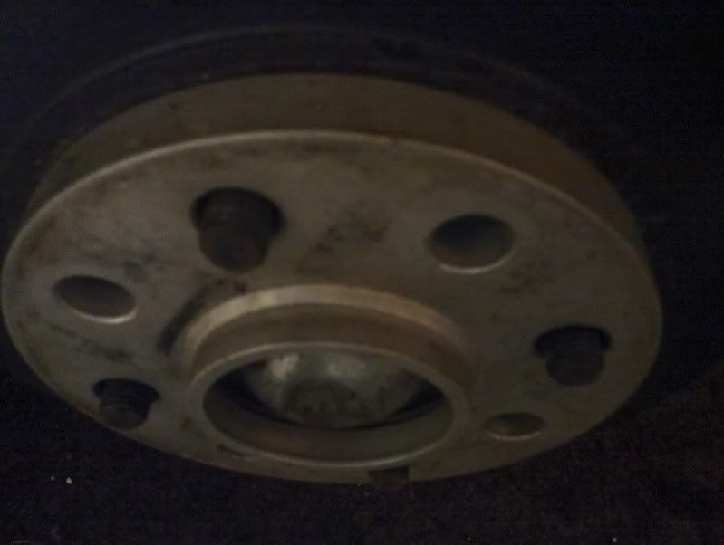

These little works of art arrived from ratspeed (fiestaturbo.com) yesterday, and after checking them over they are made to a superb standard by eibach, he also sent me 2 sets of extended wheel studs

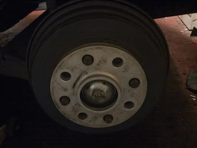

And ofcourse theyre 100% safe as theyre hubcentric spacers as you can see

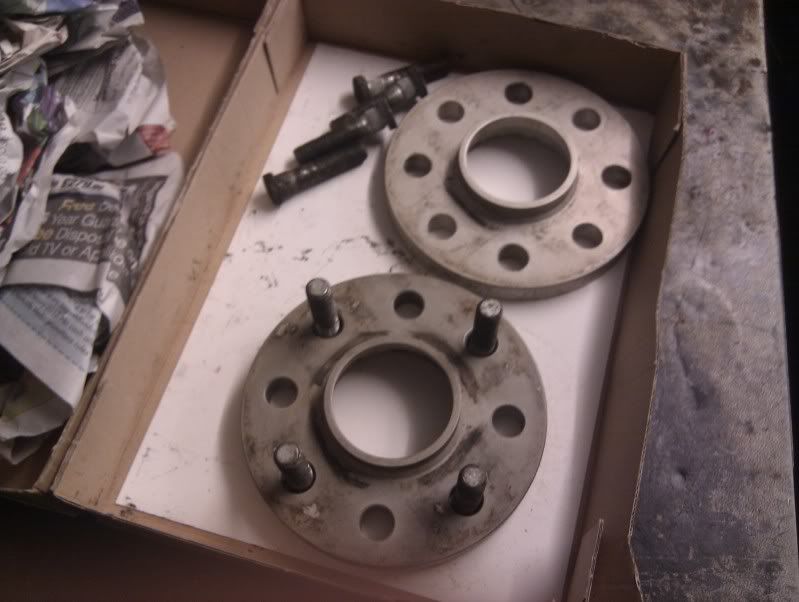

my old spacers (still have these on the front)

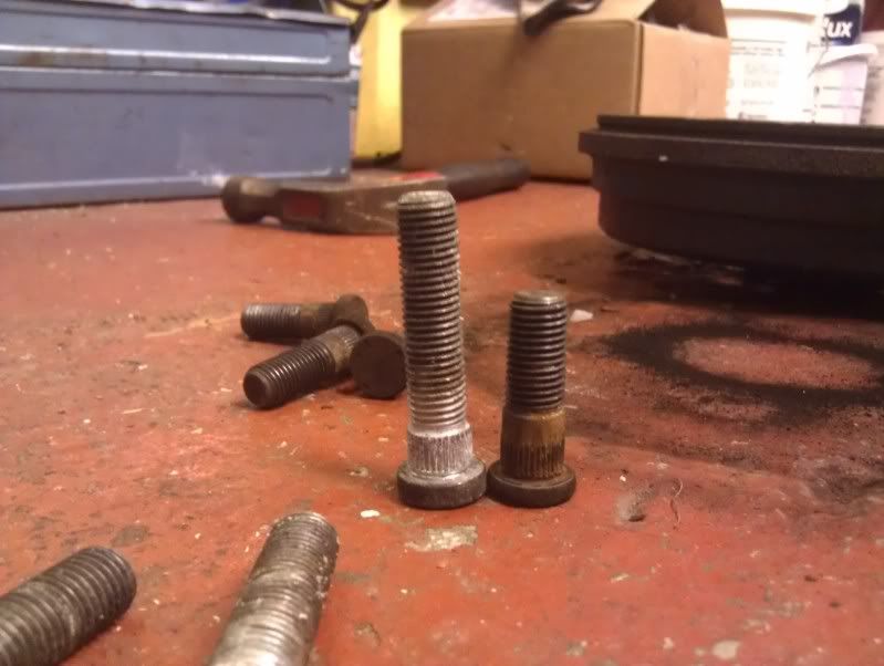

reason the studs are needed

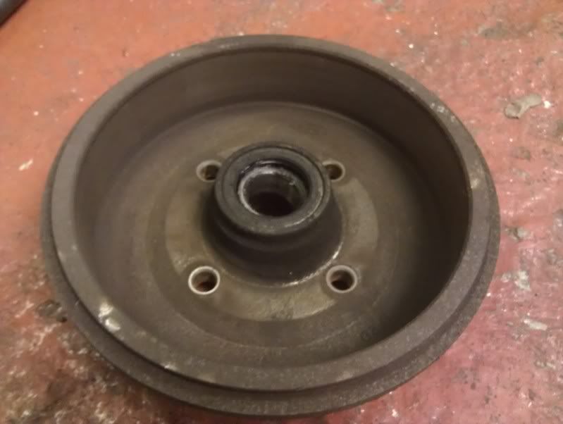

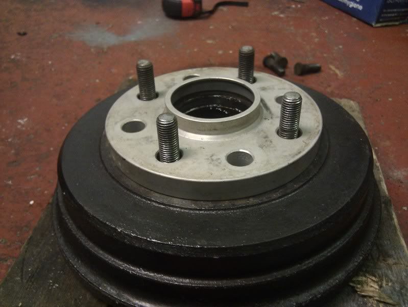

drum off brake dust cleaned away, and studs pushed out of the drum
cleaned the threads with wire brush before fitting them ofcourse
the 20mm extended studs are fitted in the splined holes via hammer blows, and checking the length

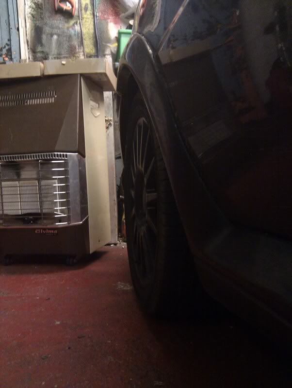

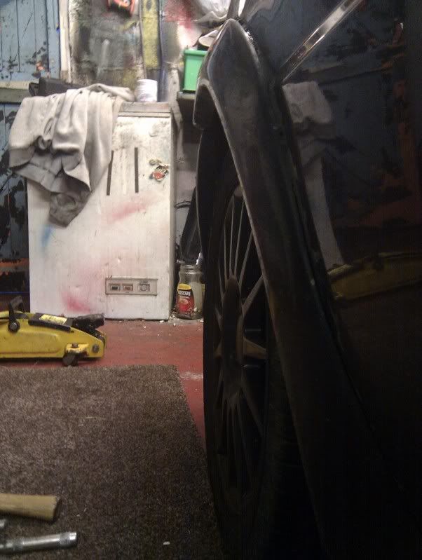

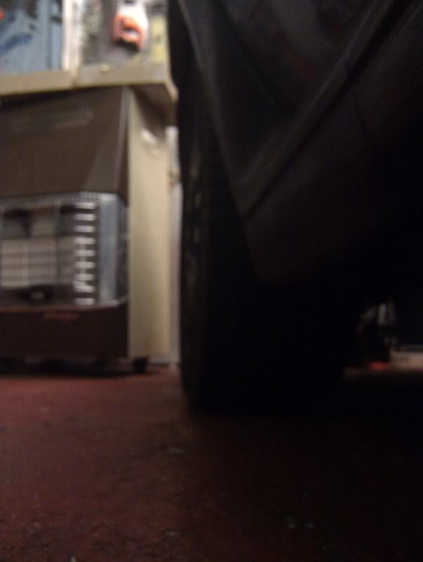

this is a before shot (drivers side)

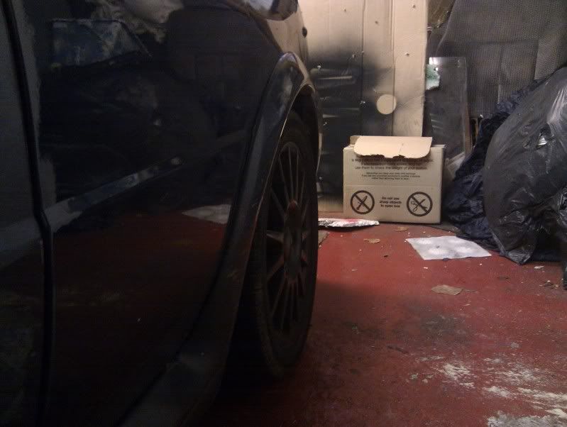

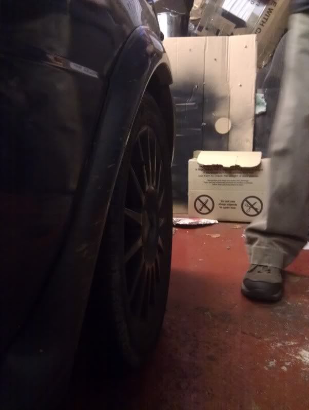

After both sides
Summary

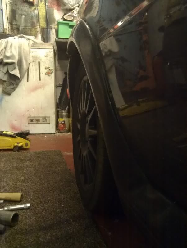

the extra 30mm wider track has spaced the wheels to nicely fill the arches, the camber has been changed dramaticly as you can see and all remaining safe, i can also add another 5mm by fitting my old spacers over the hubcentric ones and still be safe but ill see how these go for now
after a spint he car seems more stable and secure on the road, but its wet and dark atm also heavy traffic so ill give them a good test when its next dry
simple effect mod :)
