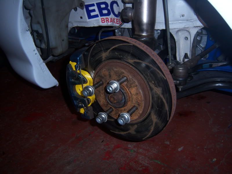

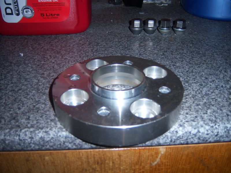

fitted longer suds to all 4 corners so i can fit hubcentric spacers to give the wheels a better offset and give clearance for the LEDA coilovers. The spacers where from a peugot conversion, so i knocked out the studs ( wrong thread pitch) and machined the spigget down to 63.1 mm ( ford fitment wheels)

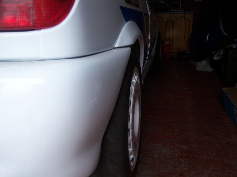

Also modified them to suit the car , ive kept the back ones 20mm to give a wider track on the back making the wheels ET15 and 12mm spacers for the front, to clear the coilovers and retain the wheel inside the front arches
Also fitted new yelow stuff pads to the front, and fitted new back shoes, and bled all the brakes back up with new 5.1 brake fluid
The front wheel with longer studs 63mm with correct thread for the ford bolts 13.1mm spline M12 x 1.5mm
The hubcentric spacers, i wanted these as didnt want just normal spacers which wouldnt hold the whell centre in the spiggot
The back wheel fitted to the car now , tons of clearance and fill the arches lovely now
