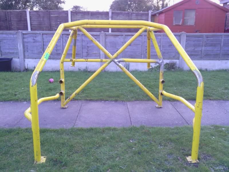

So I had a spare half hour today, so removed the dash bar from the cage and used a flap disc to make it smooth.
Behind shedule on cage, and polycarbs at moment.

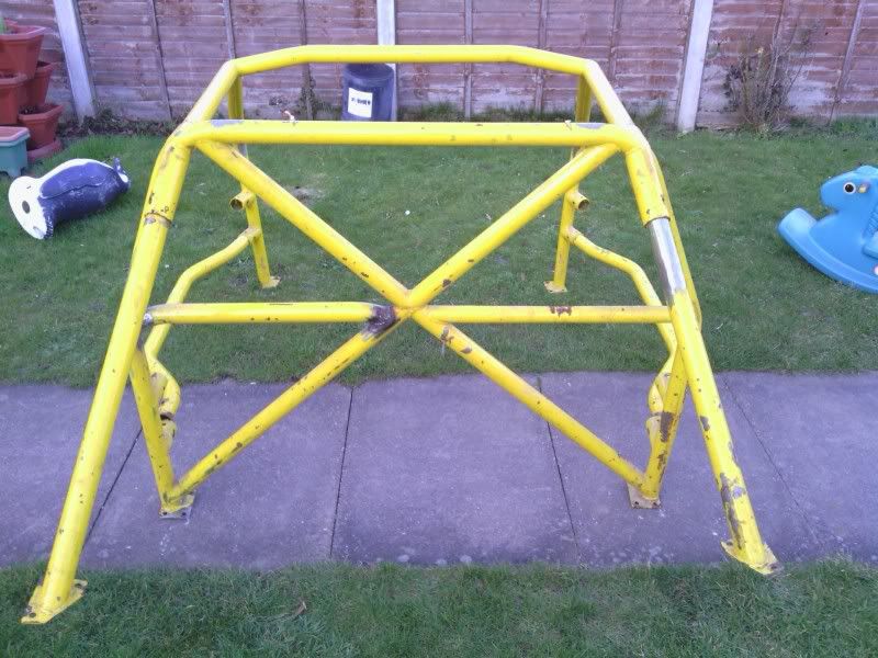

Right today I had a plan to sort my cage ojut and paint it, and the optimistic side of me wanted to fit the cage too :lol:
Weather fucked that up as it pissed it down all morning.
Got round to it in the afternoon and started to do things.

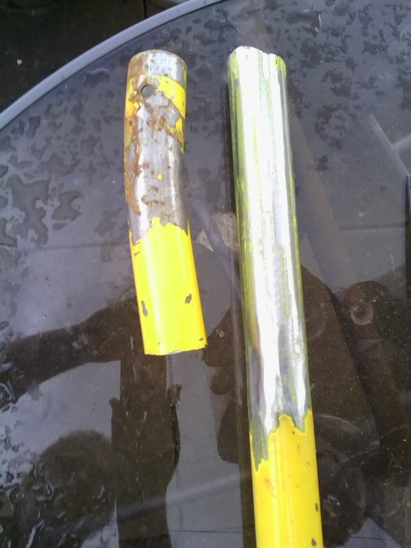

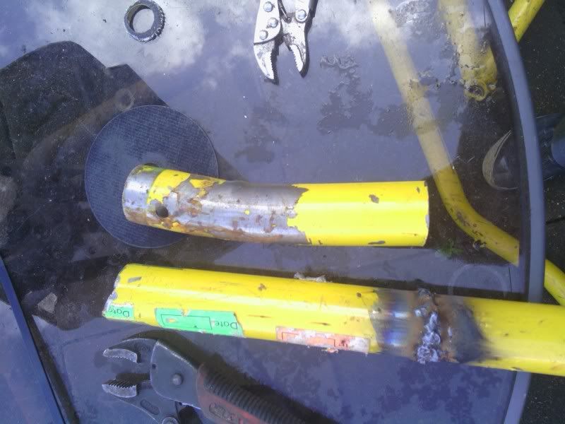

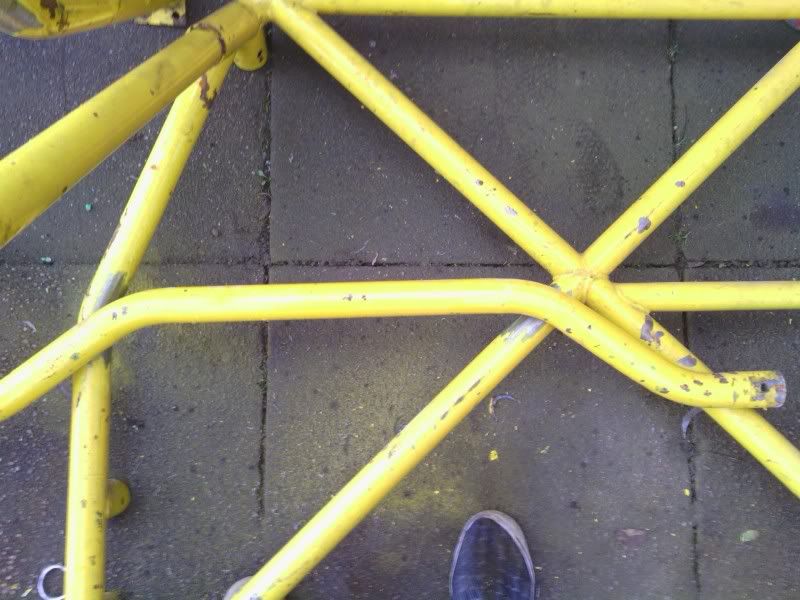

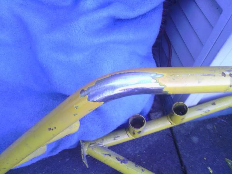

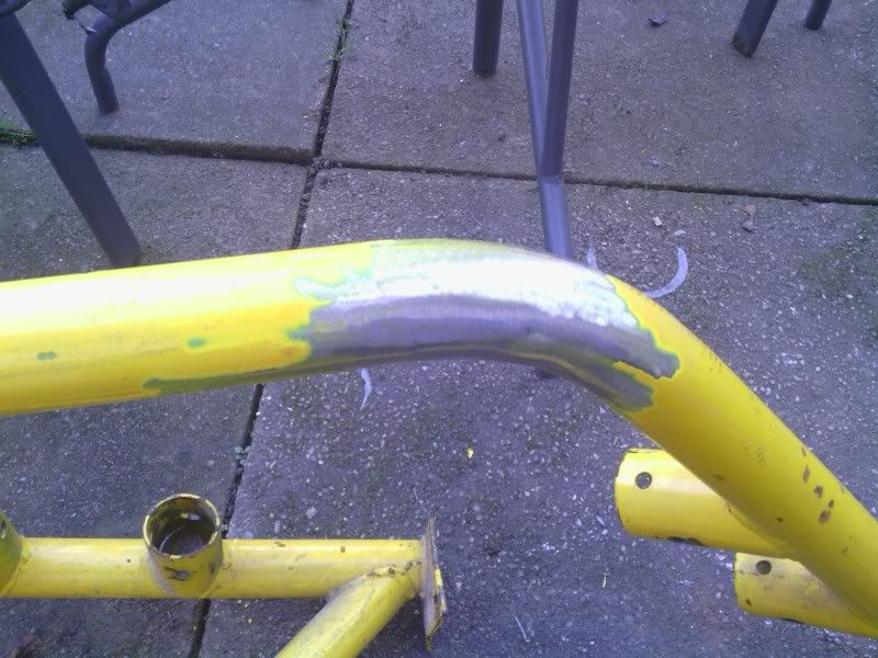

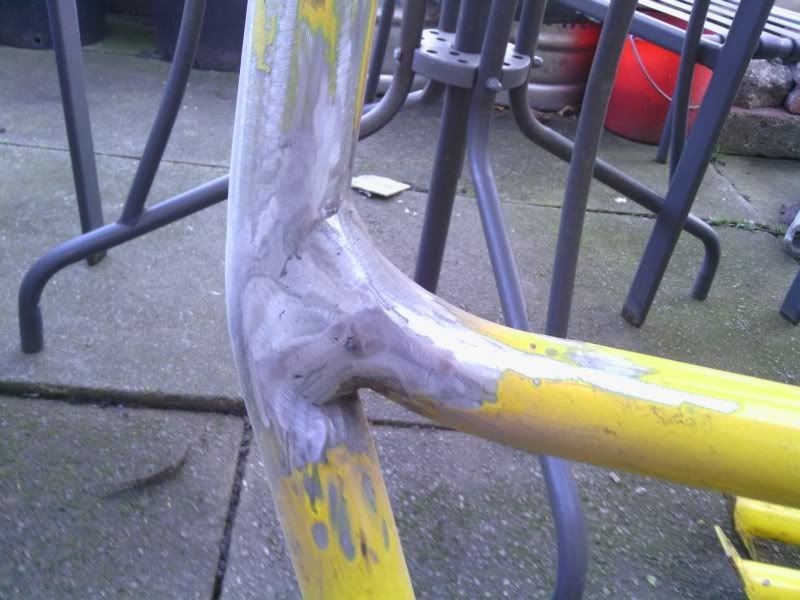

First things first, one of the tubes to the rear turret was bent, and I was thinking of ways to bend it back, in the end I ended up cutting it and welding in some more tube to replace it. Easy.
Then I needed to add a passenger side harness tube.
Yeah its thicker than the drivers side and has a slight angle on each end, but hey ho cant have everything and I'm not that arsed TBH. Made a little screw up and had to fill a gap with weld, but its all good.. wont notice it after paint.

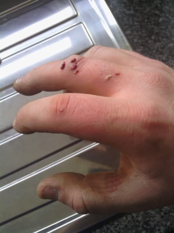

Also slipped with the grinder.... LUCKILY it only had a flap disc on, if it had the thin cutting disc on I would have definately lost the top of my finger and my thumb!!!!
Also while welding, it spat a big lump off, landed on my sock which caught fire, I put it out with my finger.. burnt the end of my finger and also pretty bad burn on my foot, as when I pulled the sock down, my skin went with it :lol:

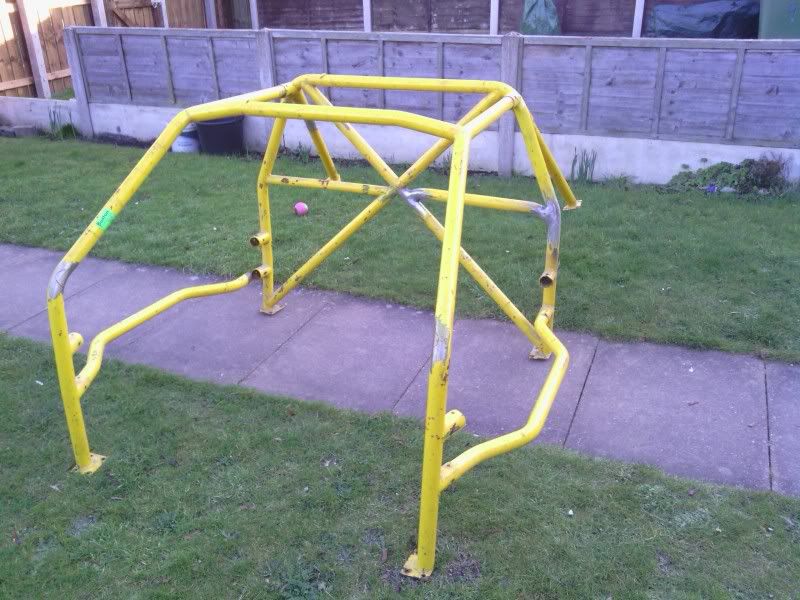

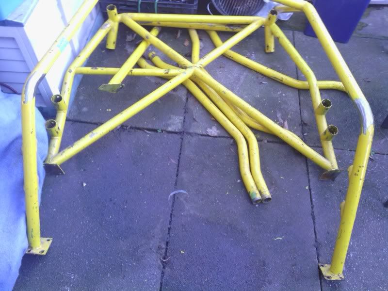

Mocked it up
Gonna have to bin off the mounts for the door bars as my original idea of turning the bottom bar towards the sill no longer works because I have realised the door bar at the front is on an angle. So gonna have to weld in a diagonal door bar once its in the car!
Gonna flap disc the lot and paint it before it gets fitted, then obviously paint the door bars after they get fitted.

Good progress there paul, and good to see your still in one piece too (just! :lol: )
I had a grinder jump back at me once when I was using a diamond cutting disc, was very close to cutting the end of my right thumb off :o
Just got a big cut instead, very lucky!
