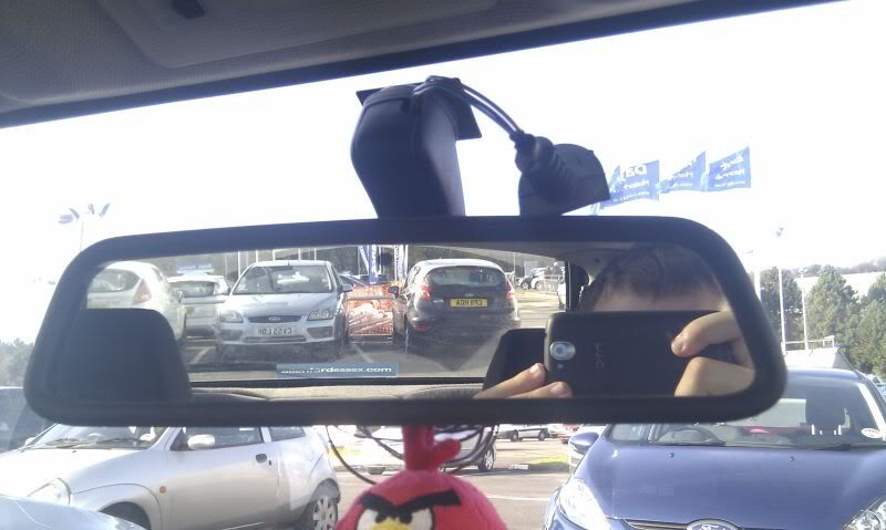

PostPosted: Wed Nov 09, 2011 7:37 pm

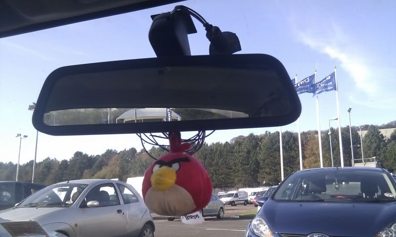

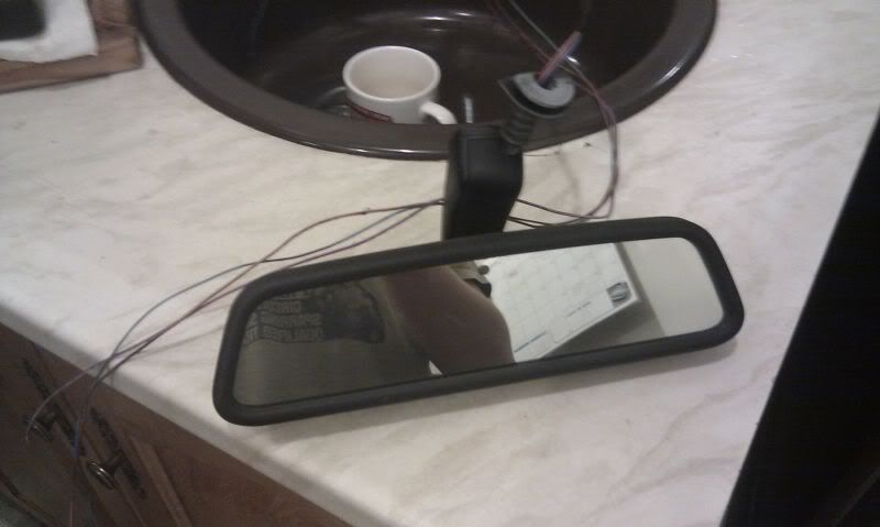

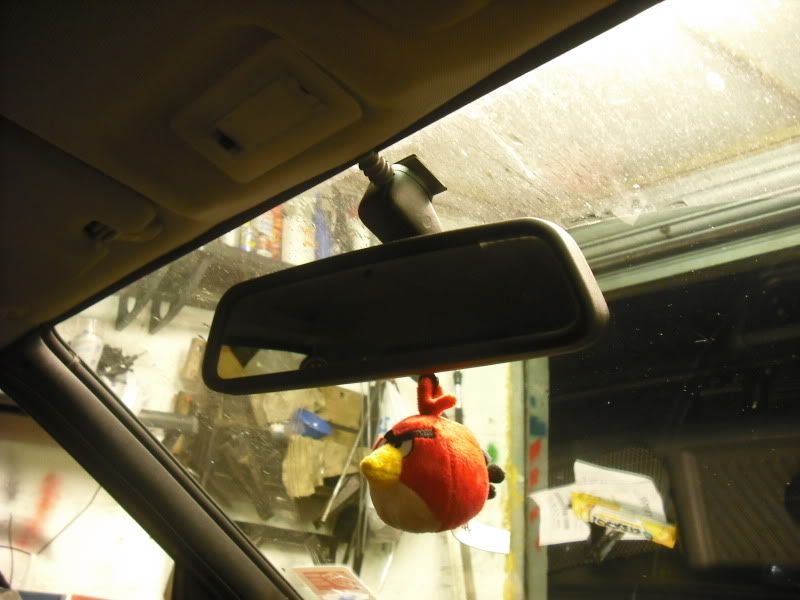

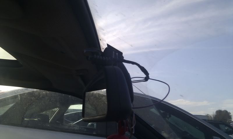

bought this at a scrappy when i snapped my bloody mirror trying to fit a angry bird!!, didnt realise how weak the metal is
its a autodimmer mirror i removed from a E36 325i BMW
just need to figure out which wire does what and i can wire it in :)

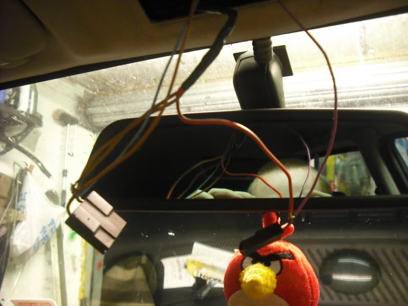

heres only 3 wires, but no idea whats what
theres 2 sensors, both light sensors, one in top of the mirror for obviously when the light behind you is too high, but one on the back of the mirror (aimed at the windshield) which im guessing senses when its dark which then activates the glare mode, if the other one is tripped ya know?
might pop on a bmw forum and ask how its wired in
dont wanna just give it a charge incase i damage the components

bit of a bad day for cars i found, my car is off the road for the night, my bros car kept dieing due to bad battery connections, my mates car had a blow out and left him stranded for 4 hours and my old mans capri has had starting issues :P
anyway
mirrors!

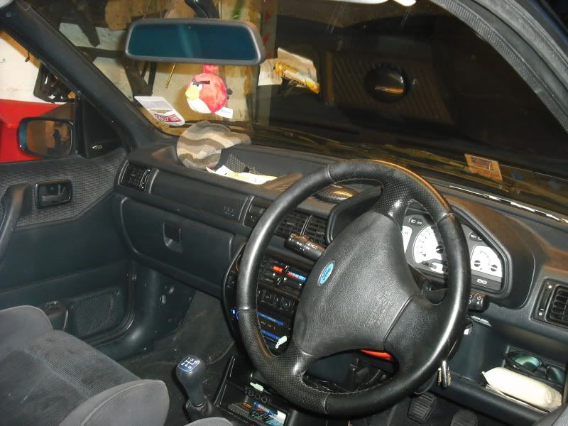

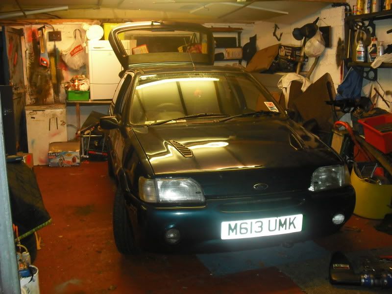

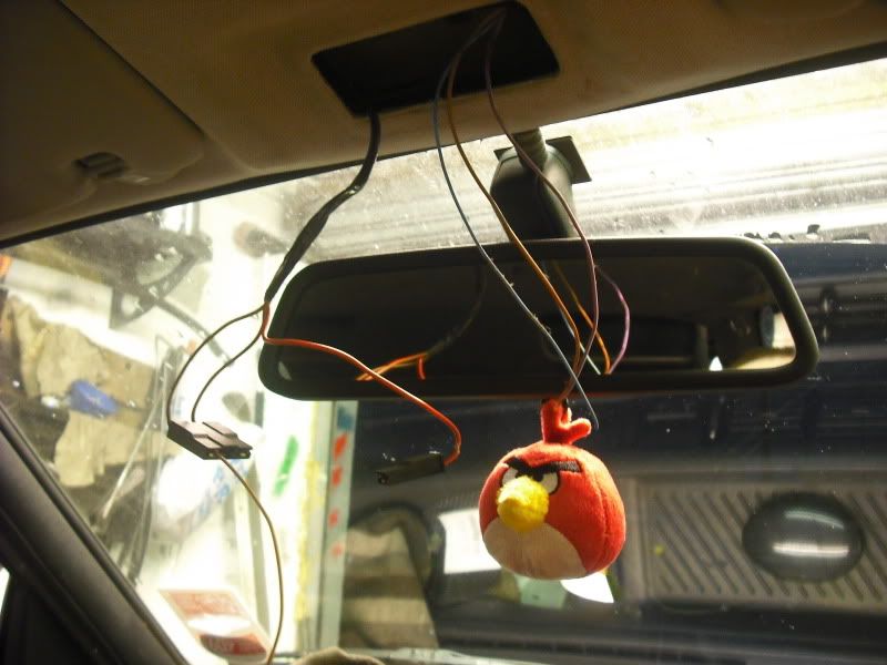

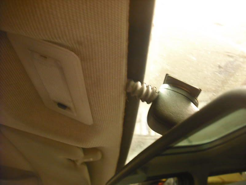

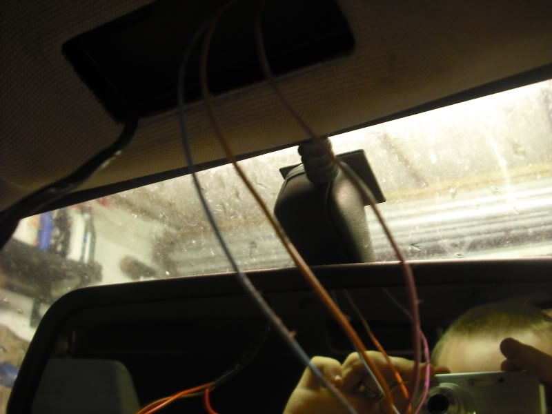

heres the wires for the mirror, tucked under the roof lining and pulled through the light hole

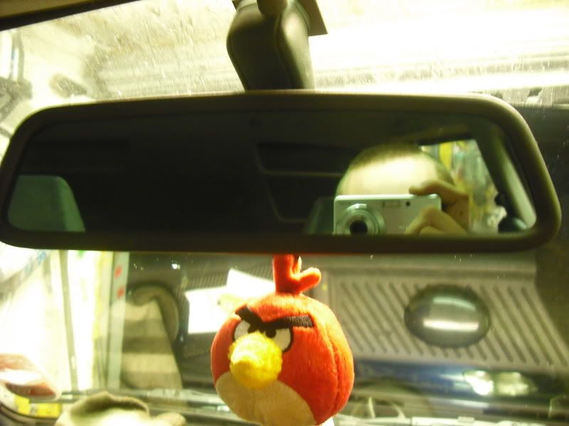

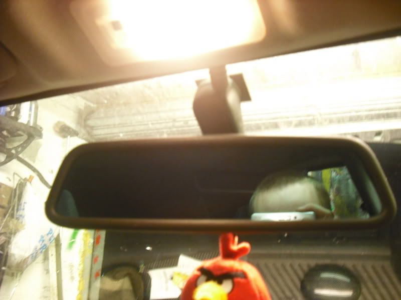

done and in action

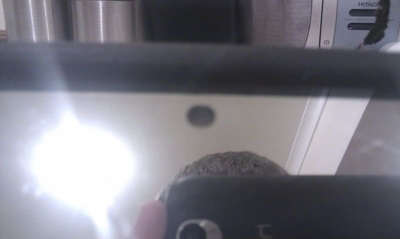

normal mirror mode

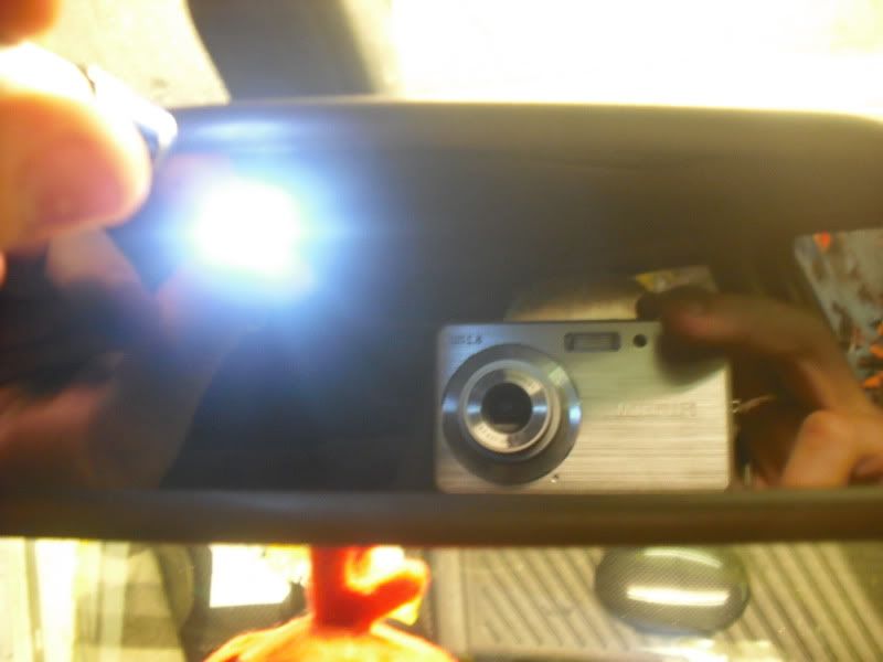

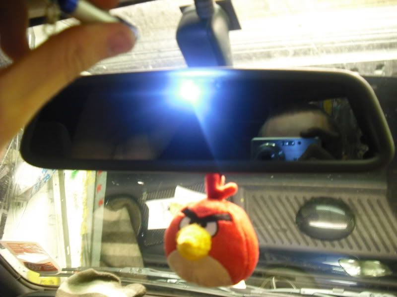

slightly dim (garage lights, finger over daylight sensor)

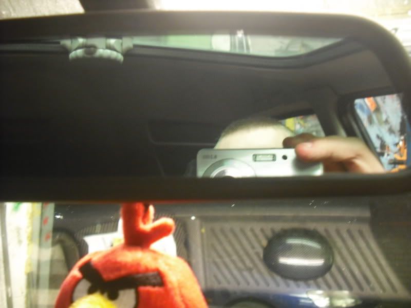

dimmer mode

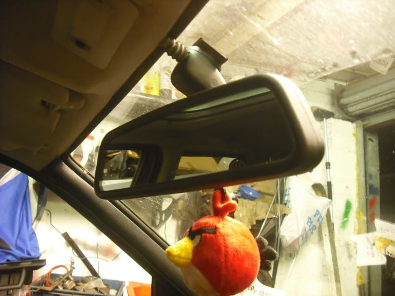

tints in a nice green colour, which works well with the fiesta's green tint tindows
and back to normal
sits well, sleek and slender, its wider than the standard mirror too, so i can have a wider view
gromert come in handy, much tidier than wires everywhere

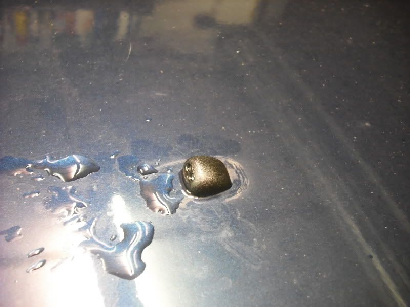

fitted my new genuine washer to replace the failed attempt of a focus jet
ideally need another now as my passengers is a faded grey colour

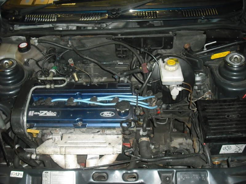

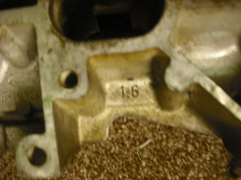

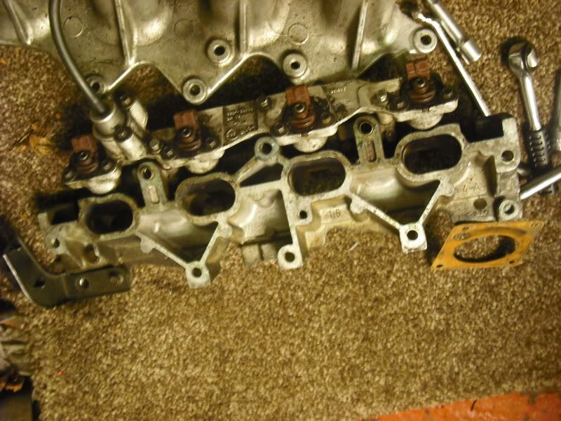

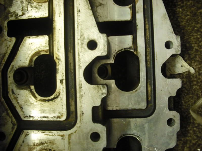

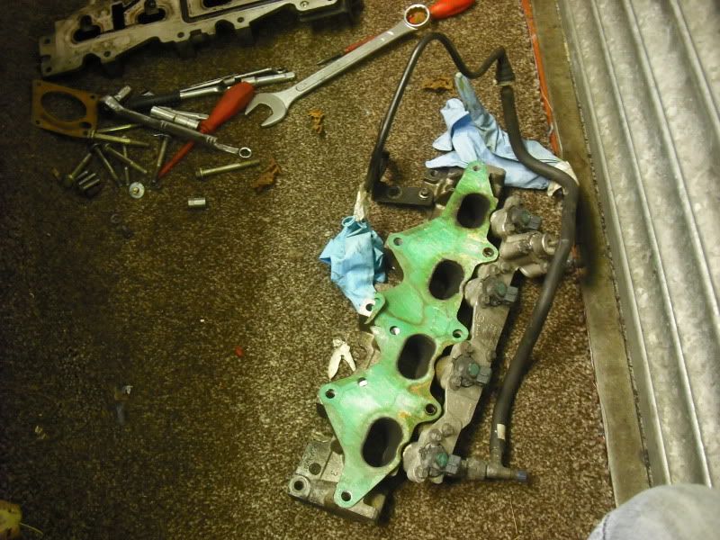

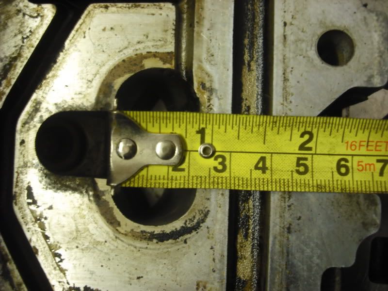

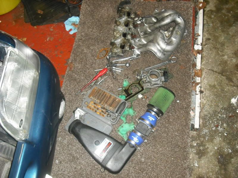

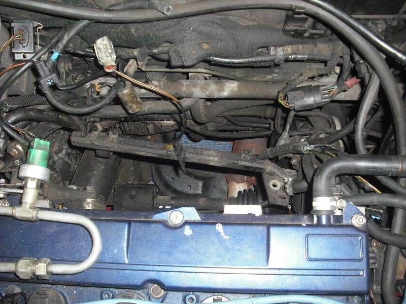

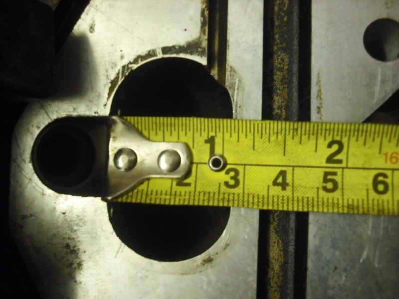

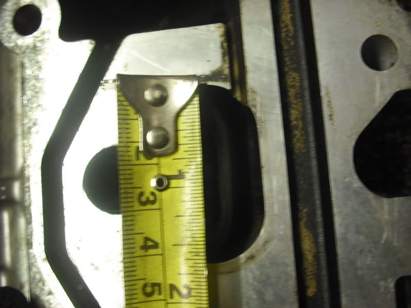

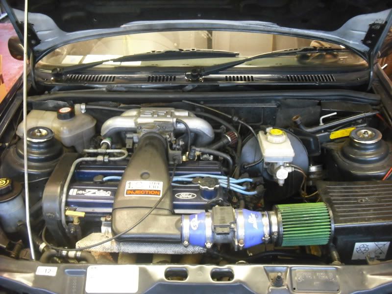

in other news, i finally had enough today (again :P) and stripped the inlet off to check for leaks, to change the air intake temp sensor as i have heard many accounts of them causing havok when they breakdown
i then noticed that my injector rail at least is a 1.6 item.... which begs to question are the injectors 1.6 items too?!
if thesy are it would not only account to poor performance, but also a missmatch in the ecu and injectors, which would likely make a bad running cycle, or perhaps result in my bad idle on tick over
at the very least this 1.6 item is going to massively restrict the engine, literally strangling it, i will get a bette rpic tomorrow

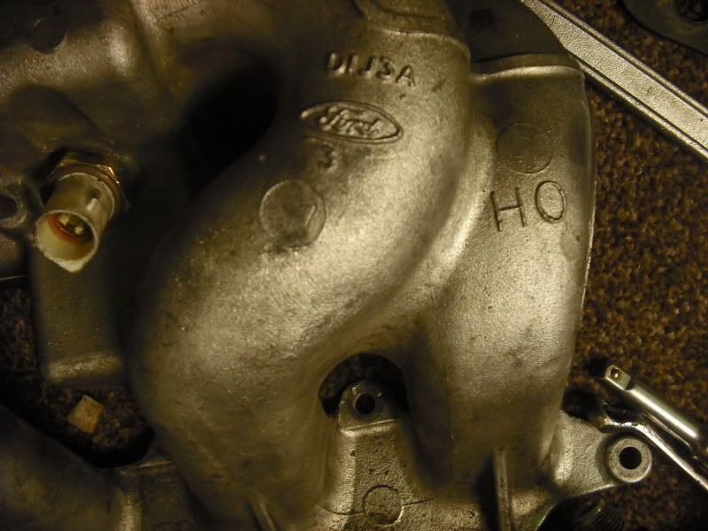

but the ports are tiny compared to the RS1800 H.O inlet, making the H.O struggle

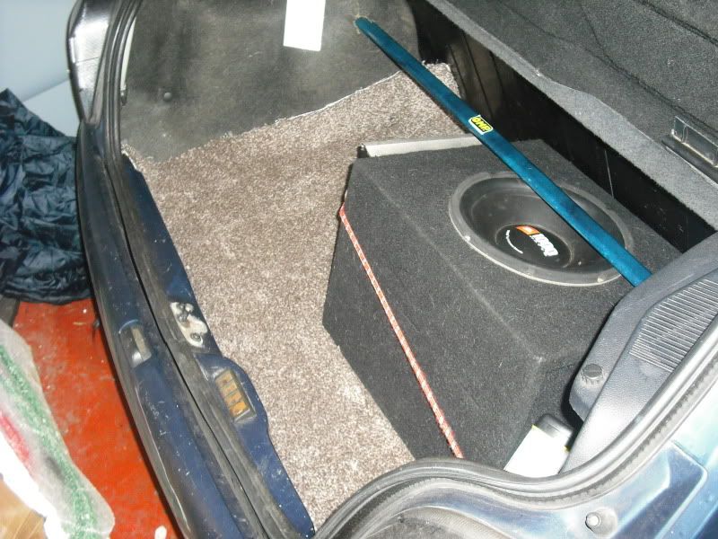

small walk around
my dog proof carpet
massive thanks to dan (danPsi) for coming to deliver the Xr2i sandwich plate/injectors on such short notice, id have hated to rebuild the inlet only to rip it apart again a few days later once id bought the new injectors, ill get that fitted tomorrow, then over to ford to collect my new interior panel, been in fords about 5 times this week now lol, mirror sticky pads, panel and the washer jet...
PostPosted: Fri Nov 11, 2011 6:49 pm
well today finished fitting the inlet and injectors
heres what dan brought

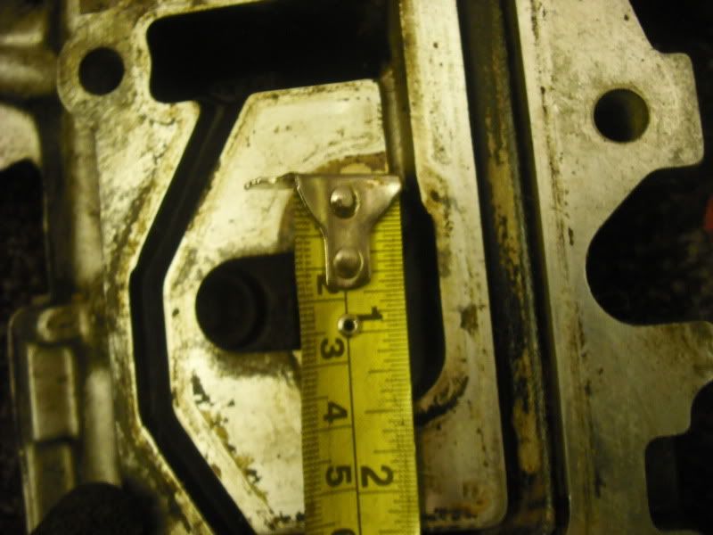

comparisons
1.6 left, 1.8 right
1.8
1.6
also fitted my new panel from a mk5 fiesta for the electric mirror
its a new genuine ford item
and my sound system badges
