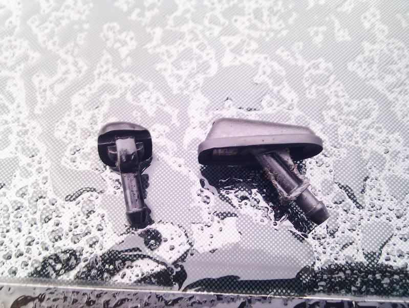

Im sure some of the citroen ones are a direct fit? I read it somewhere. Ive wanted to do the whole mist spray thing for a while, but never got round to doing it. I want some that look subtle like the standard items though which is the problem.
PostPosted: Fri Sep 16, 2011 12:14 am
Looking at the Citroen ones they could be direct fit
PostPosted: Fri Sep 16, 2011 12:16 am
yea thanks for the mood killer darren

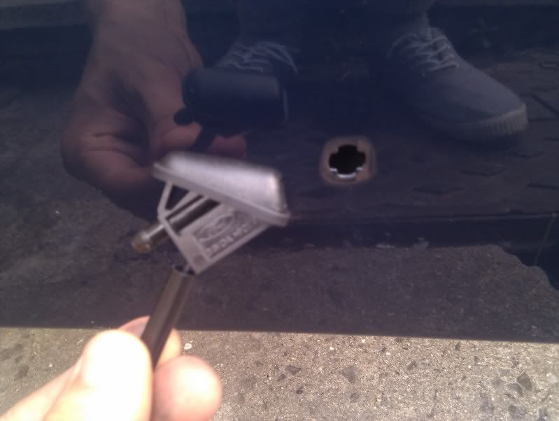

its a tiny hole! shaped like a cross :(
PostPosted: Mon Sep 19, 2011 7:59 pm

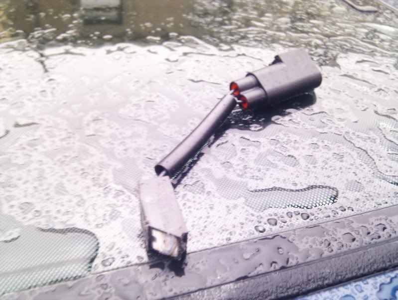

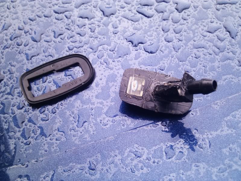

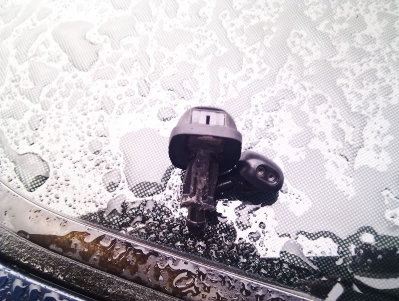

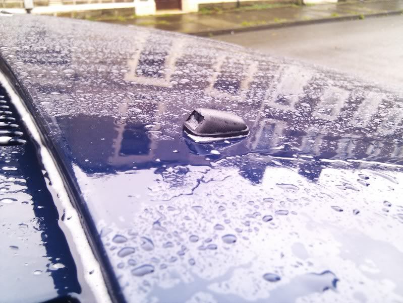

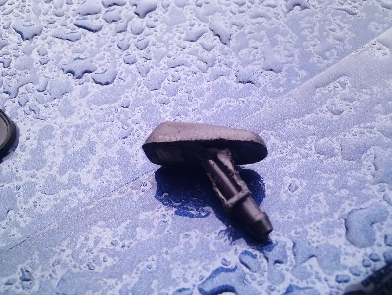

well done 1 washer, but i pierced the pipe on the other so will have to buy another, its very eas to saw into the pipe when cutting them down :(
anyway pics of how it went, they work well for anyone interested and only cost little more then a fiver
never gonna fit...
so some hacking required, i also had to cut off the heated portion, and i dont think i could effectively refit it, maybe if i connected the heater elements to a small metal joiner so it heats the water while in the pipe, but thats for another day

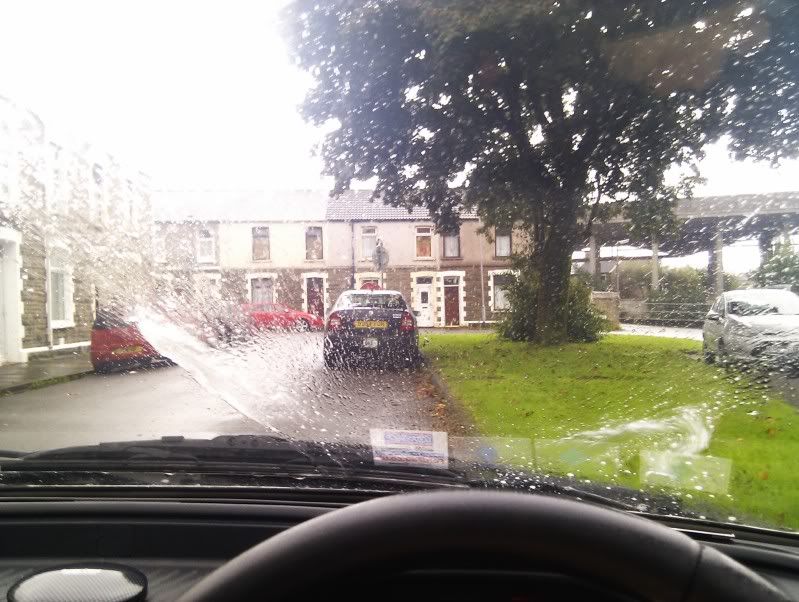

better wipe, and cleaner car! job done

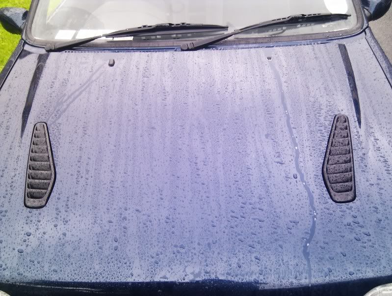

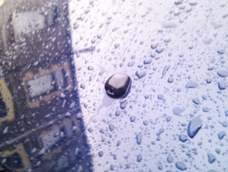

PostPosted: Tue Sep 20, 2011 10:29 am
It actually doesnt look like its spraying at all, just looks like its hitting two points which are in the completely wrong place to where they should be hitting the screen lol. I'll go get some citroen ones today and see if they are any better :P lol
PostPosted: Tue Sep 20, 2011 11:38 am
Posts: 2059
Looks worse than the standard ones lol
The Fat Fake Xr2i
PostPosted: Tue Sep 20, 2011 1:39 pm
lol ok.. well received, need to see it in person really
 Post subject: Petrol Blue Fiesta Si125
PostPosted: Tue Sep 20, 2011 2:29 pm

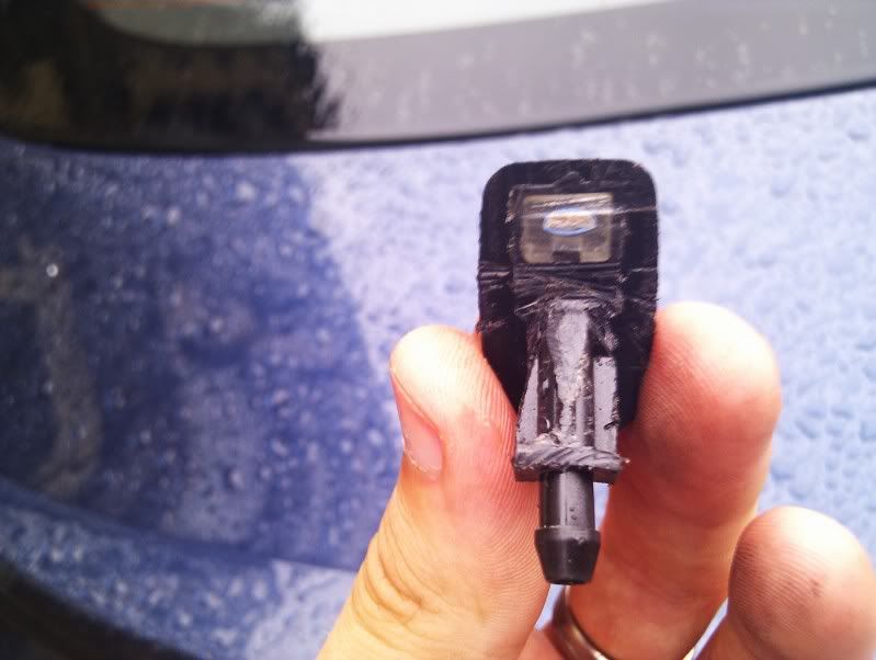

I got some citroen ones, modded them to fit, fitted them, look just like normal fiesta ones but very slightly bigger, spray well, but they don't sit right due to the fact of the design. They are too long so they sit slightly on an angle. Admittedly I could re-route the washer hose outside of the inner channel of the bonnet and feed it under the insulation, but I don't want to. So unless I can find shorter ones then standard ones are staying. That's my conclusion to them lol
PostPosted: Tue Sep 20, 2011 4:09 pm
pretty much the same as these then, they aim to low, my guess is the focus has them further away from the screen
i did aim it high slightly by having the jet sit on top of its rubber seal
but it does give a better wash and wipe, so it will stay :)
