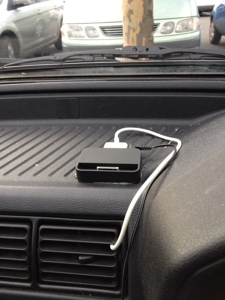

I want to modify the dashboard so I have a foldaway dock for when the phone isn't in it, and angle it backwards as the phone is far too upright at the moment. Next time I go to the local scrapyard I'm cutting out a good chunk of dashboard for experiments and kinda designing something in lego digital designer!
I know the dashboard needs a damn good clean! Also a PROTIP! for you all, UHU glue doesn't mark dashboard material. It looks messy but it molds into position and works by suction grip :)

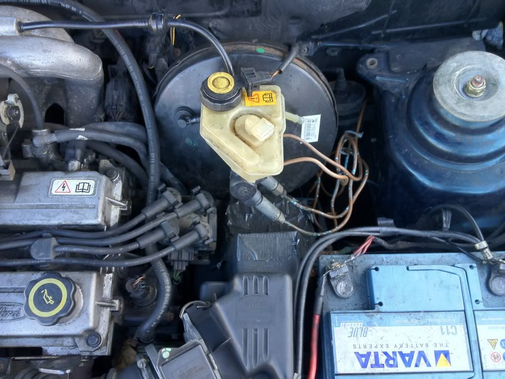

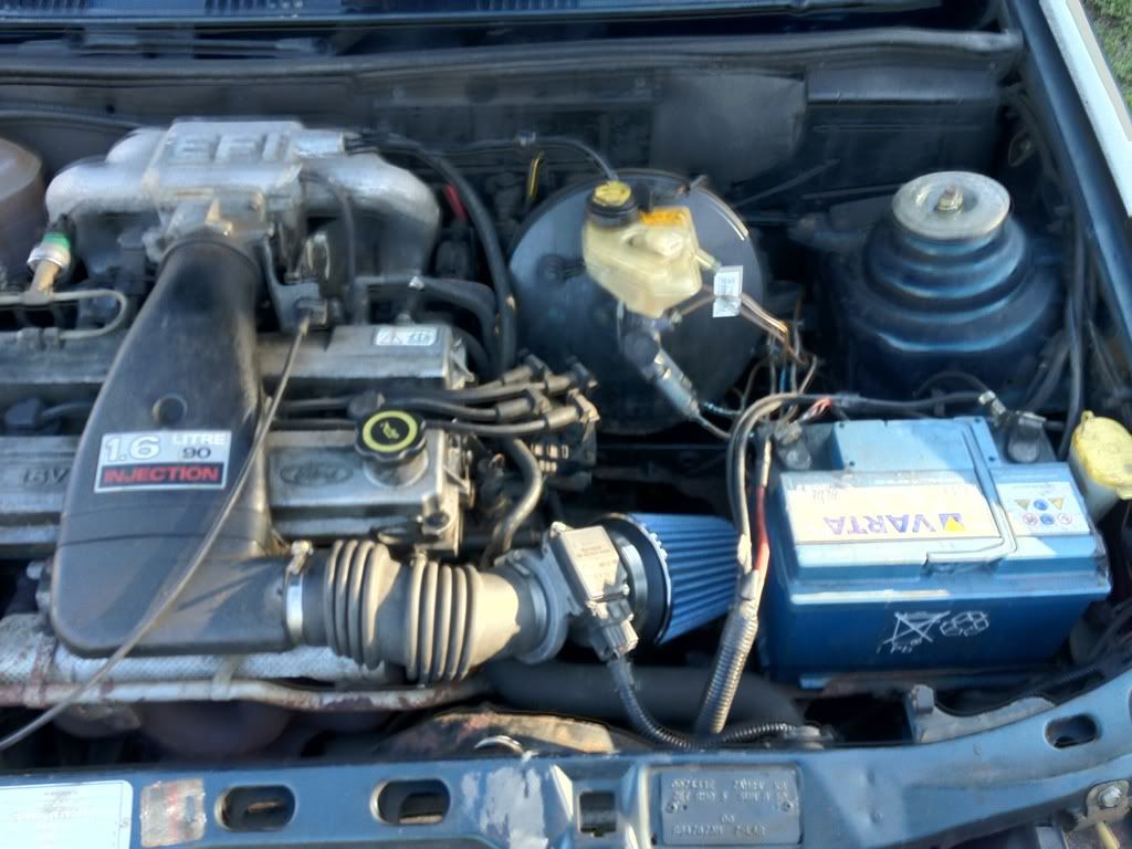

Well it's been a long time coming but I'm starting to get hold of little bits here and there. The mod today:
Not installed for performance, noise or anything chavvy. Simply for the fact I've had to chop the standard airbox to fit round the mondeo servo and master cylinder.
Oh dear. Anyway, it's sorted now! Not driven it yet to assess the effects, but it's going to get a good a road run to Nottingham later.

PostPosted: Thu Jan 19, 2012 4:35 pm
nice mate, mirrors are a nice touch i can vouche for that.
fuck cutting the box up mate just remove them load restrictors from the pipes, if you have drums you dont need them anyway
unless the servo itself fouls the box?
i hope not as ive just been sent a standard airbox and i dont want my escort servo getting in the way

escort one and mondeo one are the same size.
you can fit them bias valves inline at the back of the car between the solid pipes and flexy pipes

Escort one needs welding though doesn't it? If I was doing it again, I would choose the Mondeo one simply for the fact of chopping and welding a pretty critical part of the braking system. Not sure I'd like that even done by a well and truly seasoned professional.
