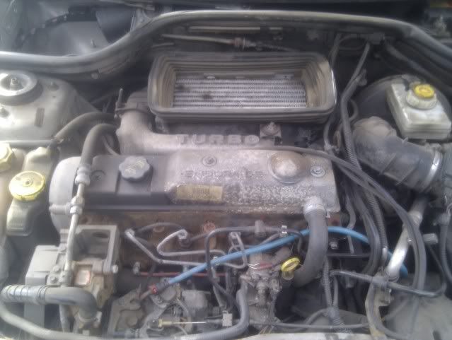

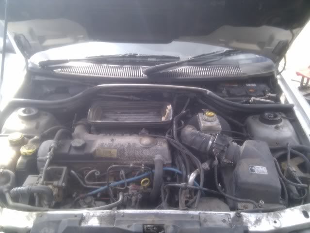

fucking seriously underpowered below 2k
untill the turbo kicks in, was even struggling up a hill earlie,r had to drop to 1st haha
ill clean the intercooler up and see what the air filter is like, oil is black, will service it soon and the belt/s

Check the pipe which runs from the fuel pump to the turbo, it runs under the fuel filter on the right hand side of the engine, if this has split it makes it run like a sack.
What you need to be doing is turning the preboost fueling screw up a little, wont have any issue with low off boost power ;)
PostPosted: Fri Apr 08, 2011 2:06 am
lol good call
having trouble finding this hose you spoke of mate, its not bad just pretty gutless untill mr turbo answers the call really

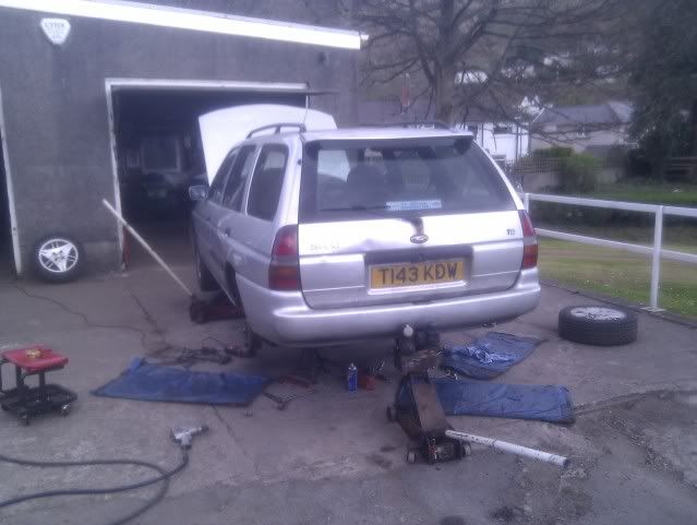

O/S lower arm removed
with the two wishbones and the gaiter done, this arrived this morning
coudlnt for the life of me get the old pipe off the mid section while on the car, hammering the hell out if it and it wouldnt budge, even penetration fluid wasnt helping
so had to take the whole midsection from the cat back off
back on the car
all done with that, not that it was loud without it, but its nice and hush quite now

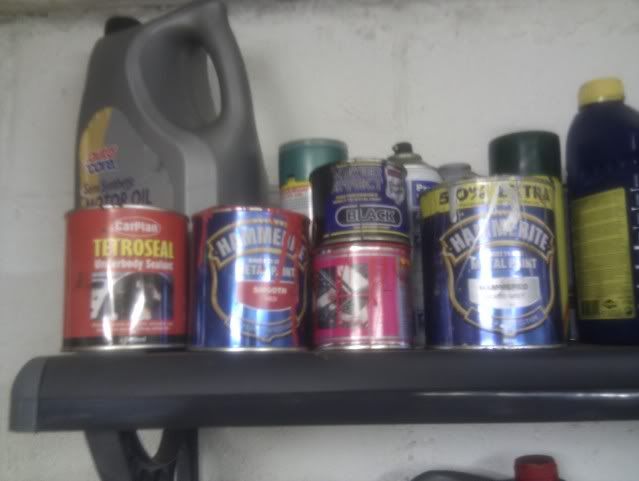

pictures of the sill repair, it will get a new sill one day as this is temporary, i know crappy welds, but its the best i could get out of my crappy mig, even with gas!

A solid ratchet, the ones that don't turn, and a extension tube, or just a long power bar, a impact 15mm socket
Ball joint breaker, think it was a t30 or so torques ratchet, a 17mm socket and ratchet, and a 18 mm longish sinner for the nuts on the top of the lower arm carrier
Some copper grease
Oh and Phillip hammer :)

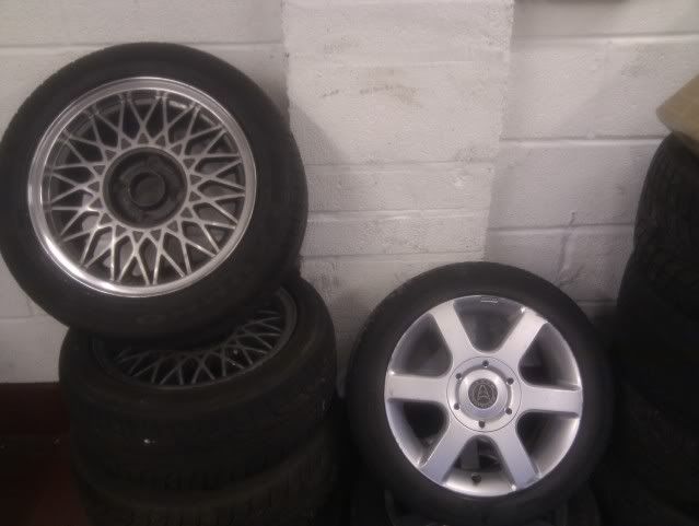

im planning on getting either some BBS sharktooth lookalikes, some cheap Zetec S wheels, or some RS7 softlines in 15s

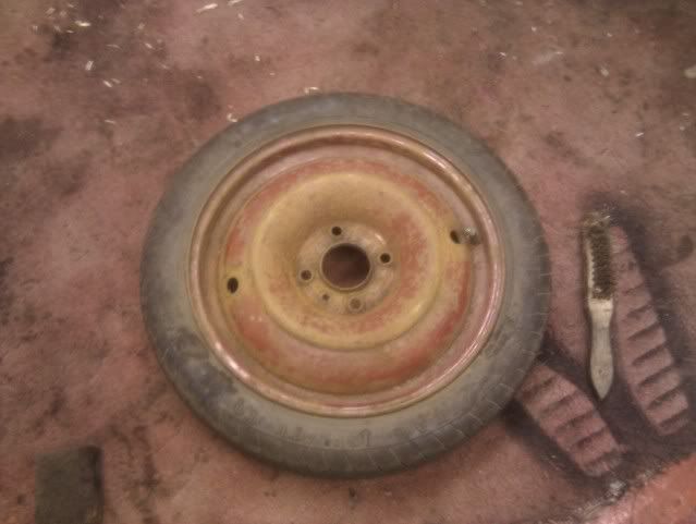

its a 115/70/15 spacesaver i got off the XR

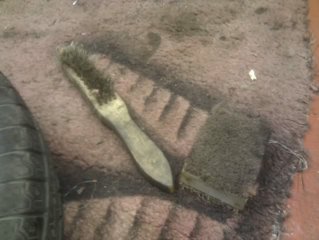

prepping
the only colour :Q

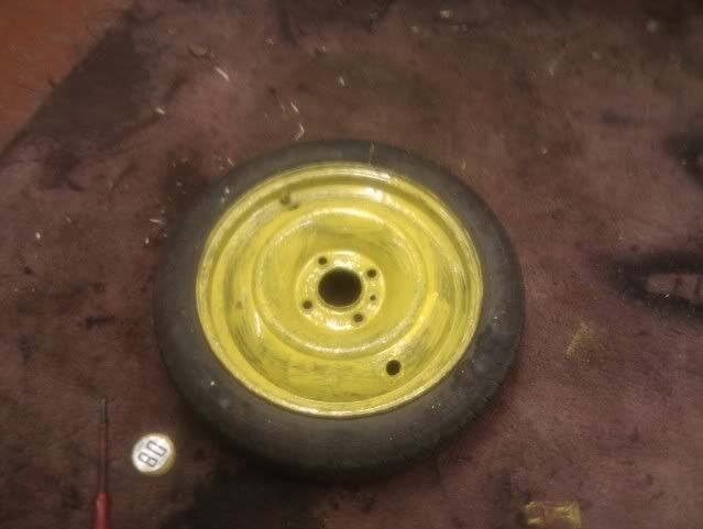

didnt fancy anything else in the inventory
as i left it after its first coat on both sides
will update tomorrow/thursday if well it should pass :P

think ive decided on a set of RS7s from a mate whos Constantly picking up sets of wheels to sell on,
the other choises were, 16" mondeo Si wheels, or these BBS sharktooth lookies, or them wolfrace 6 spokes
decisions decisions

£130 mate, there not actual cossie wheels but BBS ones that look like them, Ford fitment, 7J et 35
