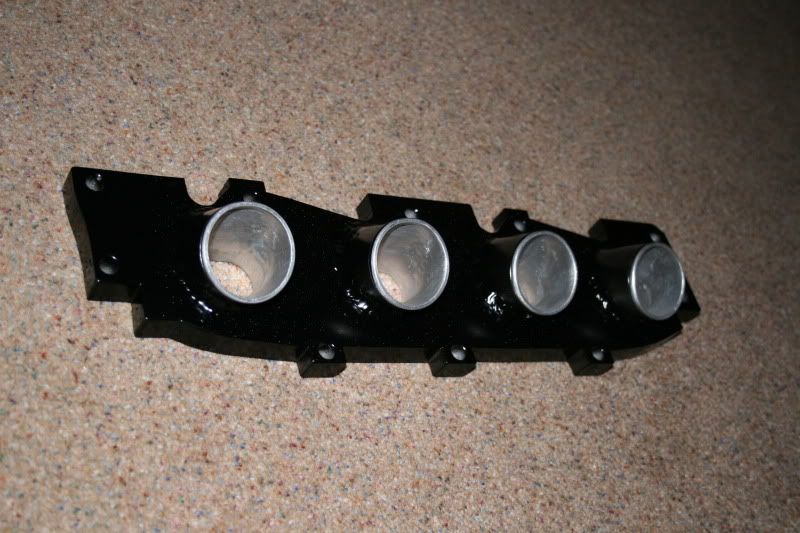

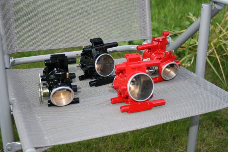

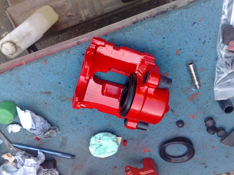

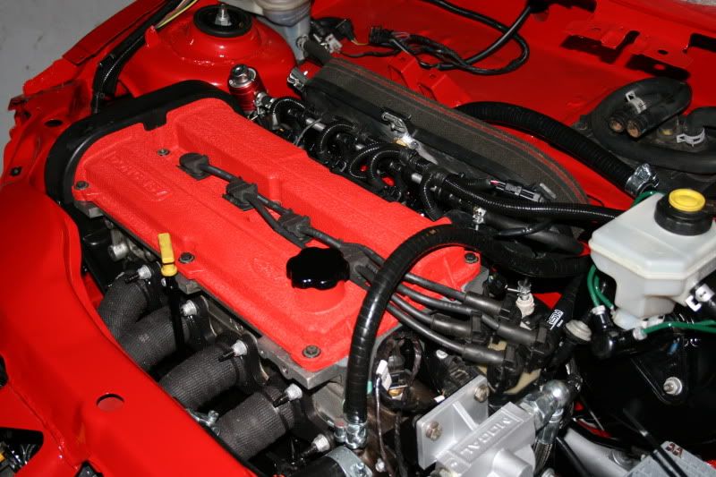

my Dad and I have had a busy few days all the paint work has been repaired after a brake fluid leak from the servo :thumbsup: and my manifold has been finished, throttle bodies painted up and all the parts to turn the engine over have arrived i am just short of two hose connectors which I should be able to pick up local and hopefully get the engine running monday evening
Tomorrows job is to re bleed the brakes and fit the inlet and ITB's and finish the wiring in the engine bay and fit the last few hoses

brakes rebuilt with new seals and a fresh coat of paint :thumbsup:

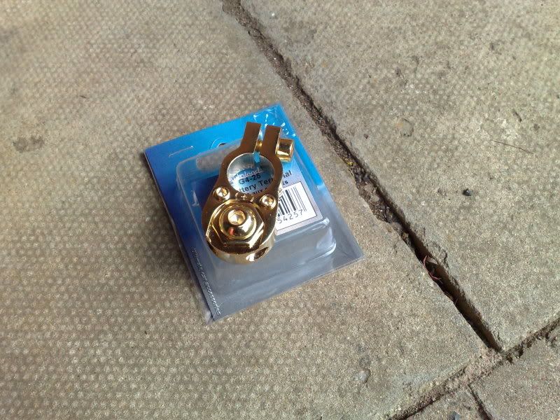

new positive battery terminal to allow the amp to be wired in etc....

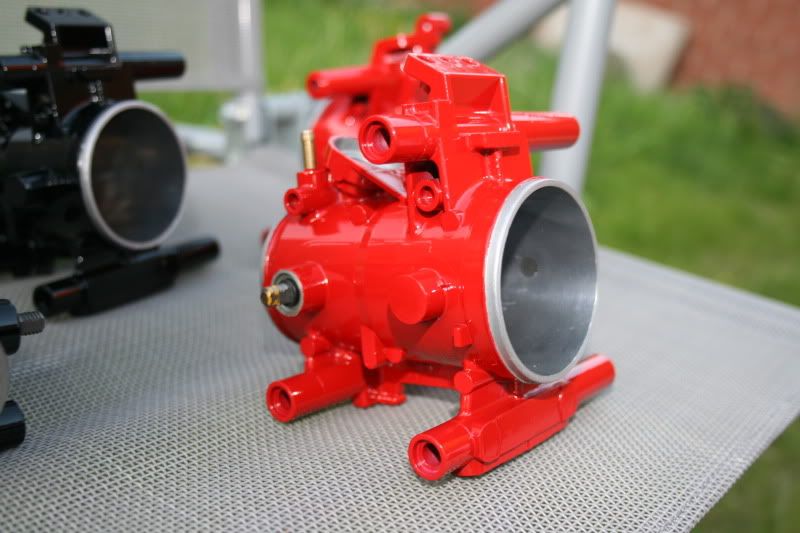

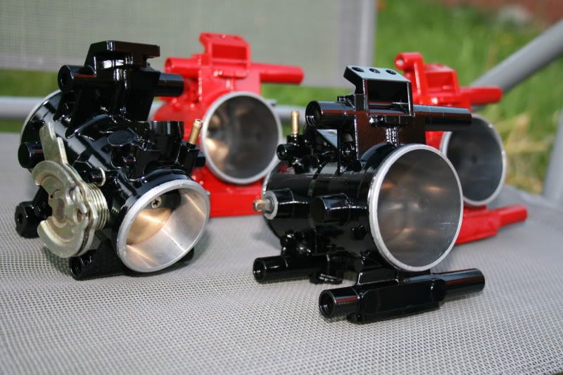

throttle bodies painted up and inside polished

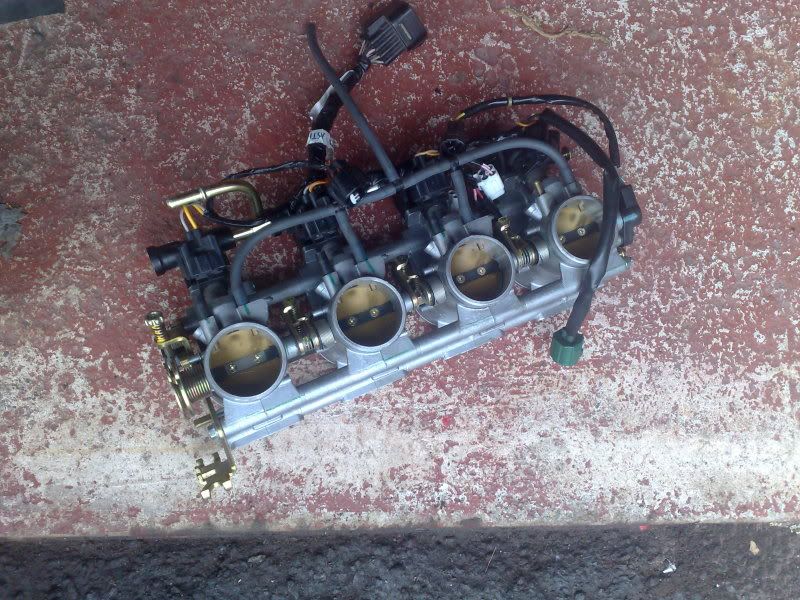

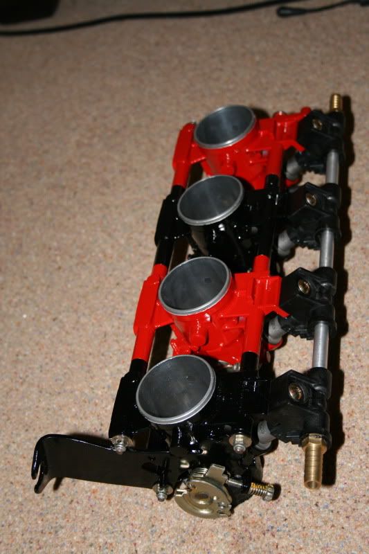

another set of gsxr throttle bodies, purchased for the injectors 270cc and the loom plugs and a new TPS
throttle bodies put together with custom fuel rail and throttle cable bracket to fit the standard ka throttle cable

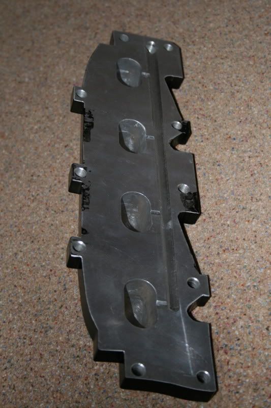

new custom made inlet manifold (aluminium) to allow the throttle bodies to fit in the engine bay
back of the manifold showing the vac line for the crank case breather (in line filter will be used) paint will be removed before fitting

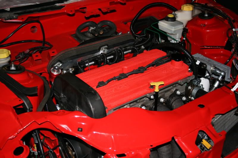

Little bit of progress..... lol
ignore the oily finger marks on the slam panel lol
got all the fluids in coolant (just water at the mo), ps fluid etc.....
got all the battery connected and the modified injector loom for the bike injectors and TPS, also got the filter plate modified, two boss' welded on for the rocker cover breather and AIT sensor, needs to be painted black thjo dont like the bare ally look.
Also made a bracket for the fuel pressure reg bloody nightmare, such a complex bracket
all fuel lines in just need to check the oil and lower the car to the floor and start it up :) wish me luck
would have started it tonight but omex have sent me the wrong base map :crying: (not that I am complaining they have been VERY helpful :thumbsup: )

oh and another thing IT STARTS AND RUNS :thumbsup: :thumbsup: :thumbsup:
[url="http://s3.photobucket.com/albums/y65/Wellz1/?action=view&current=09062009005.flv"]Image[/url]
not bad considering its been stood for 3 months and that was it second start up since then, oh and the battery was a little flat :rolleyes:
its been a great day today, it started and got to operating temperature with no leaks of any kind had it idling for a good half hour :thumbsup:

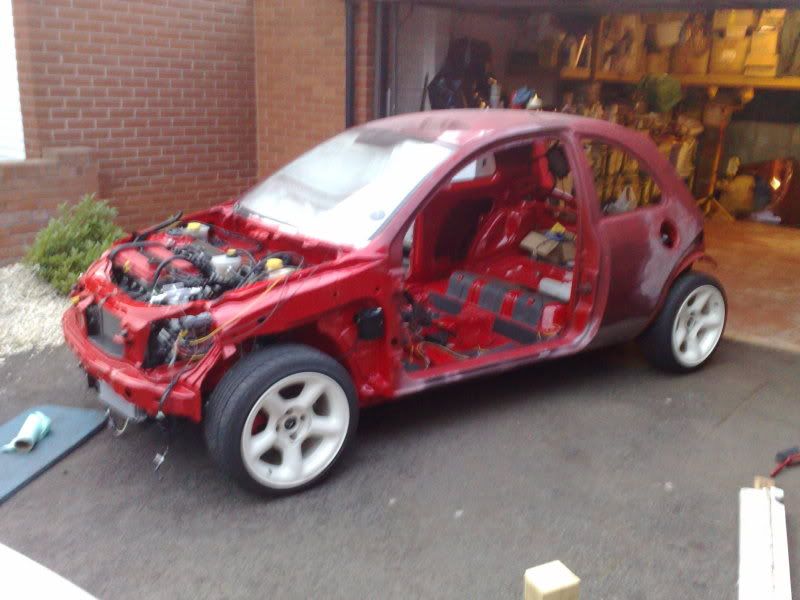

Pic of it out the garage

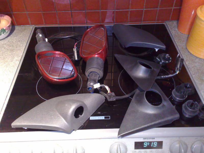

Oh and my heated/electric mirrors and switch arrived today :thumbsup:
