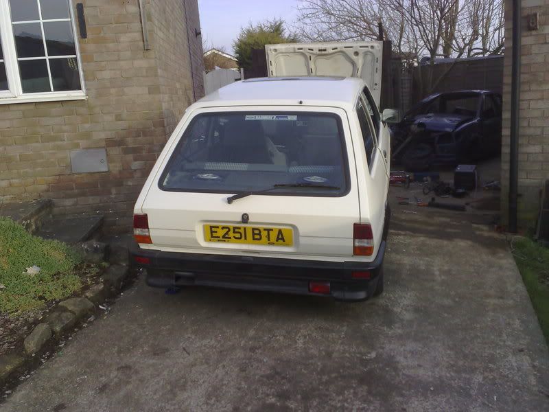

Its been a very busy weekend for me and here is my large update.lol

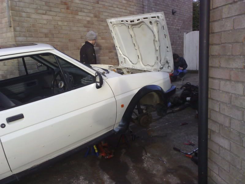

Firstly i stripped of everything that was not needed from my 2ltr and gave her a quick like of paint!
(the rocker cover will be repaint white, it was just a guideline to see what it would look like white)

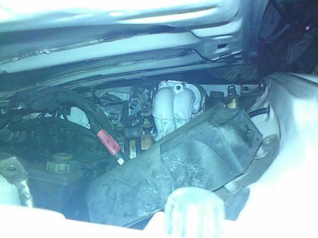

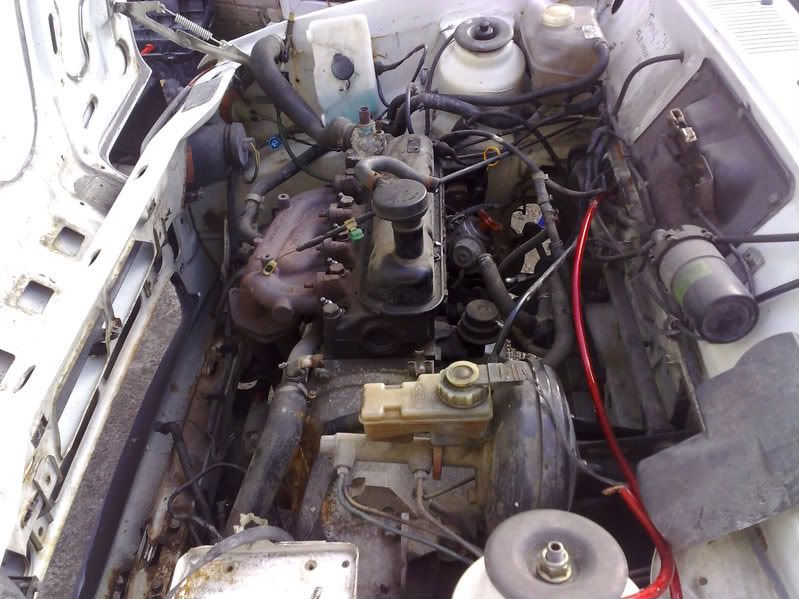

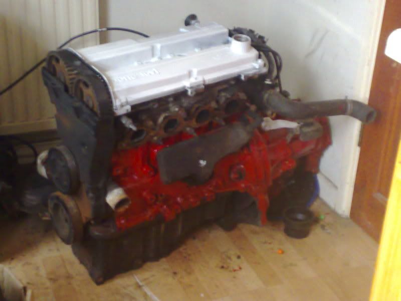

Then it was time to pop the bonnet and take out this little lump

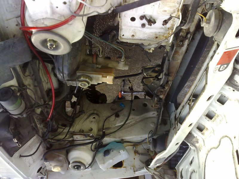

engine out then
The fez was up in the air then

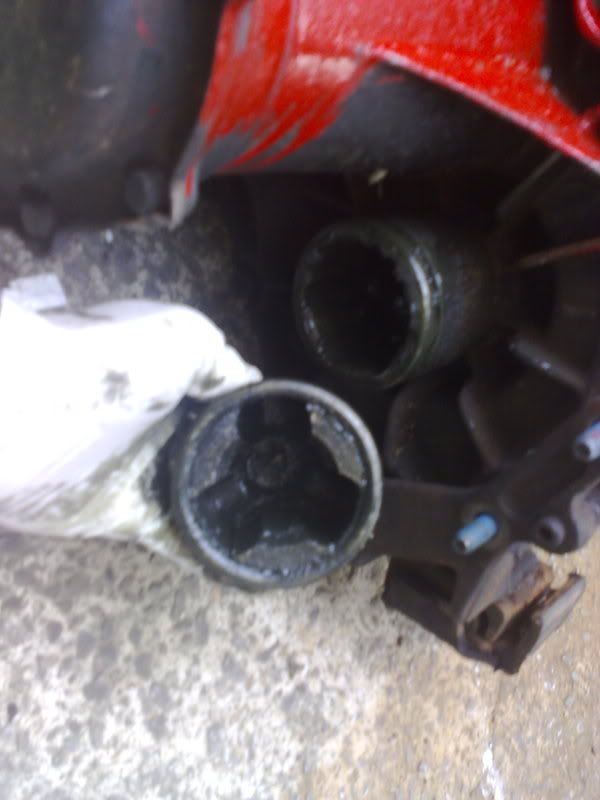

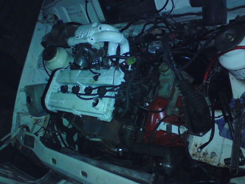

Then i fabricated engine mount, gearbox mount and fitted the xr2 tie bar and xr2 cradle, then compared the drive shafts from the diesel box to the 1.1 driveshafts they were a completly diffrent shape:
i popped the cups out of the 1.1 box and they fitted directly to the diesel box so easy problem solved :thumbsup:

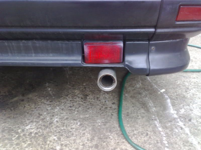

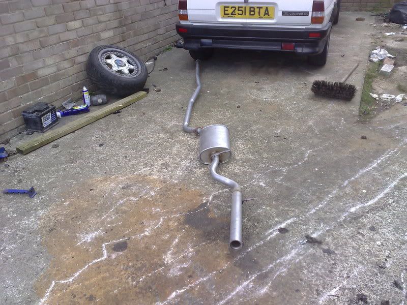

Also went out and bought a new xr2 exhaust system as i do want to just go for the clean/ sleeper look and it looks the nuts.lol
and fitted in place
it has been welded directly to the zetec down pipe and it only has literally just the centre box :) no cat needed ;)

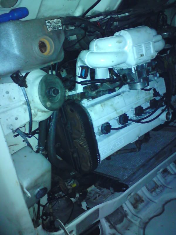

now we couldnt get the fez high enough on jacks to push the zetec under so one person on each front arch we lifted it and another made slid it under :P surprisingly light for a car.lol

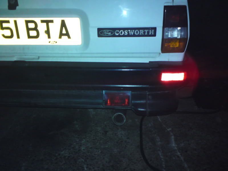

Then got distracted and thought it would be funny to blue tack a cosworth badge to the back as i had two lying around

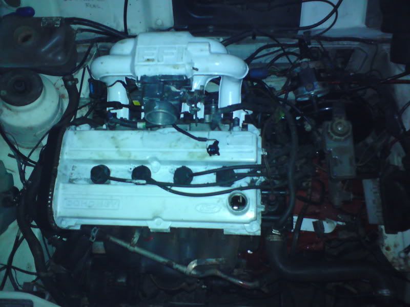

engine was then fitted up and the all plumbing done, two custom pipes needed all i did is got spares from the si and put an alloy tube in between them to extend the pipes around the engine, i used the si rad as i know the plumbing for these so it made it easier, only real issue there was the si rad is huge in comparison to the 1.1 one so made out own lugs on the rad to mount it to the chassis
I fitted the inlet and exhaust and did wired the loom into the engine side, still trying to work out the other side of things now but thats to someone called benny who is on XRtwo.com and lives local to me ive cracked it! just need time to wire the other side into the mk2 loom now.
