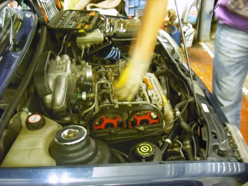

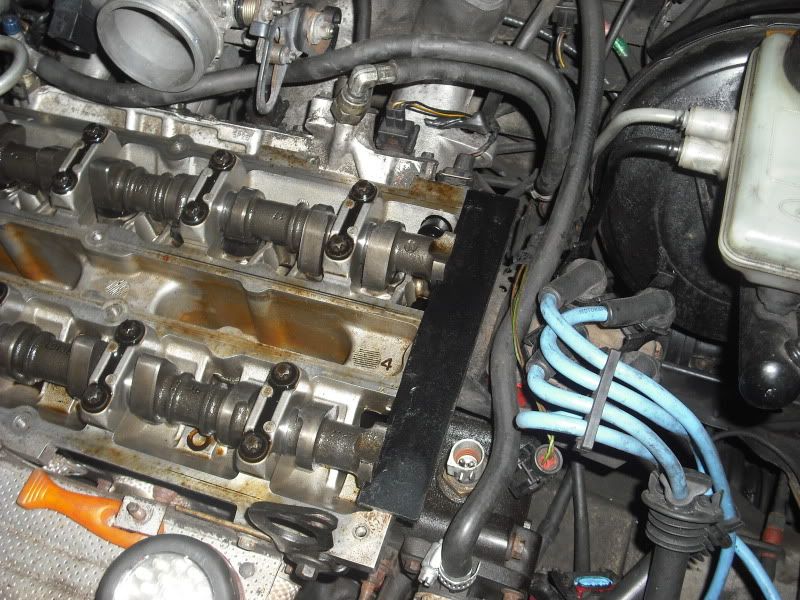

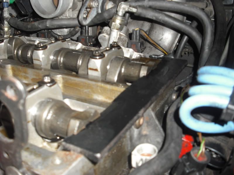

anyway got the timing spot on, made my own cam tool and its very snug in the cams so i got them bang on

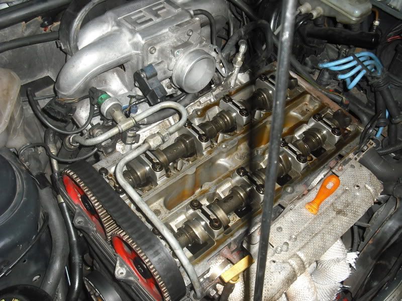

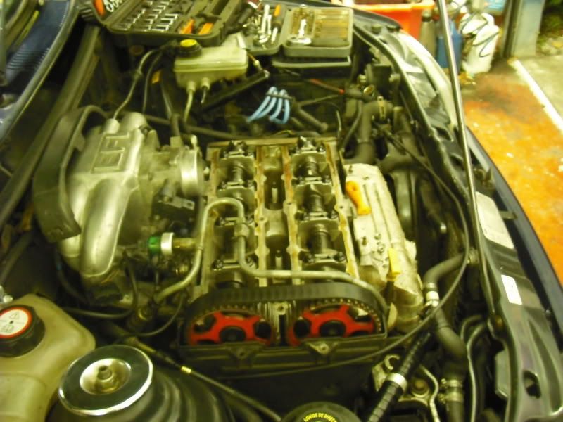

heres the last of the cam updates, this was all done nights ago but heres it being retimed and sorted :)
home made aligning tool, which i painted so i dont lose it
both bang on
going back together

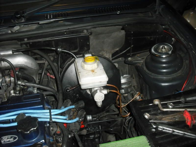

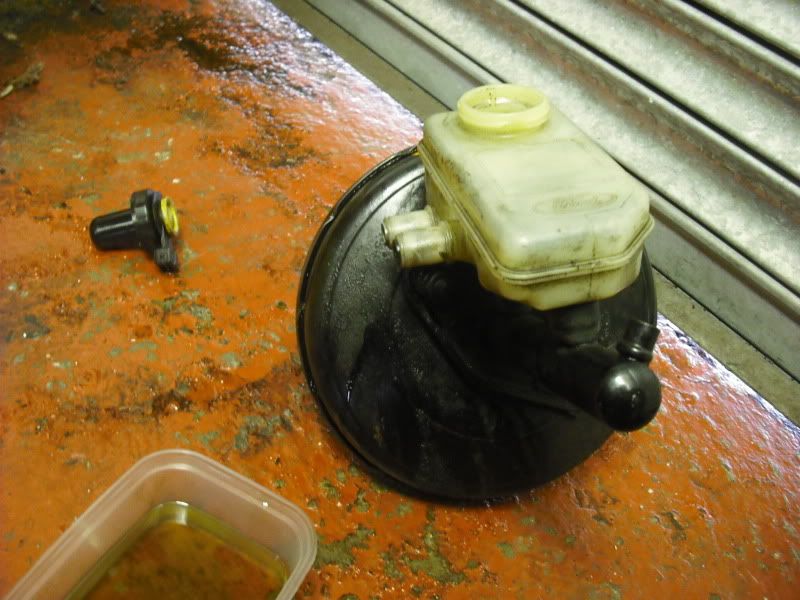

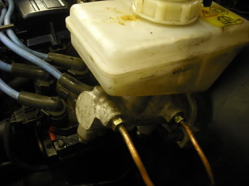

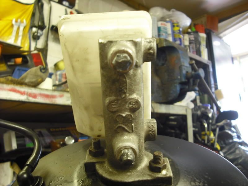

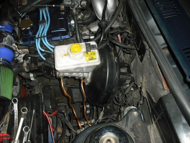

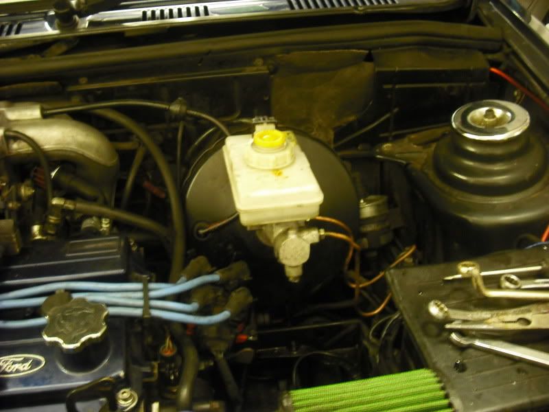

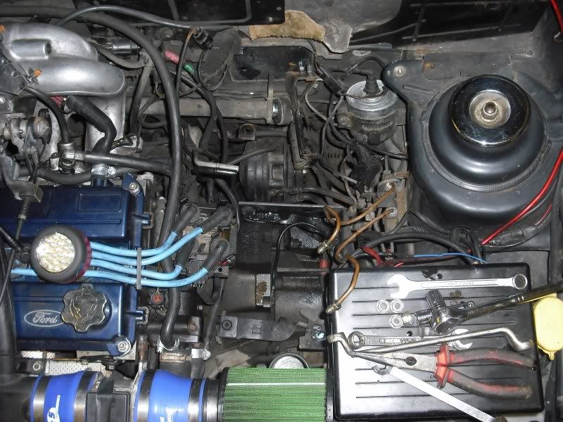

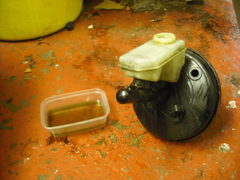

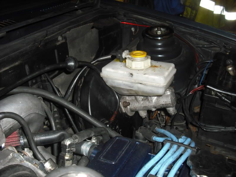

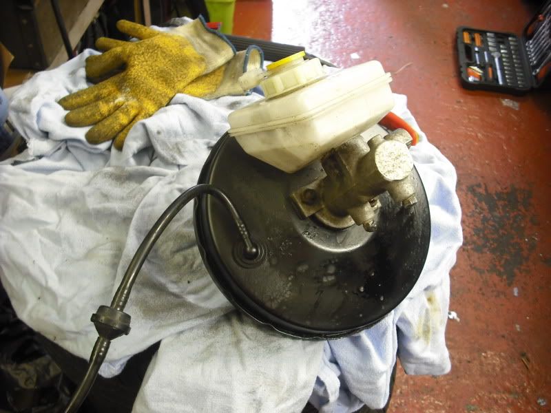

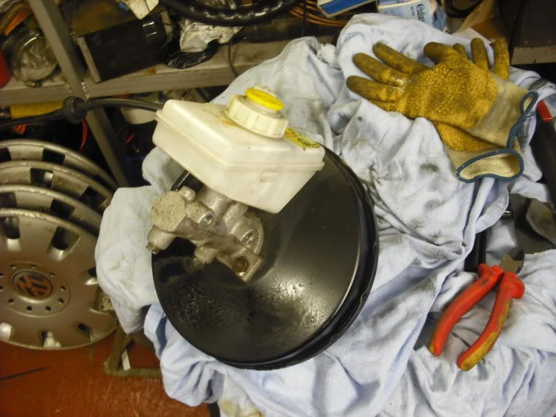

fitted the bigger mk5 escort servo today, yet to bleed the system though
standard one removed
new one getting some paint (first coat)

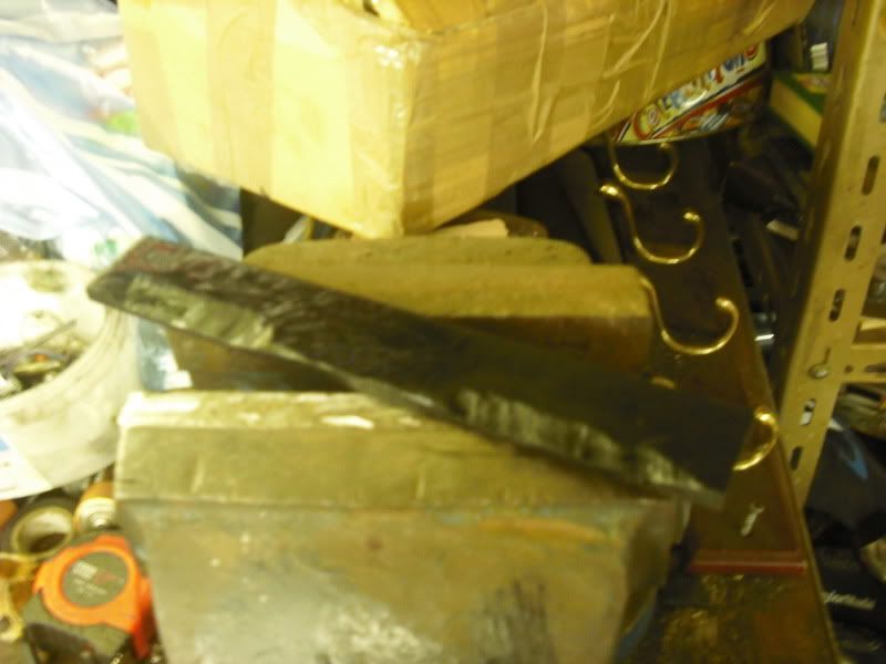

Blanks (welded up standard male brake nut/flanges)

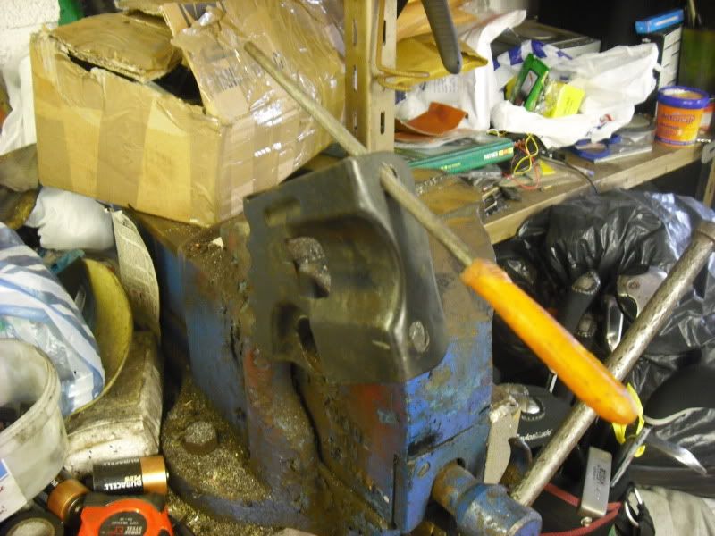

filing the servo bracket to take the wider apart studs the escort servo has
brake barre connected, spring and grommet on, and all bolted up with brake pipes reconnected
will bleed it tomorrow 8-)
