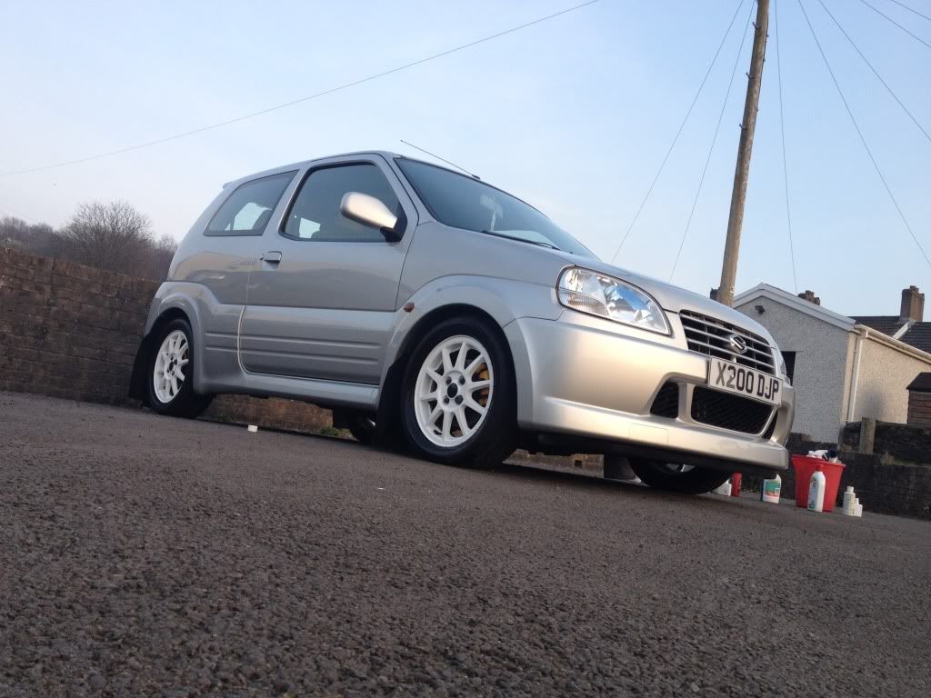

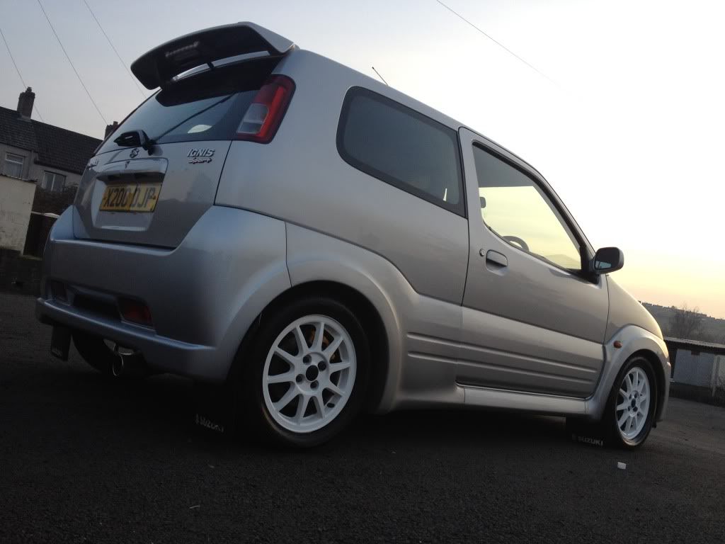

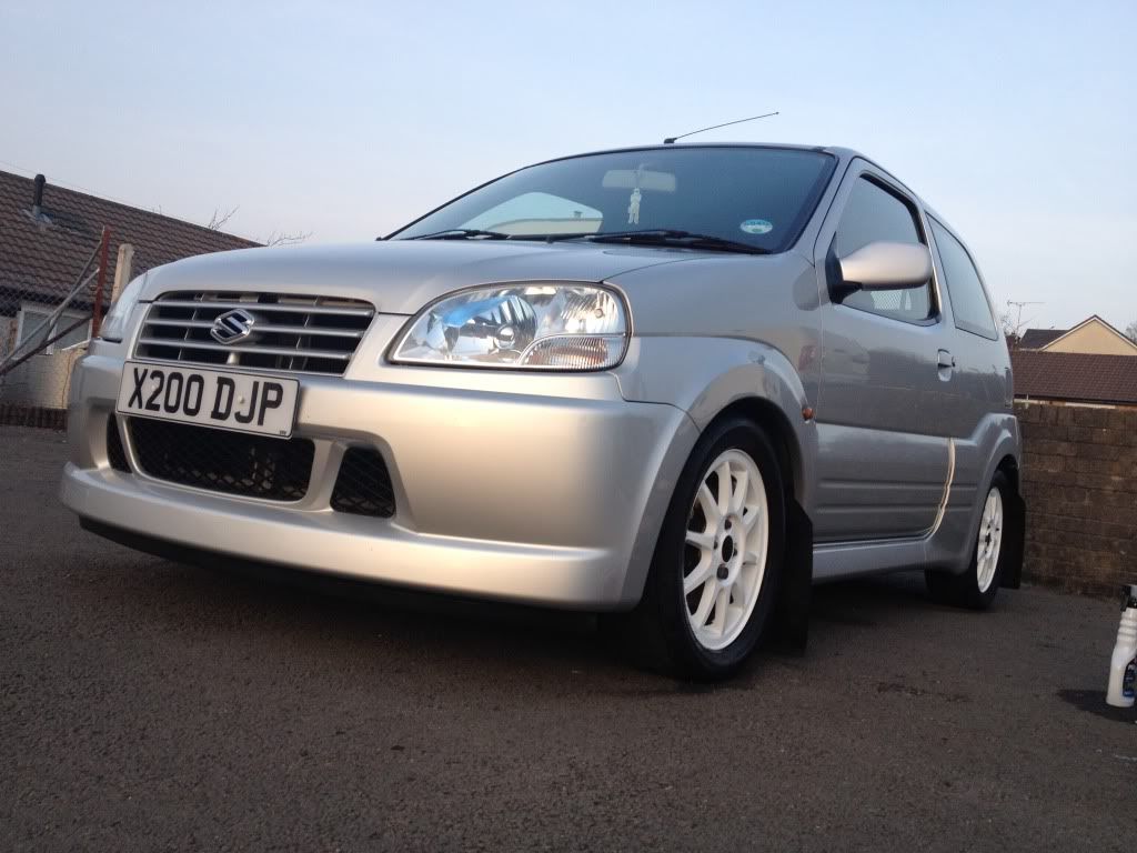

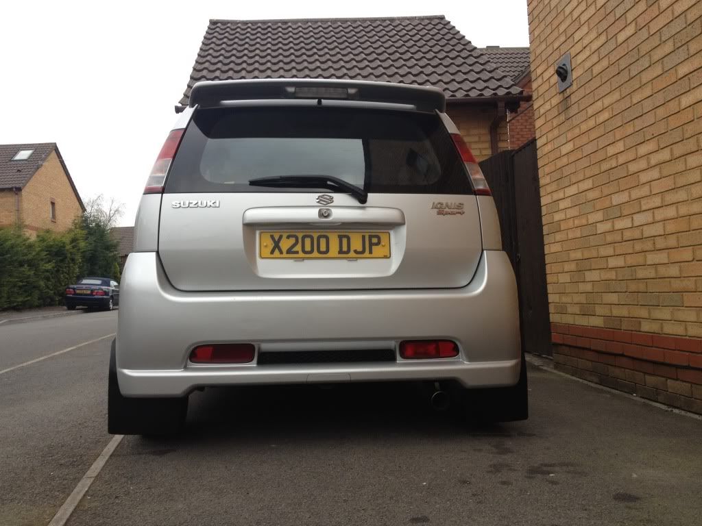

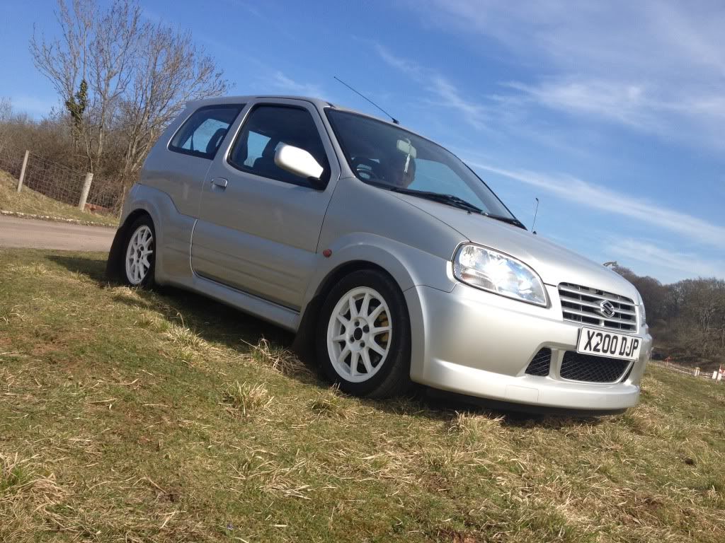

some pics of the ignis after i went over it with the intensive tar remover yesterday.
cleaning it turned out a bit pointless after the tour of caerwent rally today, now its covered in dust lol

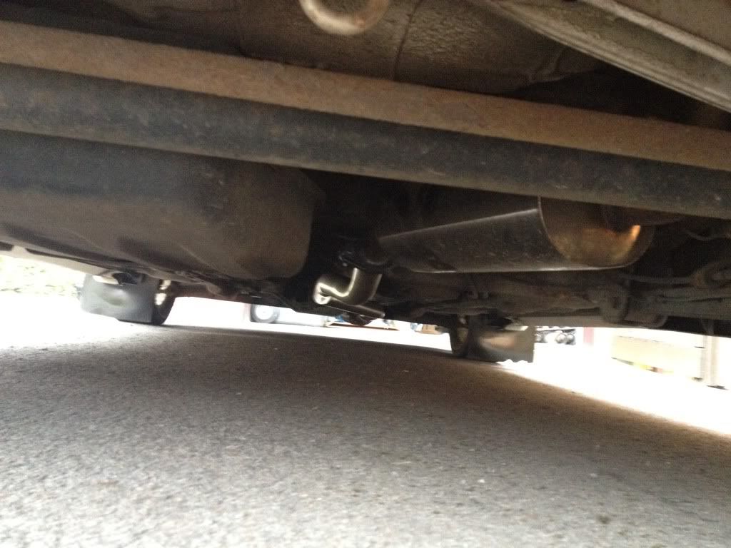

Got the final part of the exhaust sorted today at longlife
2" middle section, and i opted to get rid of the mid silencer, was worried it would be loud but its all good, no different really, maybe a bit raspier.
car seems to pull a bit better now, although it might just be in my head lol soon see tommorow on the dyno!

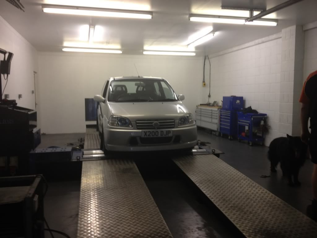

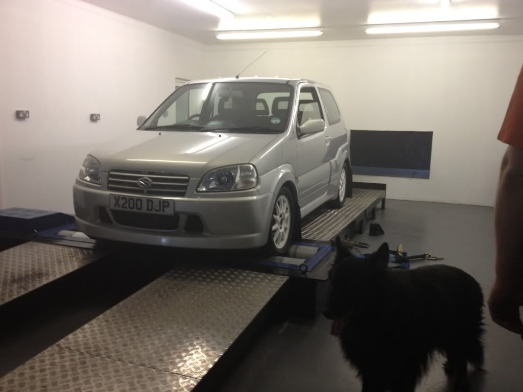

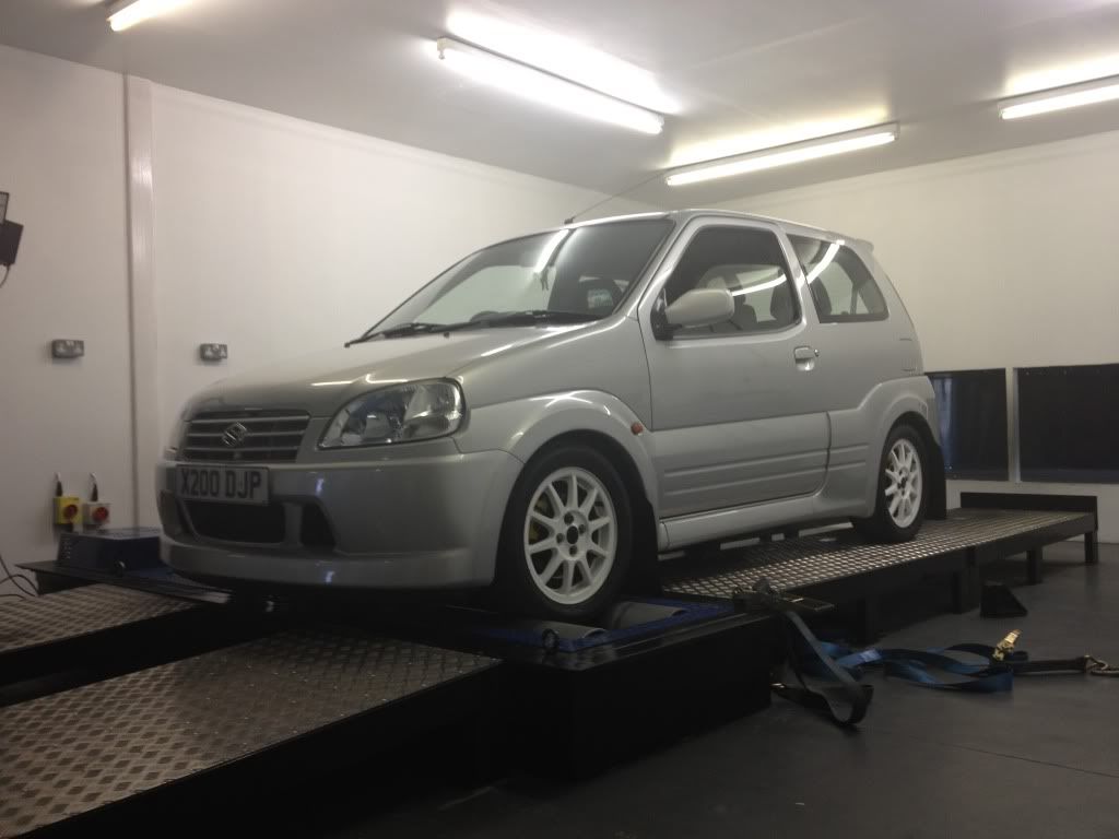

Anyway rolling road day sunday, had a feeling it was gona be low on power but on the day on the way to the dyno it was flying, it actually felt like it was gona put out good power.
on the dual carriageway on the way there it was keeping up with a fiesta st, mountune fiesta zetec s and jonys mk3 fiesta si 1.8 zetec which made 133bhp (i was actually catching him at one point, and i left 2 puma'd fiesta zetec s' for dead.

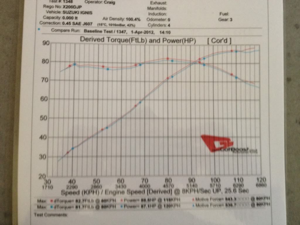

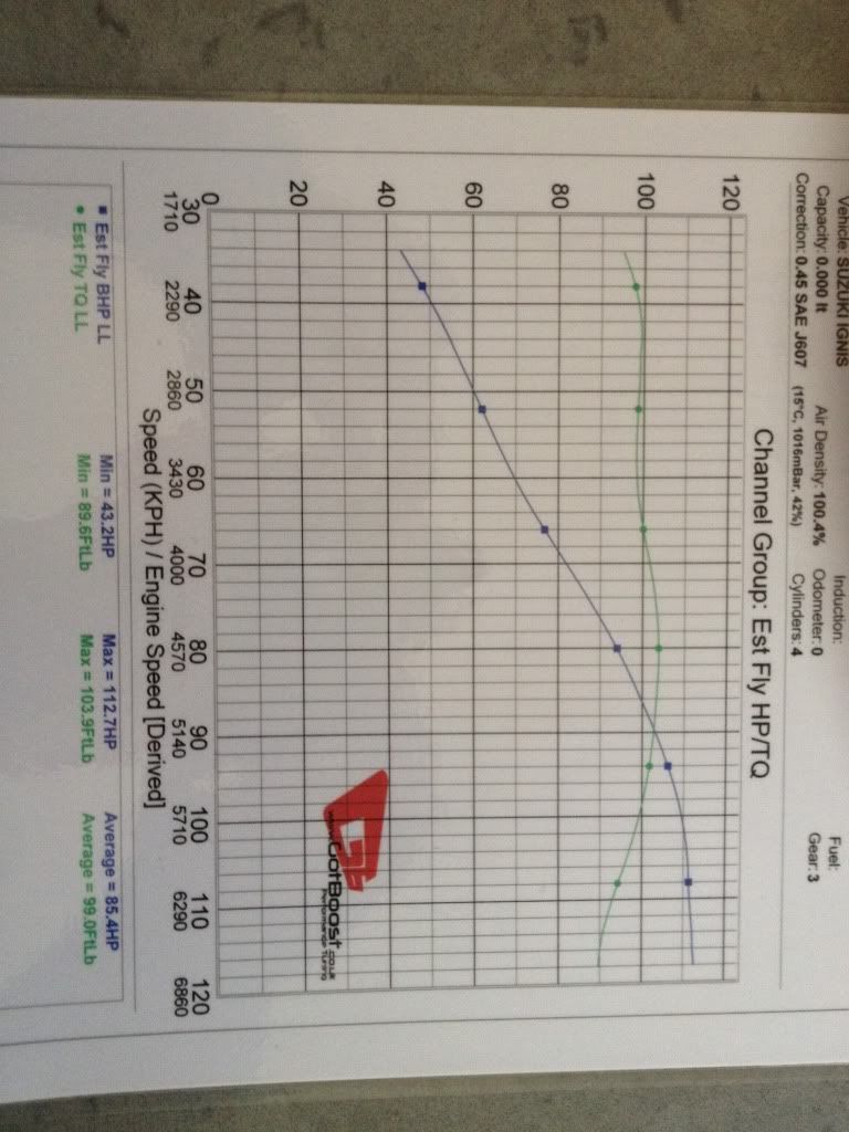

anyway, the car made 112.7bhp at the fly and 103.9lbft.
88.5bhp at the wheels and 82.7lbft of torque.
i suppose its better than standard but for what its got on it surely it should be about 120bhp?
although i believe theres definately something up with it, i have an intermittant flat spot which i cant find under diagnostic check, so its proving to be a pain in the arse to cure. so maybe the car was pushing out good power on the way there but was flat on the dyno??

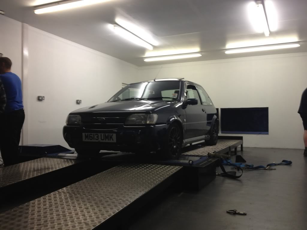

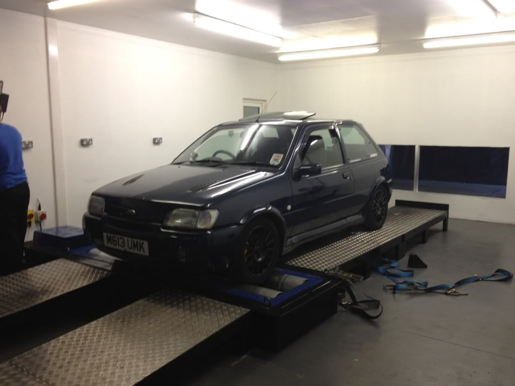

and jonys si. which produced 133bhp and 140lbft at the flywheel.

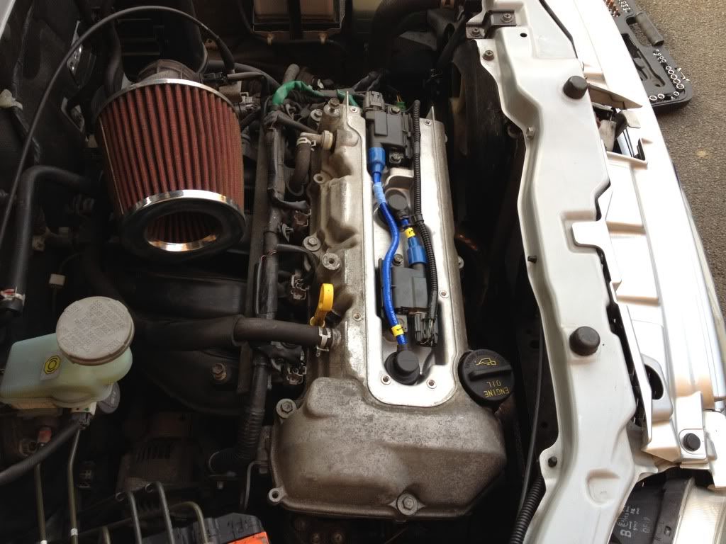

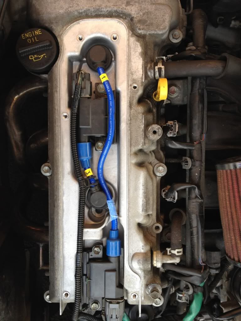

thanks to paul from partbox for sorting out speedy delivery on my magnecor leads, unfortunately they didnt come in time for the dyno run, but i fitted them monday night after work, and inspected the plugs while i was at it.
car seems to rev a bit smoother with them on now.
next job now is to find out why im getting this flat spot.. i believe it may be the universal lambda sensor i fitted from ebay after the other one siezed in the manifold.
but i might also order a jr panel filter from partbox, so then at least ill know the air filters a tidy new one, not like the cheapy cone i have at the moment.

Nice power curve on the graph indeed! Good to see its got a few more ponies pushing it along too :D

theres something up with the car, im pretty confident that its the lambda sensor. it should be 120bhp+ with the mods ive got, but at the moment least its better than standard.
as for the little blast we had, the 6 of us were in line at the traffic light and we all shot off to about 80, one of the pumad fiestas made 108bhp on dyno with catback and de-cat (which was well underpower) and the other which was also underpower made 116bhp and was stripped out. the onbe lad actually came up to me after and complimented on how quick the ignis was, he didnt realise it was only a 1.5 lol i dont think it would beat a up to scratch one though, maybe when its running right, although at the time it was going well.
heers for the comments though guys.
and jonys car done better than last time too, hes changed the filter, sorted his exhaust fitted a 1.8 sandwich plate and kent cams and its given him 7bhp more.

jony's 140lb.ft made me :hsugh: though as that is really high
PostPosted: Wed Apr 04, 2012 12:42 pm
Cams
PostPosted: Wed Apr 04, 2012 12:45 pm
won't make the torque that high
