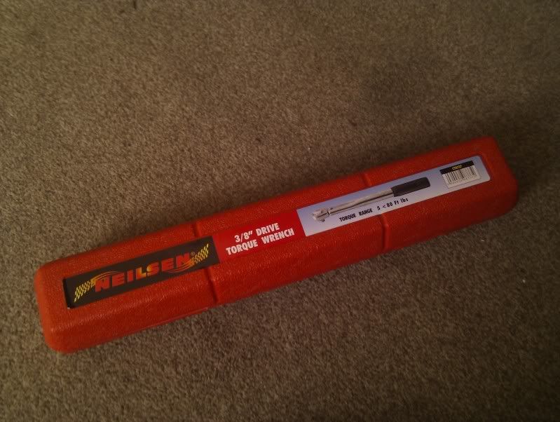

bought myself a torque wrench for low end scales today at the Gnoll classic car show in neath so ill be down there in a few mins checking the tightness of the cam caps, as im convinced theyre too tight, driving it makes it seem like the handbrake is on, theres a physical restriction there

I actually wanted to know - Petrol, how much was that torque wrench? :)
PostPosted: Sun Aug 14, 2011 10:16 pm
it was 19quid my good sir, found it on someones tool jumble :) i missed it actualyl and i waslooking for one, my old man who is BLIND saw it! tup...
