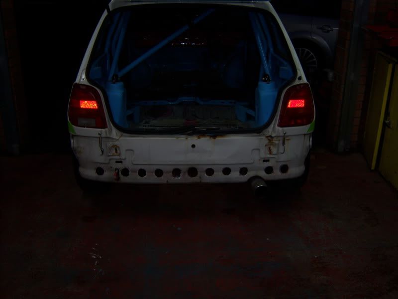

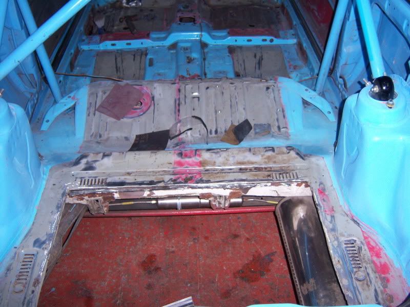

worked on the car on Saturday nite , with a few cheeky budweisers, help keep the cold at bay, if frrrreeeeeziiiing now at nite up here
front panel had some weight took out it
removed the battery tray, and jack mount from under the bonnet
sanded down under the bonnet , ready for primer now
finished removing the rest of the sound deadining from inside the car, this is a horrible job, and glad its now finished
removed the inside of the door, and removed the sound deadining too, im gona leave the crash bar in there for some strength
Im gona have a real push at the car wedneday /thursday, get all the cutting finished, and inside the car all flattened , ready for the welding to start Sunday

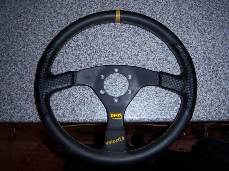

been buying some bits for the car
new steering wheel, 350mm , think this will suit me a bit better
