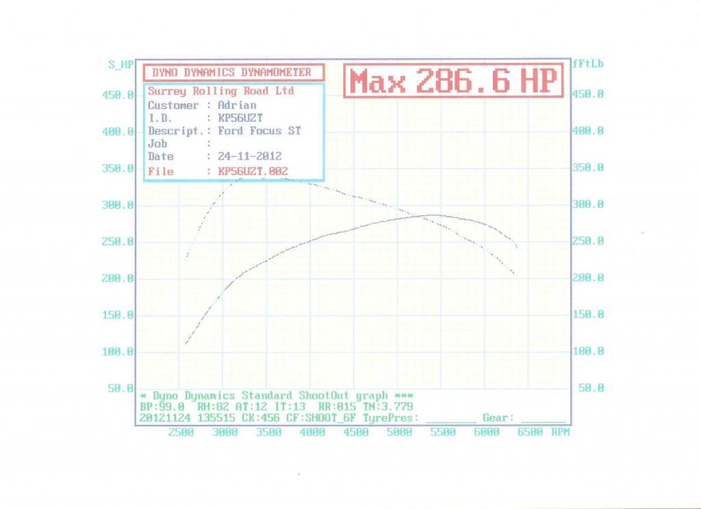

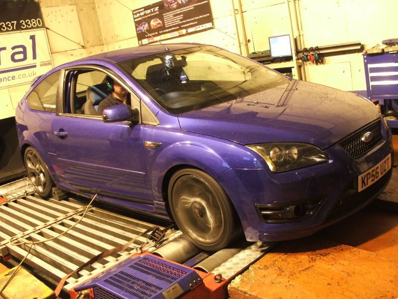

Plonked the car on Surrey RR with Focus STOC today see what the car is upto and how its running today and things are an improvement, but its Running abit rich possibly an air leak post turbo?
Gonna have to research/get it looked into at some point
Not it was not clean lol drove there straight from work, sounds immense on the rolling road 8-)
This is with the standard cat and the fueling issue, Operator reckons its a 300-310bhp car with those 2 issues sorted, RS injectors would help further
286.6bhp no printout for torque but line on the graph suggests around 345lb/ft
Still im happy with that, need to get more done when next year arrives :thumbsup:
Also any ideas on the fuel running rich? (dyno operator suggested air leak post turbo) Not clued up lol

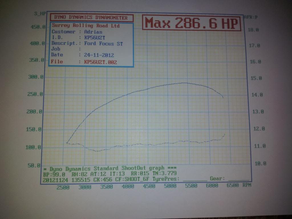

How rich is rich ?
Did they plot a AFR vs Boost graph ?

For you Alex, AFR ;)

That's a nice power curve Ade. I'd assume it was the map simply running rich as standard due to safety precautions against knock, seen it be the sole cause of many other other cars running plug-in maps that then go on to have a custom tune developed with nothing else changed. Could be other things but I wouldn't worry as it's not dangerously off in my barely-educated opinion (i.e. take what I say with a pinch of salt ;) )
My AFR was between 12.5 and 13.7 for quite a few months when I whacked on a totally different bottom end and it was fine.

dont worry about it being a touch rich, mine is set up to be the same like ry said to prevent knock :thumbsup:

Not as rich as i was sexpecting. Below 11 is abit low, i would be expecting 11.5 - 12 across the board .

Found this http://www.angelfire.com/pro2/rst/air_f ... g_tips.htm which makes yours look spot on top end but just a bit rich bottom to mid.
As said likely a safety thing with standard map.
Proper rolling road tuning will likely eek a bit more power out and sort out the afr but is it worth the huge cost for gain? Probably not.
Caveat here, I didn't fully read te linked article but what I did read supported all of the above.
