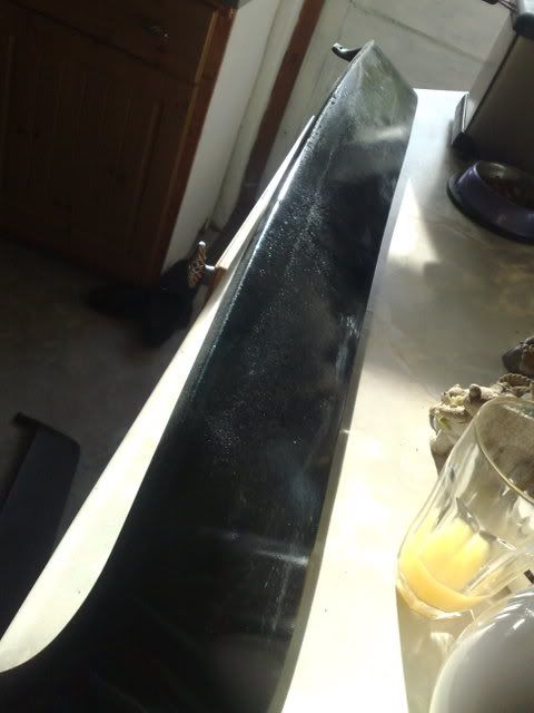

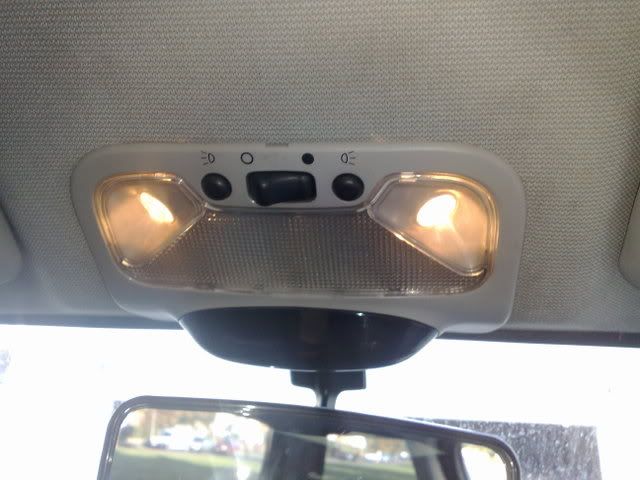

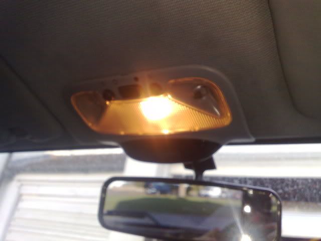

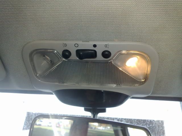

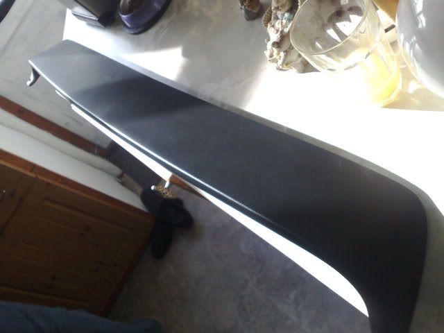

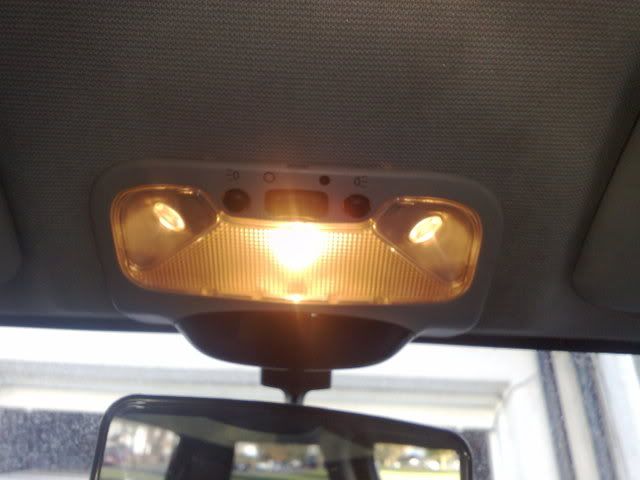

well took a trip to the scrappy today and came home with a mint spoiler and a mk4 ghia interia light with alarm sensor and spots :chill:
the light was a nightmare to fit, involved alot of cutting to the inner roof and the roof lineing but it was well worth it in the end :halo:
pictures
old spiler
new spolier

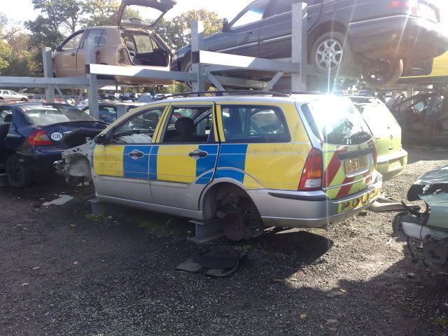

also saw this lol

thankyou terry! i dont think i have ever cut myself so much trying to fit something and worried so much about cutting the metal and roof lineing :lol:

What did you have to do to fit that light?
PostPosted: Fri Oct 17, 2008 11:43 pm
Think its just a case of trimming the headlining for it to fit, and some of the metal above it, plug it in.. glue it up, job done 8-)

nice mod there :) its always good to see a police car in the scrap yard :lol:

the light is as paul says, you have to cut the headlining and the metal under the headlining, cut the 2 point plug on the brown wires so there seperate as the mk3 light has the 2 connectors inline but the mk 4 as 1 going vertical and one going horisontal lol then plug the wires in and it will work ;) then if u have cut the metal correct under the headlineing it clips into place, no glueing needed :chill: ill make a guide for it tomorrow when im bored!
phil: cheers :) very nearly got some headrests to try the trick with the rear headrest conversion but ill do that another day! there were 2 police cars int here, i didnt spot the other one untill i went back there the next day! both focus estates, also a 57plate fiesta in there roof compleatly caved in :shock:
