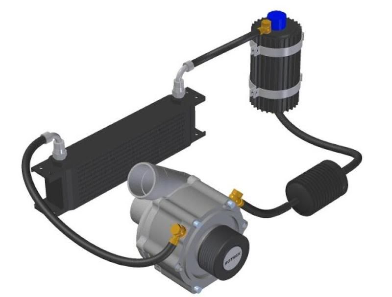

Im prob being a retard, but what is traction oil? I take it for the charger?
PostPosted: Thu May 22, 2008 2:07 pm
Yeah its for the charger, it needs its own supply of oil, early rotrex tapped into the engines oil, like turbo's, but then they moved onto its standalone system, it needs it other wise the Charger will get hot, which will increase inlet temps, but can infact weld itself shut. There was a Charged VTS which had a hose pop off on track and the charged welded itself, which left him with £1300 paper weight! :rolleyes:
Its infact in a 1l bottle, so £70.50 for 1 frigging litre! :0
Set up will look like this! :)
