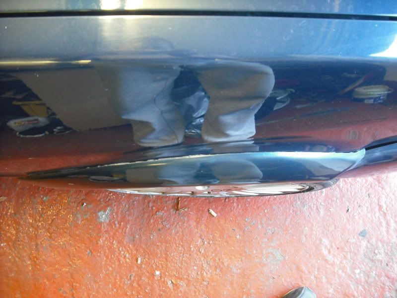

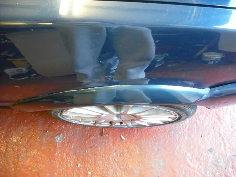

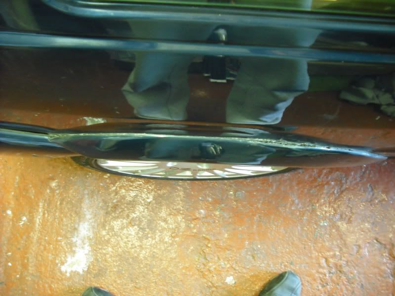

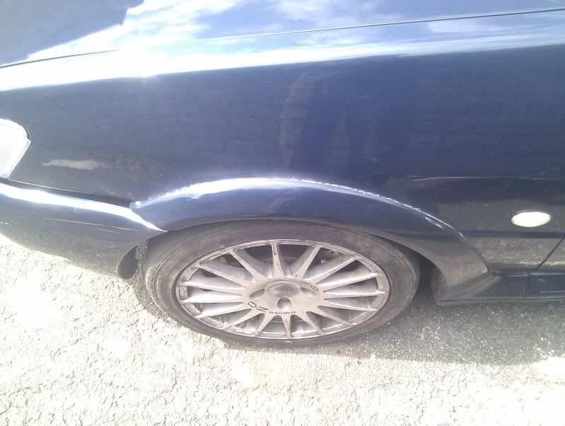

get a buffer and do this on yours mate, after a few hours practice its easys, but dont let your guard downa s its easy to damage the paint
thanks mate means alot
ill get a good pic of that area, but its come out really well, could do with a tad more blending in though

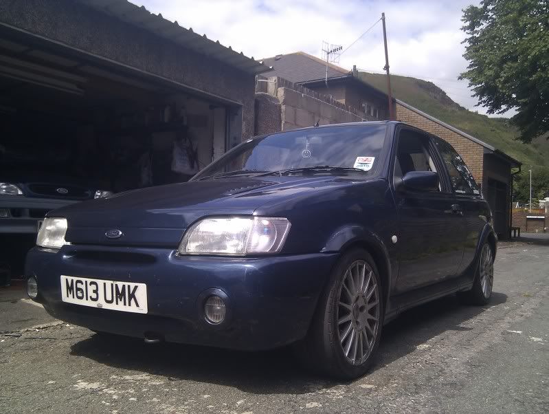

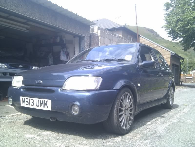

true but after the damage on my passenger door and wing, i was thinking today it would be extremely difficult to get a good colour match with the door and wing... so i think ive decided to save for a full respray. i think it needs it, then i can just keep on top of it looking beautiful!
defo mate, would like to see the area as it stands.

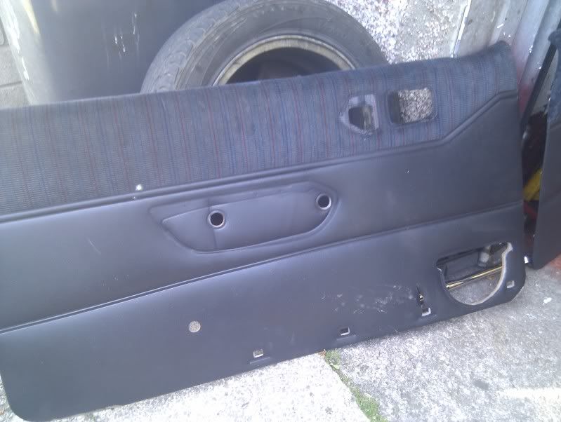

bagged a right bargain today :D
the escort tis now gone, sold for a alright sum i guess, wanted more but dont we all? and almost never get that figure :homo:
bargains being :D
brillirant condition! but the drivers at the top where it clips tot hem useless clips is a bit tatty as it doesn't sit in the clips, which is anoying, other than that they're in fantastic condition :D

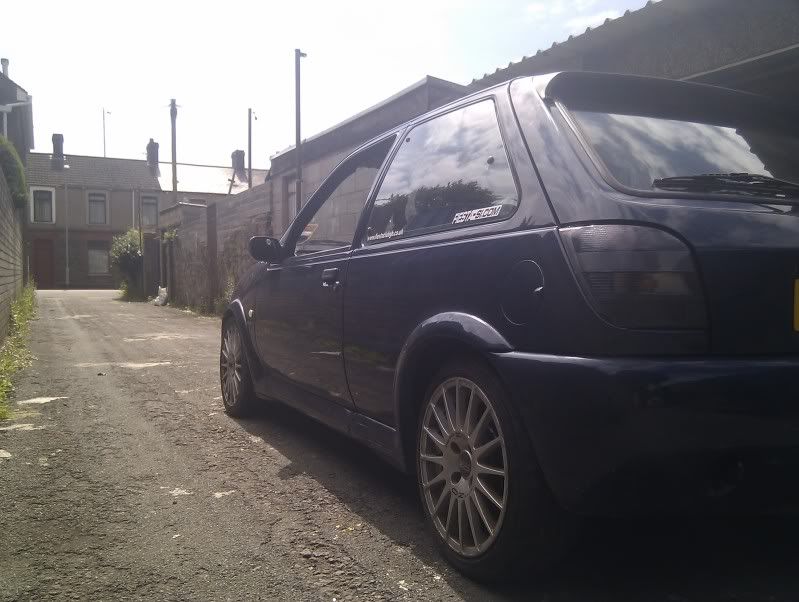

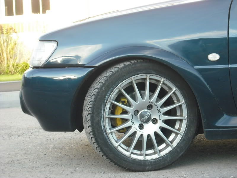

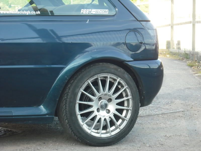

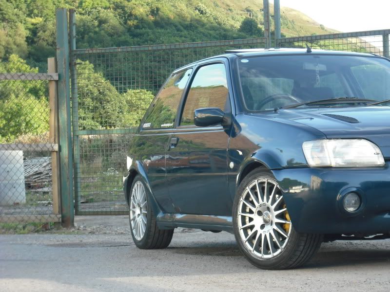

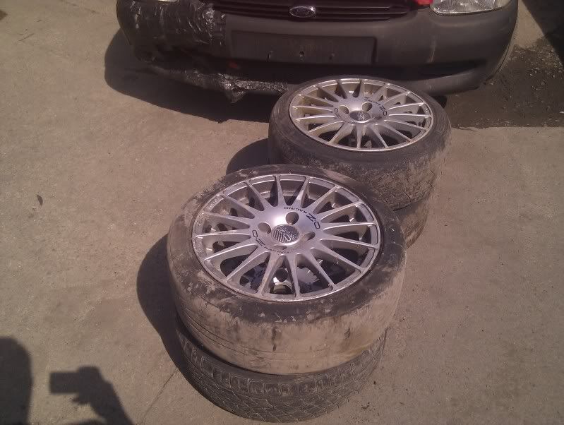

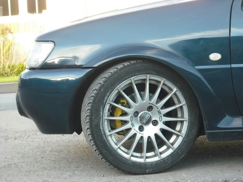

O.Z Superturismo's in 16 inch and 7j wide :D unsure on the offset, i removed them from a mk5 Zetec s at a breakers
might keep them, might flog them on, reckon i could fetch around £300 if i referb them, as they are pretty kerbed up and theyre in good need of a good scrub and wash
but absolute bargain, tyres are knackered though, was going to be my little surprise mod for ford fair but i guess that can wait :P

I like them! Always loved super t's go with any car.
Personally I like them, plus they don't fetch much anymore.

super ts look good mate!! keep em!
PostPosted: Fri Aug 05, 2011 11:37 pm
prefer the si wheels if im honest, never used to like. but maybe with a refurb and nice new tyres it might change my mind!

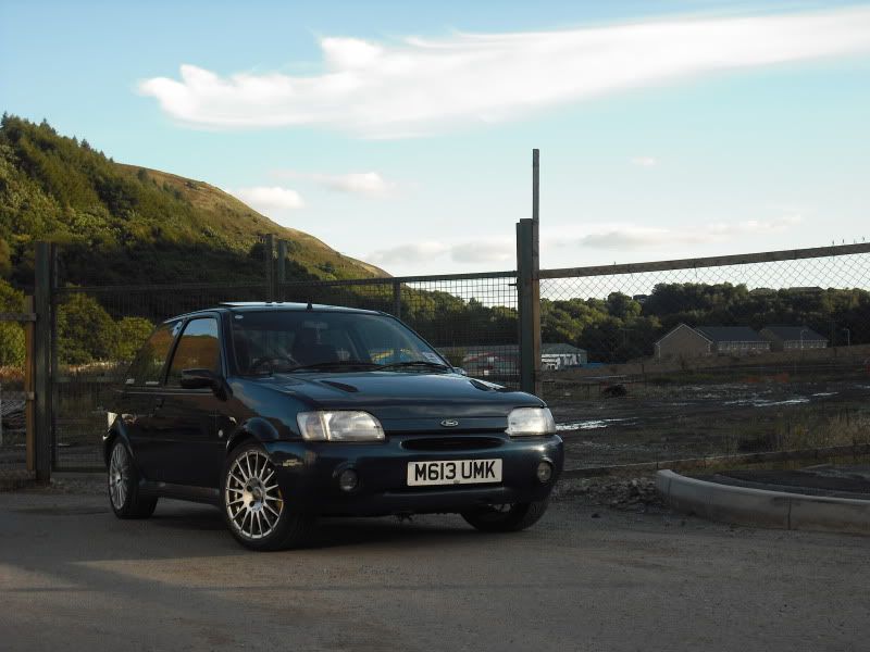

PostPosted: Sat Aug 06, 2011 12:11 am

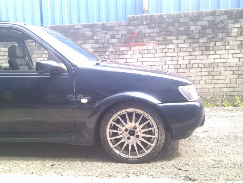

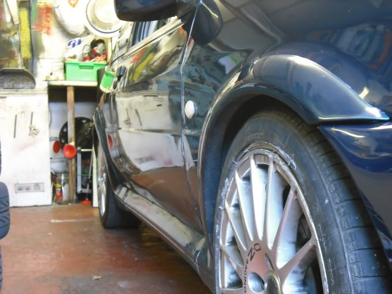

im hoping that too ben, getting tires monday , hope theyre 195/45/16s or they wont fit under the arches lol
just to clarify ford fair will be spent on the 16v wheels
PostPosted: Sat Aug 06, 2011 12:25 am
was going to say must be a tight squeeze! but they dont look oversized in the pics :S
PostPosted: Sat Aug 06, 2011 12:51 am
nah i know, i was shitting myself on the way home fromt he breakers but they fit snug, bearing in mine there 7J!!! the 195 tyres just aint wide enough and there is stretch :D never had stretch in my life lol, on top of that i need 5mm spacers just to fit them lol, gonna keep my eye out for extended studs at ford fair so i can run larger 10mm spacers, dunno "wheel" wait and see :P

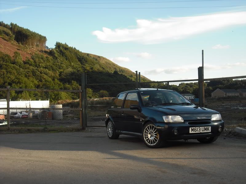

cracking weekend, great thanks and respect to Dave5300 and his mate, top blokes so down to earth, camping apart from missing the club was great,a nd ford fair was fantastic
the car looked the best it has since ive owned it and im very proud of my 0-60 time, achieved in my 3 runs a best time of 8.56 seconds

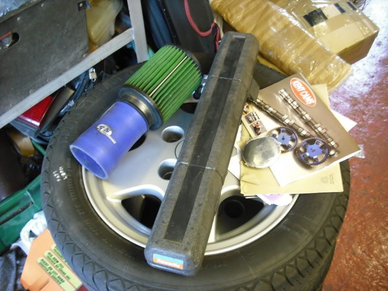

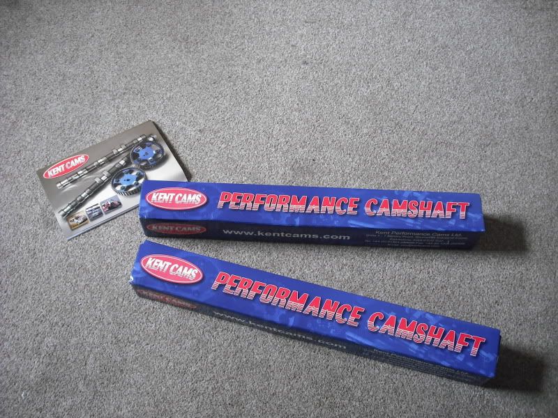

first off i took delivery of this rather exciting package, bought the lube seperate

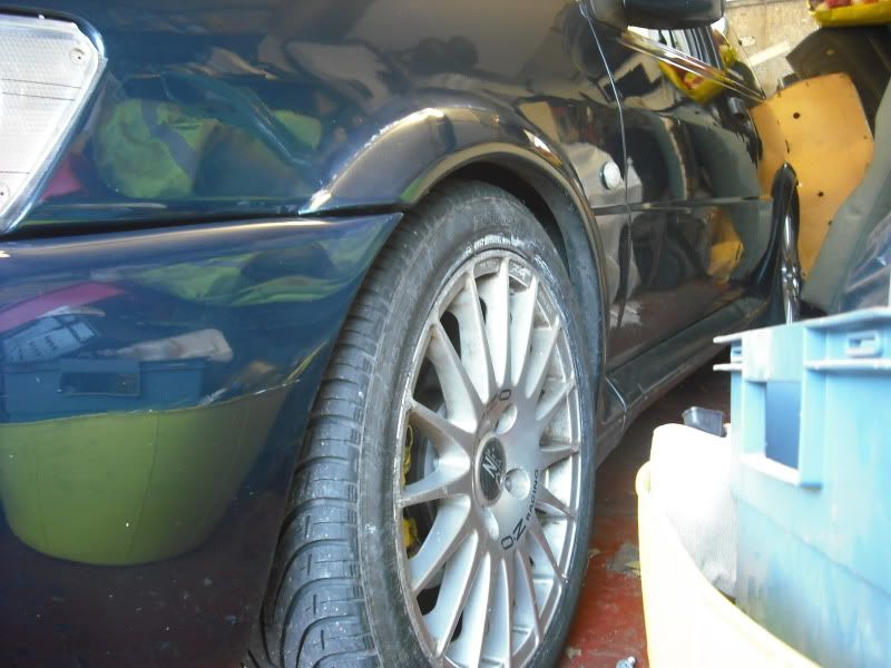

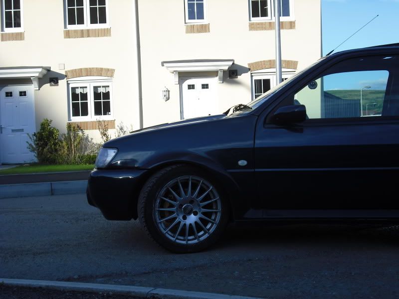

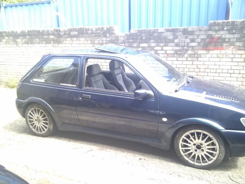

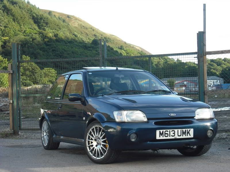

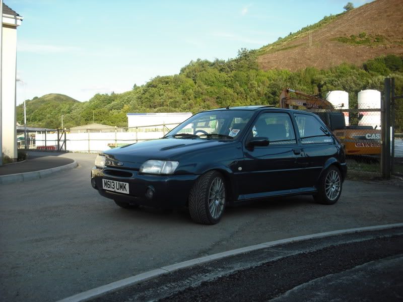

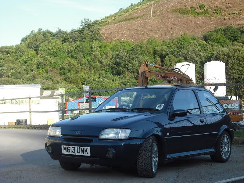

Then i got my new wheels wrapped in 205/45/16 tyres

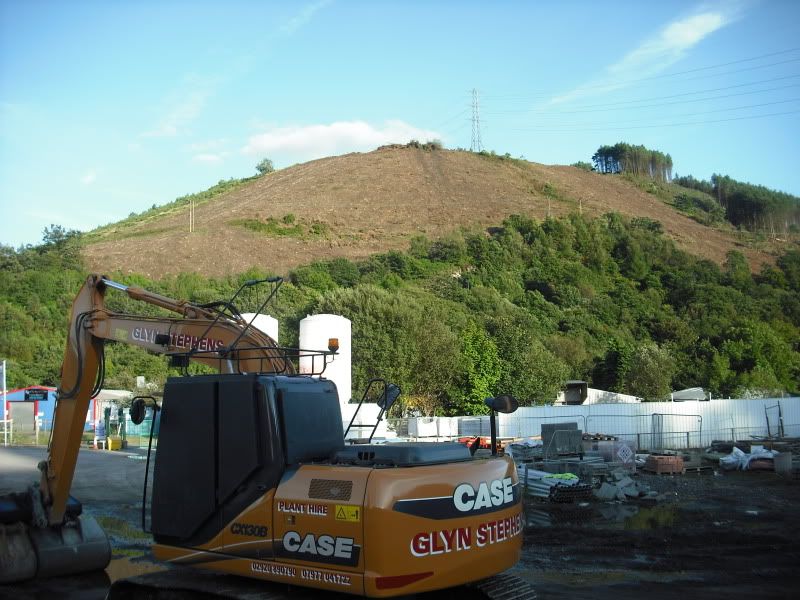

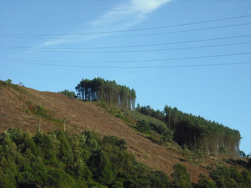

council are cutting down our forests all over the place due to an alleged tree disease spreading :red:

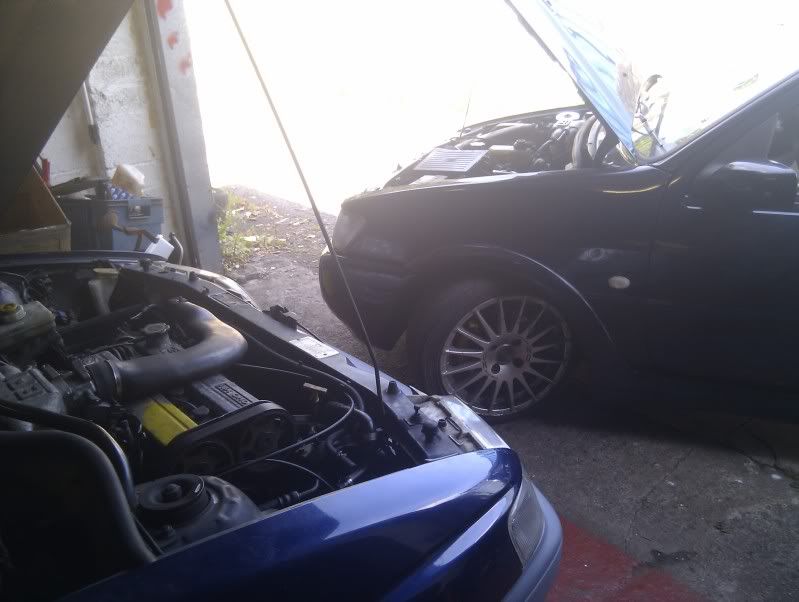

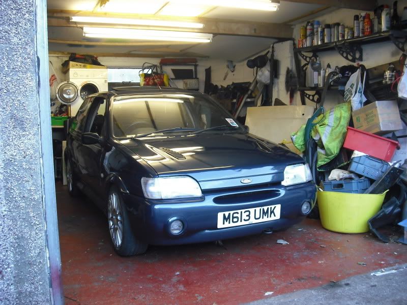

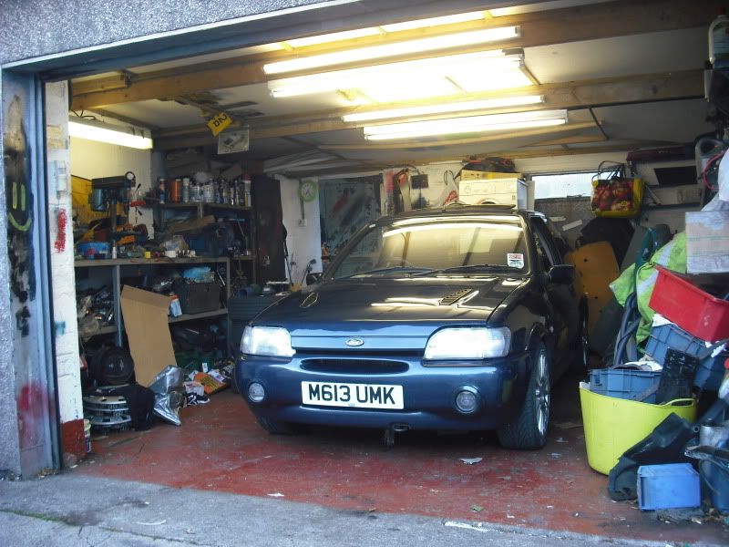

back at home, popped it in the garage for a night of improvement
Puss agrees

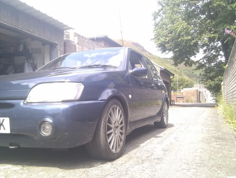

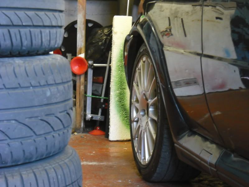

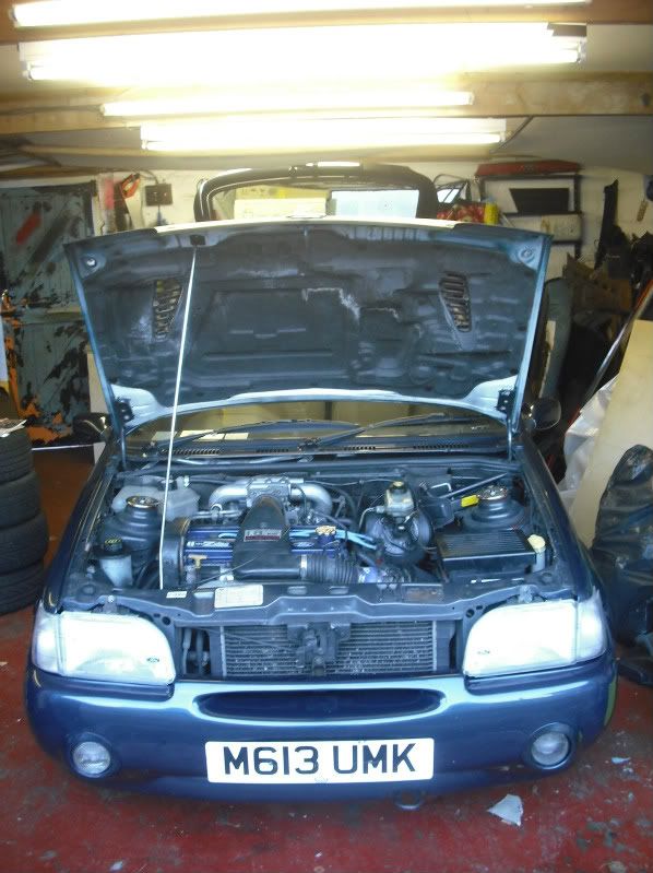

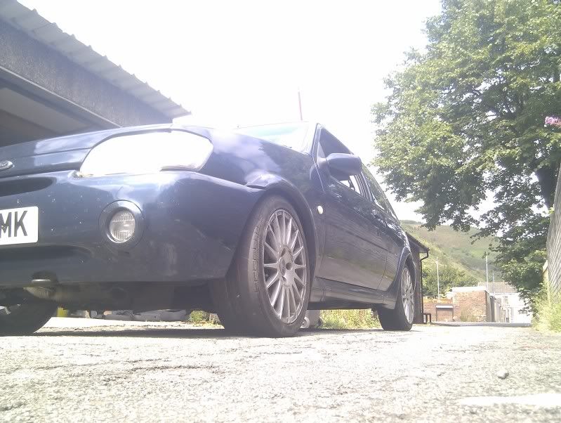

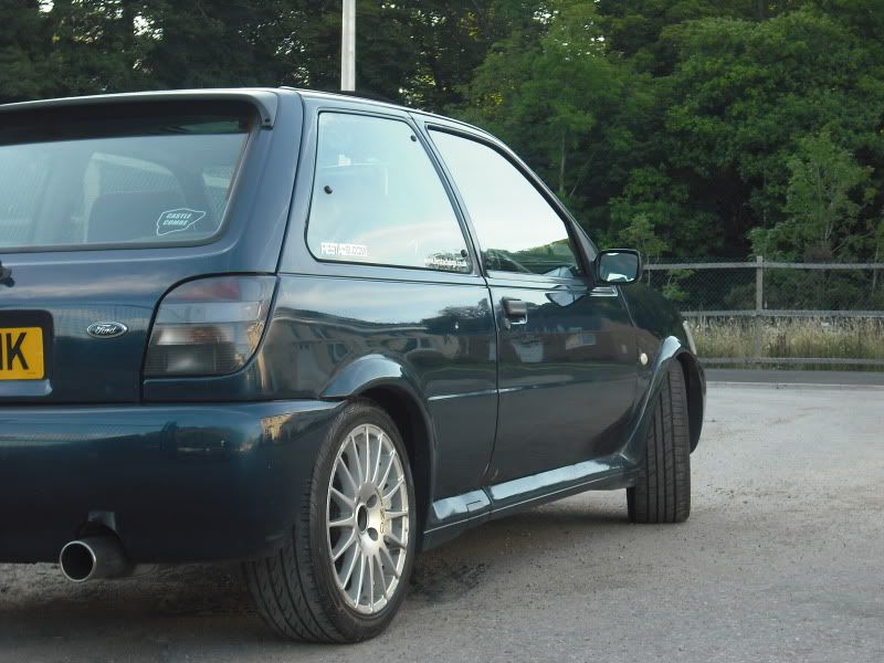

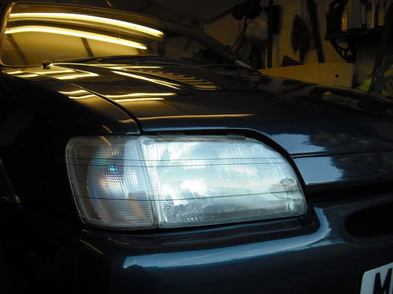

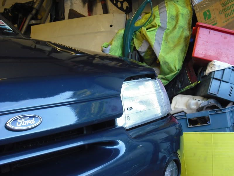

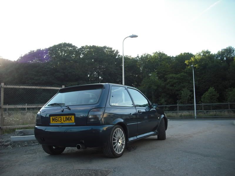

Camber and arch gap (remember its only 30mm) & new headlamp protectors
To surmise, before i started

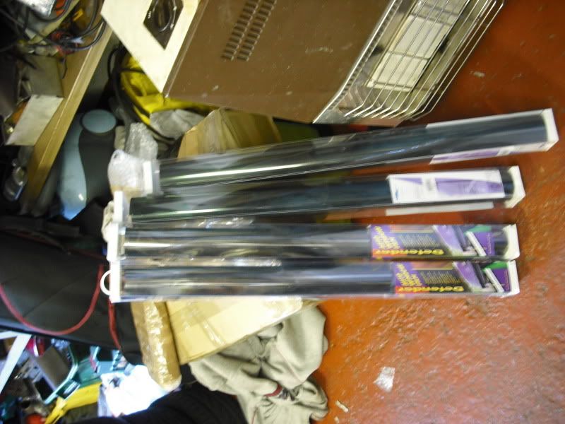

ill use the matt finish tint on the back three windows, might sell the reflective ones on, all 4 for £10 :D

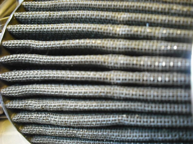

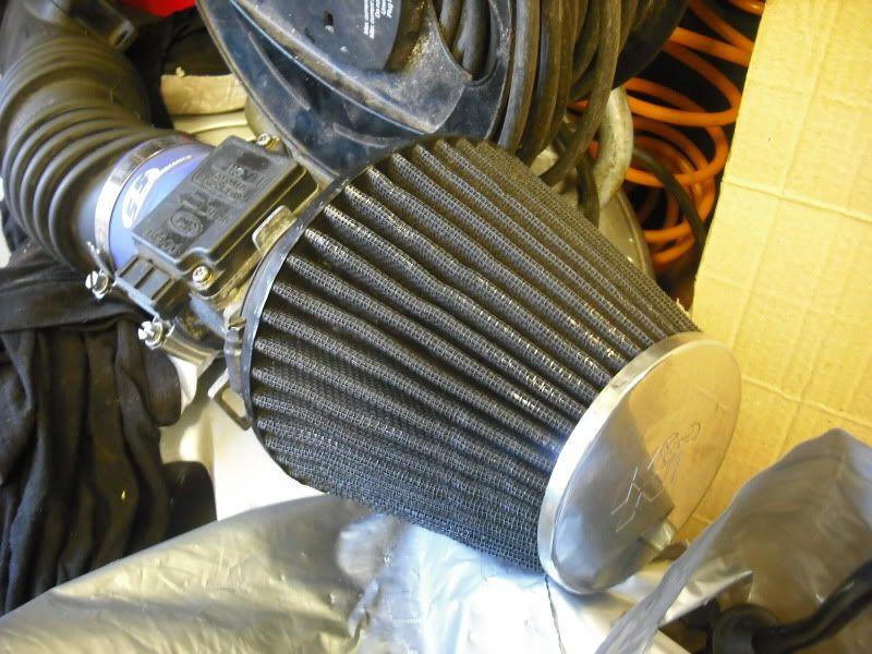

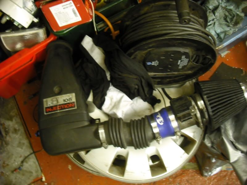

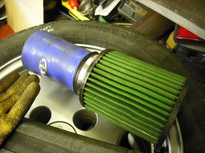

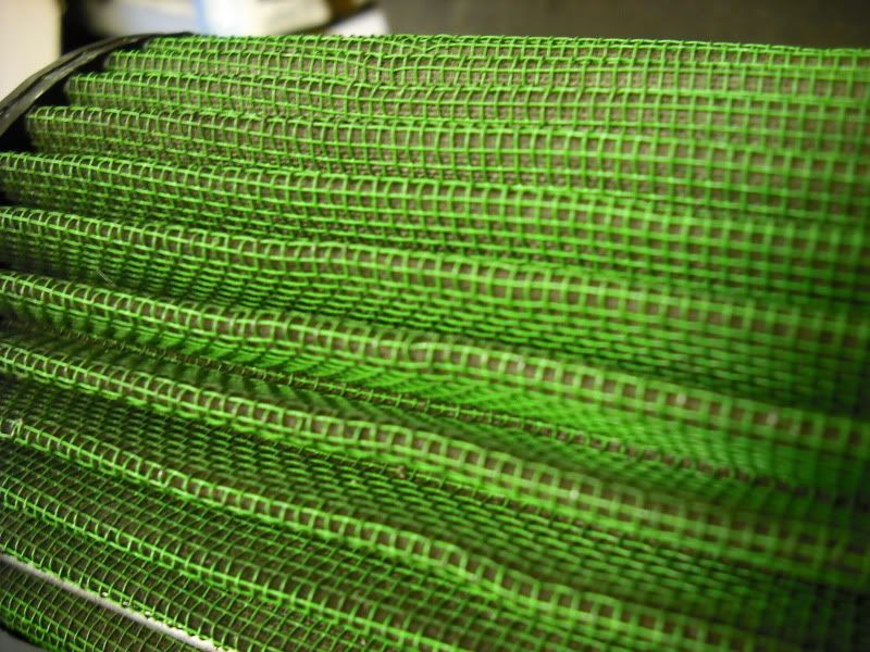

bought this because of the condition of my K&N, manking! not been cleaned since before i even bought the car :( i know im a slacker! so instead of £10 for a cleaning kit i got this Green cotton filter for £5 :)
just look at the close Macro shots, really filthy

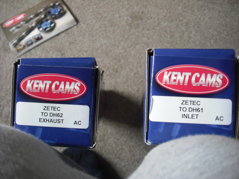

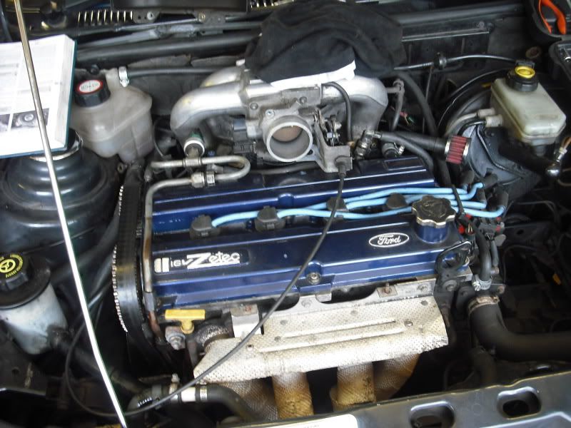

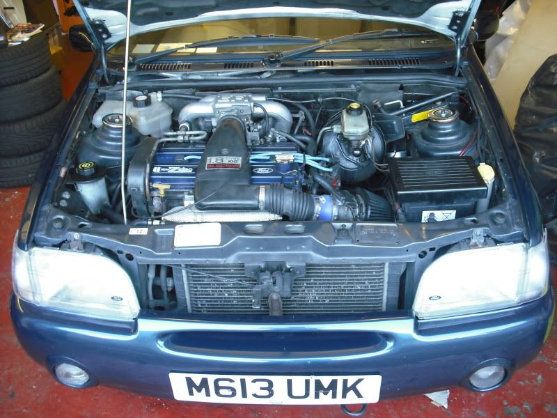

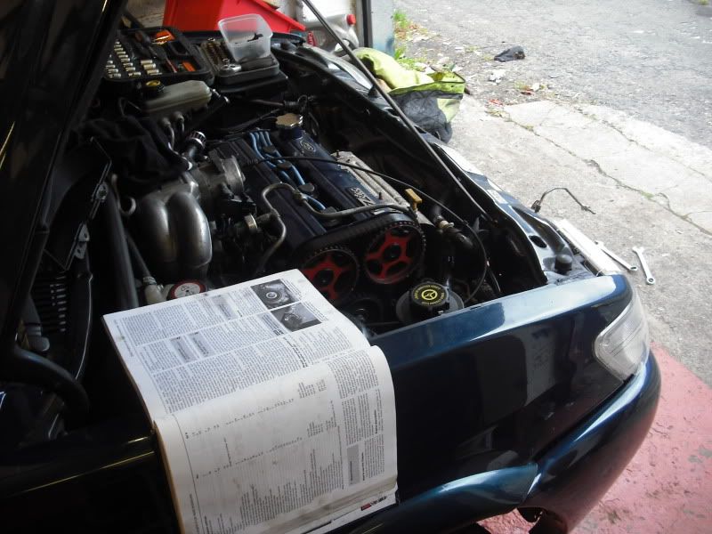

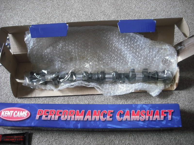

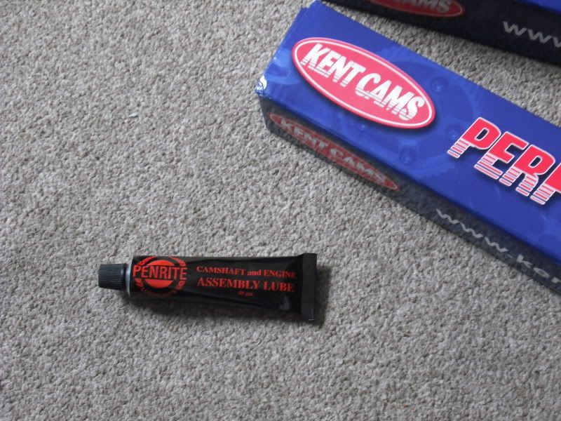

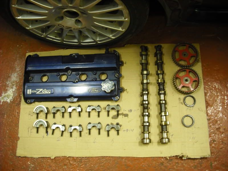

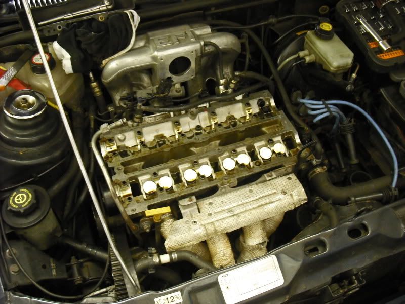

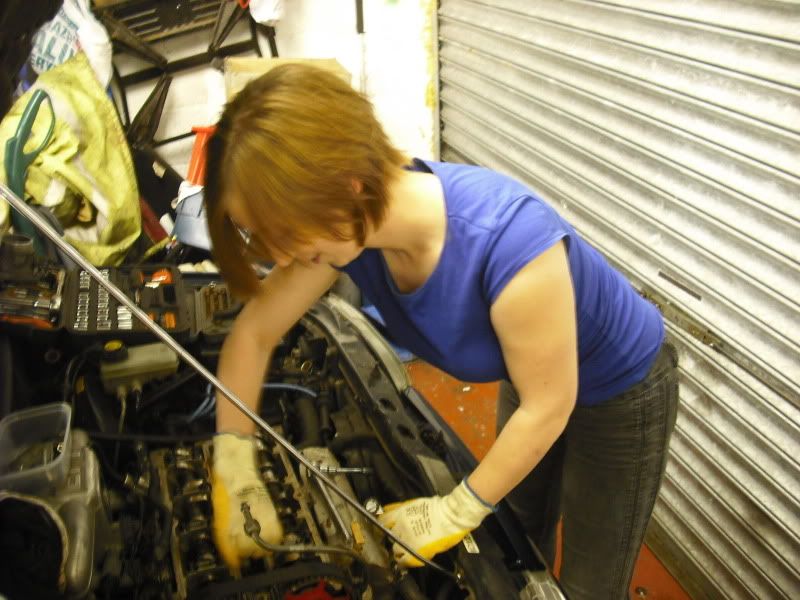

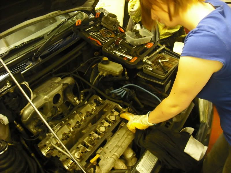

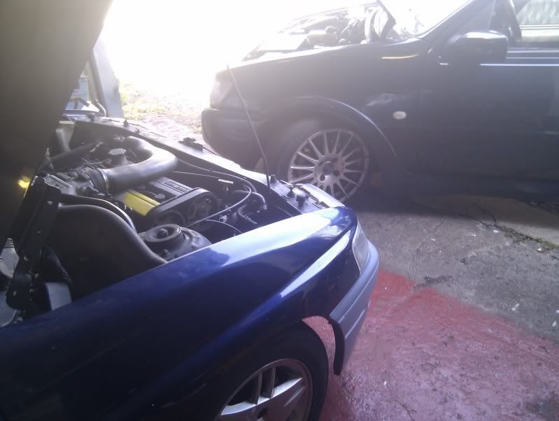

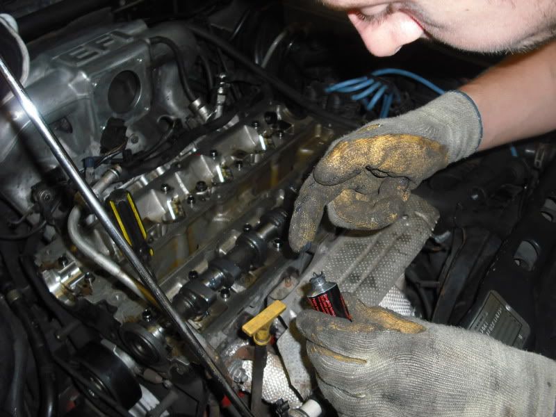

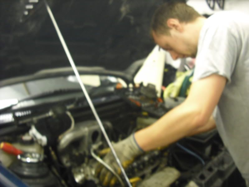

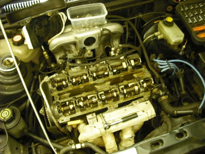

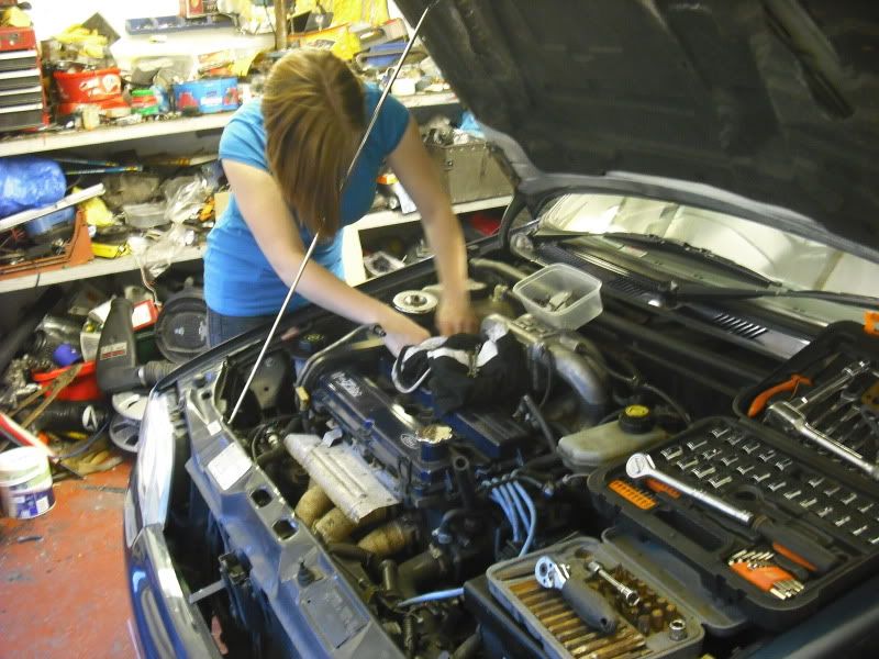

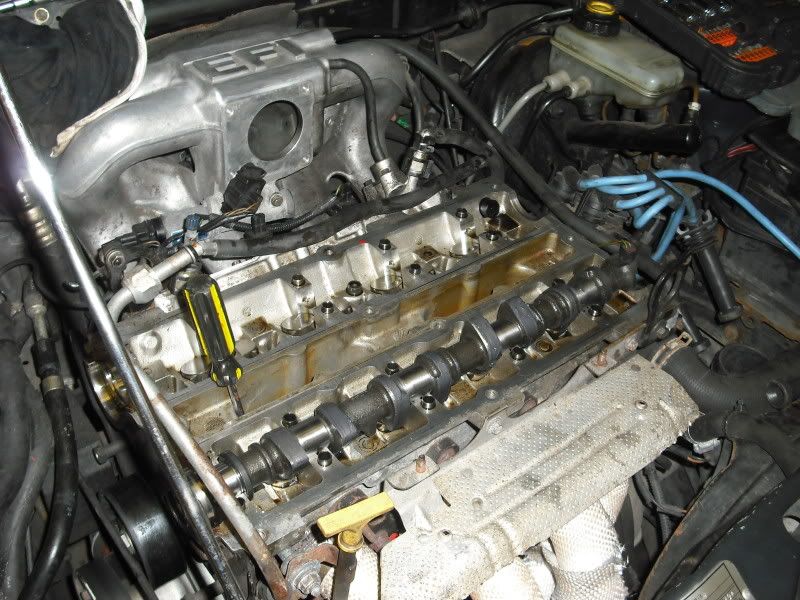

so i got cracking on the car, changing the 2.0 cams for Kents fast road 262 degree cams, and help from the missus

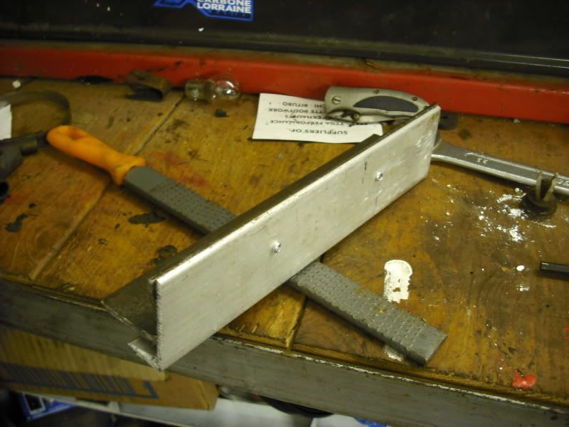

home made cam locking tool :)
Lubing the follows and guides, the cam lobes were also done
that concluded last night, finished just shy of 2am :(

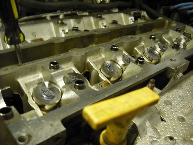

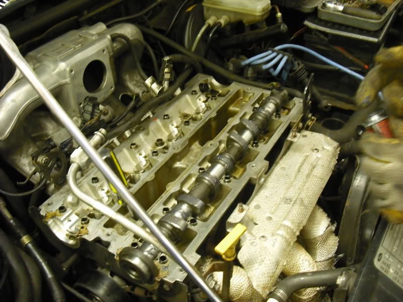

just before i finished for the night, i was refitting the cam cover, as i went to slot a bolt into the hole for it on the cover i dropped it, it literally had too... it fell into a spark plug hole with freakish precision :banghead:
using a probe magnet thing the bolt was easy to remove, as it didnt fit through the hole thanks tot he piston being at TDC, but its washer did :cry:
took me half hour to remove the bastard thing lol, jacked the car up on the passengers side as i could see it to the right of the centre of the piston, i was knocking the car and hitting the head with a rubber mallet to shock the washer to the centre, nope, ended up using a long reach screw driver that i bent the head on to reach while at BDC...
then raised the piston back up thanks to my missus clever thinking i used a screw driver with some blue tack on the end to grab it out, the prove magnet wouldnt fit through the plug hole
think ive learned my lesson there, NEVER leave the plugs out apon reassembly lol, phew though, would have hated to remove the head just to get it, meaning new bolts and gasket! :(
today was timing and refitting

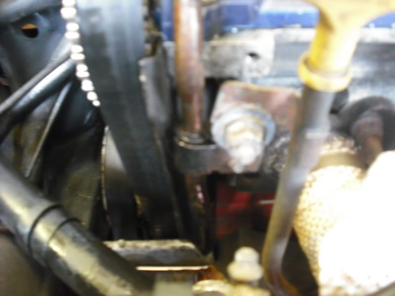

but disaster stuck, as i was about to start it, i was cranking it with the coil unplugged to check things, and PAS fluid started to piss out of a new hole in the crossover pipe, must have happend when i pent the pipe out of the way to remove the cam cover :bs:
this is where im to atm, having a little tea break a sec then ill be back down there to take the pump off which is a right swine of a job, and fit a spare pas pipe i thankfully have :)
love my spares pile :P
but i did remove the aux belt just to get it running, took a minute of cranking but she fired up sure enough and run fine :), which is a relief, wont know if the timing it bang on untill im driving it :|
but it should be fine
more later, plenty of mods to come this week :wth:

you will love them cams :D
they the fast road ones?
mine made an extra 15-18 ish bhp after a remap :thumbsup:

nice i like a women that gets her hands dirty even though shes wearing gloves :lol:
you're predicted 0-60 time is about right for the fiesta
looking good
PostPosted: Wed Aug 10, 2011 7:33 pm
you really think so darren? :d i bloody hope so, all this effort lol was yours a 1.8 or 2.0? im hoping it will increase lower down power as its like a VVT or something, gotta wait for the power in the higher revs
cheers though
mouse thanks mate, yea she enjoys helping me with what im so passionate about, oh she helps with the car too ;) haha

in other news, got the pump off, didnt bother switching pipes i just fitted the spare pump i had to save hassle, which is back on all the water pipes etc are fastened too, just needs the engine moutns refitting, coolant and power steering fluid back in and the induction back on and its good to go, started it again, runs perfffffect :D
bring on the CAMS!
any ideas the prices im looking at for a remap? and where?
to those with zetec engine fiestas.. PRAY your powersteering pump never gives up on you, what a nightmare this has been :(
