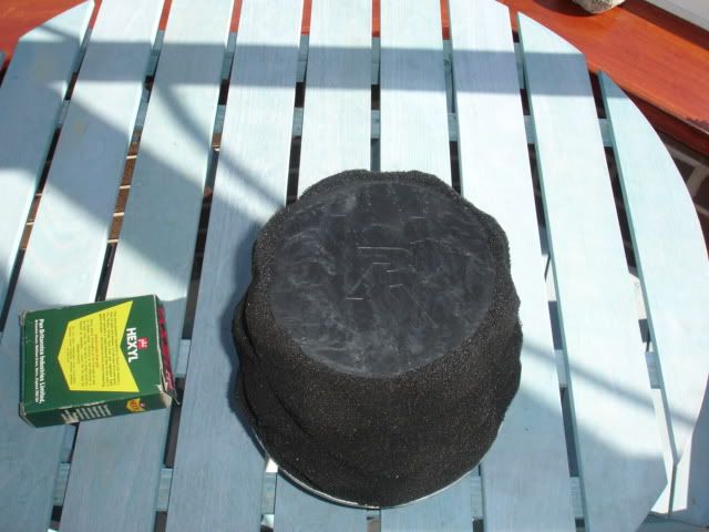

new piccies:
then i thought id better get a propper cone so i got this off ebay, but im a but unsure about it at the minute, might get a different one:
PostPosted: Sun Sep 18, 2005 8:57 pm
Posts: 2628
That cone is massive. Will it even fit in ?.
