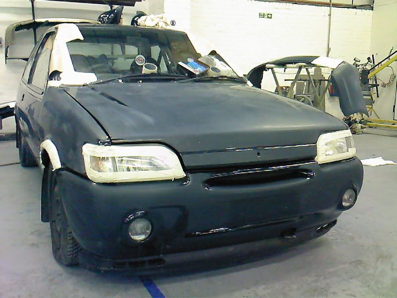

Hey, sorry for the late update, im livin at my bros til wednesday nxt week so only jus got me hands on his pc.
anyways heres my progress of the last 2 days, (wednesday and thursday).

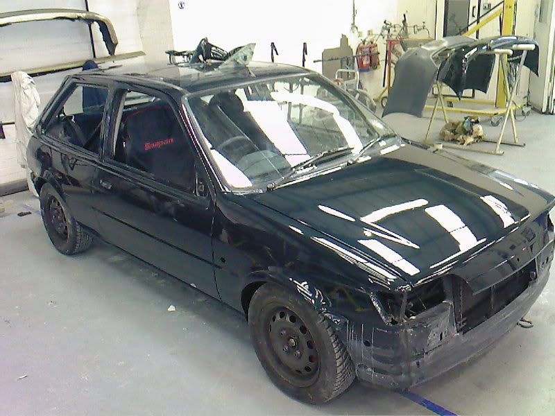

wedneday was boring, i did a hell of alot of flatting. but it was all worth it cz she got painted today!!!( thursday)!!!!
she looks mint, jus gota fit it all back up n flat the lot dwn again for the mop and polish!!!
any way have a butchers for ur self ppl!!!

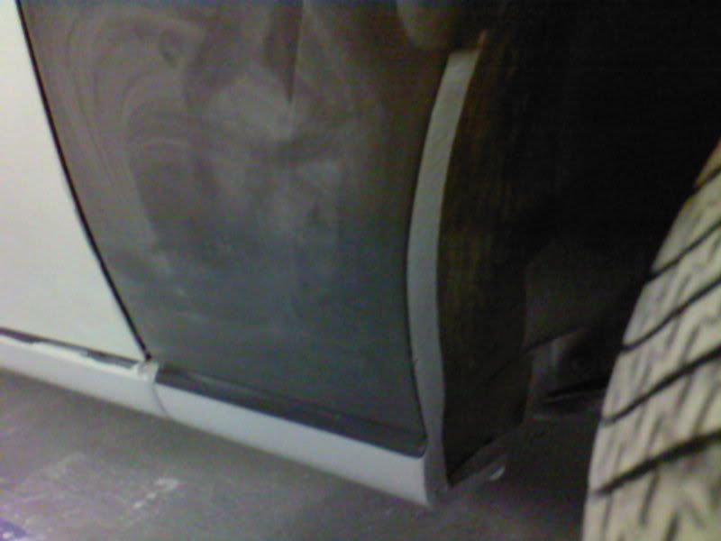

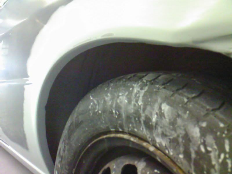

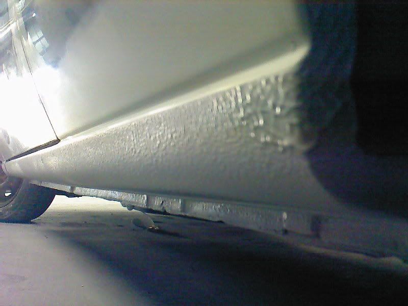

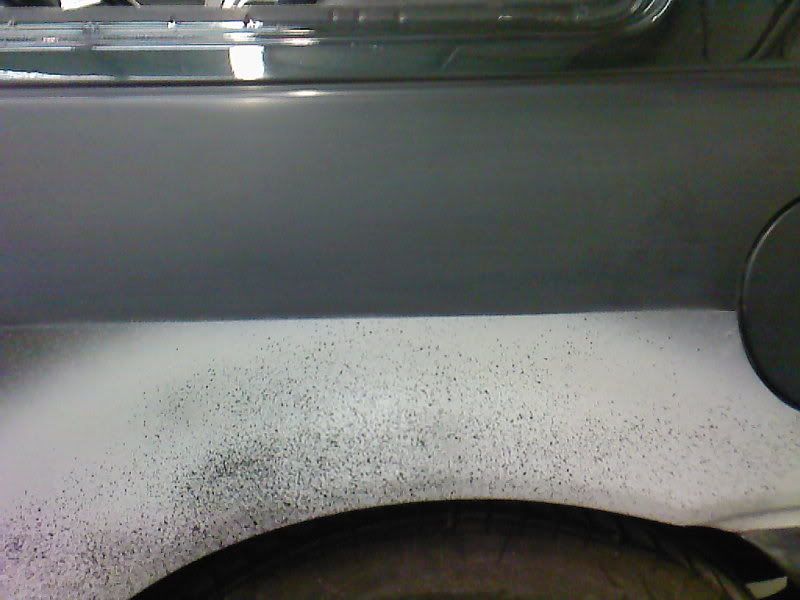

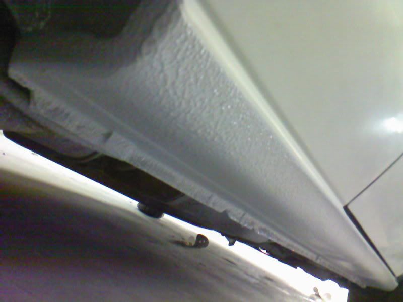

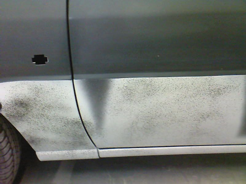

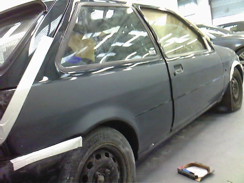

You can see here thta i have extensively stoneguarded the sills and inner lips of the arches all round the car. this prevents corrosion. ford never did this to the fiesta and most of their fords throughout their manufacture. no wonder they rot so damn quick!!
i think its safe to say that ive beaten their 10 year corrosion gurantee hahha :lol: :lol:

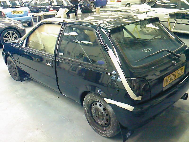

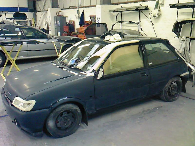

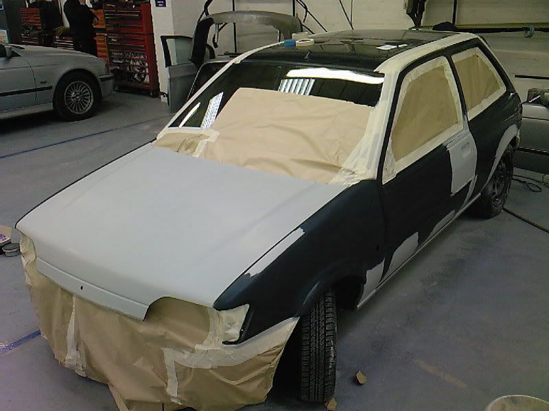

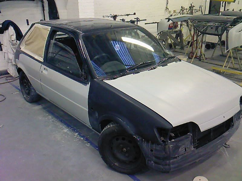

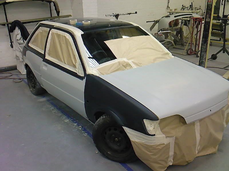

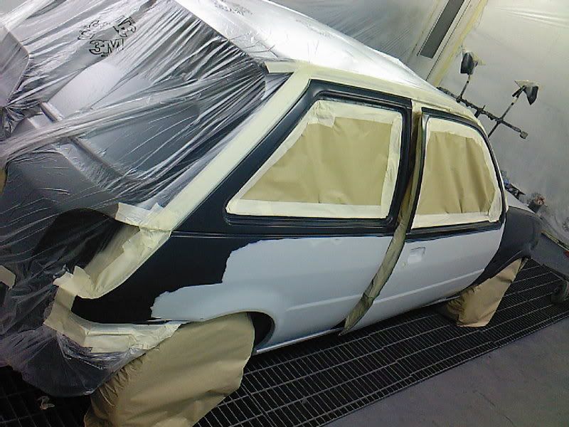

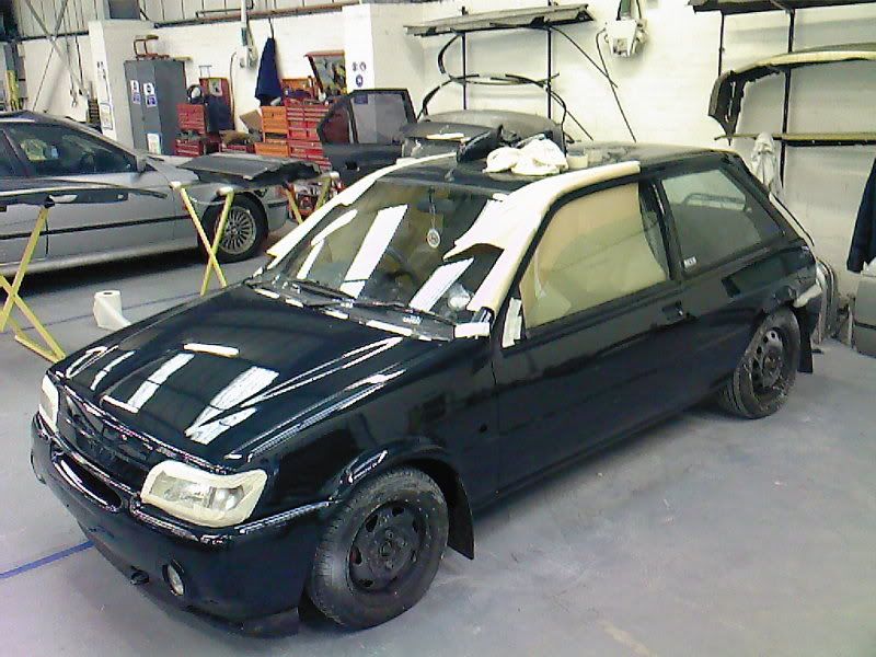

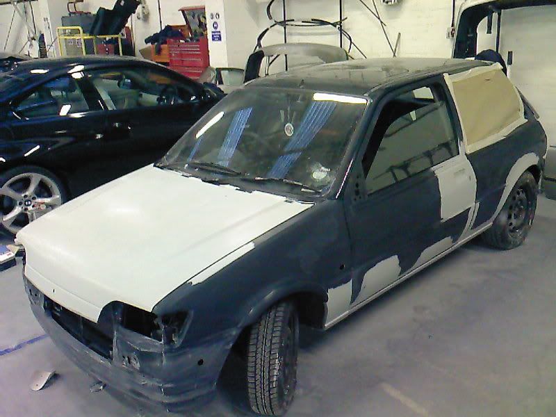

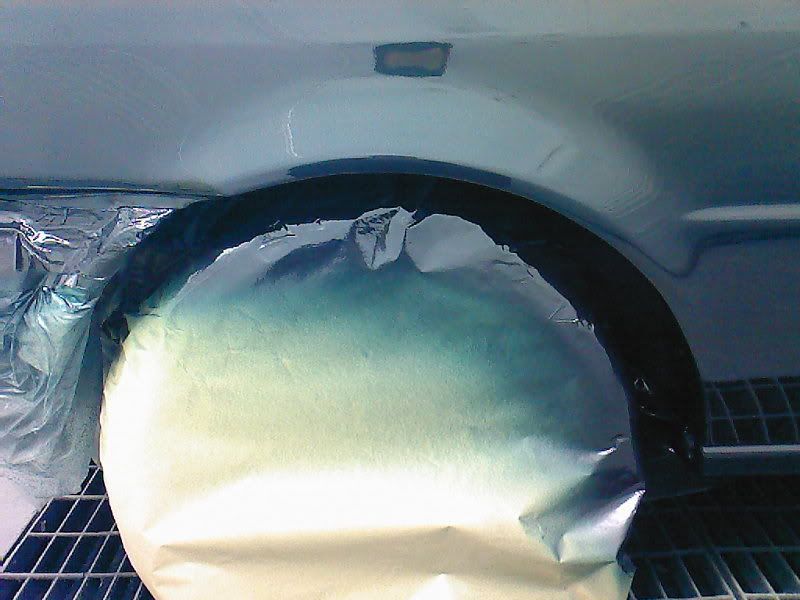

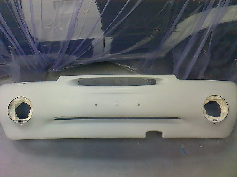

with all the flatting of the primer out the way it was time to panel wipe/ degrease the whole car ready for masking for paint!!

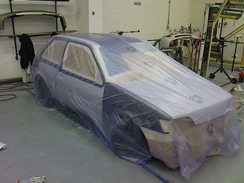

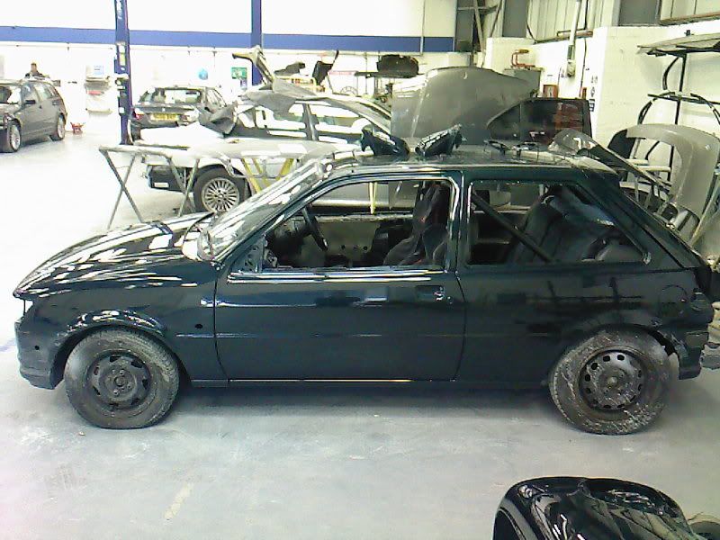

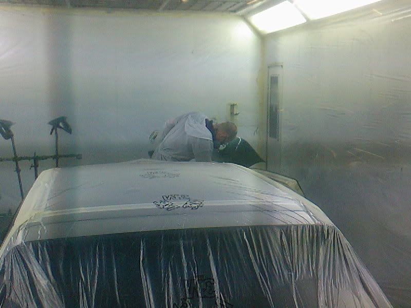

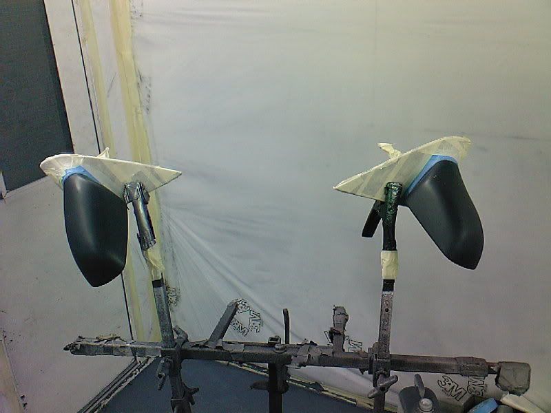

in the booth now, fully maksed up degreased and ready to go!!!

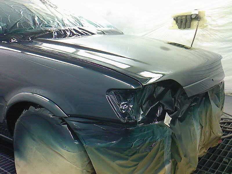

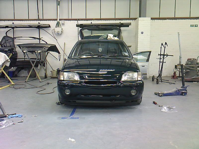

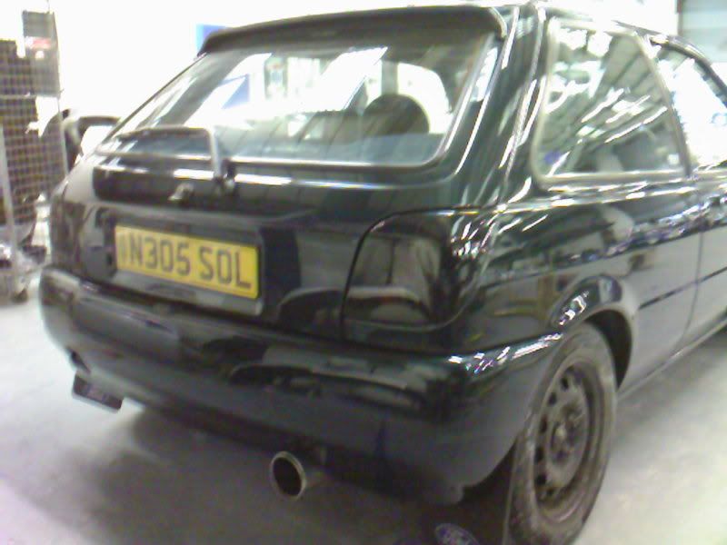

Paul the painter, doin wot he does best!!!!

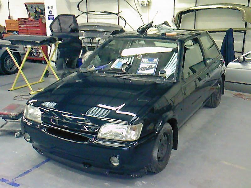

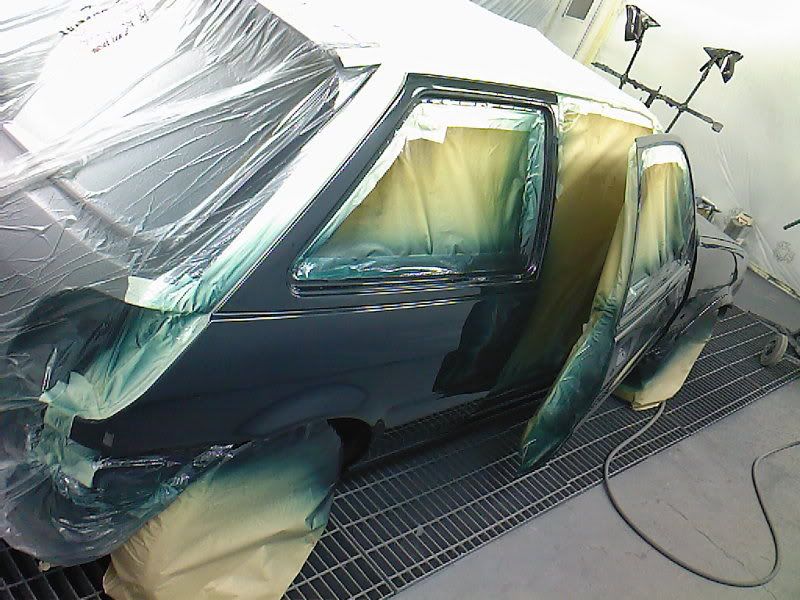

Painted, and lookin the nuts!!!!
i cant wait to fit it up n get the laquer lookin flatter than flat!!!

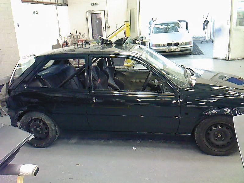

Heres todays progress (Friday).

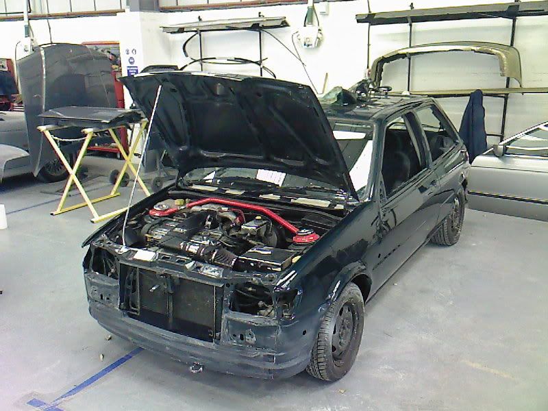

Got to work at 8;45 am n had to unmask the fez n get it out of the oven, then i began building her back up as much as poss, so i cud crack on with the mopping and polishing. i realistically wanted it built upm and half mopped by the end of today, it went really well and i managed to get the whoe thing mopped and polished, and the only fitting left to do is:
Door handles, window rubbers and runners, door cards, mirrors.
side repeaters, front number plate, and those 15 inch 5 spoke alloys im borrowing til nxt fri wen i finally get my wheels back!

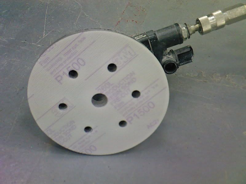

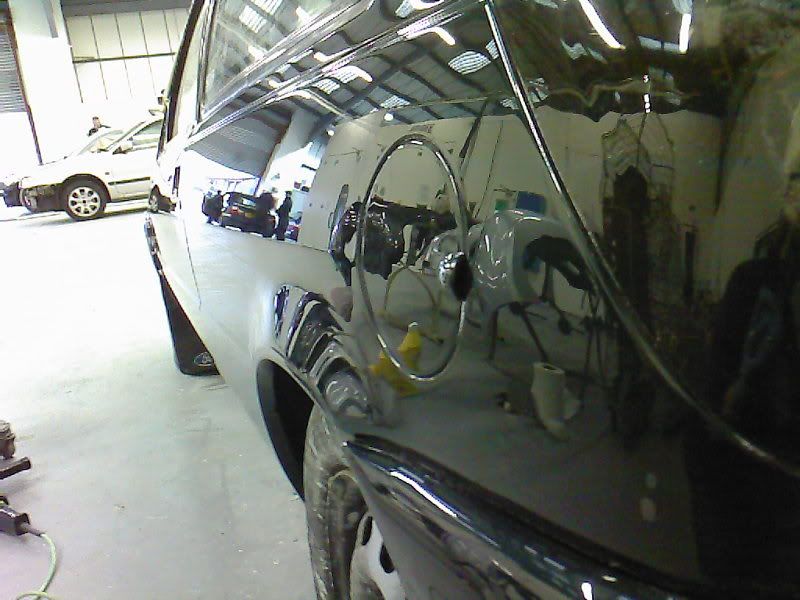

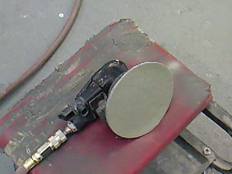

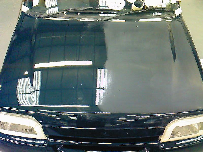

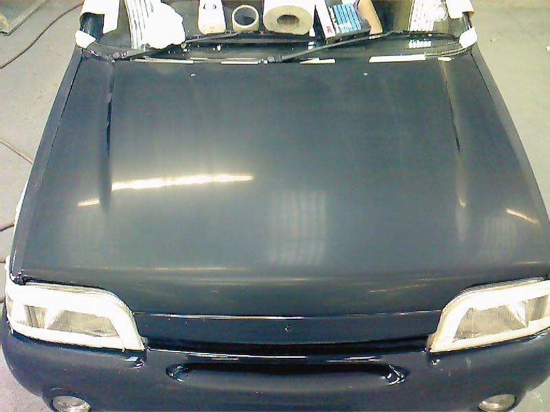

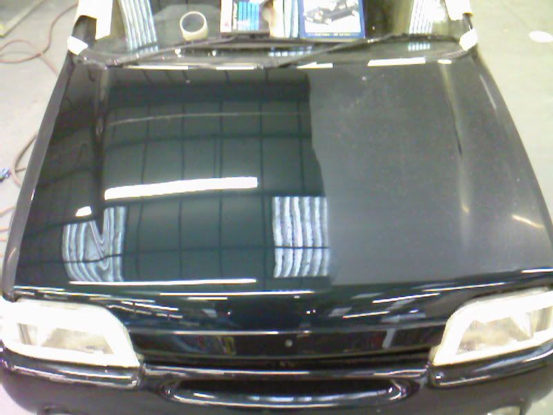

Using p1500 da discs to dry flat the lacquer down in the first part of this mopping and polishing technique.
you see here that ive da'd half the bonnetto show you wot it looks like.
then i da'd all the paint panels as much possible.

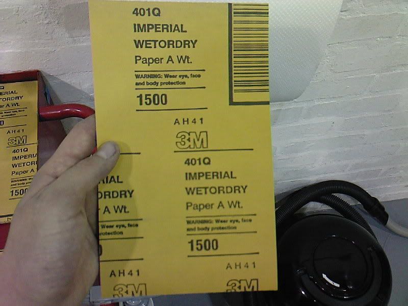

i wet flatted the front bumper with p1500 wet n dry paper, this is because he da is too big for the small areas of the bumper.

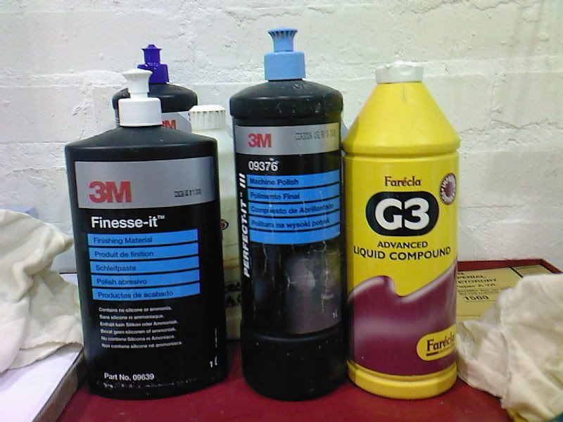

this is wot we use at my work wen mopping and polishing. G3 compound for bring the panel to a shine, then Machine polish for a gloss finish, and finally Finesse it, a light wax.

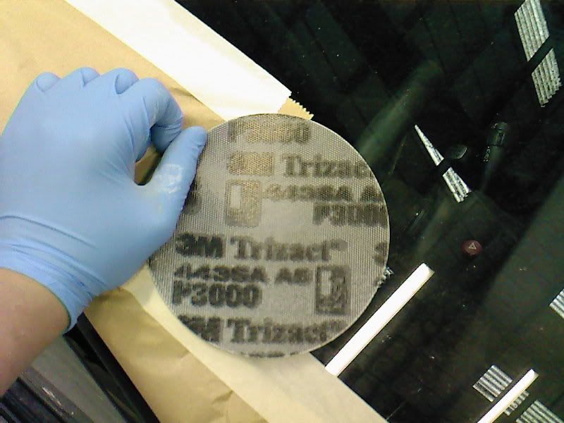

this p3000 microfine finishing pad, aka Trizact. this is the nuts!!
After p1500 dry sanding, spray painted panels with water and spray trizact pad and da over the top of where you have p1500'd. this gives a half gloss finish, thus makin it so much easier to mop up!!
here you see ive mopped up half the bonnet to show u hte differnce.it leaves a glasss like finish once mopped up!

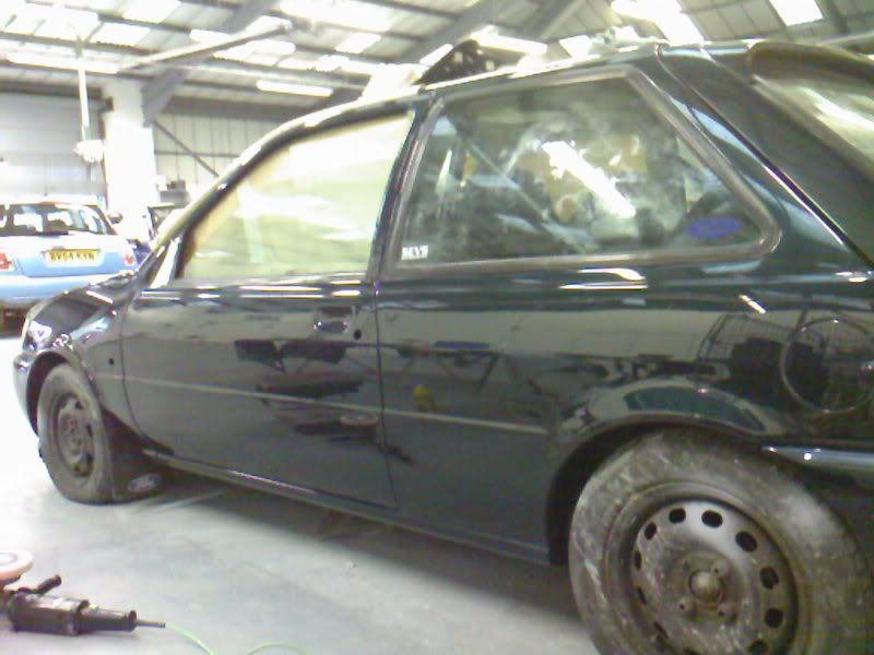

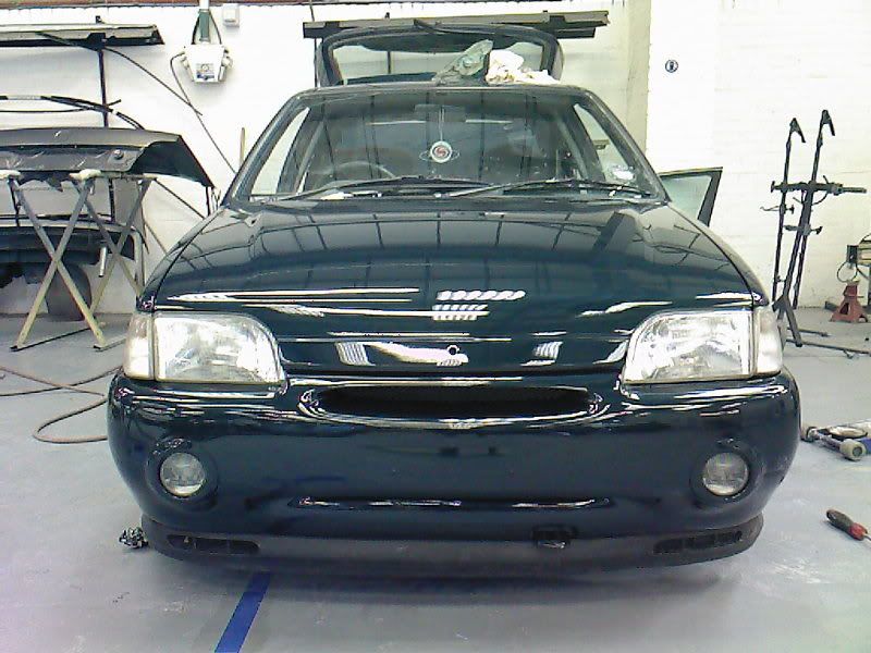

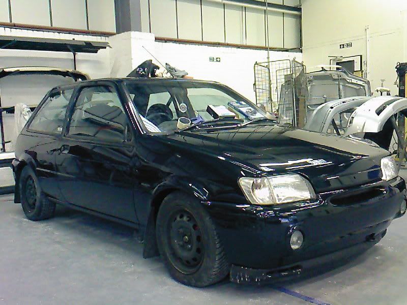

thats the whole car mopped and polished, and it looks like new!!!!!!
