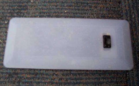

A mod I do to most cars I own, just for added help in the darkness...
I fitted this:-
to replace this:-
I have these ready to go on:-

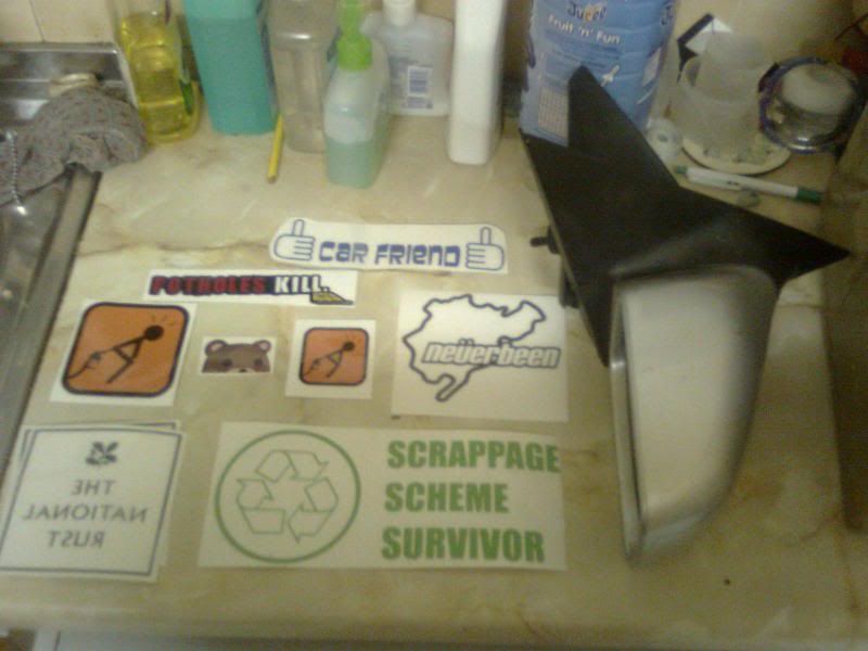

I dont think I need to explain the stickers??...
Got a drivers side colour coded mirror, as it currenty has a boggo plastic one on that side, and for 2.99 you can't moan :lol: cheap symmetry!

Where do you get those kinda stickers from? I'm tempted to get one of the scrappage scheme ones
PostPosted: Fri Dec 24, 2010 12:17 am
ebay

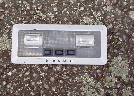

hi mate what is that interior light out of cheers :thumbsup:

i bet that light would fit in the fiesta si.
PostPosted: Fri Dec 24, 2010 6:33 pm
Its alot bigger, your better off fitting a MK4/5 Fiesta light with spot lights trust me
PostPosted: Fri Dec 24, 2010 6:57 pm
The mk3/4 light looks alot of hassle aswel. Think I will just stick with the one thats in.

MK4/5 Fiesta one all you need to do is cut thew roof lining to make it fit, and slightly cut/bend the metal behind it, simples, and well worth it IMO ;)

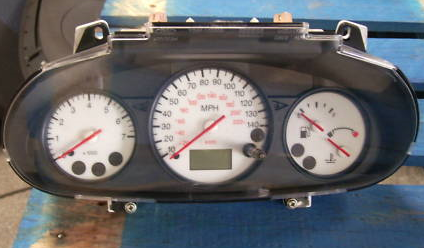

Been driving the Scrote more on a few more long runs and found that the Speedo is playing silly buggers on me.
eg. its all over the place, either the cable and/or gearbox is near shagged to death, which wouldnt suprise me at all :teehheee:
So a way round this, would be to fit some of these:-
As found in MK5 Fez ZS models :)
They fit straight into the Scrotes, and is the same job as like fitting them to a MK3 Fiesta. Wire up the relevent wires and add a wire from the VSS found on the gearbox to feed the signal to power the speedo needle! - Alot more accurate.
The downside being that the fuel gauge reads backwards, like it did when I fitted a set to my MK3 Fiesta. - A way round this would be to fit the sender from the Fiesta too, which isnt a hard job in its self.
Please note:- I will probably not bother doing this :lol: too lazy.. and generally have the satnav on longer journeys anyway :P

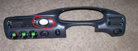

See part of the MK6 Escort Dash:-
The clock which is circled in red (which happens to be Analogue; why the fuck Ford got rid of the digital one I dont know)
Is an oval shape... now my plan is to fit the boost gauge into that space that the clock sits, and cut/fiberglass it all in, and give it a coat of black. - I'm sure it wont be too hard, its only a little bit of fiddling about to keep me entertained inside.
I will then need a clock, so I am going to take a digital clock panel out of something else, probably have a mk3 fiesta one laying around somewhere.
Under where the boost gauge will be, is 2 redundant buttons for changing the hands on the backwards clock, and a flashing LED to tell people that it is fitted with the wanky PATS system :lol:
I plan to mould in the clock and LED from the Fiesta into this place, it will use the existing Escort wiring anyway.
I'm hoping it will look fairly neat :) - Then when the ineviatable Escort drops to bits, some chav will want to buy it for his Coz replica and pretend he has boost :lol:
