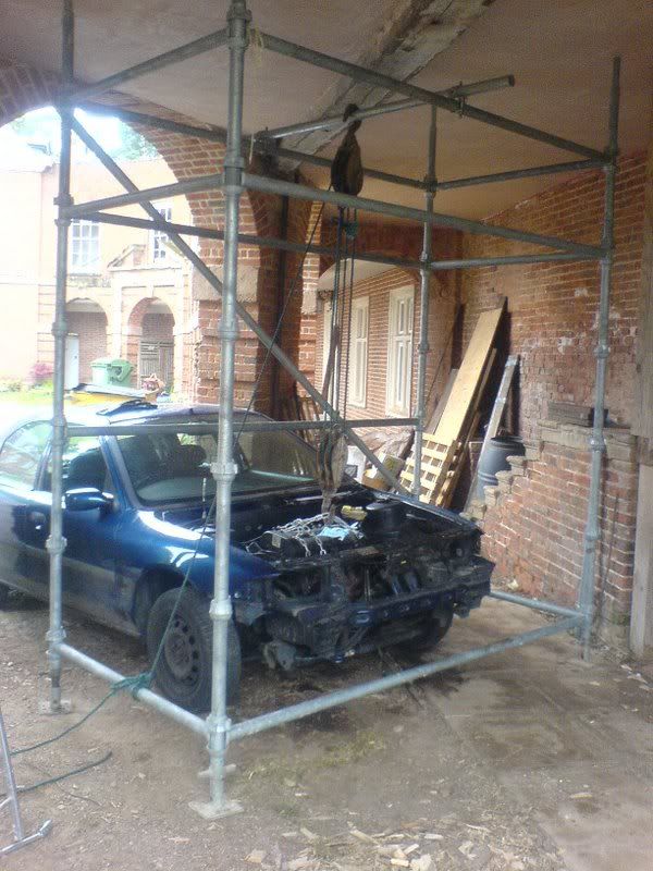

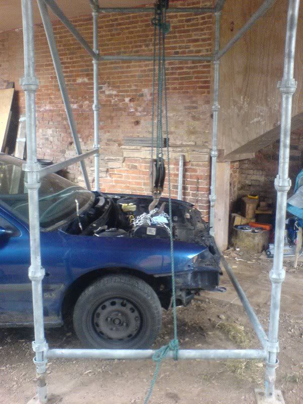

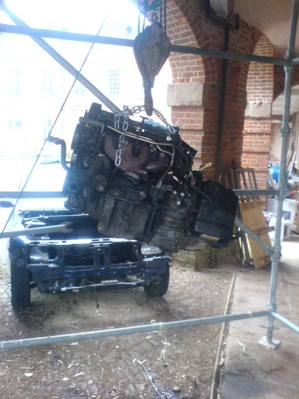

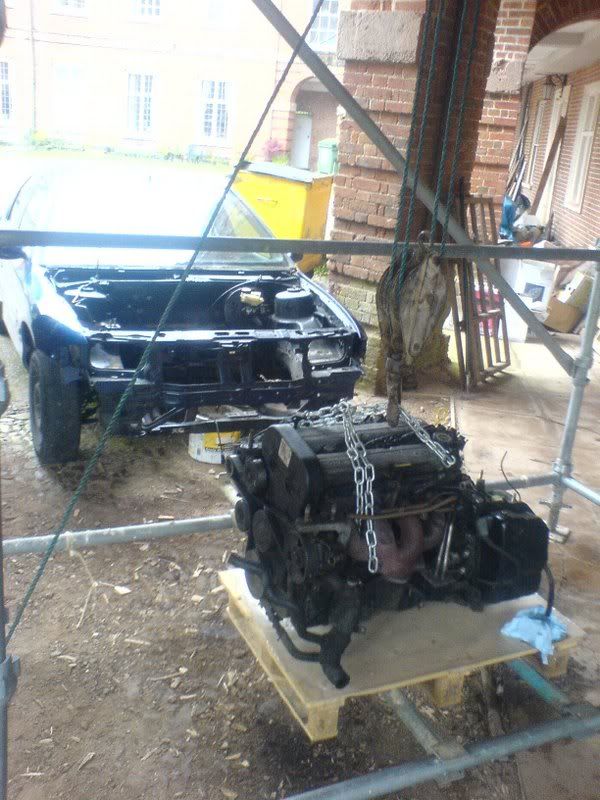

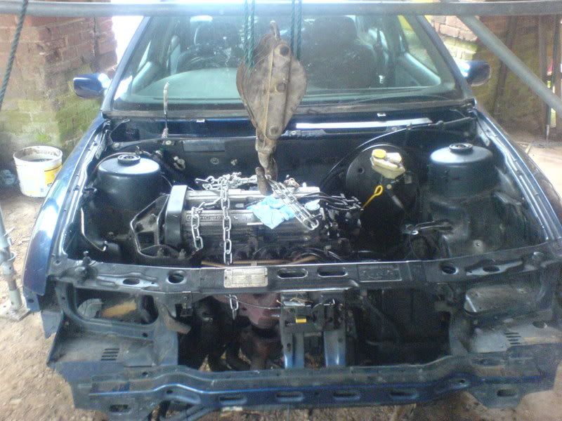

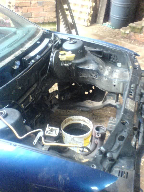

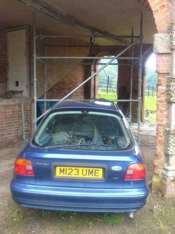

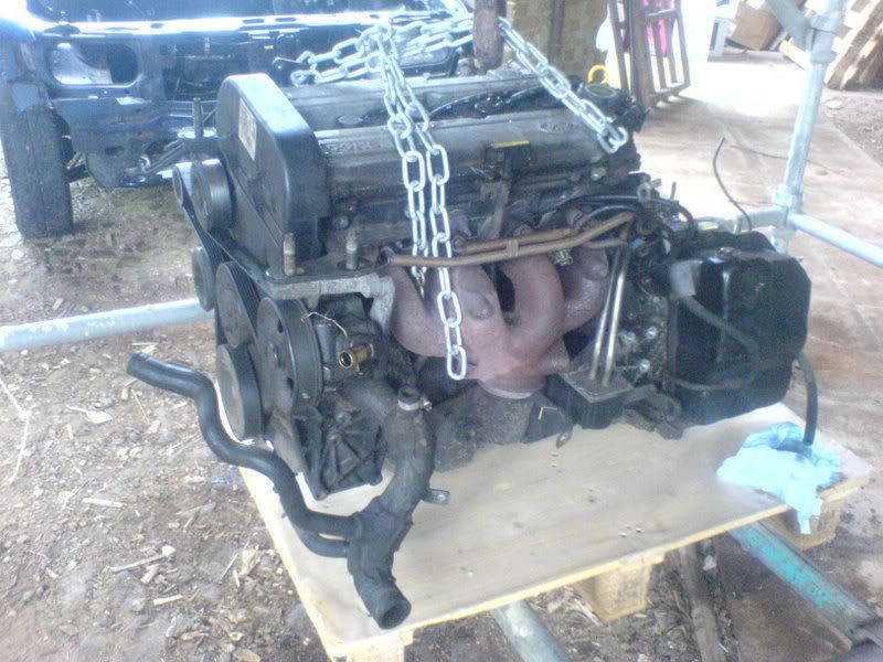

I've been busy over the weekend and started work on the mondeo.
The result is one 2.0 lump removed and ready to begin being rebuilt. :)
It took me about a day to strip everything from around the engine, then me and my uncle constucted an engine hoist using scaff. and two large pulleys. The lift went very well, although the pulling required combined effort because we lifted all of the engine, ancillaries and gearbox in one. It's one heavy lump!
Anyway here are a few pictures:
Thanks, James.

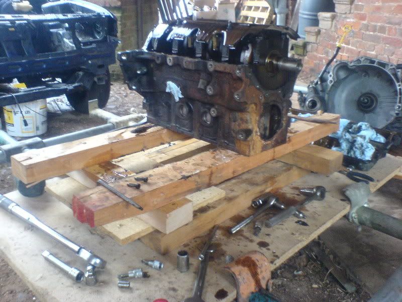

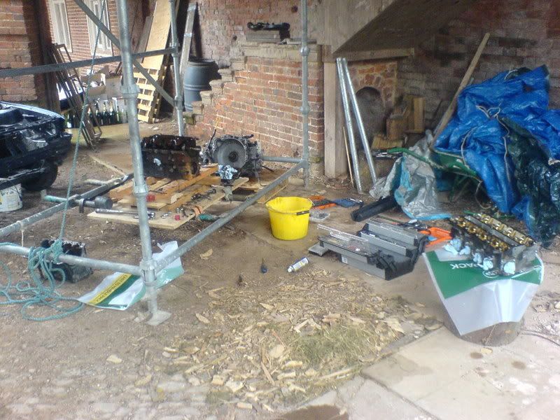

Probelm sorted :)
I decided to keep the faith and go back to Halfords, they replaced 2 broken sockets for 2 new ones without issue.
I managed to remove the head bolts without another tool snapping, which is nice :rolleyes:

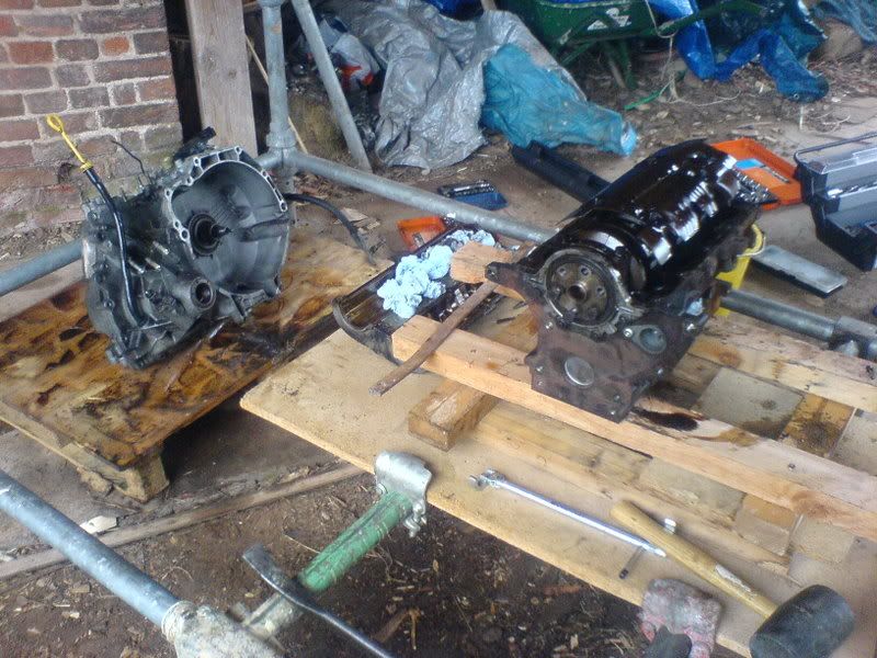

So now the cylinder head is off, as well as the sump and all the other pumps and pullys.

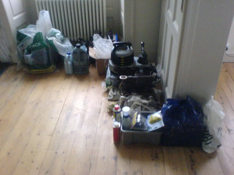

Here are a couple of pictures at the end of the day:
and the parts collection growing in my kitchen: :lol:
Thanks, James.

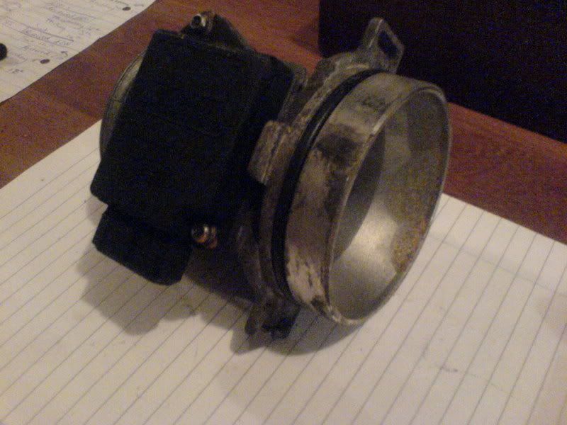

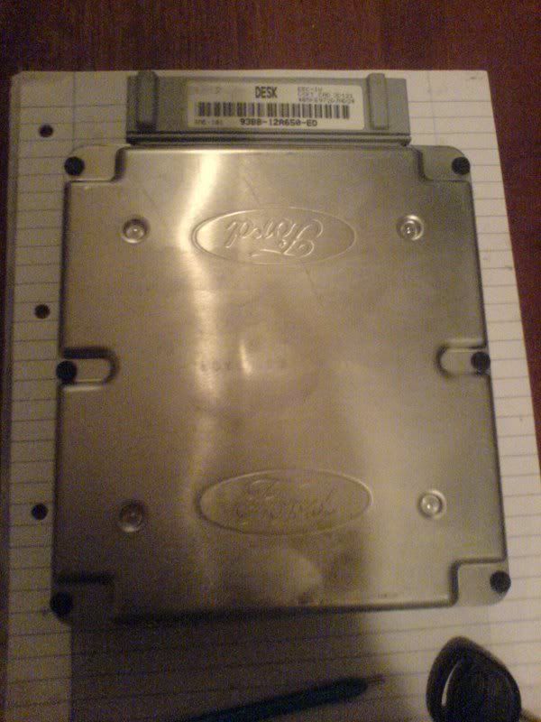

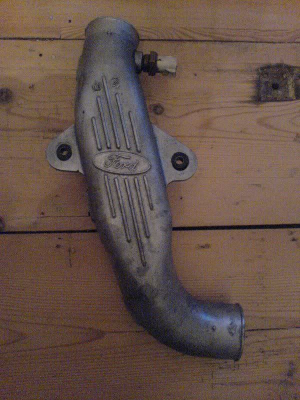

Here are some of the parts that i've been collecting from ebay and the like :)
RS1800 inlet manifold, throttle body and sandwhich plate:
Escort RS Turbo crossover pipe:
2.0 MAF sensor
DESK E.C.U (very expensive :shock: )
I also seem to have 5 throttle bodies somehow :lol:
Is the RS1800 throttle body the same as the 2.0, which would be the best to use?
Thanks, James.
PostPosted: Mon Jul 23, 2007 10:11 pm
that ecu looks like new!
