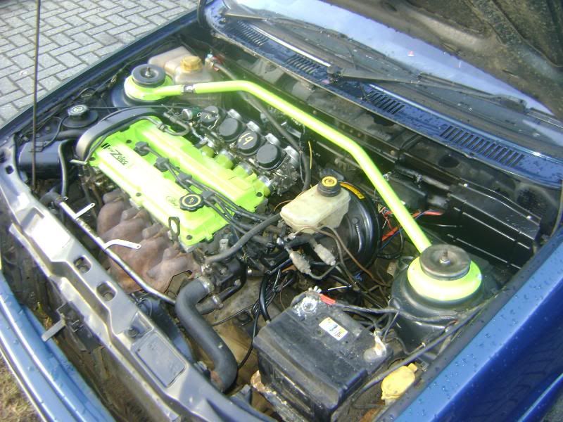

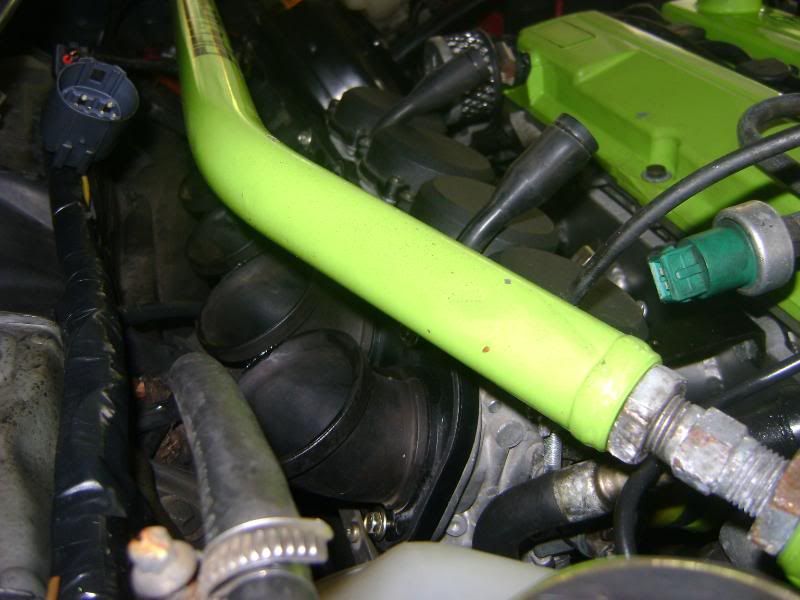

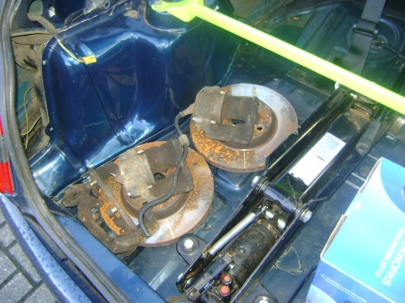

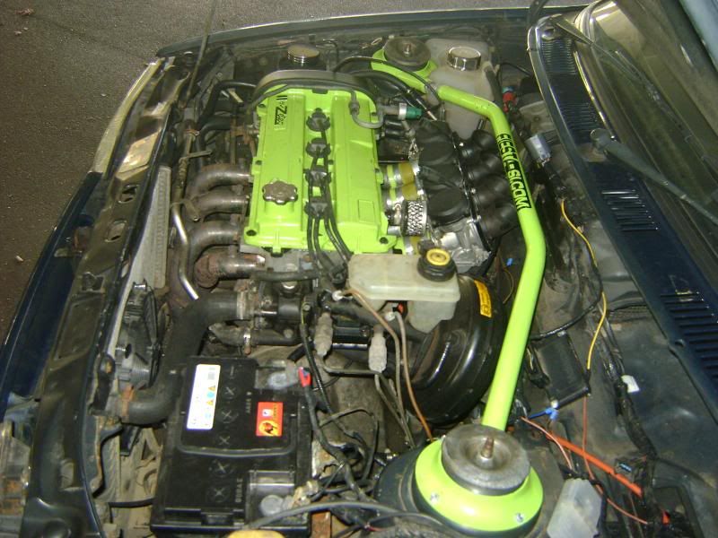

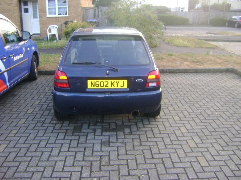

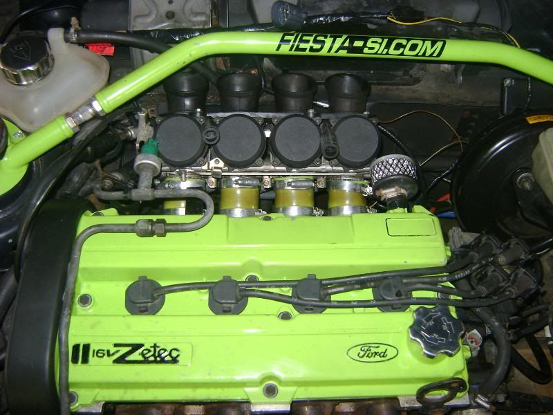

Spent some of last weekend on the car and got most of it done, its now alive and running and goes pretty well. Ive ordered another set of carbs so i can give them a good check over, drill out the jets and fit them as the R1s are not what the manifold was built for. I have now found the correct zx9r ones that i need after a few months of searching ebay.
Some progress pics

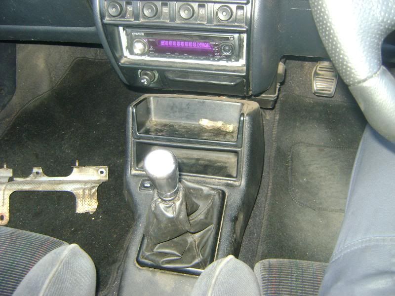

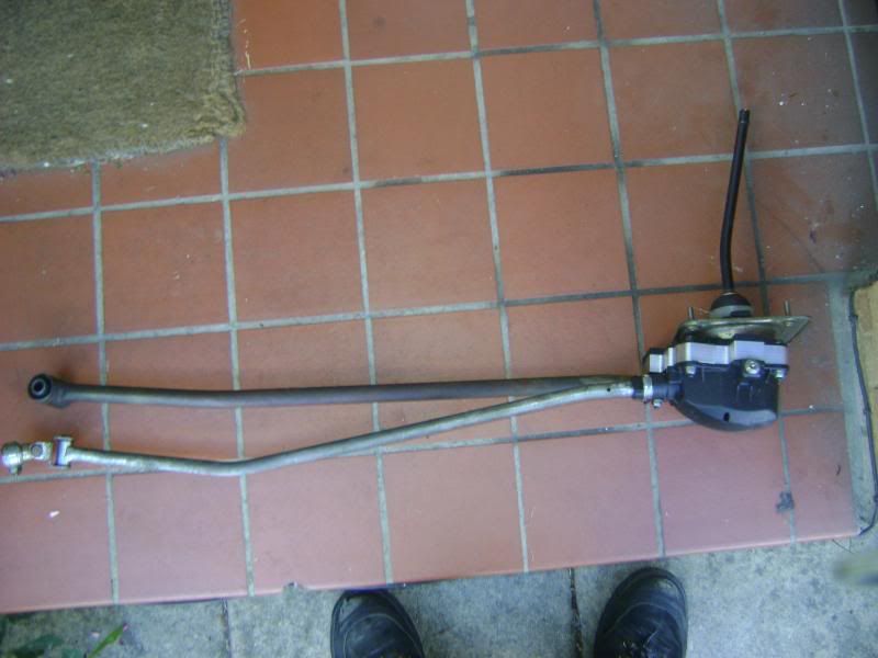

Short shift now fitted

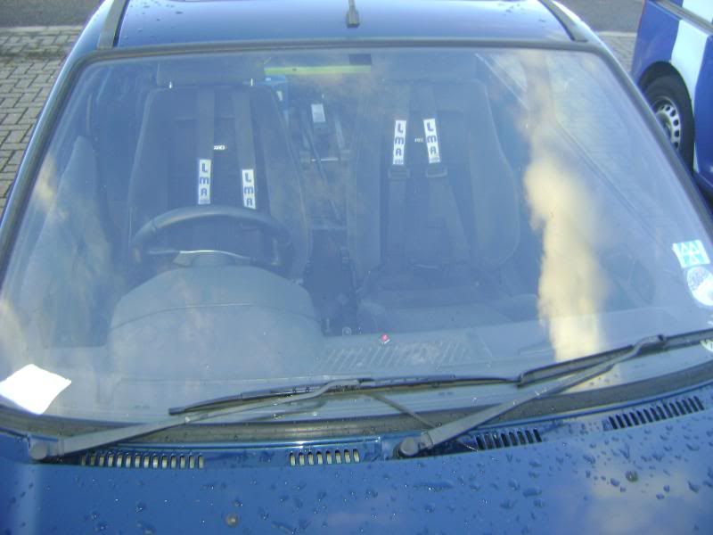

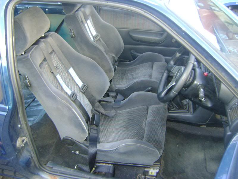

Seats and harnesses changed and finished removing the rest of interior
Front 285mm brakes waiting to go on

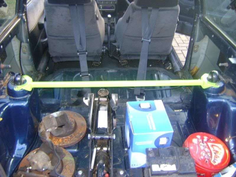

Strut braces front and back
New rear lights 8)
Few more bits to do
fit front brakes
Ordered rev limiter with launch control
Fit new set of carbs
Will run it like this over the winter but early next year i will be fitting 45mm jenvey throttle bodies with omex 600 ecu which i have recently done a deal on. Would swap them straight away but the ecu is currently mapped for st170 engine with vvt so wont be to good on the zetec :thumbsup:

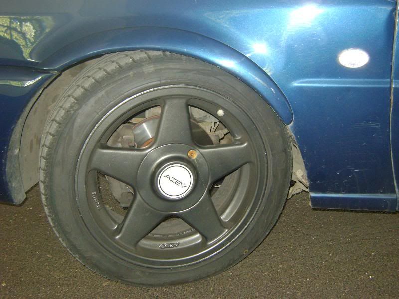

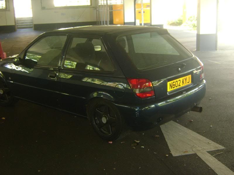

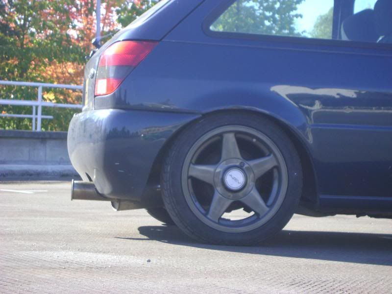

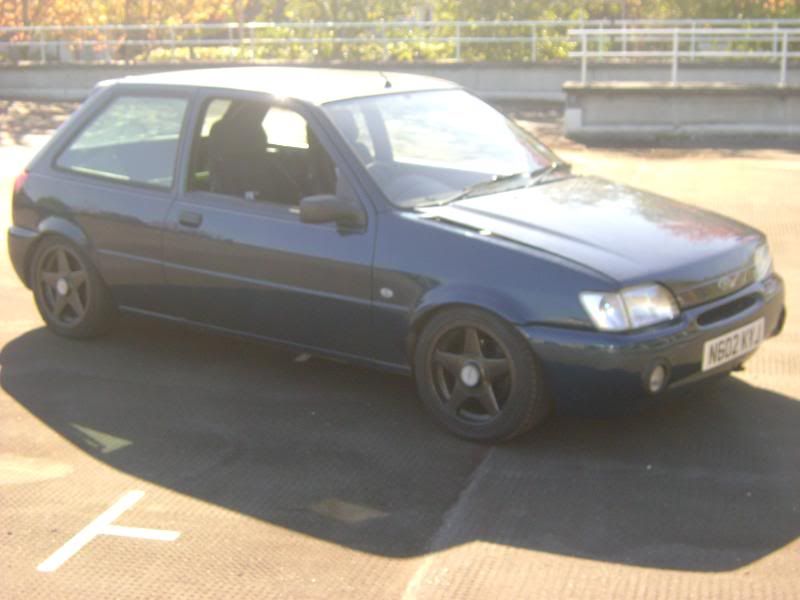

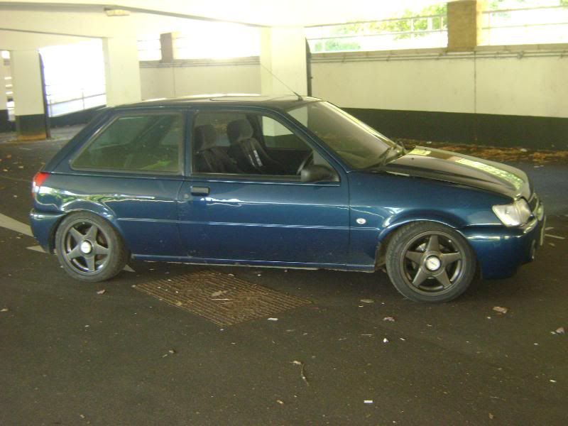

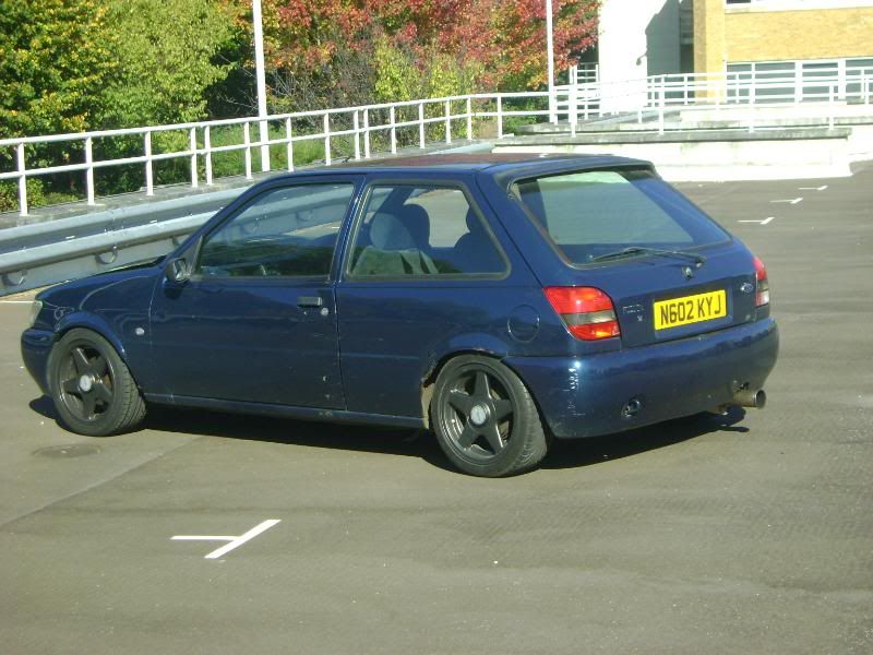

My g/f was out for the day so went for a little drive and decided to take some pics as it was a nice day. Didnt bother to clean it though :(
Will upload the little video when i can work out how to :doh: :banghead:
